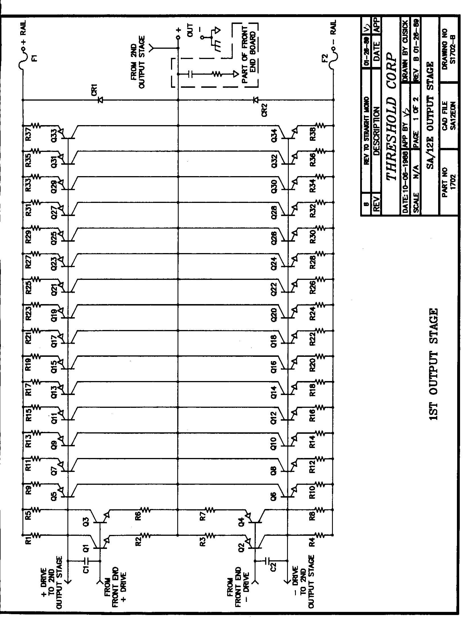

make a consensus about type of outputs, OS arrangement, max number of devices per channel (UMS applicable?) and I'm going to draw OS pcb for Greedy Boyz

Following on from Zen Mods great offer, maybe a 6 pair and a 12 pair pcb layout will suit all members - would that be too much trouble for you ZM?

if memory serves me well, UMS is allowing up to 8 pairs of outputs?

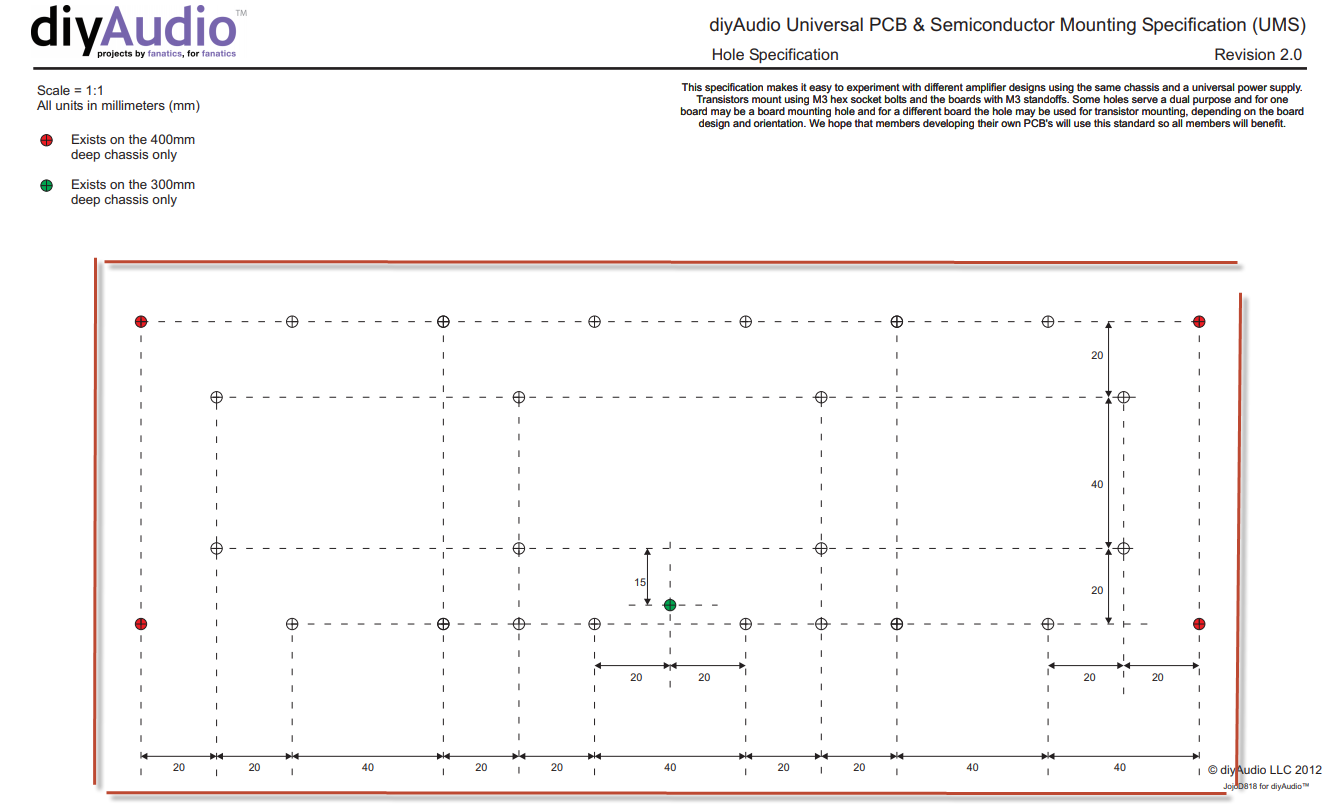

UMS - https://cdn.shopify.com/s/files/1/1006/5046/files/universal-mounting-specification-v2.1.pdf
Big UMS is 6 pairs.
Big UMS is 6 pairs.

arrangement is pretty much 1+7 pairs, ubergovernor transistors (Q1 and Q2) being of same type as rest of them .......

since 300deep chassis is for Sissies only, excuse me that I'm really insisting in arrangement for 400 deep, which complies with (1+7)=8 output pairs
is there any other choice , if going for 1R emiter resistors?

TO3-P or TO247 definitely preferred over the original To3 metal cans - much easier to mount and work with the UMS layout.

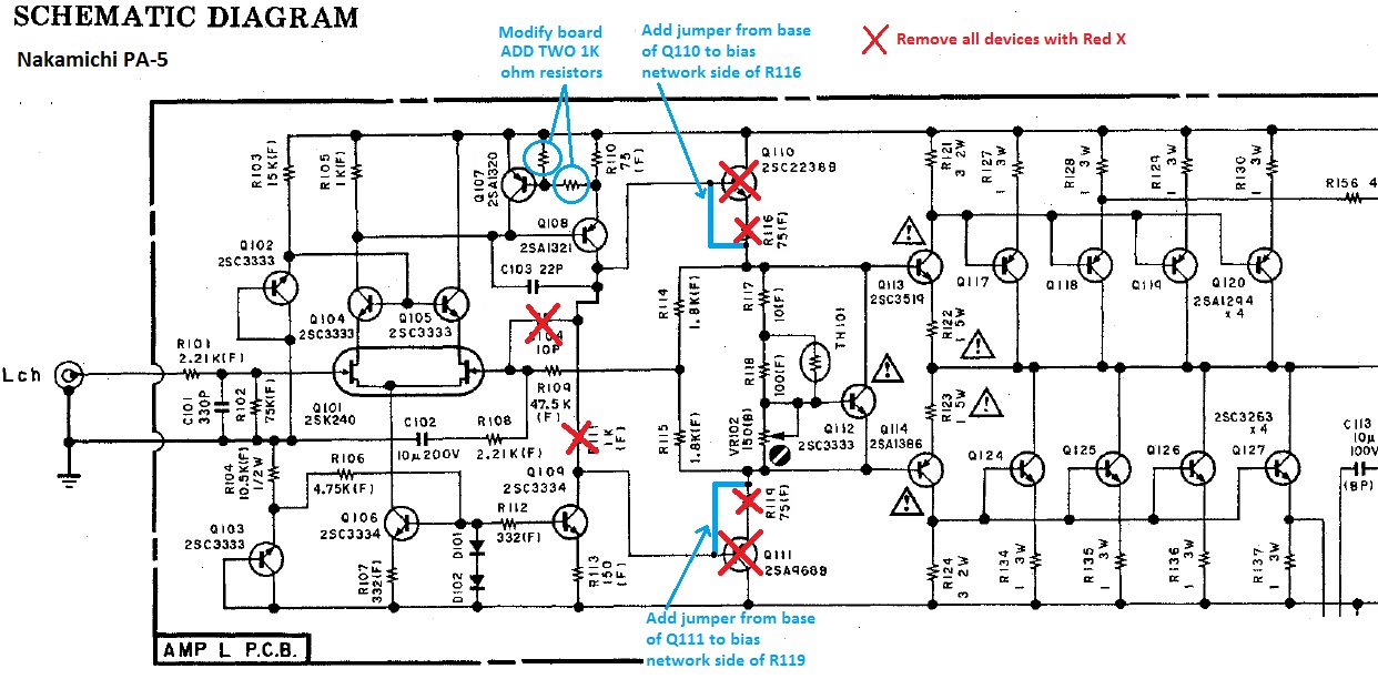

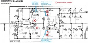

I own a first gen Nakamichi PA-5 and decided to look at the differences between the revised Stasis circuit from Nelson and the original Nak PA-5 to see how big the changes were. After a bit of evaluating the boards and new circuit it would actually be very little work to revise the original Nak pcb's to the new revised Stasis circuit. The hardest part would be adding the pair of 1k divider resistors (R14/15 in the new circuit) to the base of Q107 in the old Nak pcb. I attached the original Nak circuit & my MS Paint edited schematic. The nice thing about the Nak pcb's is that they have a fair amount of space on them to allow for modifications. The stock pcb's would be even simpler with the reduction of parts.
In addition to my edits, various resistor values can be updated. Add the miller cap across R109 and the electrolytic cap across the bias network. Swap out C103 originally a 22pf for a 33pf.
The original Q108/Q109 (SA1321/SC3334) could be swapped out for the KSA1381/KSC3503 as the pinout is the same.
Did I overlook anything?

Nelson has also added a N/C thermostat T (shown incorrectly on his schematic as N/O).
It would be very interesting to see what difference the new design makes to the Nak.
Maybe you could save the original FE board, remove it and add the new FE board in its place.
The Nakamichi also has a 75C temp switch but its part of the protection circuit.
It could be relocated to shut down the front end current source as Nelson's revision shows or it could just be left alone in the Nak.
The thing with the Nak amps is that they do not have a separate output stage board. The input and output stage are all built into the one board. This is the reason I was looking at a way to do the revision to the original board. The nice thing is that the changes that I see to the original board could easily be reversed.
