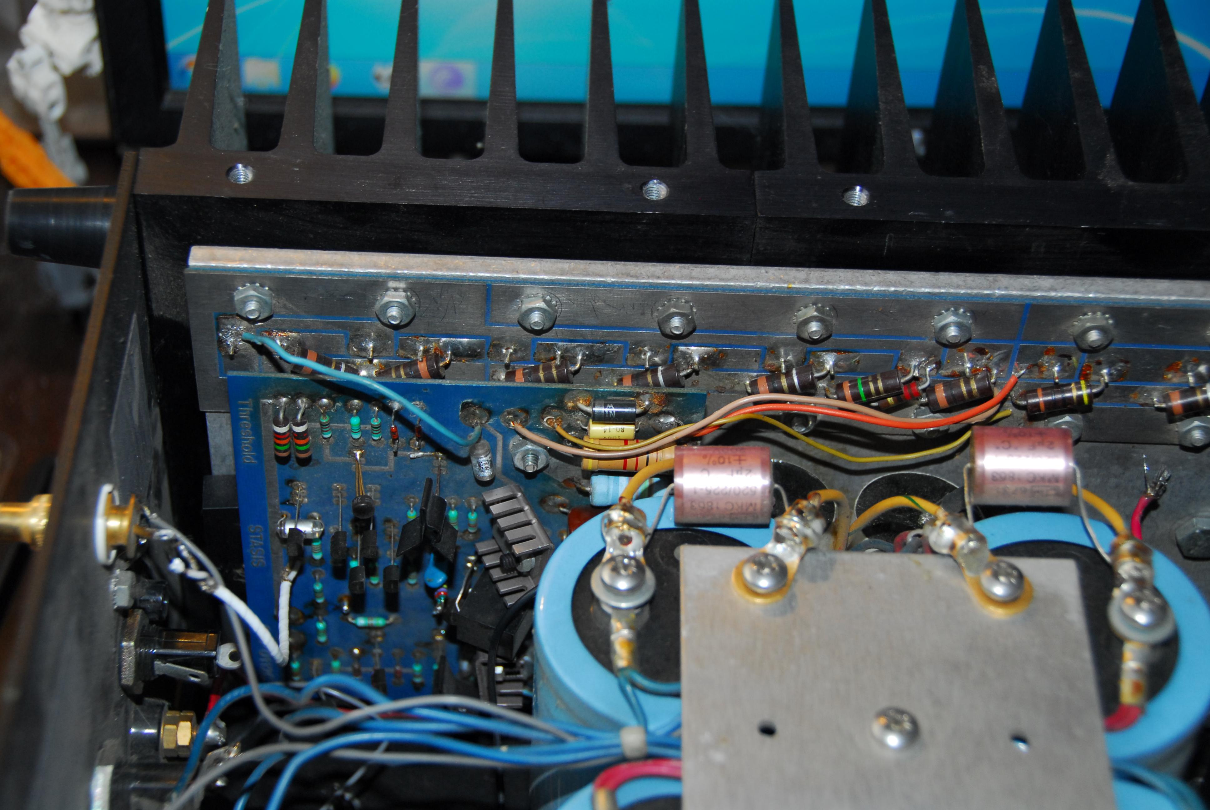

As I am one of the 2 people that Nelson graciously decided to design a new FE board for to restore the damaged Stasis amps' original FE cct brds, I thought I better jump in and publicly thank him for being so generous. Thank you Nelson!

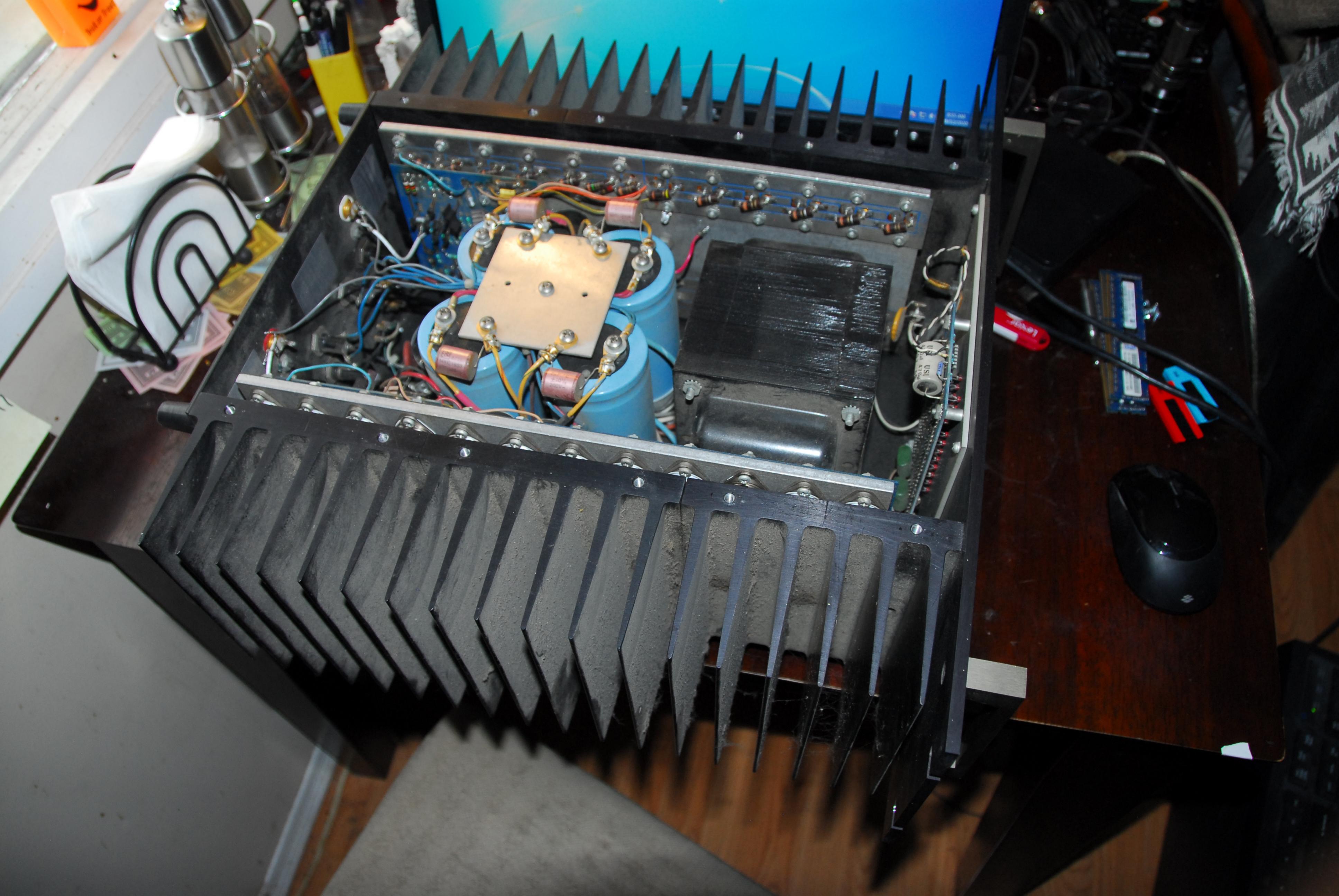

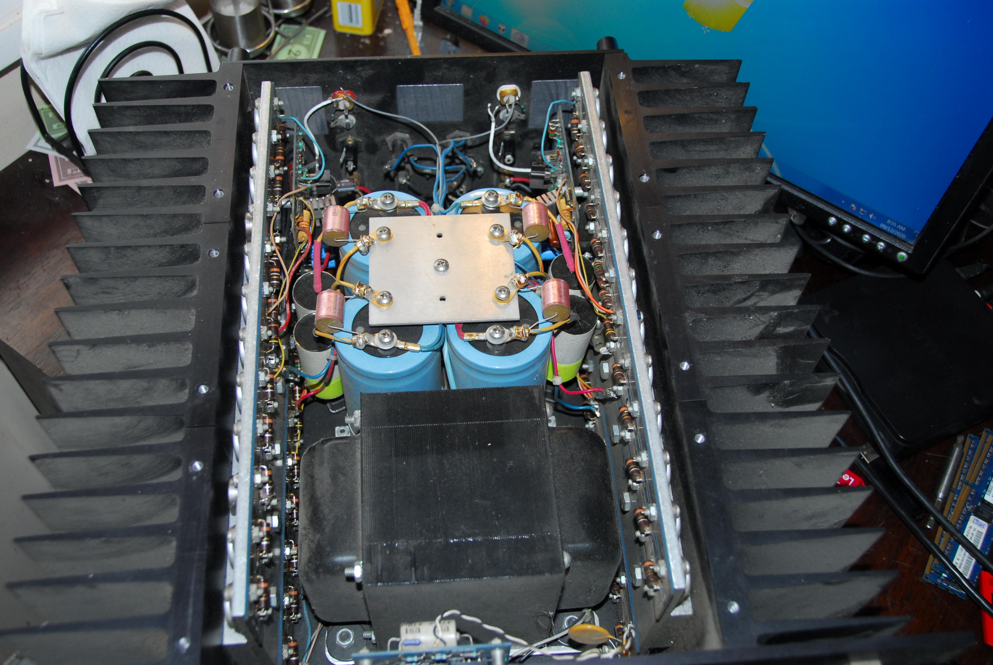

My only participation in the design was to give him the dimensions for the original FE boards for the Stasis II. 🙄 I haven't had any audio time recently as work has all of a sudden picked up again but I have the amp ready to rebuild this winter and the boards and parts ready to stuff. The poor Stasis has been sitting under the piano for a few years now, I am looking forward to getting it up and running again. I will be replacing all 24 output devices per side as well with new TO-3s, I think I decided on MJ21194/95 but can't recall as it's been a few years since I bought them. If you search my posts you will find my discussion with Nelson re: the repairs on this amp a few years back and my thoughts on OP devices.
Stasis II heatsink dimensions are 16" deep, 6.25" tall, 3.75" fin to mounting surface. They look like pretty standard extrusions and each side is made up of 3 pieces.
Attached pics of my baby.
Cheers
Cheers
Very cool! I love those old heat sinks. Do you recall if the smaller film caps were installed from factory or were a later mod?

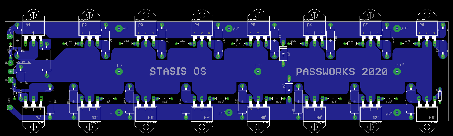

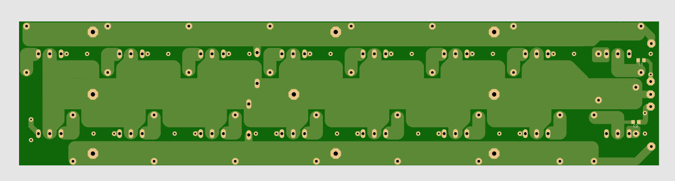

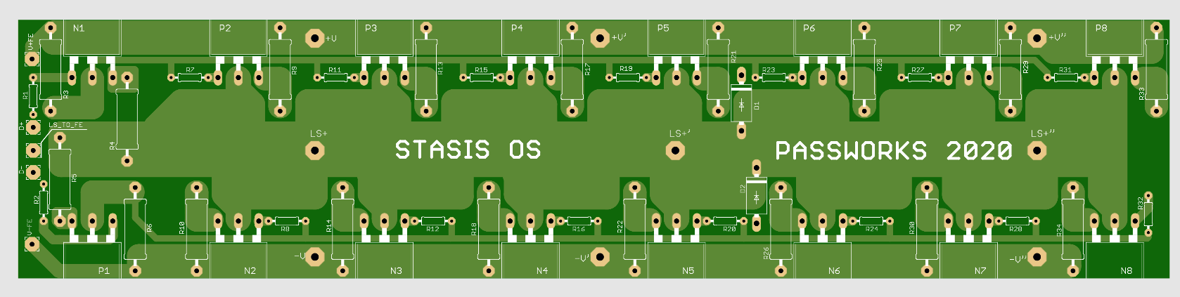

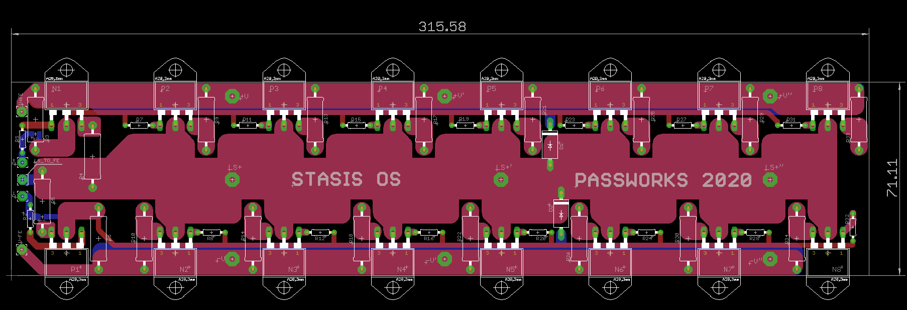

OS pcb
400 deep UMS compliant
I just need Papa to give blessing for resistor values
Very nice ZM, it looks bloody good, just one small point - am I missing something as I don't see the C1 and C2 on the layout. Other than that - you are a legend.
Also just looking at Nelson's new FE pcb, he has R20 and R21 already in place feeding D+ and D-, so do you also need your R1 and R2 at the input drive transistor base?

I did that instead of Papa
though, I am sorta on payroll, all these years
caps are biggest size SMD on back side
regarding D lines resistors - I like them placed locally; considering values - you can keep both - Papas FE placed 100R, and my local 22R
