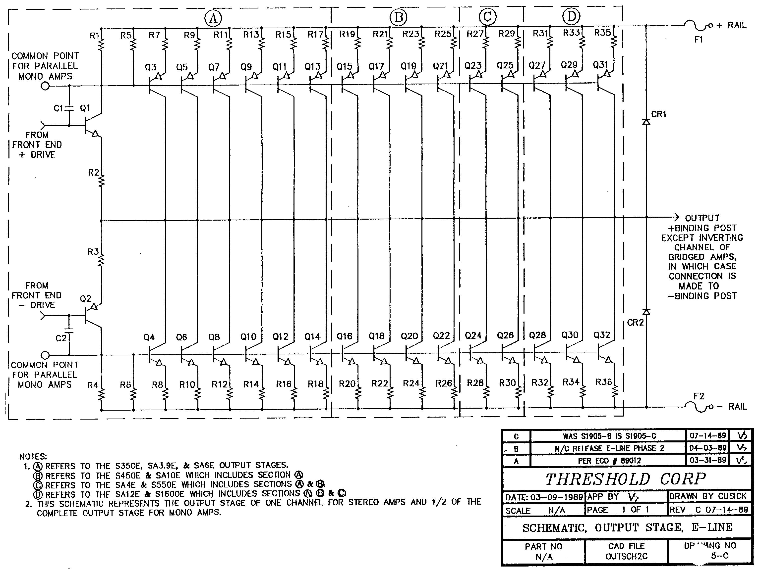

That is good news, any idea on what Threshold output you might base it on - hopefully not one of the cascoded (series) outputs. Other members who might be looking at building a classic amp might want to throw in their suggestions - I am sure ZM will, after he finishes munching on his Vegemite toast.

make a consensus about type of outputs, OS arrangement, max number of devices per channel (UMS applicable?) and I'm going to draw OS pcb for Greedy Boyz

Big UMS hole pattern, 6 pairs/PCB
If there is suitable BJT that has pinout BCE, say MJW21196G/MJW21195G, or MJL3281AG/MJL1302AG, then the same PCB could be made to use GSD Mosfet as well.. just jumper the drivers. NP mentioned he could tweak the front end a little to allow that.

It can do up to 10 pairs just install what you need/want.

So ...,. if someone wanted to drive the Apogee Scintillas 1 ohm version , which past Stasis model would be a suitable clone without getting nuked ?
Nelson did mention you would have to get Medieval about it
The SA 1 or 12 just has to many outputs to consider it unless really necessary

I agree with ZM, six pairs is ideal and I would have 45 to 50VDC rails. I will use the Sanken 2SA2223A and the 2SC6145A TO3P with BCE from left to right. Even Sanken Japan says these are their equivalents to the MJL21193 / 94 TO247 On Semi types taht Nelson likes. These Sanken's are used by D'Agostino in his huge power amp designs. I have them here already.
As advised by Nelson, I would bias the OS till heat sinks run at max of 50 deg C with lid on.
