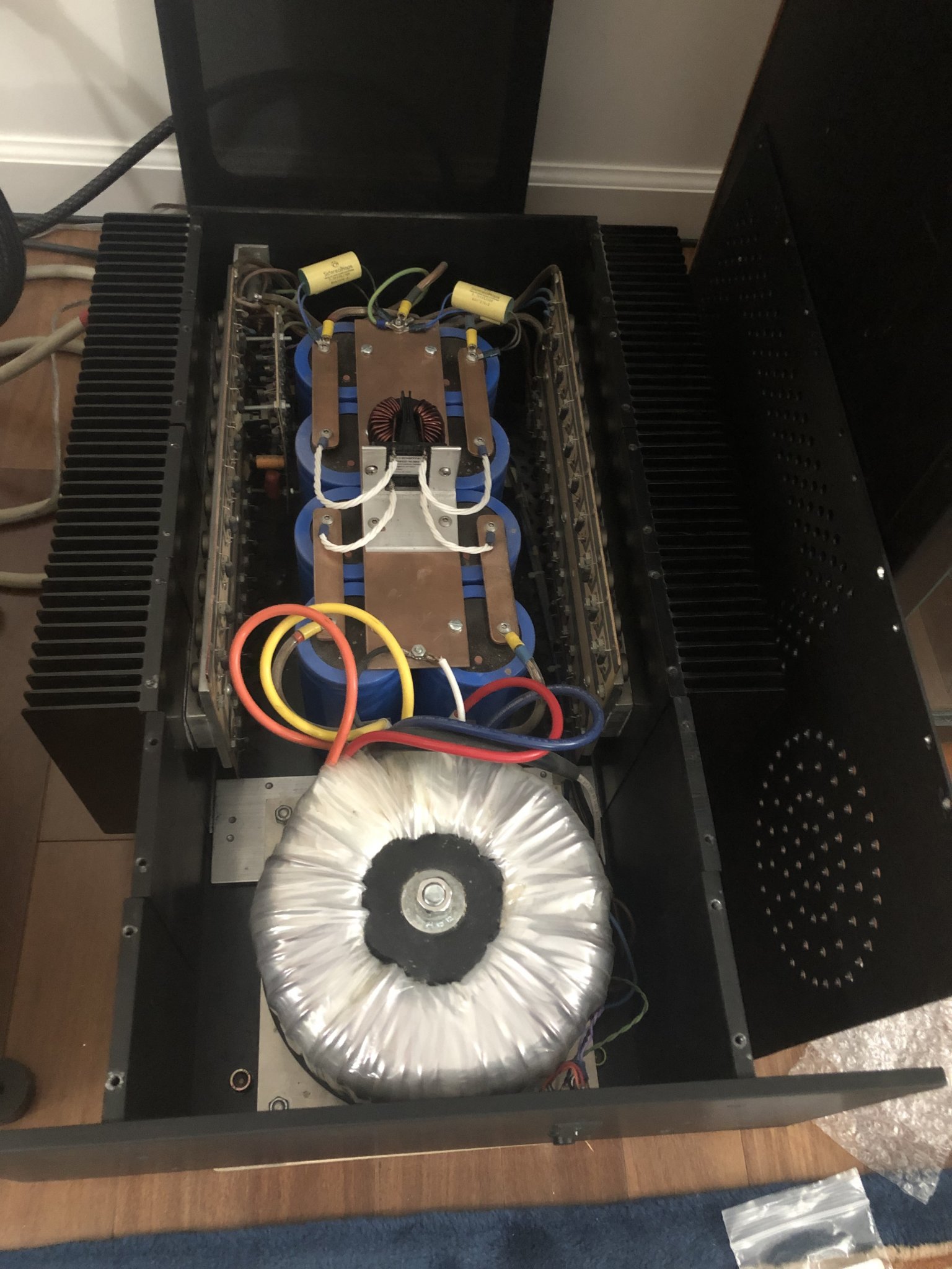

Really enjoying this now hum free amp. And the combined 408,000uF capacitance hasn't popped the slow start cct yet.

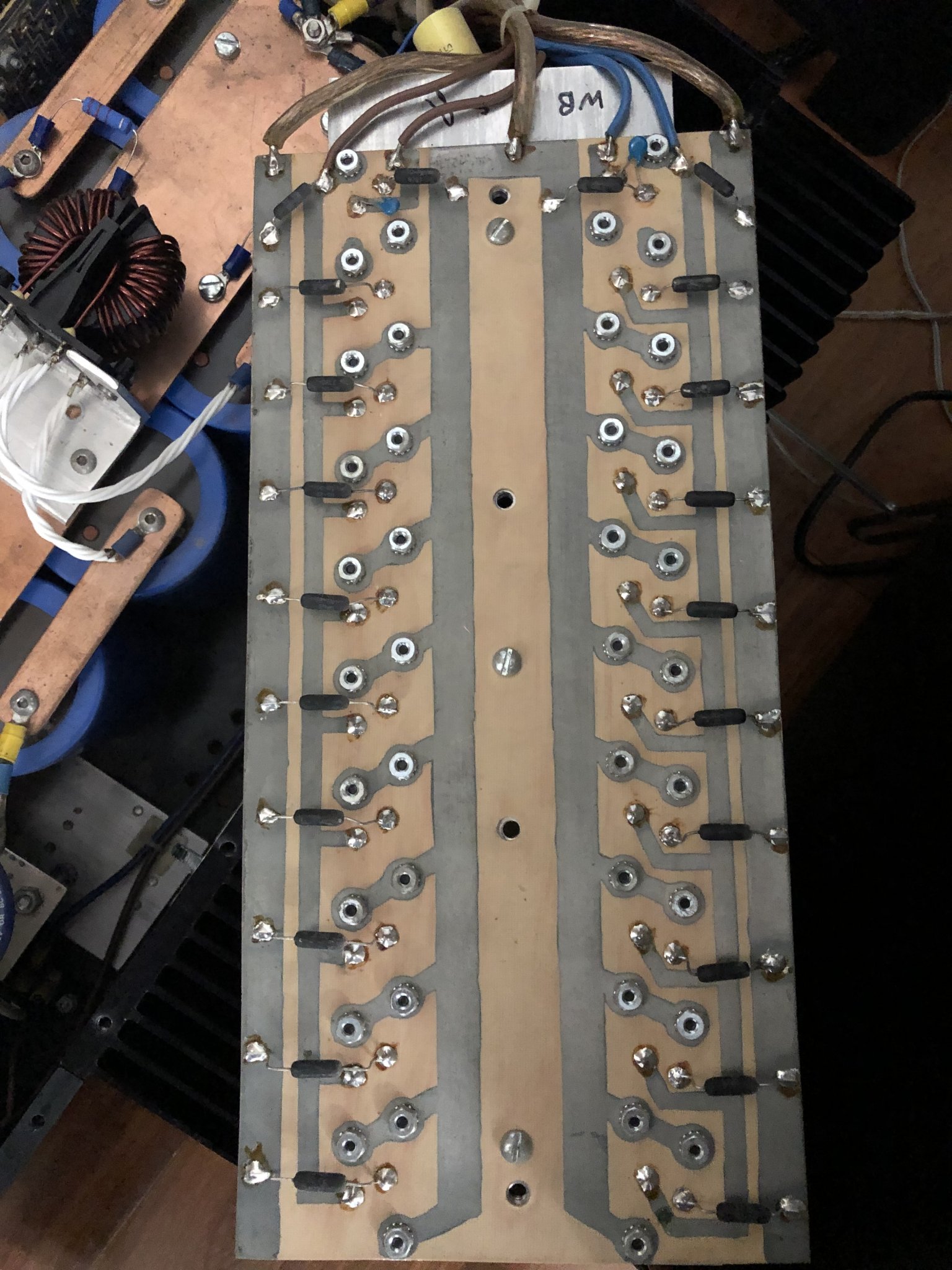

And I have been working on the CAD drawing for the TO3 transistor mounting plate and heat spreader bar so no drawings or pics yet, but they are coming.

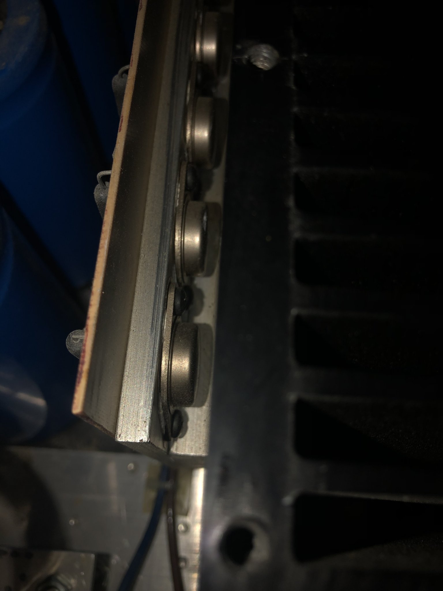

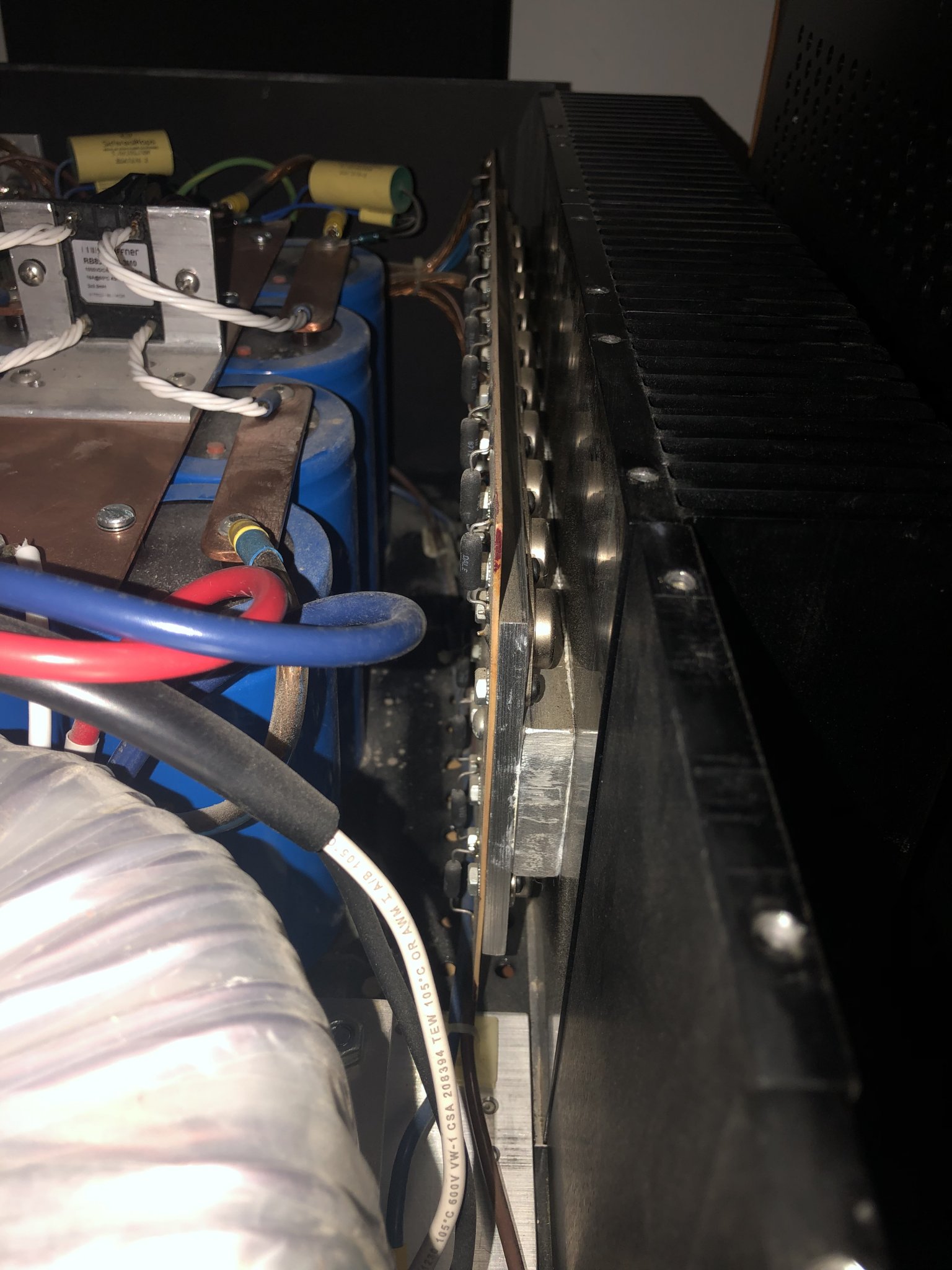

Pic of the output cans mounting plate/heatsink and heat spreader bar. Found the 1/4” thick plate is 4.5” wide.
ok, here are the .DXF files for the transistor mounting plates one for the SA/1, SA/2, and SA Mini. as well as the heatspreader bars and a pdf file to see what they look like.
For the heatspreader bars you thread the small holes with 10-24 and the larger holes with 1/4-20. Put thermal grease between the 2" heatspreader bar and the transistor mounting plate. Put nylon spacers in the larger transistor screw holes in the transistor mounting plate. Use 1/4" long by 1/4" outer diameter, 1/8" inner diameter. Then place gasket on the transistor mount plate then PCB on top of that and put 10-24 x 1/2" screws through the PCB and transistor mount plate into the heatspreader bar, making it one assembly.
Then one at a time you can mount the transistors with thermal insulators. Check that the legs of the transistor, base and emitter do not make contact with mounting plate. Then solder the legs and mount the emitter resistors and other components.
I need to take a couple more pictures to make this clearer.
