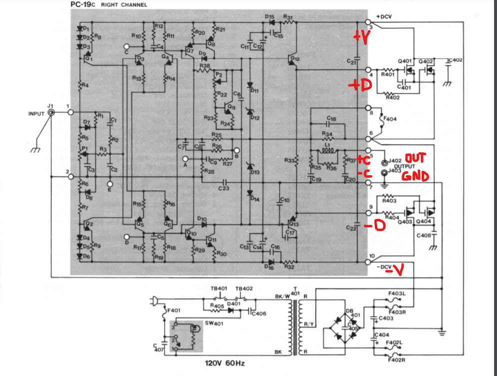

I found the Hafler DH220 schematic online. I copied it and attached it.
I'm referencing Papa's FE board, since it has +C and -C connections, which I think I need for the Hafler. (Guessing the ZM FE board would be adaptable also, but I don't see the obvious connection points.) I've written in red, where I think the connections from the DH220 would connect with Papa's FE.
I'd appreciate it if someone would check my connections and let me know if I am on the right track. Thanks.

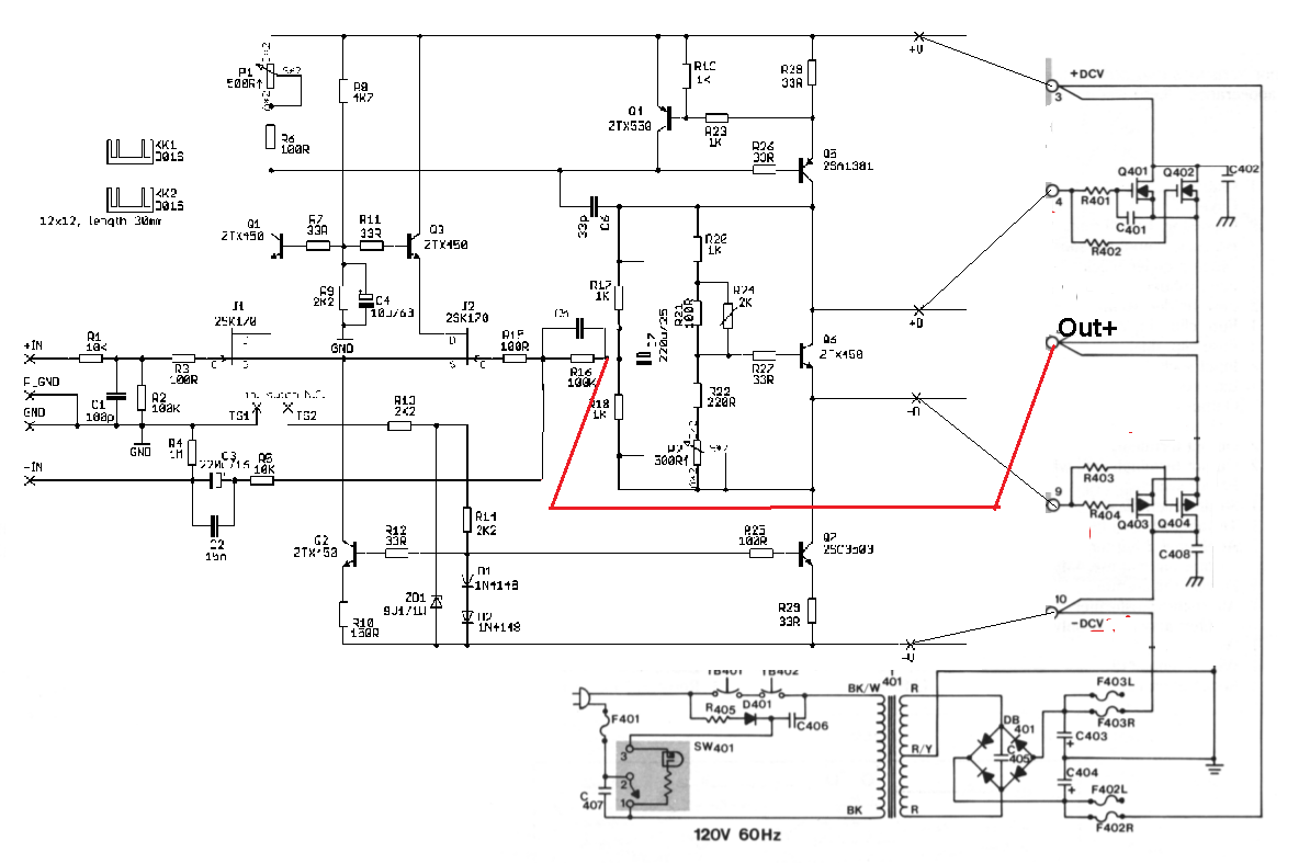

easier is to dissmantle everything but mosfets on heatsinks and abandon all Hafler nomenclature, than the other way
anyway, if it's easier for you to think that way. here it is
observe NFB edit
edit:replaced pic, had error with NFB, now good

It is a good idea to briefly remove the power Mosfets from your DH-220, clean off the dried thermal paste, apply fresh thermal paste to the mica and Mosfet case and re-install the devices. Hopefully it goes without saying that the old 10,000 uF power caps also need to be replaced. There is plenty of room inside the chassis for two sets of 18,000 uF, 80V electrolytics in their place.
observe NFB edit
Thanks, ZM. It's clear now from your posted schematic. I'll build the boards, try it out and post some pics here. Let's see if we can get one old Hafler off the rack in the garage and back in service.
TA- the amp has fairly recent filter caps. I'll check them to make sure they're still within spec. I'll update the Hitachii? with some new thermal paste, too.
Thanks to all for the support!

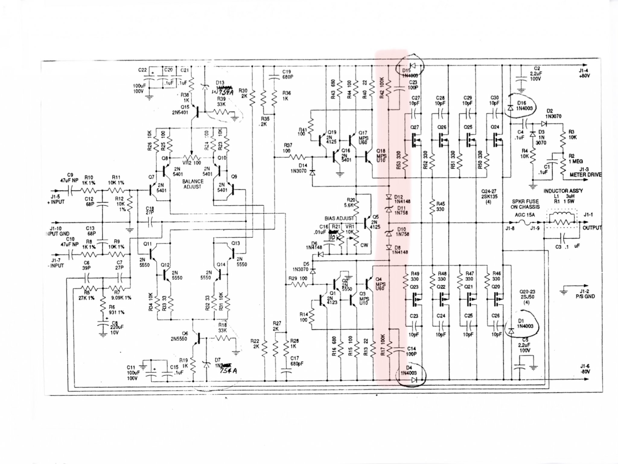

O Mighty Not So Dodo, would you be able to give similar advice for the attached schematic? I have two of these amps. One got banged up in shipping (back panel damage) and is begging for extensive tweaking. I’m assuming somewhere in the highlighted section in the attached are the points for stasis FE…
