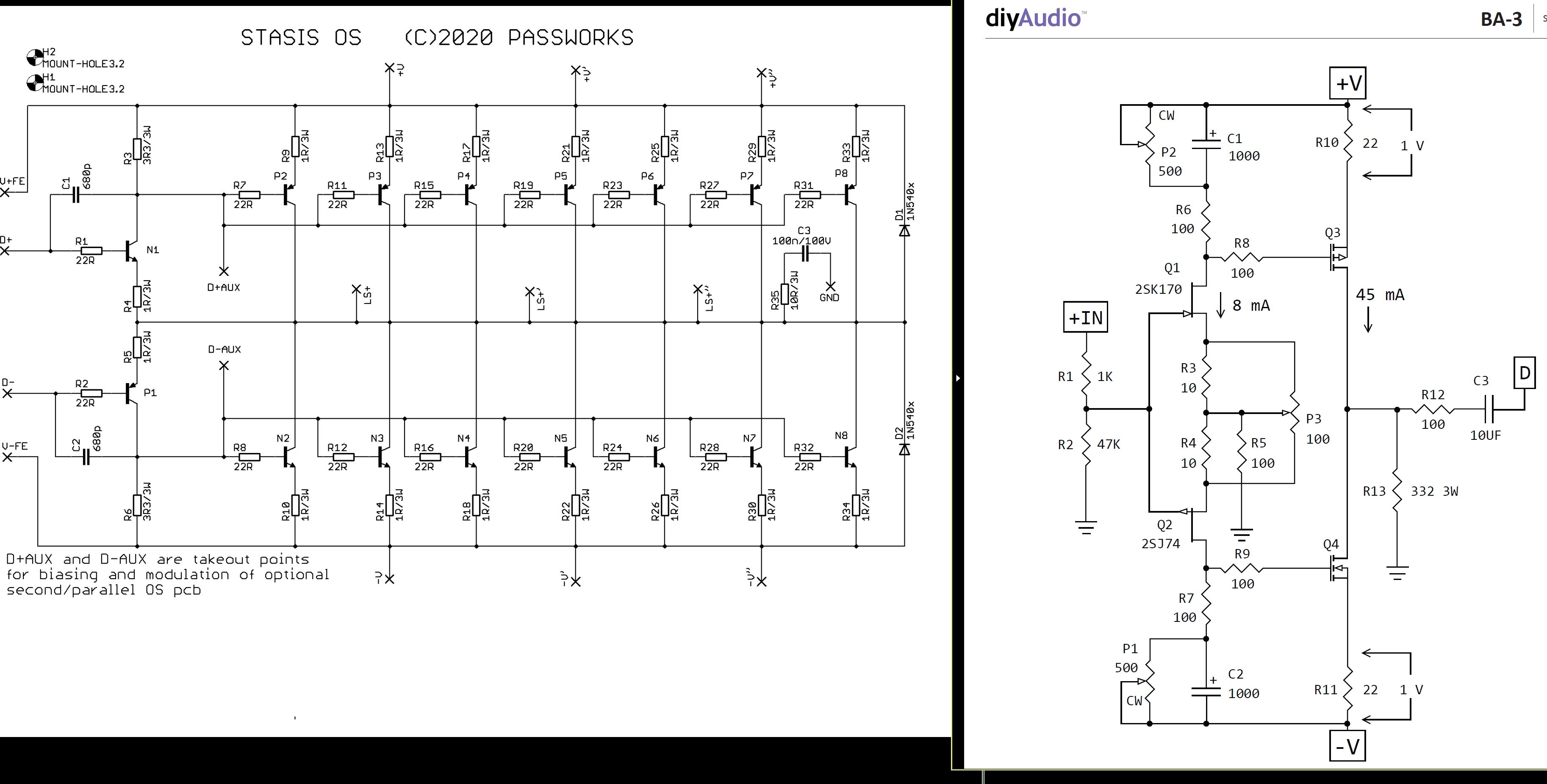

Transform BA3 to Stasis?
Forgive me is this obvious to most people.
It occurs to me that if, in the BA3 preamp, you connect R5 to output instead of being connected to ground, you now have a stasis BA3 preamp. Maybe R5 becomes smaller, maybe zero ohms.
practically - BA3 FE is, well, FE;
while Stasis FE is FE with bias generator for OS
Stasis catch is in OS, so - pretty much any sort of FE is appropriate, as long bias generator is there
not counting on fact that you'll need to alter value of that resistor, accordingly, to include it in NFB loop, instead of acting as local degeneration thingie

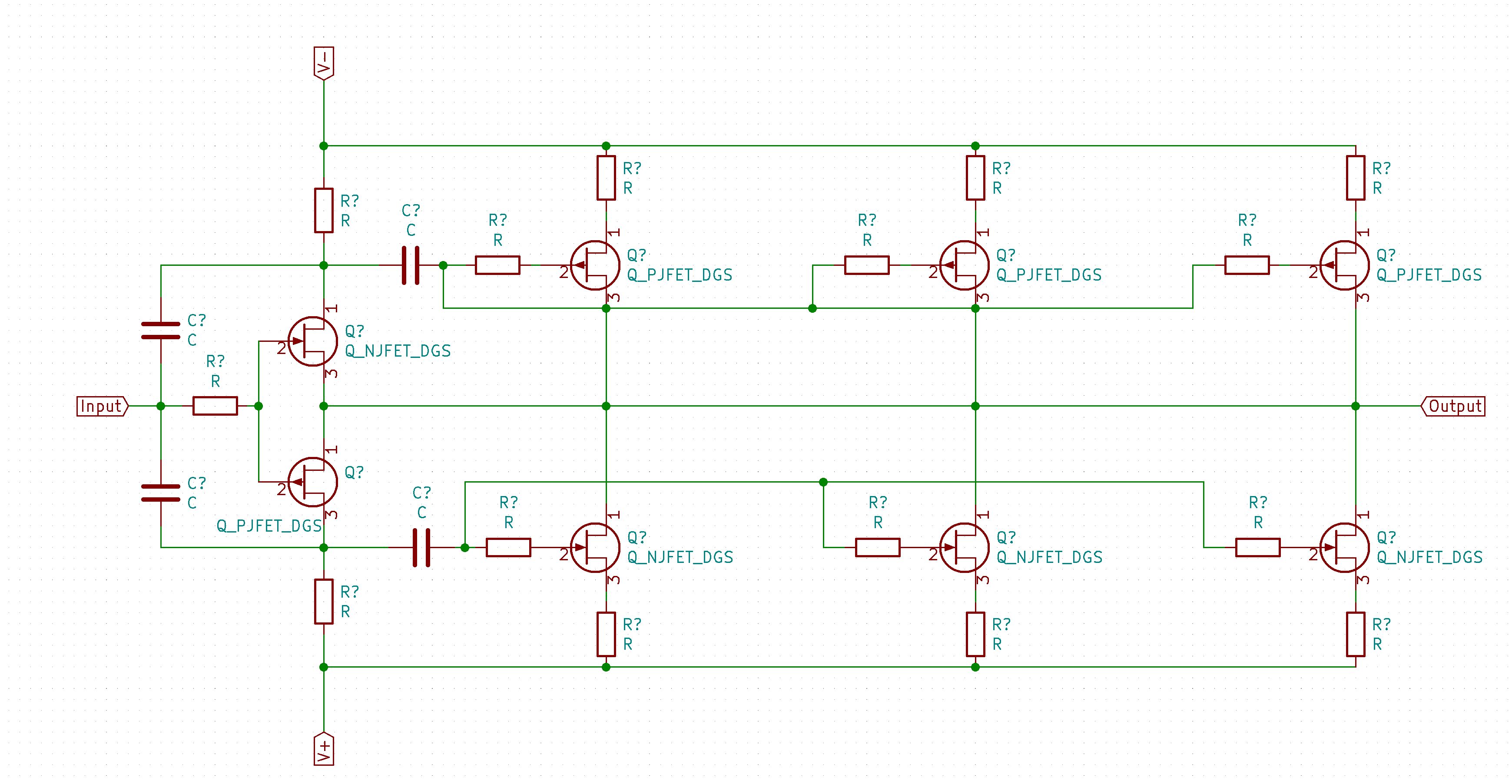

The idea would be to create a new stasis OS topology with the devices in BA3 preamp. Just a mental exercise to see if I understand the stasis OS.
It looks to me that the stasis OS is unity voltage gain with very large current gain. 100% local voltage degeneration in the OS using what looks like "current feedback".
The next idea is how to make a stasis OS using 1000 JFETs. I think a blocking capacitor is needed for each cell because the JFETs are self-biased.

Here is what I am thinking for stasis JFET beast. This drawing is 3 cells representing hundreds or thousands.
I'm sure this will earn me an immediate and well deserved excommunication. 🙂🙂🙂

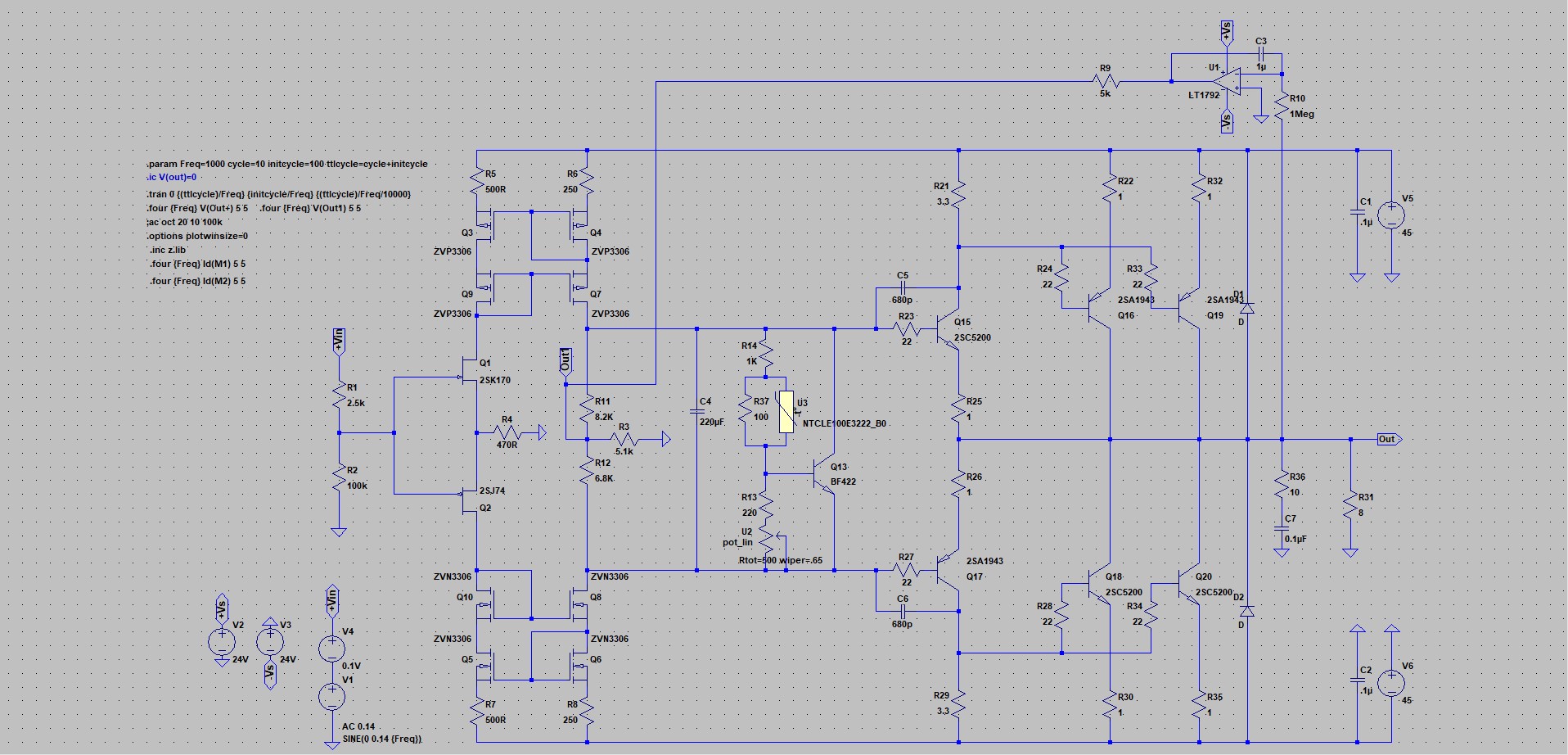

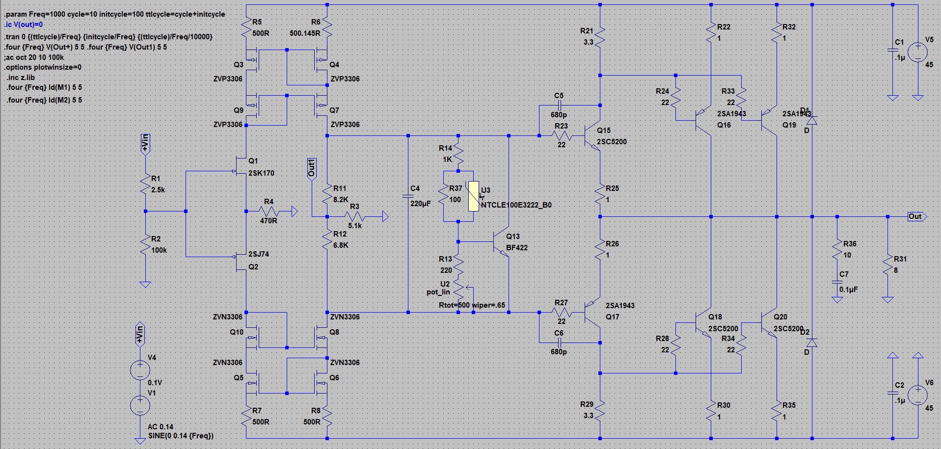

EUVL's UTHAiM FE with the Stasis OS: it sims OK.
I would like little more current from FE at disposal
So, I would change that, in some way
yup, just solve half of those question marks, and you're good
I will be grateful 🙂
Re: schematic in post #597
Since your push pull output drivers have their gates AC coupled to the input stage, you'll need some sort of a biasing circuit to set the DC value of the gate voltage. Look at the NJFET at bottom right: its gate is completely floating and has no DC path to either supply rail.
You might even decide to build two biasing circuits. One to establish the correct DC bias current flowing in the upper half, and another "DC servo" to establish whatever DC bias current is needed in the lower half, to make the output offset voltage become zero millivolts.

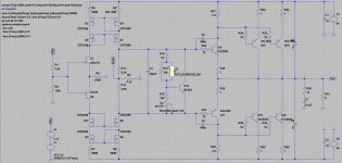

Good eye: it was running at about 7mA. Now it's at about 17mA, and I added back the DC servo because the offset is a bit high. I sort of like this Frankie 🙂
- New Stasis front end
