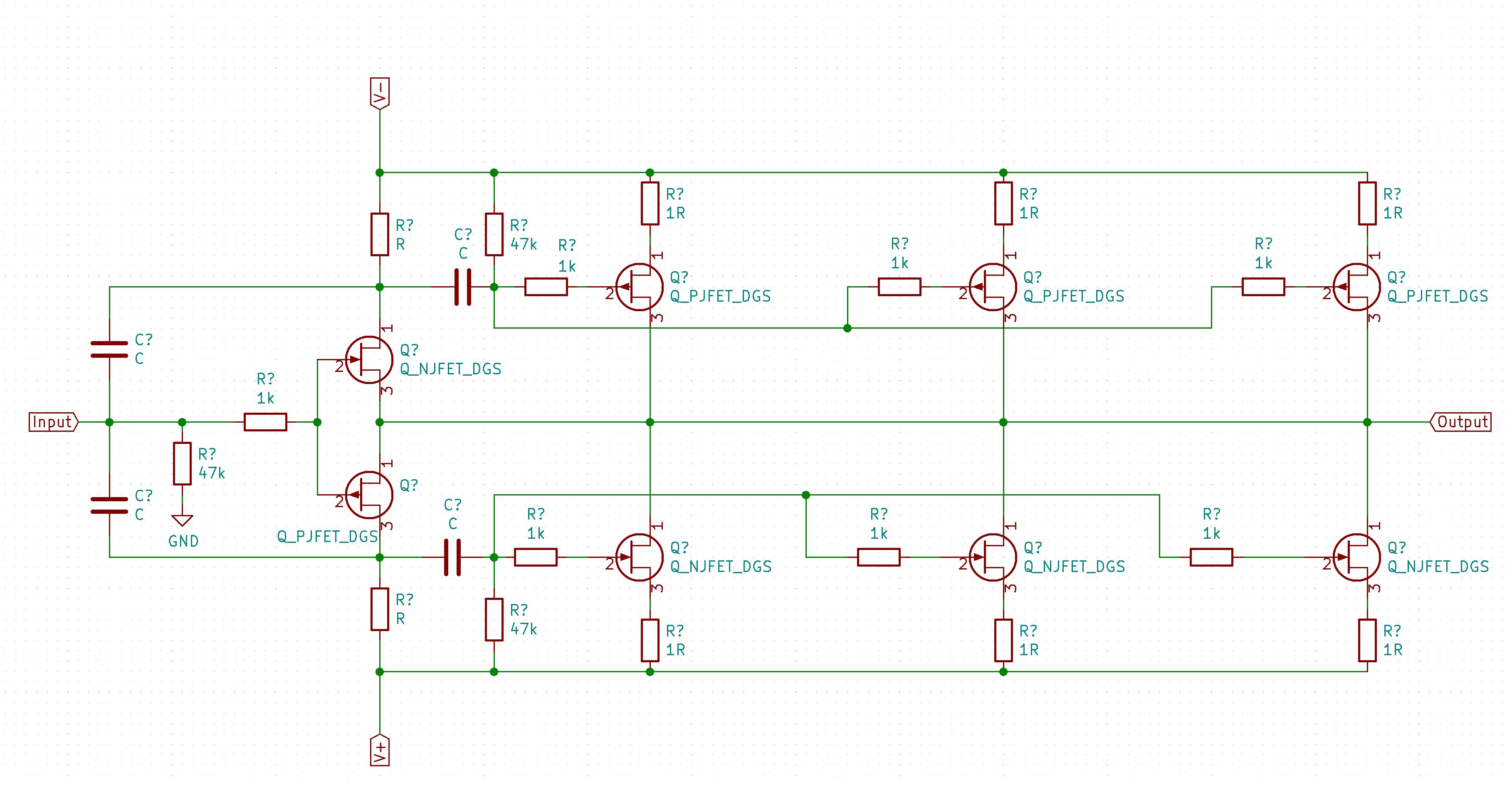

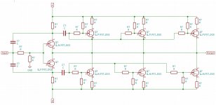

Re: schematic in post #597
Since your push pull output drivers have their gates AC coupled to the input stage, you'll need some sort of a biasing circuit to set the DC value of the gate voltage. Look at the NJFET at bottom right: its gate is completely floating and has no DC path to either supply rail.
You might even decide to build two biasing circuits. One to establish the correct DC bias current flowing in the upper half, and another "DC servo" to establish whatever DC bias current is needed in the lower half, to make the output offset voltage become zero millivolts.
Hello Mark. Thank you for your feedback. The initial idea is to use the JFETs at Idss (or as close to as possible and select the groups for a close match. The JFETs that I have in hand have Idss grouping in the neighborhood between 5:4 and 6:4. The PBC may be populated in that ratio with some not populated to balance output offset voltage.
Thank you for pointing out the floating nodes. I have added the gate reference resistors.

Thank you for the help. Here are the corrections. The input ref resistor can be non-populated if the builder wishes.
I will see how many of these can fit on a 100mm x 100mm PCB and build one. The resistor values can be played with to see what works.
...too expensive in terms of voltage: the double MOS current mirror is using up too much of it...
Swap the mirror FET's for BJT's (BC327/337-40) and use 100R & 50R emitter resistors.
I'd also move the feedback to the top end of R4.
45V is too high for the JFET's, you'll need to cascode them.

Skip that, wrong phase, I was thinking of my own amp - it has a source follower output, not the common source used in the Stasis 😱
Thx for the hints.

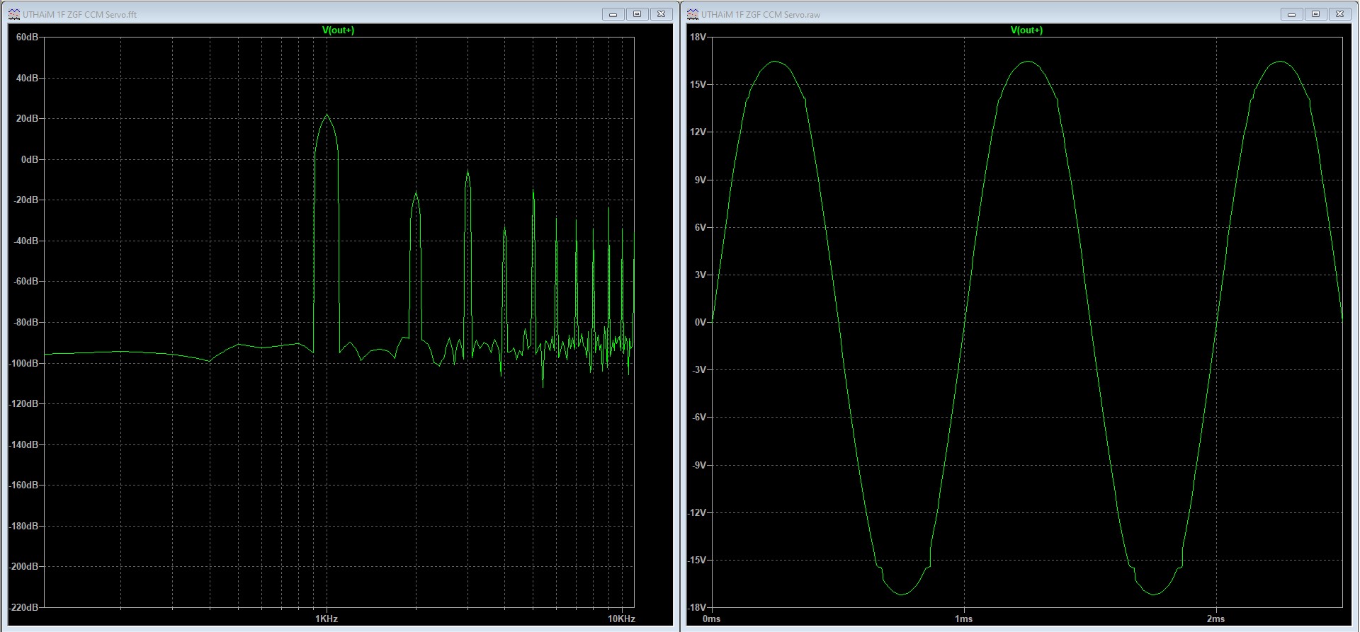

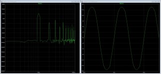

I pick the UTHAiM on a whim, but I don't feel comfy with this topology: the original UTHAiM fed with +/- 24V starts clipping at about 16V peak, with all harmonics present.
Maybe I'll explore the F5 as a FE, or even something more buildable like the MP150/Goldmund FE, we'll see. No offence, but I don't like the BA3.
