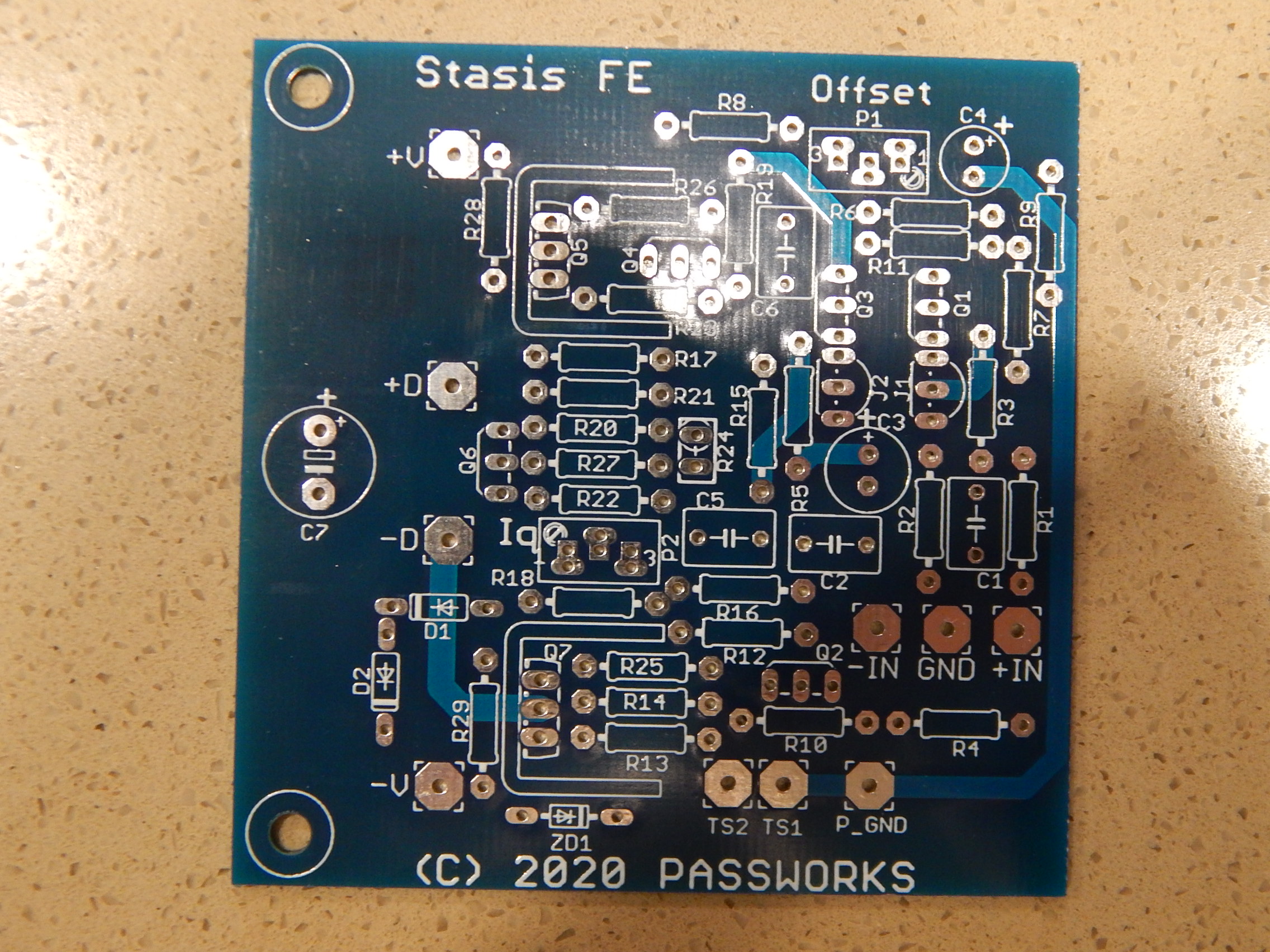

I’m a little green when it comes to bridging two channels so i have a few question.
Ill be using two 6 deep OS boards on each side of the chassis using Zen Mods Susy FE which will require Monoblocks
1) I’m assuming ill need two FE boards, one for each side?
2) How does the input work regarding positive and negative using two front ends (if 1 is correct)? Does one side get a positive and the other negative?
3) Speaking of input, can i use a RCA and XLR wired like an Aleph J and jumper XLR when using RCA only?
4) Will i need (1) set of binding posts or (2) sets of binding posts per chassis?
5) How will the wiring for the output speaker terminals be done?
Thanks for any insight

1) 1pc SUSY FE pcb per channel, 2 OS pcbs per channel (as minimum - you can double them, if you want more outputs )
2) explained in 1); FE pcb fed with balanced signal, normally, or SE , with shortie between 1 & 3 XLR pins
3) yes
4) positive 1pc, negative 1pc
5) positive signal carying OS pcb output wires goes to pos term. , negative pcb..... to negative term.
you are not ready to make SUSY iteration; read my disclaimer in post where I posted all files for SUSY FE
wait that some more experienced Greedy Boy confirm functionality and bring possible necessary changes to it

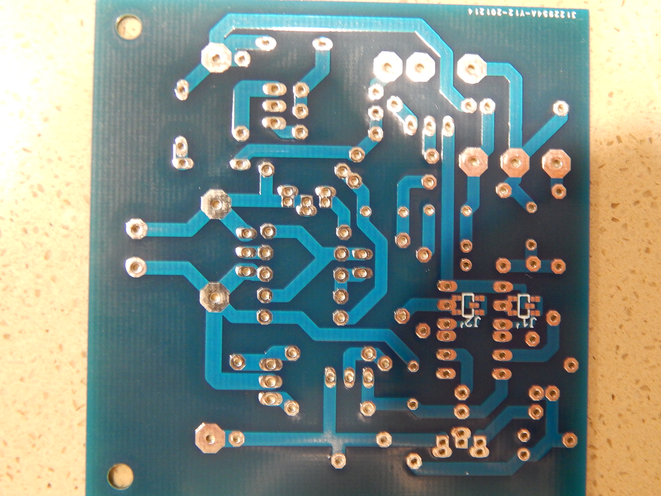

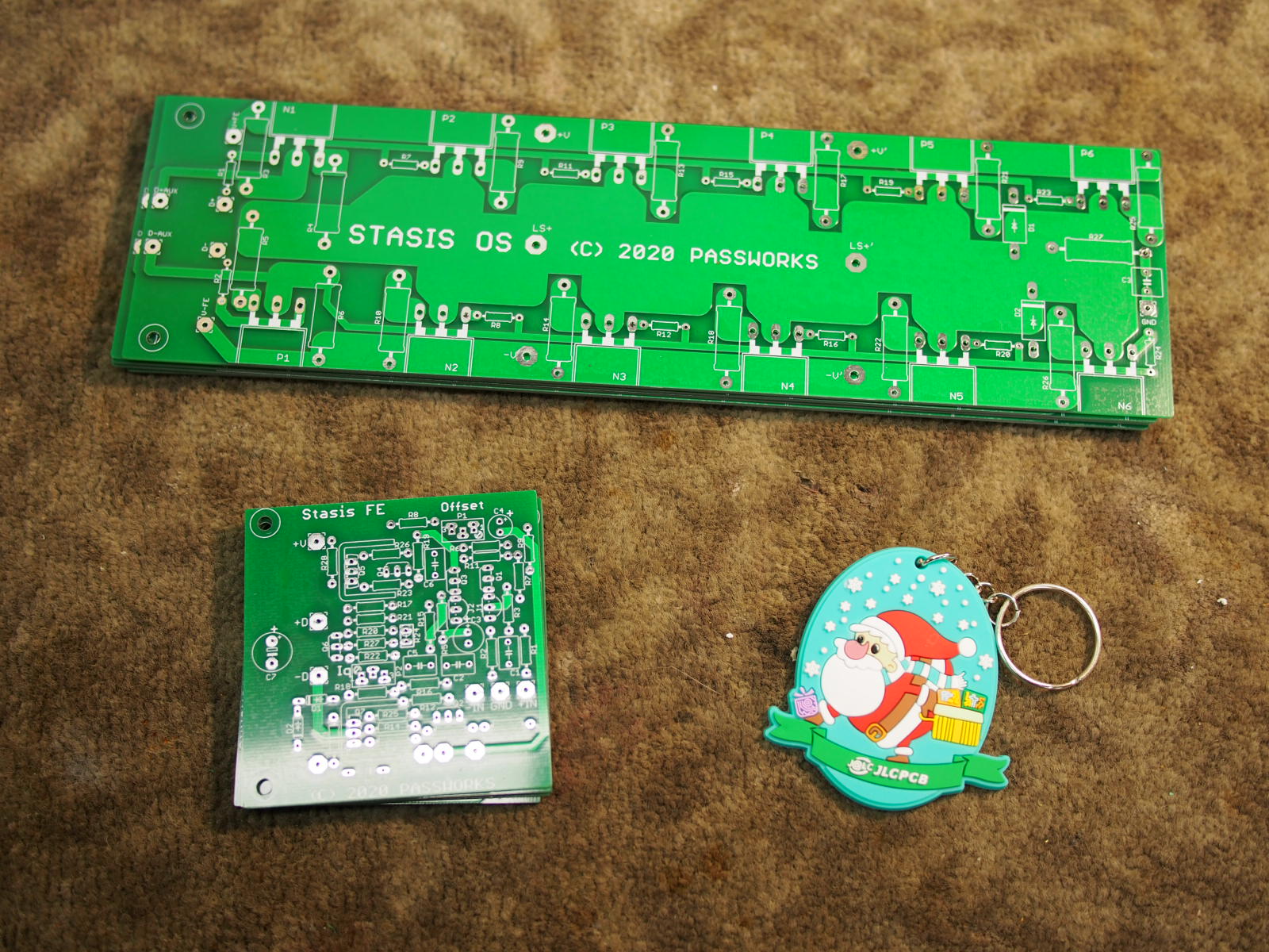

I just received my PCBs from JLCPCB. Thanks for the tip to try them. They are faster and less expensive than OSHPark.
Plus I received a Santa Claus key chain with my order - don't be jealous...
other side, pretty please

Cool thanks for the clarification
And no worries I’m not in a rush just trying to game plan so I can buy the proper parts and get my chassis done right
