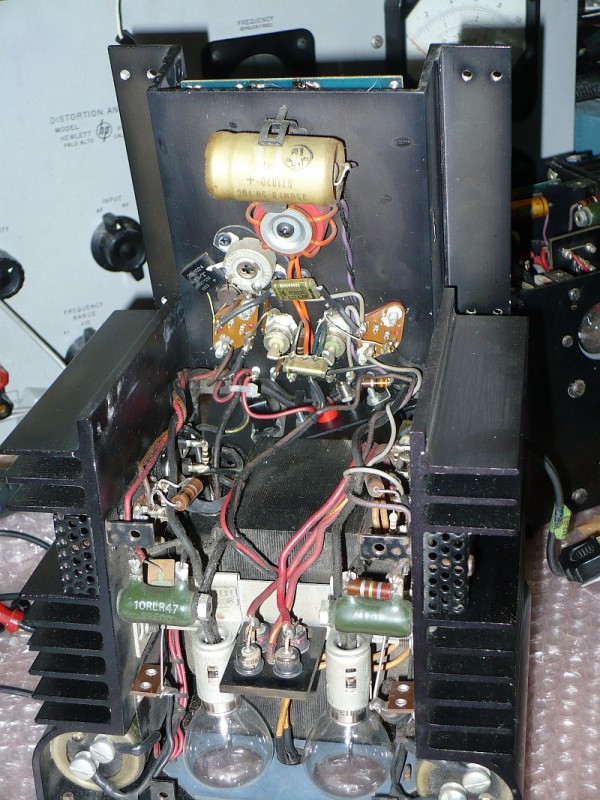

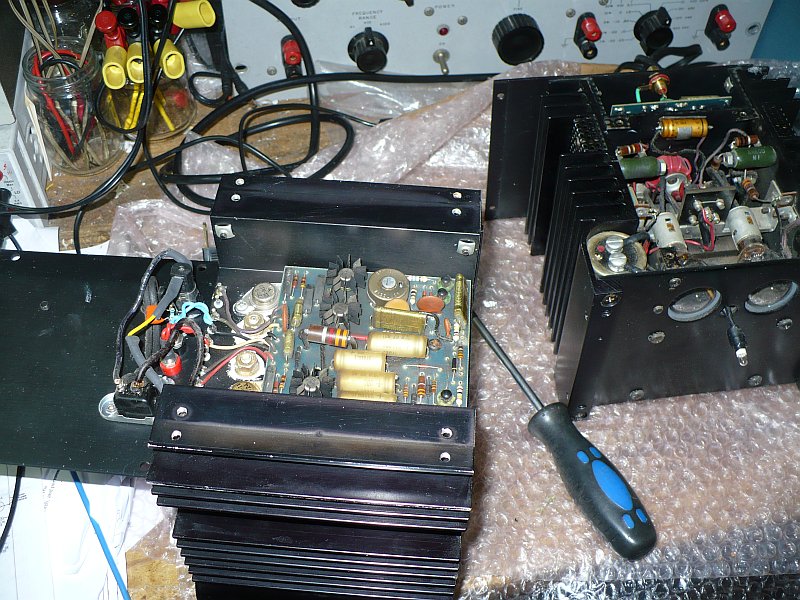

  • The picture I posted is from a Japanese site, my own unit has a lot more wear, and so it looks more "authentic" 🙂
  • This project is #5 in my backlog, so don't hold your breath, ETA is late 2021

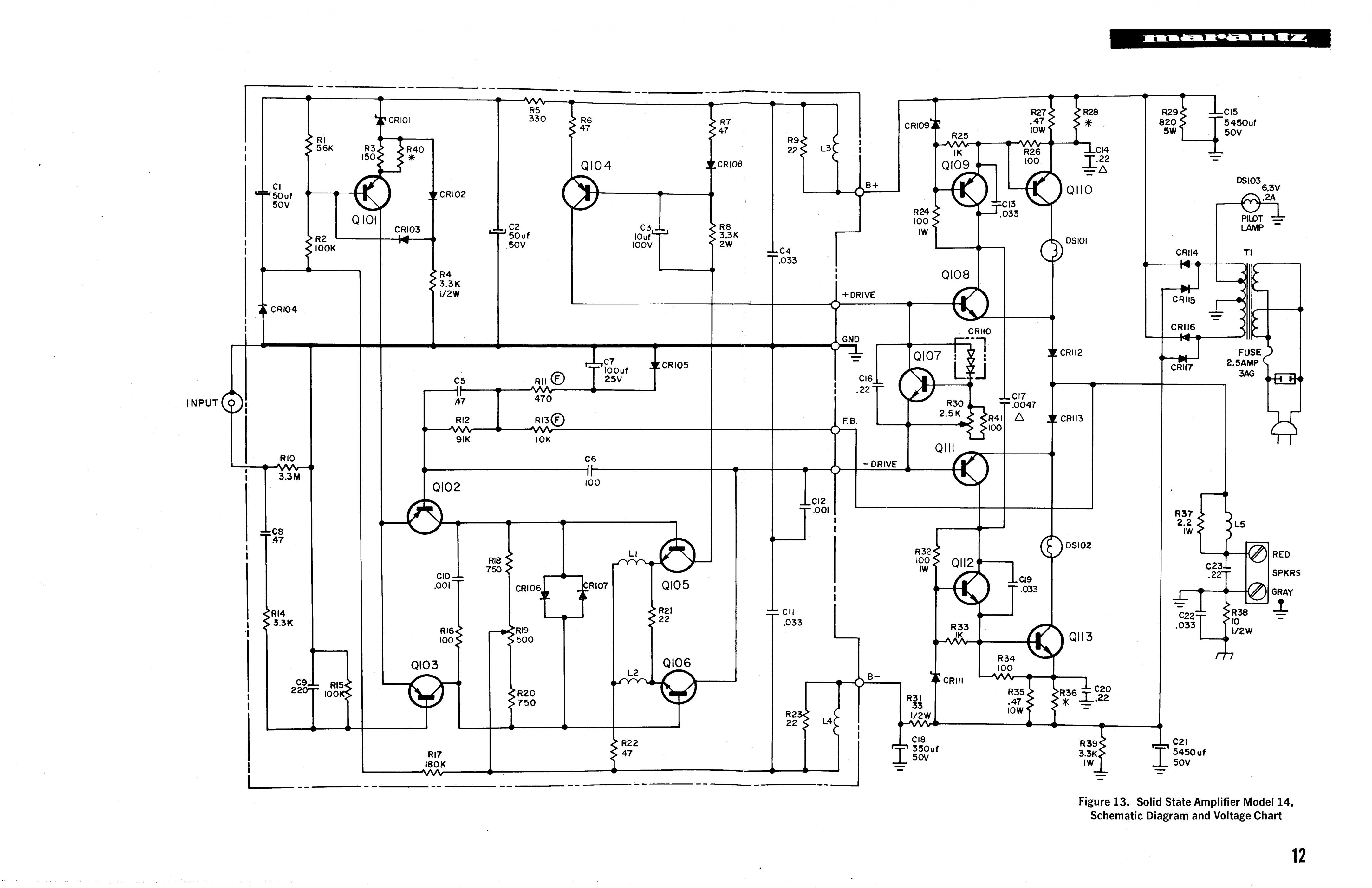

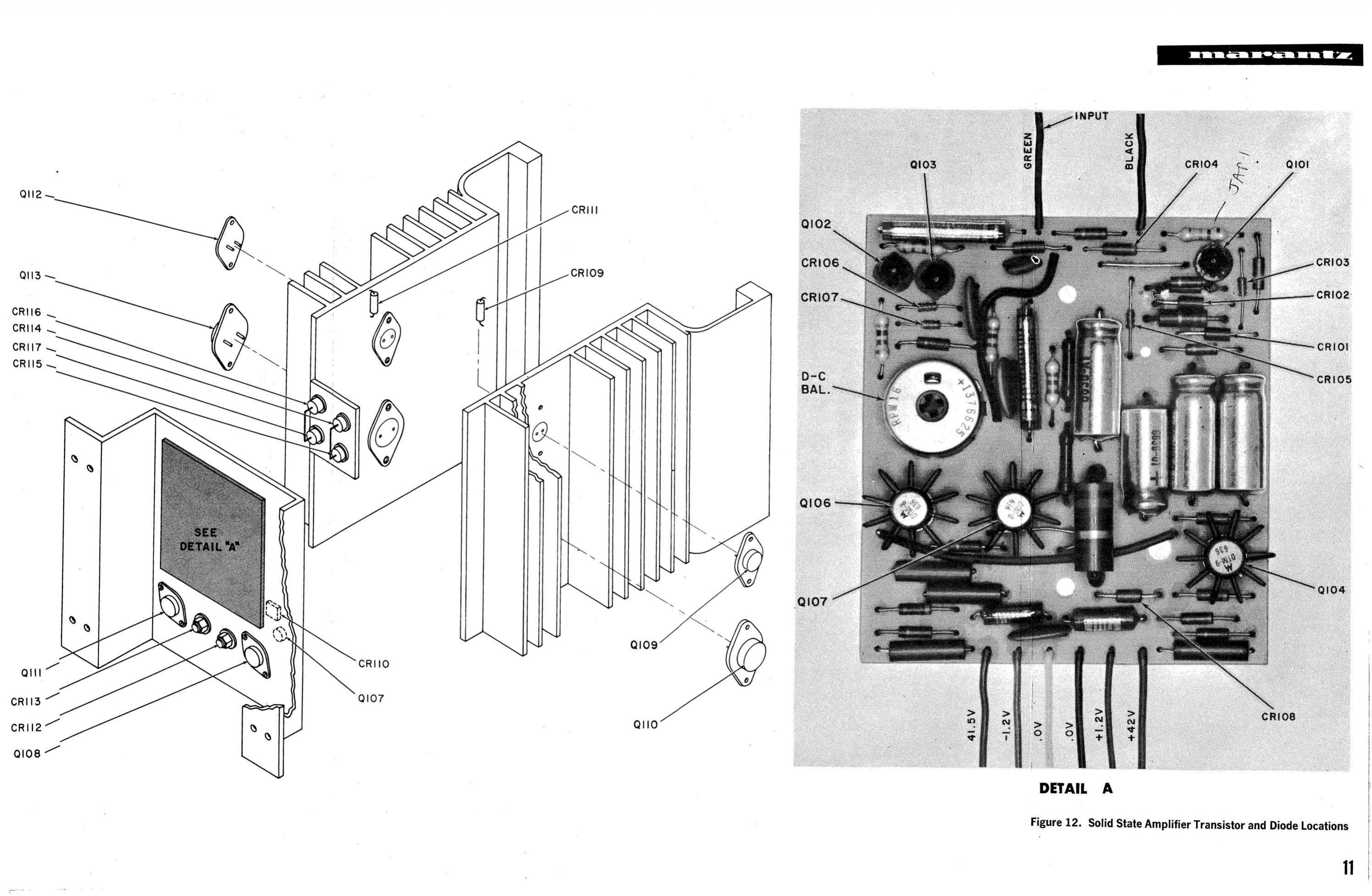

And a brief history: this amp was designed by Sydney Smith in the mid-60's, at about the same time Marantz, the company, was sold to Superscope, and as Marantz's first attempt at the raising thread of the solid state stuff. I guess Syd had to be extra careful designing a successor to the famed Model 8 & 9, and he nearly got it right the first time, given the constraints of that era: diff-in, diff-VAS, and complementary out (where did he get the PNP power silicon in 1965?).
I blew it twice, and I've been thinking about a fix for some years:
  • Put it back to the original state? Given its current state, the resale value must be low, and it didn't sound very good by today's standard
  • Transplanting a more contemporary "brain" into the body? Which one? The New Stasis is the perfect candidate for a lesson in history: AMYAT (American Masters, Yesterday and Today) 🙂
Attached are the original schematic, the mechanical drawing, and some more pic's from the Web.
