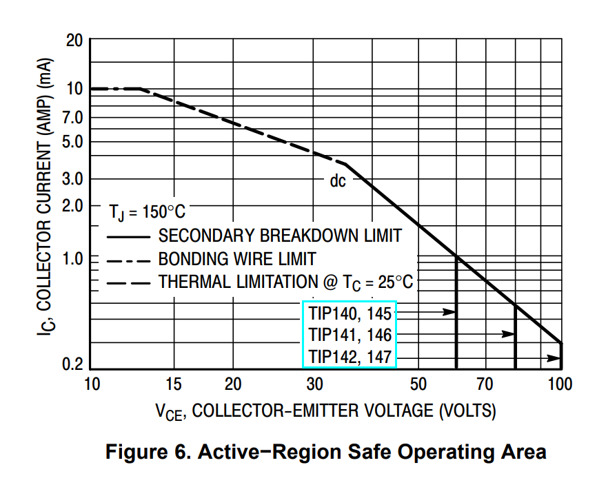

Make sure the pass device(s) can take the steady state load... This is going to have a lot of bias current.

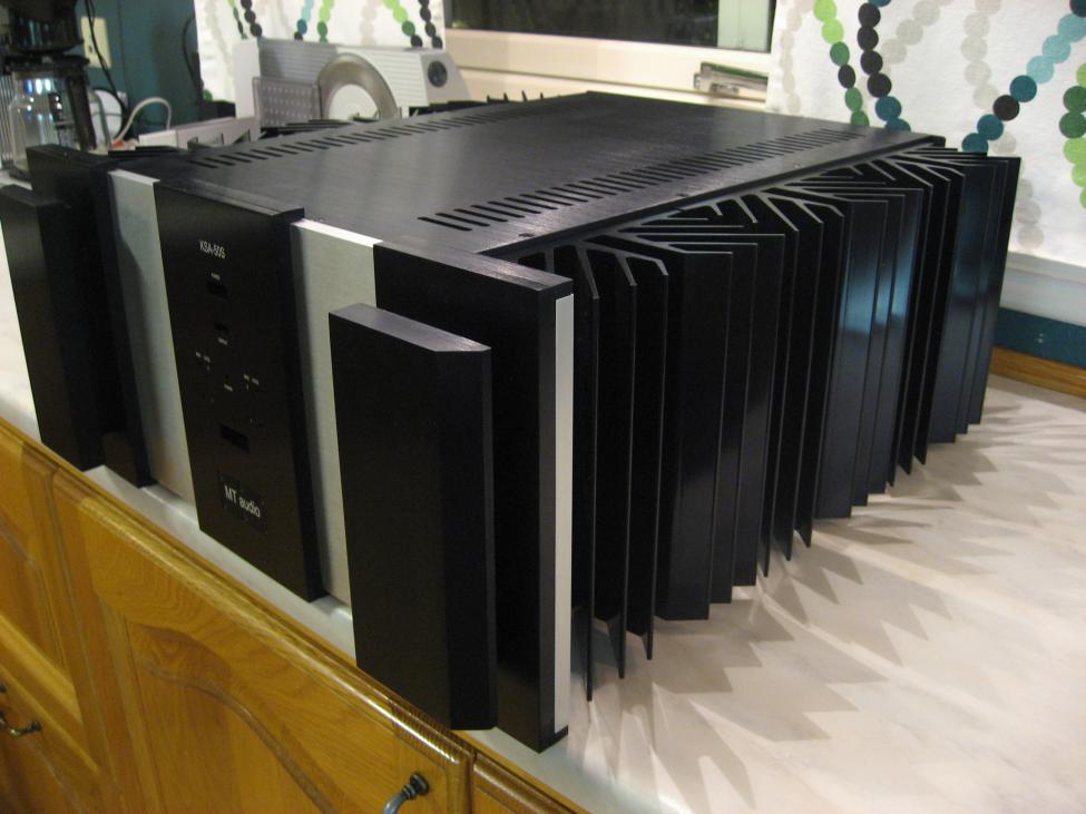

I will use this chassis for my Stasis amplifier:
It is a mix of a XA160 chassies with a Krell front.
(It has been lying here for a few years now, time to put it to use )
How far can I go, regarding heath dissapation ?
I mean, how many output devices, rail voltage etc.

300 watts per channel, into a 4 ohm load, requires 12 amps of supply current per channel. If it comes from a capacitance multiplier, I recommend 2 pass transistors in parallel (with ballast resistors!) per channel. Now it's "only" 6 amps per pass transistor, which is well within the safe operating area of many high power devices that DIYers might select.
VCE = 3V , ICE = 6A
VCE = 3V , ICE = 6A
