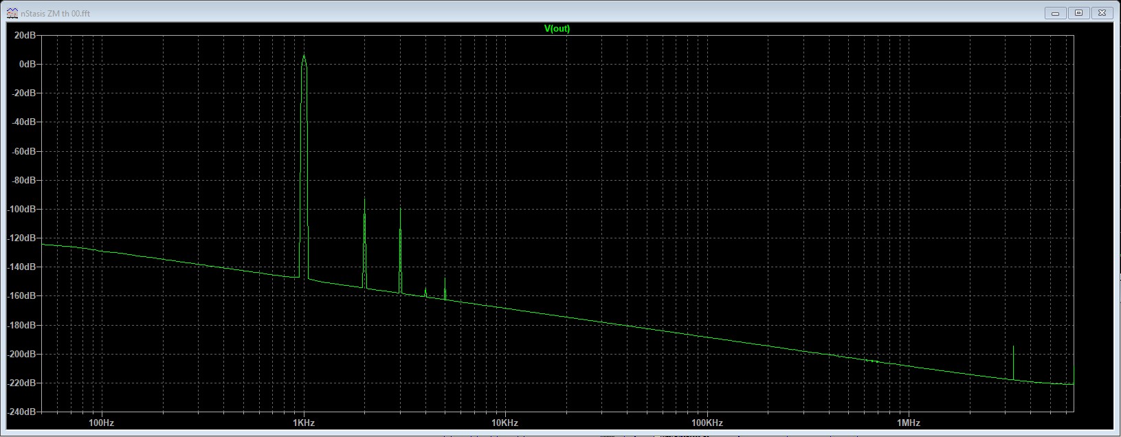

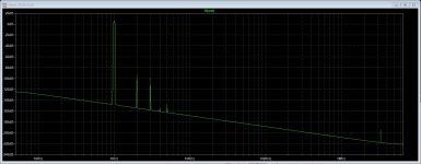

Here's a simulation of the complete amp with 2 output devices: 0.0026% THD at 1W out.
You may want to put the .asy file in the symbol directory of your LTspice installation.
