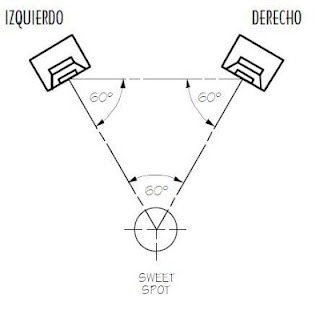

I think since the OP can't change the room, it raises some questions.
Is it a dedicated or shared room for other purposes?
I ask this because with the dimensions you have given us, it seems that you have not found an optimal listening position (yes, the famous sweet spot)
You need to move the speakers forward.
Also your chair ahead and point the speakers at a point in front of your feet.
It is the sweet spot recommended by people in the career of Lynn Olson. It is a more closed angle than the one commonly recommended - as you can see in the attached brochure -.
Other experts ( vade retro , jaddy 😒 ) in studio recordings advise that the SS should be behind the head of the operator-listener.
I think it's worth experimenting with that before embarking on ships with no pre-set courses. Adrift, they say.
" I recommend placing the ME2's at the tips of an equilateral triangle with your listening position at the bottom of the triangle. Aim them at a point about 1 foot in front of you, with the tweeters on the inside of the stereo pair. You should be able to see just a little of the side of the cabinet that has the large radius.
Next, adjust the height of the stand so the centerline of the tweeter is between 38" and 40" high. If the tweeter is below ear level, the stability and overall size of the stereo image will be degraded, so adjust the height so the tweeter is at or a few inches above ear level. (Many compact speakers that "sound bad" can be cured simply by elevating the tweeter to ear level! This is a psychoacoustic effect that doesn't appear in any measurement.) "

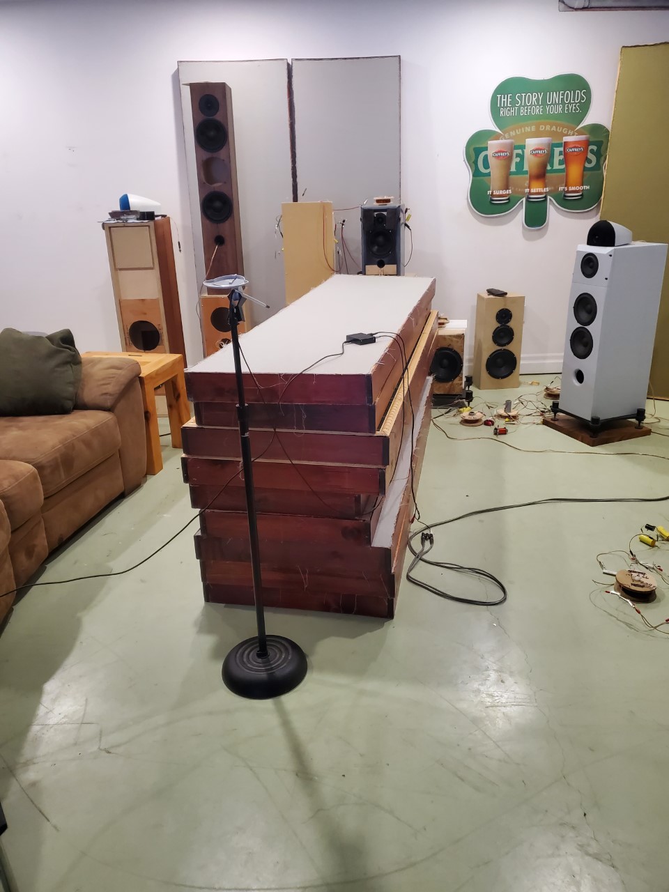

Earl geddes uses a futon mattress covered with one of those shag rugs from ikea. That has to be 4-5 inches of absorption alone (depending on the damping coefficient of the material).Floor Bounce(deep notch between 120 - 180hz aprox, created from speaker height and listening distance) is difficult to reduce, and how audible is it anyway.
Reducing the notch requires a lot of absorption. Minimal absorption will make the notch deeper before it starts to decrease with more absorption.
Through much examination with measurements, and including information from AES, I've decided to ignore it! Thick shag type carpet I do want for higher frequency absorption.
Sounds cozy! Improves sound at listening position I'm sure.Earl geddes uses a futon mattress covered with one of those shag rugs from ikea. That has to be 4-5 inches of absorption alone (depending on the damping coefficient of the material).
This is the amount of absorption required to reduce the notch significantly.

It takes around 4"-8" of thickness in damping material (arguably more) to actually make a real dent in the frequencies that floor bounce usually affects.As I already posted previously, that's my plan. No cost at all. Just need to find the time to get into my shop and do it.
Also, not worried about floor bounce with extremely thick carpet, over an equally thick pad, over a second story wooden floor. It's about as sound dead floor as you can imagine.
https://www.jochenschulz.me/en/blog/rockwool-glasswool-hemp-best-absorber-material
That really seems like overkill... Were you just trying to create a pseudo-ground plane? Even 12" of fiberglass should pretty much annihilate the floor bounce unless the dip (and band there-around) was at very very low frequency for some reason.This is the amount of absorption required to reduce the notch significantly.
