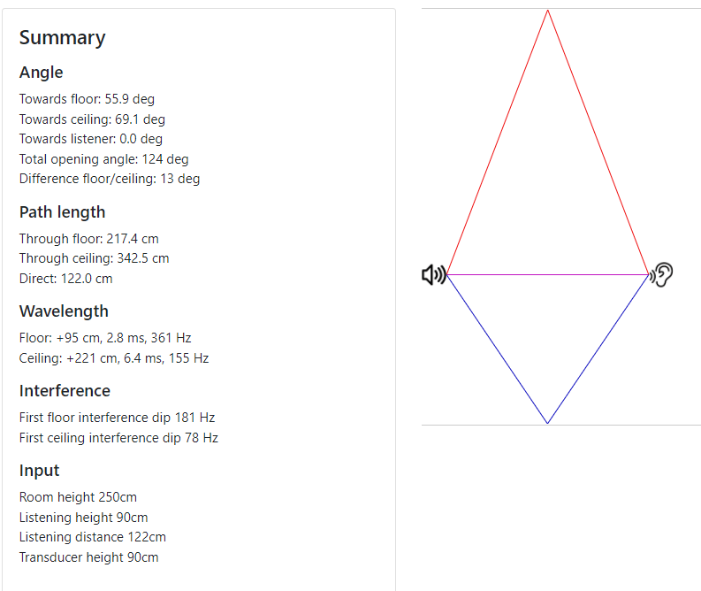

Floor Bounce(deep notch between 120 - 180hz aprox, created from speaker height and listening distance) is difficult to reduce, and how audible is it anyway.
Reducing the notch requires a lot of absorption. Minimal absorption will make the notch deeper before it starts to decrease with more absorption.
Through much examination with measurements, and including information from AES, I've decided to ignore it! Thick shag type carpet I do want for higher frequency absorption.

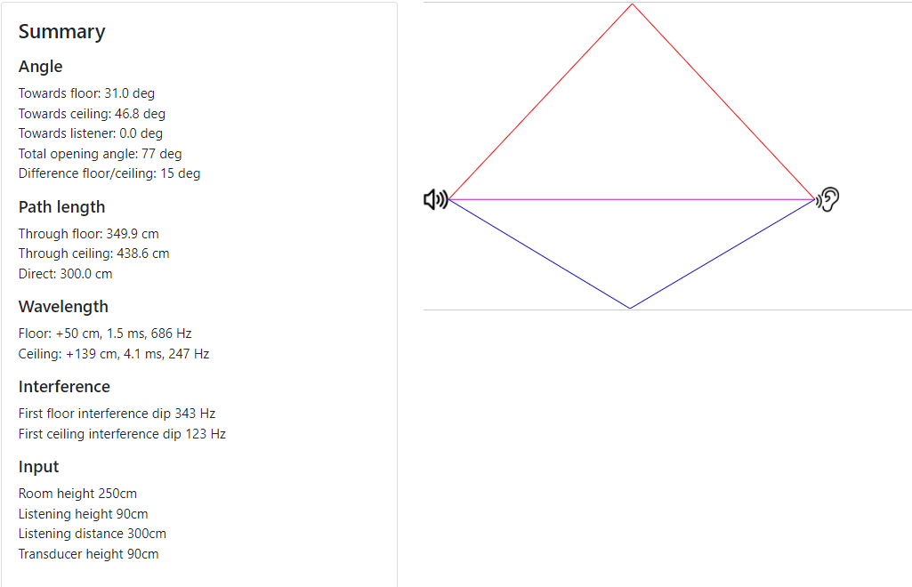

I'll expand on this that path length difference through ceiling or wall behind the speakers can easily be double and more of the floor creating dip(s) lower in frequency than the floor bounce. Most of the time, unless speaker is close to sidewall, the floor reflection is the first one that arrives after direct sound, shortest path length difference, highest onset frequency of resulting comb filter.
Cancel/null happens when reflected sound has 1/2 wavelength longer path length than direct sound. If listening and speaker height is ~90cm and listening distance is ~3 meters, the floor bounce is only ~50cm longer than direct sound which would create comb filter whose first dip is around ~340Hz. On the other hand, path length difference with ceiling reflections is almost three times longer with ~2.5m ceiling height, creating dip around ~120Hz. In contrast, wall behind speaker makes ~50cm path length difference already when the speaker(driver) is ~25cm off the wall because it is a round trip towards the listening spot! There are also bounces from opposite sidewall and back wall, both of these would also have longer path length than floor bounce unless ear is at the back wall, which is a round trip again.
So yeah, distances between source, listener and boundaries matter and as demonstrated the floor bounce is at least one of the shortest if not the shortest reflection path making it more mid range problem, or at least all the other first reflection bounces ought to be more into bass region than the floor bounce. Perhaps floor bounce appears more severe if walls and ceiling leak /attenuate more than the concrete slab. If listening distance is < ~1.5m floor bounce gets below 200Hz.
Calculate path length differences at your listening situation and see, I'd claim floor bounce not bass problem but mid problem. Cheers 🙂

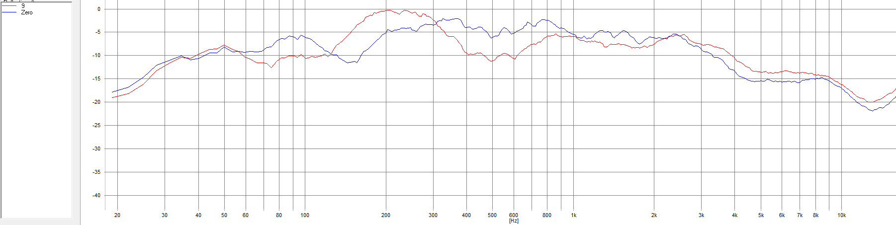

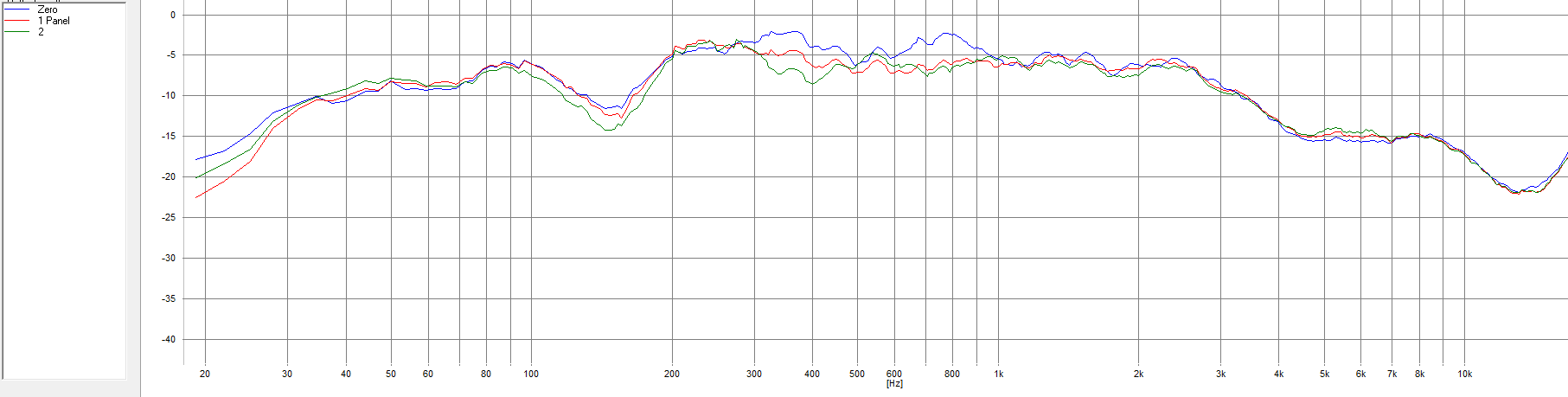

The dip was at 150hz. "pseudo-ground plane" - the panels are 3" rockboard 40. Could a stack of these create a ground plane.
There's a lot of frequency change in the measurements and I cant say that I can interpret it completely as other boundary reflections might be altered by the floor panels but the panels would alter the reflection(say from back wall) rather than at the point of incident(the wall). Maybe floor panels are absorbing a little second reflection after wall reflection.
IME, the worst reflections that reduce coherency are between 400 - 2khz, and it appears panels have reduced destructive room gain in that region.
Note - 4-6 panels had reduced the notch to a large degree and 6-9 not a lot of change. so not far off from your claim that 12" is enough.
The room will be treated at the boundaries and a large thick carpet on subfloor. This will greatly improve soundstage coherency.

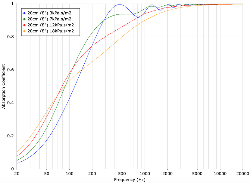

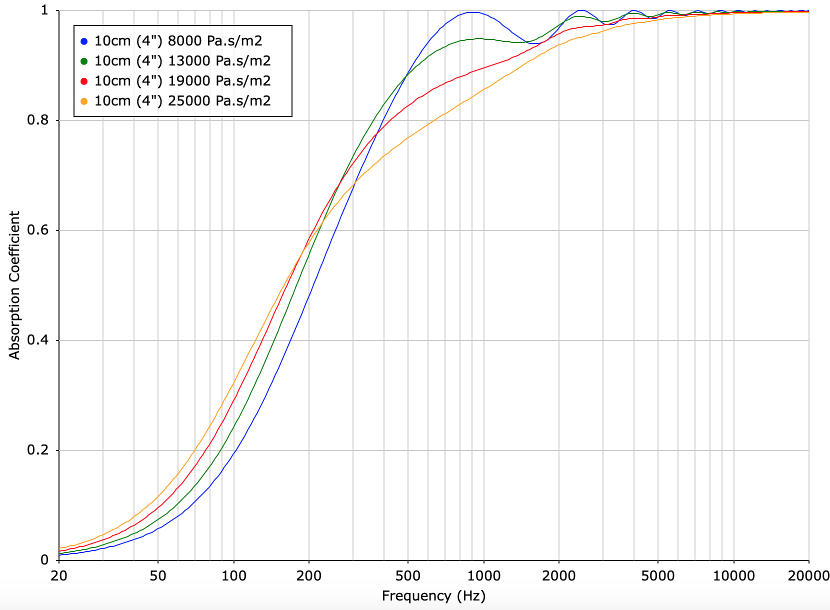

Short answer - sort of, yes.
Damping material, of a given flow resistivity (which generally correlates with the density, for any given material) is effective for a certain range of frequencies vs its thickness. If the density is too high, only lower frequencies can actually pass through and be attenuated, as higher frequencies will bounce off (whether at the surface or somewhere below the surface, I'm not entirely sure). In other words, you have a maximum effective depth of absorption that is based on the frequency of interest and on the density of the damping.
With Rockboard 40 at 64 kg/m3, its flow resistivity should be somewhere between 15000-20000 Pa*s/m².
Absorption with 4" thickness, no rear gap - trace the red line (19000 Pa*s/m2) to 200 Hz and find coefficient = approx 0.57:
Absorption with 8" thickness, no rear gap - trace the orange line (18000 Pa*s/m2) to 200 Hz and find coefficient = approx 0.65:
Doubling the thickness from 4" to 8" has only improved the absorption coefficient at 200 Hz by 14% [(0.65-0.57)/0.57]. You can see that you are already in the regime of extremely-diminished returns. You can also see that with 8" of damping, the damping material with the highest flow resistivity only starts to outperform the material with the 2nd-highest flow resistivity below the frequency of about 70 Hz! Furthermore, at 200 Hz the material which absorbs most effectively (again, with 8" thickness) is the one with 7000 Pa*s/m2 FR. Less than half of what you're using right now. If you want to use even more thickness, the flow resistivity has to drop even further.
The page is quite informative as to what flow resistivities would be optimal for what depth you want to use effectively.
