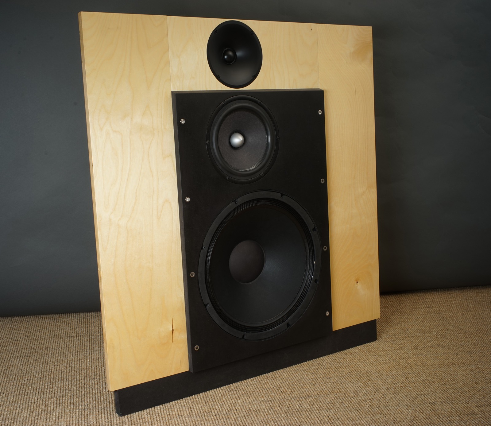

Yeah, one of the options I've been thinking about is a large full range driver. That might give me the bass and midrange I've been looking for, but at the sacrifice of the very high end.Does the 8 inch Audio Nirvana have this ringing anyone know? This is back to our classic fullrange compromises, highs or bass, but pretty good imaging either way. Maybe a driver smaller than 10 in an enclosure that is more efficient in the bass might be a a good option, that seems to be a popular way to go in the fullrange subforum though there's a lot of variety.
Some of the recent Lii Audio products are interesting. They use a whizzer to get the high end, which I'm not thrilled about it, but their 10" model might be worth a try, nevertheless. They certainly get good reviews.
Yes, that's one of the things I've been considering. Anyone want to design a crossover for me? I could try to do it myself, but don't really have the experience that I think is needed to get it right.Why not experiment with using your 10" fullrange as bass support. Just to get an idea. You'd need to fabricate some kind of crossover though.

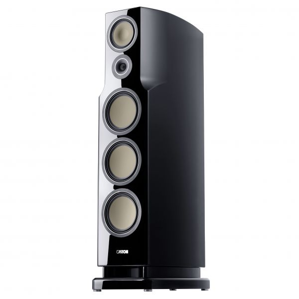

Today's popular 6 1/2-inch drivers have long VC travel to compensate for their lower SPL, but placed in towers with 3 or four of them, they can match the SPL of a single 15-inch driver without much travel. . I have to do the calculations, but I can't right now. Sorry.
