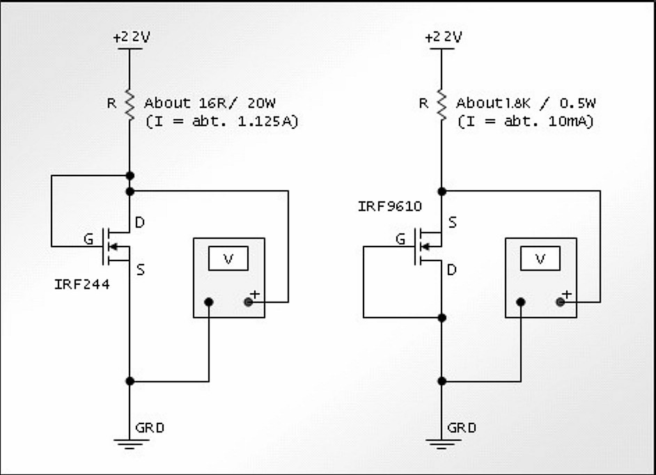

I bought some of the C2m1000170d and just did a quick and cheerful VGS matching exercise on them. Results below. Current and V(supply) are derived values. Setup attached. V(res) is the voltage over the resistor in the test and is used to derive the current.

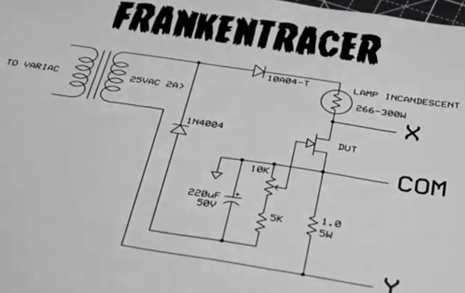

Is there interest in me trying to curve trace them? I haven't a curve tracer, but I've been looking at This and I could bodgy something similar up easily enough...
Aspringv..
I for one would be very interested in seeing the curves, especially in the region we are accustomed to working in. I have an old Heathkit curve tracer I built in 1974 that I planned to use when I could get some of these devices in hand. Have not gotten that far yet though. I hope you have a chance to build your test setup. Thanks for the matching information. Very interesting test data. Did you use heat sinking during the tests?

Presumably you are modifying the Frankenstein to suit the enhancement mode n channel cree ? The original was designed for negative bias voltages.
I believe if you reverse the diode that powers the variable bias circuit and the 220 microfarad capacitor that smooths the the bias voltage, the bias will be the correct polarity for enhancement devices.
Maybe Michael R will clarify this.

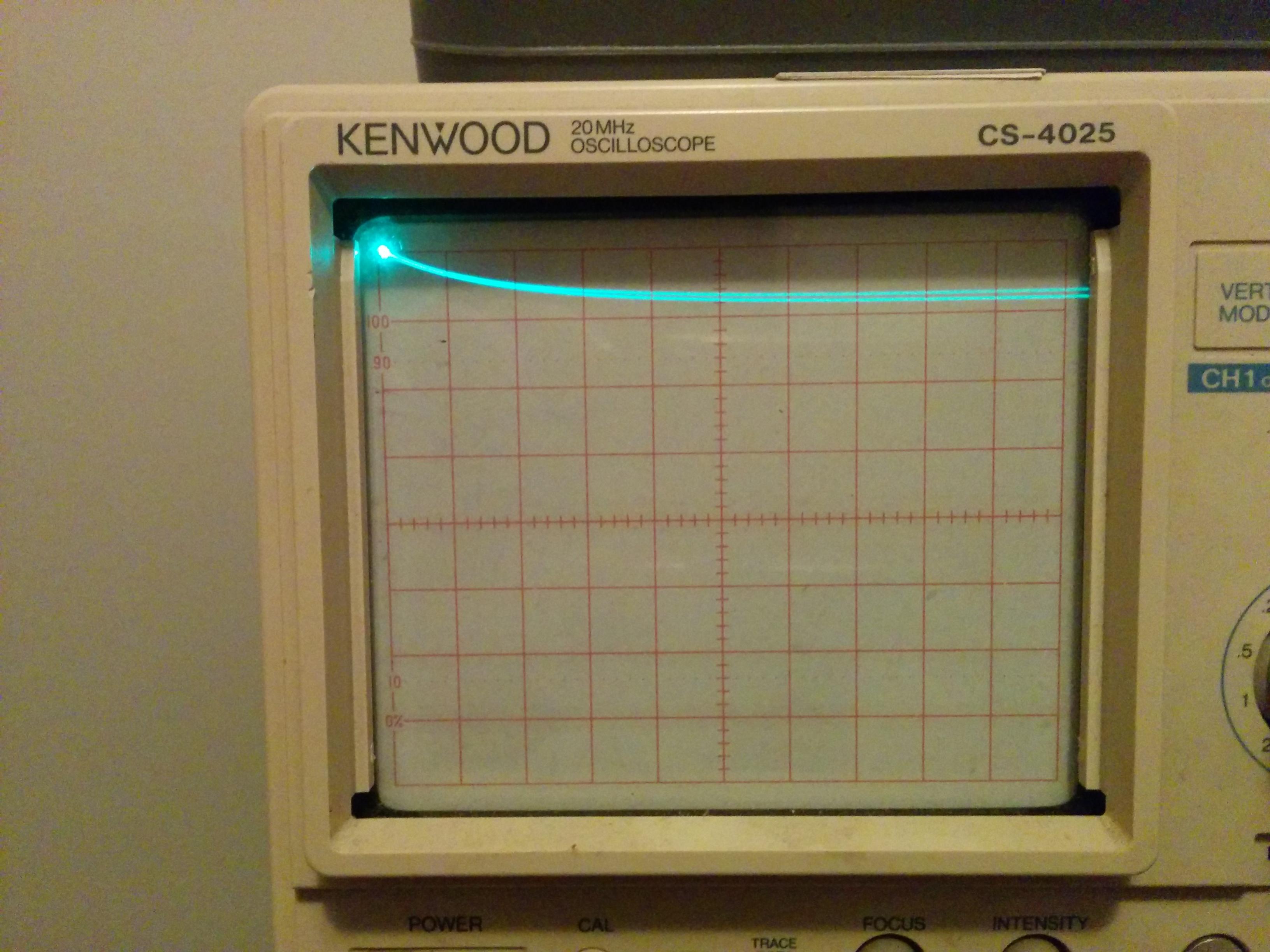

Sorry folks - I have parts and I've knocked up a curve tracing rig, but I've been travelling for work a bit recently. I'll get curves up when I get some me time.

aspringv,Sorry folks - I have parts and I've knocked up a curve tracing rig, but I've been travelling for work a bit recently. I'll get curves up when I get some me time.
Anything new to tell us ? I have not had the chance to do anything more yet. Just wondering.......
I've been somewhat snowed under with work recently so its been on the back burner for a while. However, I hope to get a chance to do some testing on Sunday should the stars align!
Progress
Curve tracer up and running - took a while due to drama with the bulb I used.
I'll pop one of the SIC FET's on after dinner.
measurements

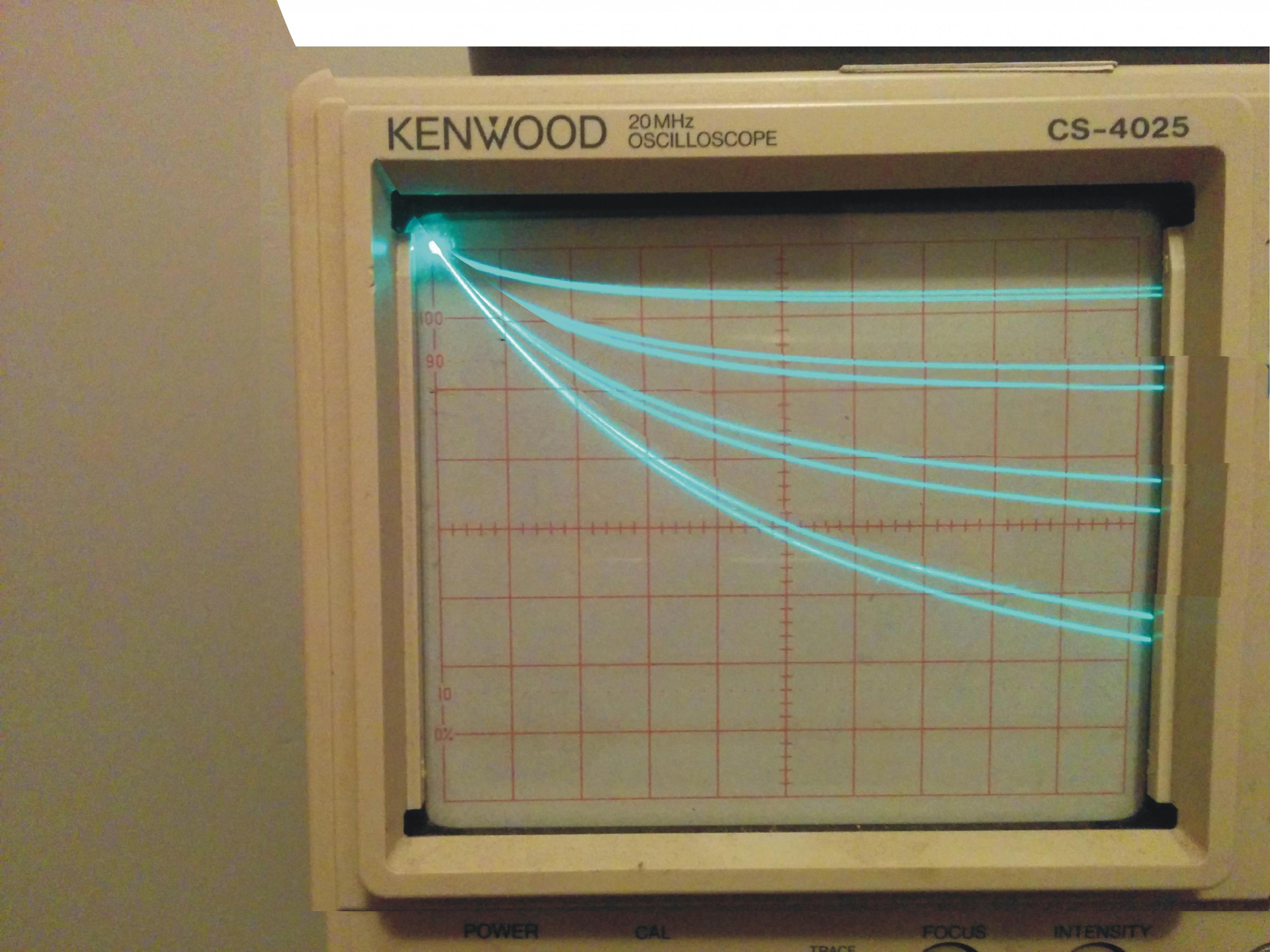

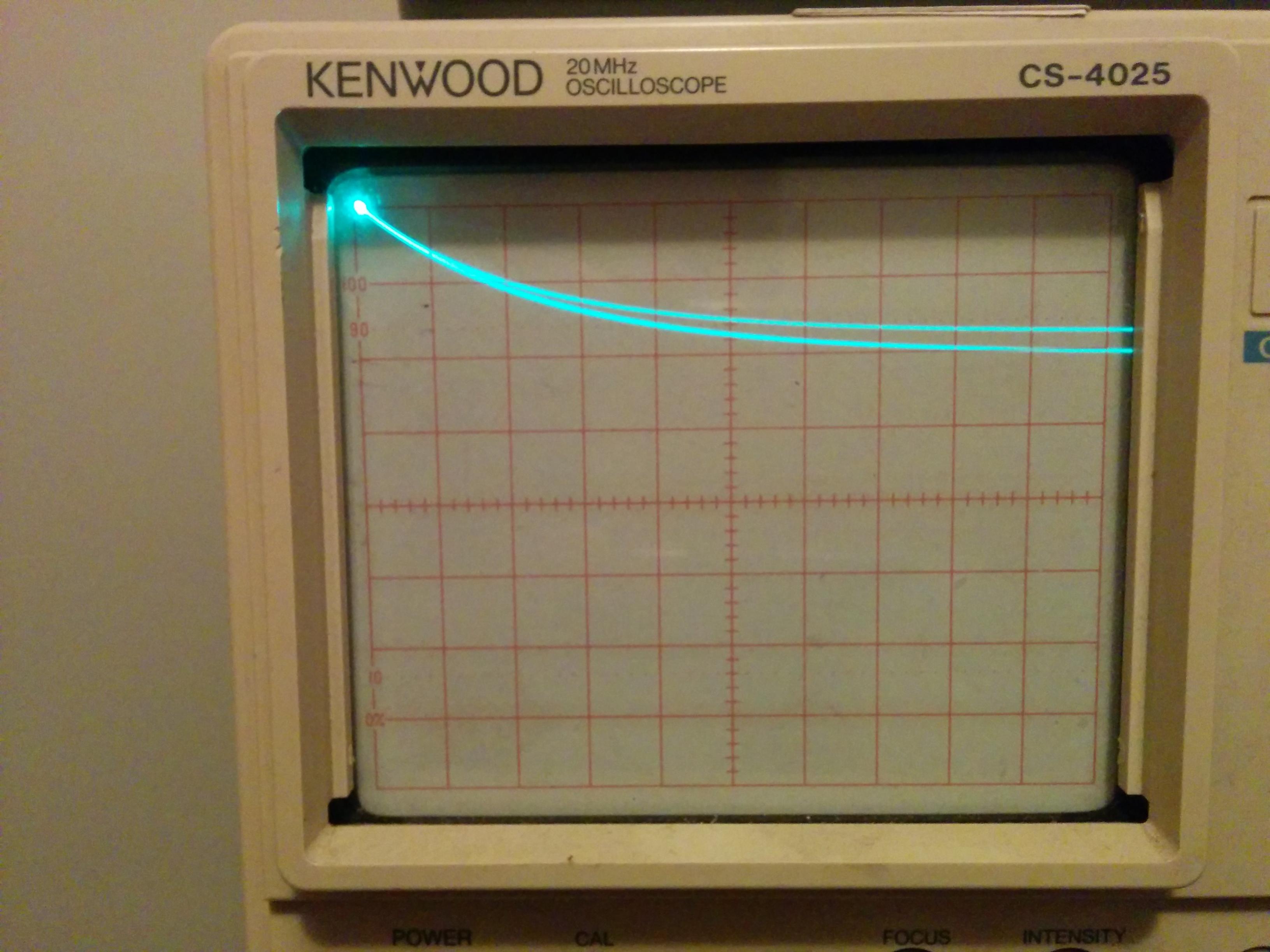

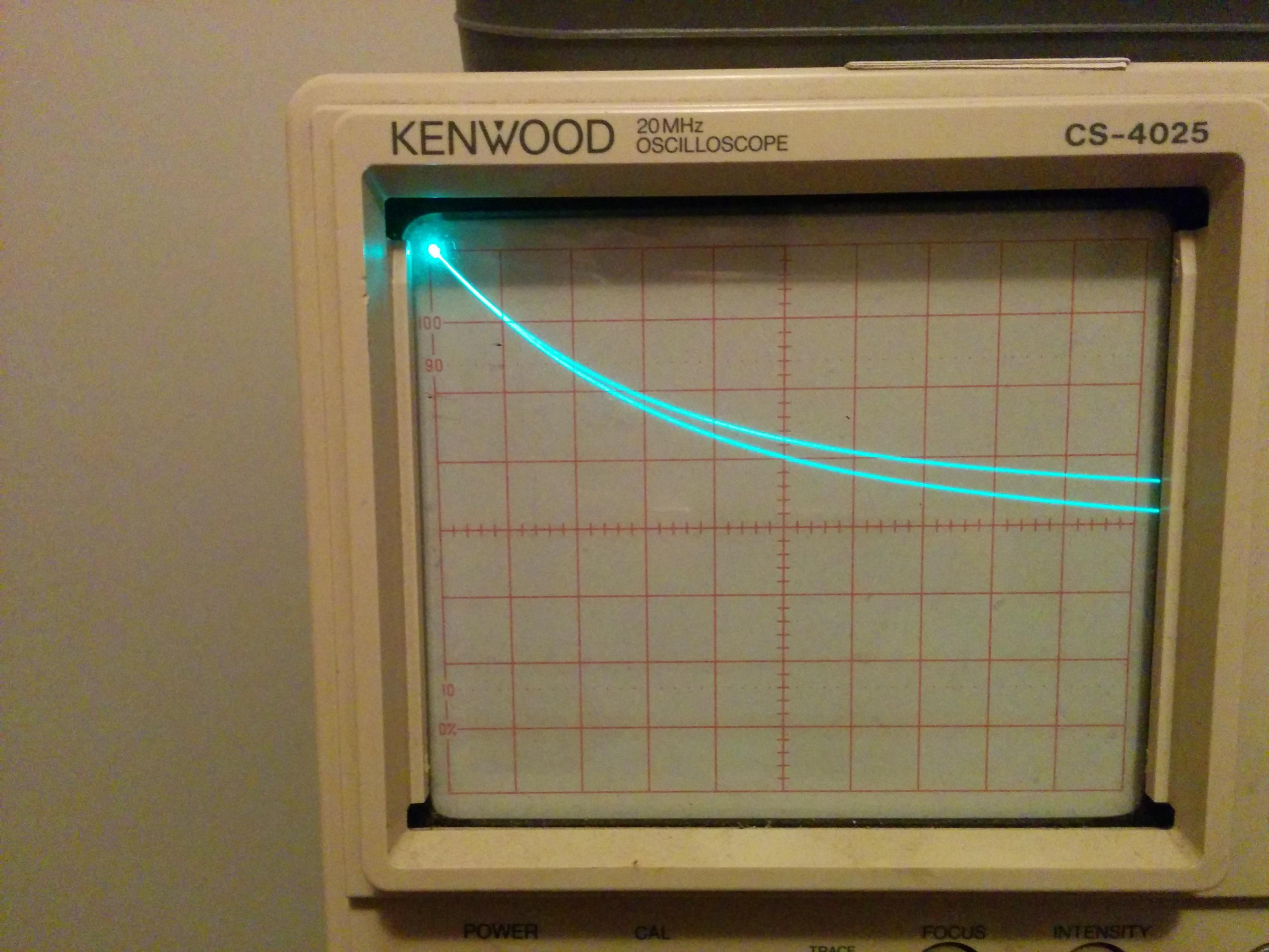

Here you go. Some small changes from the original frankentracer rig. The 1R resistor is actually about 0R94, and the lamp was swapped for 21R4. The bias circuit was altered to give a positive voltage to the gate.
X axis is .5V a division, Y axis is .2V a division. Bias at 6V, 7V, 8V, and 9V as you go.
It's all a learning experience for me, so please if you'd like different measurements please ask. I've no idea why the graph is inverted either 🙂
Hi aspringv,
Nice work!
Thanks for taking the time and doing the work so we can all see the curves for these interesting devices. I appreciate it very much.
I took the liberty to stitch your four curve photos into a composite image so I could get a better feel for the characteristics. attached is the composite for all to see. It looks promising to my untrained eye.
Nice work!
