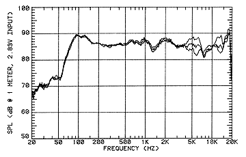

How to read phase distortion?
Here are some measurements (by NRC) for a 2 way design. This figure shows on-axis, 15 degrees off-axis, and 30 degrees off-axis response. Note the dip at 1500 corresponding to the crossover at 1500.
Post contd. to next thread

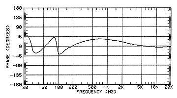

Contd. from previous thread
Here is the phase response for the same design. Now, I actually see a lot of phase anomalies because of the woofer driver as opposed to the crossover. Or am I reading this right?
I apologize if I am taking this thread offtopic. Pl let me know if I should make this a new thread.
regarding amplitude/phase plots from jag
The amplitude and phase plots are not consistent with one another according to any physical model I am aware of for normal analog circuits. For example, the phase deviation where the woofer falls off stays within +/- 45 degrees, when I would expect phase changes to exceed +/- 90 degrees. In the phase plot there is no sign of the crossover, but phase perfect crossovers do exist. Such crossovers trade the phase distortion problem for problems with total power versus frequency. This type of cure may be worse than the disease. Some will not agree, but constant power versus frequency for multi-way system is a common design objective (all part of the trade space). I find it strange that the phase plot is nice and smooth and the amplitude plot looks like a typical measurement. Are you sure this is not the phase of the impedance of the design, not the phase of the acoustic response?
