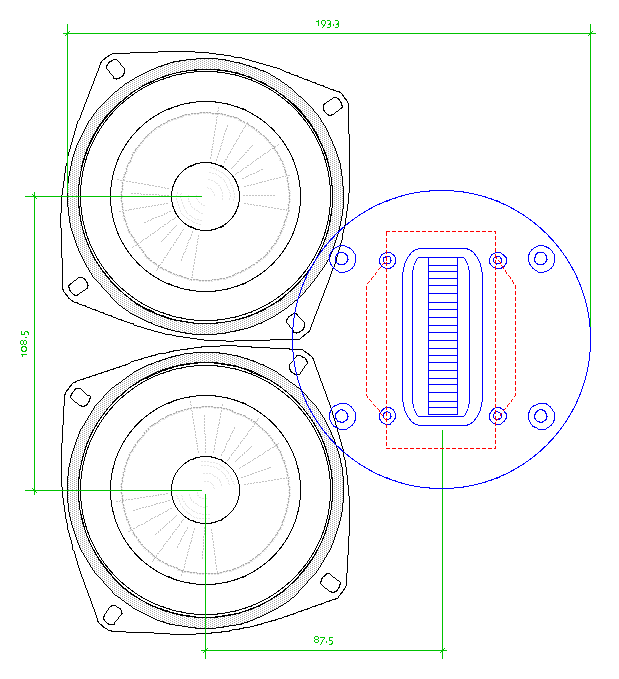

When u use 4 drivers did you hear any real problems with the expected lobing and acompaning cancelation?
i figure with 2 4" (100mm) drivers I would get lobing about 3.3-3.4k (330-340 3m/s is speed of sound). given that i like a laid back speaker and any peaks in this area can appear to make a speaker shout this cancellation might actually work in my favour.
then i bring the tweeter in about 5k or 6k using a single cap and maybe use an inductor to roll of the fullranges.
option 2 of course is to use a 2.5 way XO using 1st order LP at about 300Hz (maybe lower), letting the second fulrange run all the way and bringing the tweeter in at 10k or above whenever the natural roll off the the fullrange gets nasty or low.

Therefore, maybe you should try to mount the two units as close together as possible, to increase that 3.4kHz as far as you can.

I've a plan to do something like this (but with an extra pr of drivers on the back). I have the FE103A & a set of Aurum Cantus ribbons. Will use active XO -- either subtractive, or built into the interstage coupling of the amps, or a combo (EL84 on the bottom, EL95 on the top).

I'd like 7k but i won't know if i can get away with that high... by all the "rules" it should be more like 3-4k ... as far as i've got on paper attached.
This will be a 3-way with separate push-push woofers -- i have 4 nice extended range Foster 12".
The "mostly" full range system is a concept i've been playing with for some-time.

can the tweeter u got work as low at 3k?
are you looking at a higher order XO for the tweeter if you go that low?
i was trying to use a 1st order series XO for my system. after my last expriment with series XO i find that they integrate a lot better than convetional XOs.
It can, but it would need a steeper XO than i'd like
If i can't get away with a 5-7k XO, i'll rethink the whole thing.
how low do you plan to take the 103? what box volume will 4 x 103 require in your design?
they can probably reach down to about 80 Hz but i'll roll them off a bit higher -- not higher than 150 thou.
