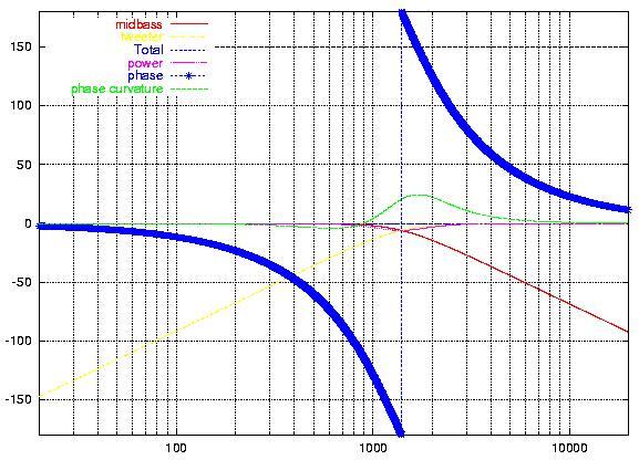

generic examples
to jag:
Well, it worked (previous post), just didn't show in the preview.
In the previous post I show a generic example using a 4th order L-R crossover at 1.4 khz. The plot shows amplitude response in dB for low pass, high pass, and coherent sum. Using the same scale the phase is also plotted. This phase plot tells us absolutely nothing about audibility, not even a hint.
The plot also shows 'phase curvature'. This is a more useful metric that indicates something about the relative group delay distortion. My experiments tell me that I PERSONALLY do not like this distortion to be significant between 1kha and 4 khz.

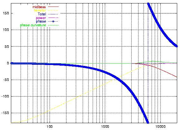

In the plot I show in this post the example is for a 4th order L-R crossover at 6khz. This will sound much better to me. Many people, I am sure, when presented with both, would not hear a difference (different people hear differently).
Most commercial designs will, for me, have significant phase distortion.
Hope this helps.

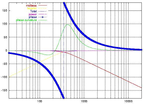

another generic example
While I still remember how I did it, here is another example.
This is for a 4th order L-R crossover at 350hz. The region where the "phase curvature" metric is significant (to me) extends up into the 1-4khz region.
Note: Its best not to fixate on a single performance metric. Within our budget limits we need to make the "smart compromise". The phase distortion becomes an important consideration only after everything else is "almost perfect". In such cases reduced phase distortion can make a considerable difference, but not otherwise.
