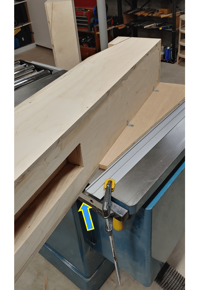

The bevels were the most challenging part. My table saw was almost too small for the job. In the attached photo you can see that I could not use my rip fence. I needed more space on the left side of the blade, so I had to clamp a straight edge to the table. Even then, I had just an inch of clearance. This difficulty is due to the height of the cabinet. If it were only 20 inches high, there would be no problem.
I am reluctant to build such a large cabinet with deep beveled facets in the future. I would be more inclined to make the cabinet in two parts and stack them. It looks like you made yours in two parts Mtidge, yes? Very nice looking work.

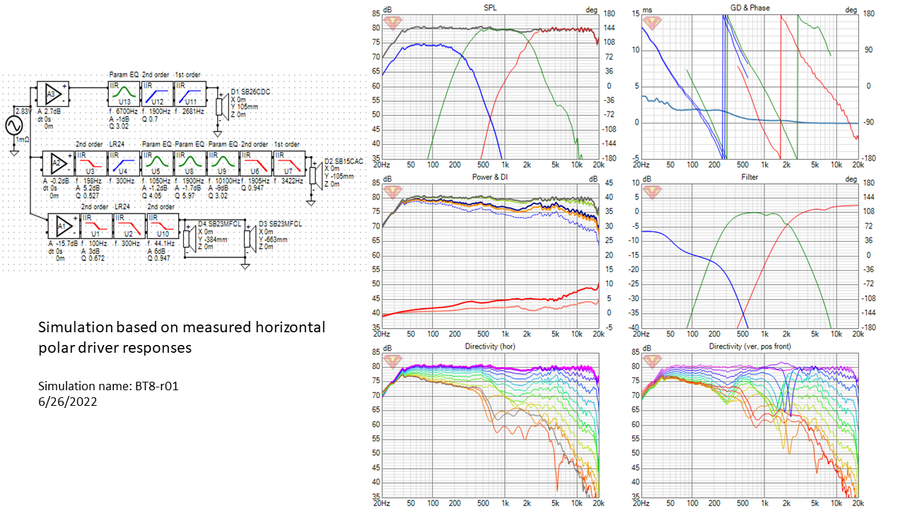

I designed the first DSP filter, and testing has begun.

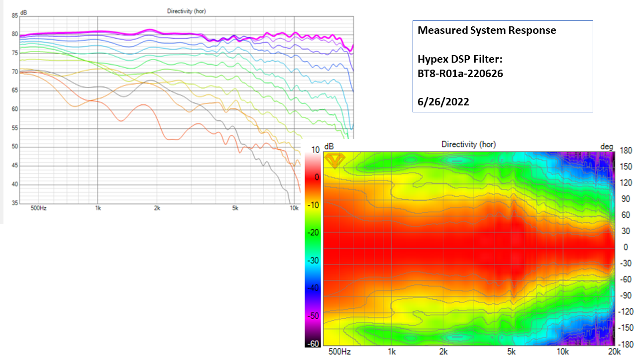

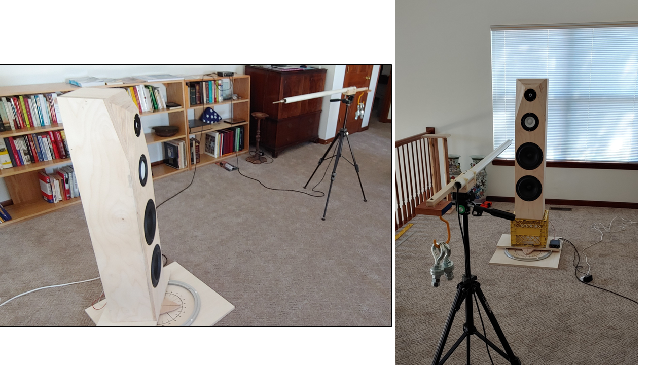

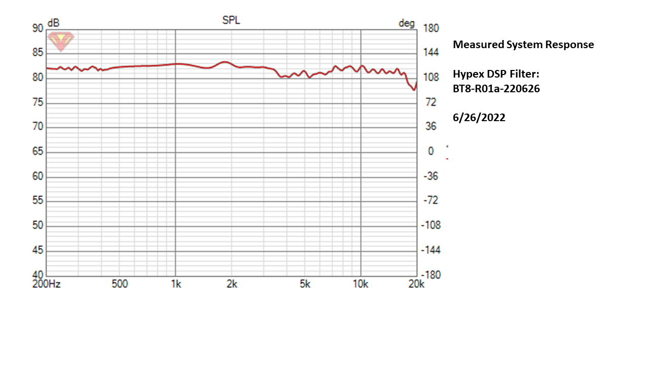

I measured all four drivers near field and far field, according to the VituixCad instructions. The baffle response was simulated for each driver, and the near field response was modified to be 4-pi equivalent. The far field response was made at 39 inches (1 M), on the vertical axis of each driver. Horizontal polar measurements were taken from 0 to 180 degrees in 15 degree increments. Due to symmetry, I made polar measurements to one side only. Vertical polar measurements were not made, in accordance to VCad guidance, so therefore the software will assume the driver vertical response is equal to the horizontal response. The merging of near field and far field was done according to VCad instructions.

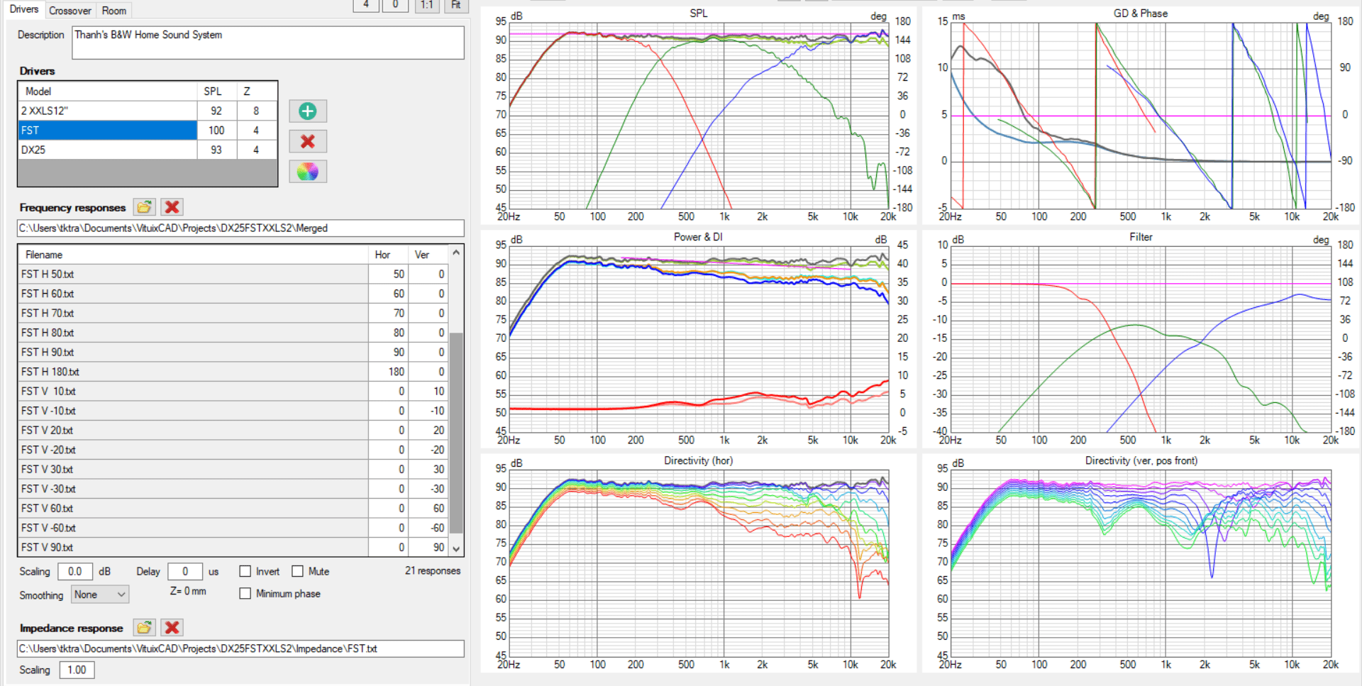

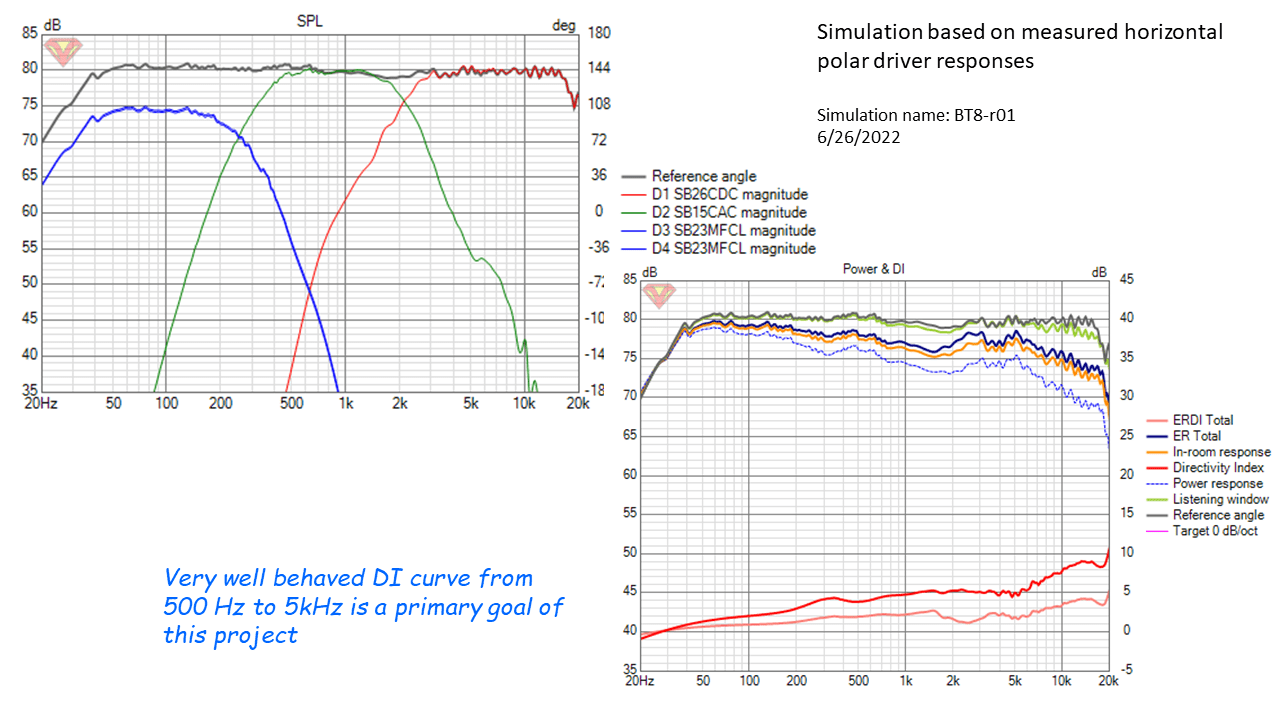

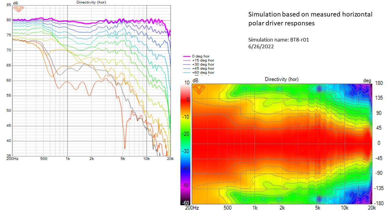

The first three graphics deal with the VituixCad simulation. From a simulation standpoint, I am happy with this filter. It achieves all my objectives, including the key goal for this project which is a well behaved DI curve. The DI is either increasing with frequency, or flat, and it is very smooth from 500 to 5000 Hz. I may develop future DSP filters which optimize other aspects, such as highly consistent horizontal polar responses, assuming it is possible with this baffle layout.
The remaining graphics pertain to measured results. I measured the system in 15 degree horizontal increments. The measured response did not match the simulation as well as I was expecting. My prior projects have had a better match between measurement and simulation. I am not sure why this system is different. I had to adjust the Q of both the mid low-pass and tweeter high-pass filters. I also had to add some additional delay on the tweeter beyond what the VCad simulation predicted. The response I am showing in graphics 4, 5, and 6 is the tweaked DSP filter. Even after tweaking, there is still some improvement to be made.
When I am satisfied with the DSP filter, I will make vertical polar measurements. I only want to do this once. My original plan for supporting the 70 lb speaker horizontally is not workable, so I am going to build a roller table.
Another task before me is to take the speaker outdoors and do a ground plane measurement. I have the levels between the woofer and mid approximately correct, but the outdoor ground plane response will allow me to dial it in.

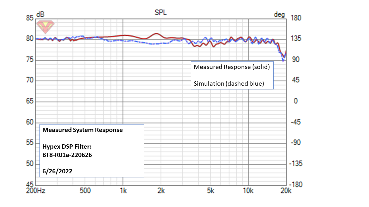

Nice results up till now! The measured response to me looks better than the simulated. The latter probably has a little too much energy at 3-4kHz (like so often with 5”-1” combos), but the actual response probably is pretty OK.
What do you mean with the difference between simulation and measured result? Do you mean difference between simulation that was based on the actual measurements and to full system response with implemented crossover that is based on the said simulation? This could happen if there is some error on either measurement, or with DSP implementation....
Just in case a reminder, do you have your actual DSP engine set in VituixCAD options? There is some errors if you simulate with one and implement with the other.
That 3-7kHz dip with on-axis signal is weird one, wonder what makes it. Perhaps there is enough error with missing vertical measurements?
Something is definitely off with the data in the simulation, the mid is not as directional in reality as it appears in the simulation.The remaining graphics pertain to measured results. I measured the system in 15 degree horizontal increments. The measured response did not match the simulation as well as I was expecting. My prior projects have had a better match between measurement and simulation. I am not sure why this system is different.

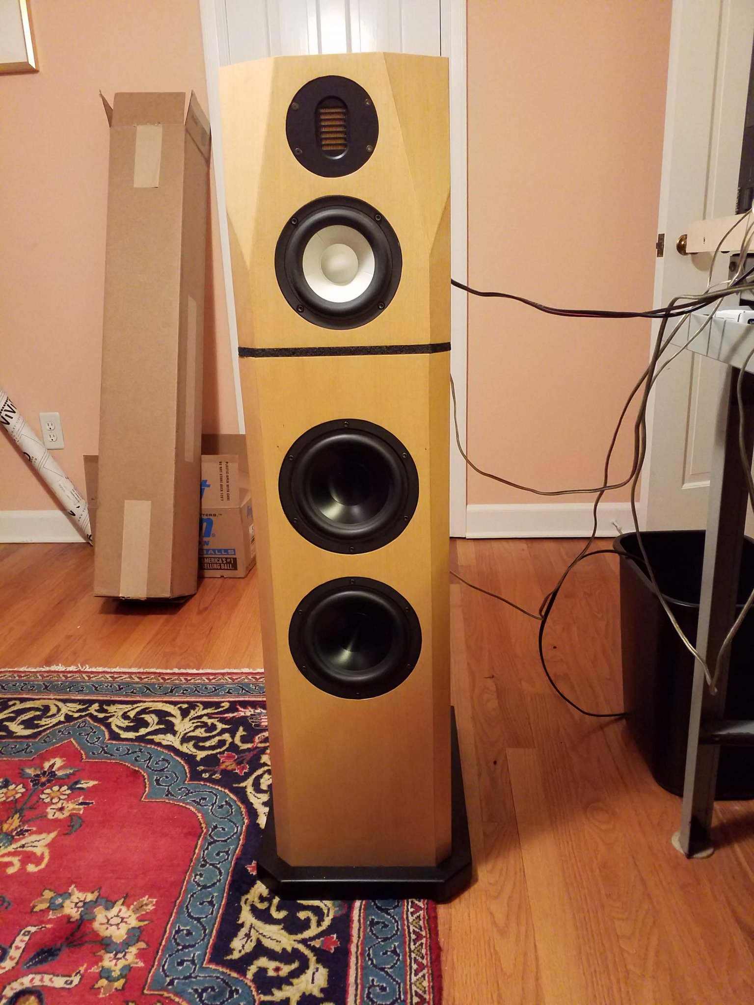

The outer baffles have been attached, and the bevels have been rough cut. I attached some pics with notes
Your speakers looks stunning. Props on your craftsmanship. I need to get back to full size speakers. 4-5 years later and 3 different stand mounts. I gave small designs a fair chance.
@hifijim I have some doubts. Why do we have to prioririze directivity index smoothness at the expense of power response bumps? Is this the best approach with direct radiating tweeters?
What would be more audible, power response smoothness or directivity index smoothness?
i got these doubts seeing the power response bumps around 4-5 kHz in your simulated response
In my eyes hifijim's measured response looks excellent!
On-axis recession is compensated by off-axis nicely. Verticals Will be more interesting... Group delay is typical for 3-way with sealed bass. LR2 xo would be even better.

Try LR2 between MF and HF and you'll get better ER and PR and PIR, whilst maintaining smooth neutral on-axis and LW, as well as better phase integration at the crossover point.

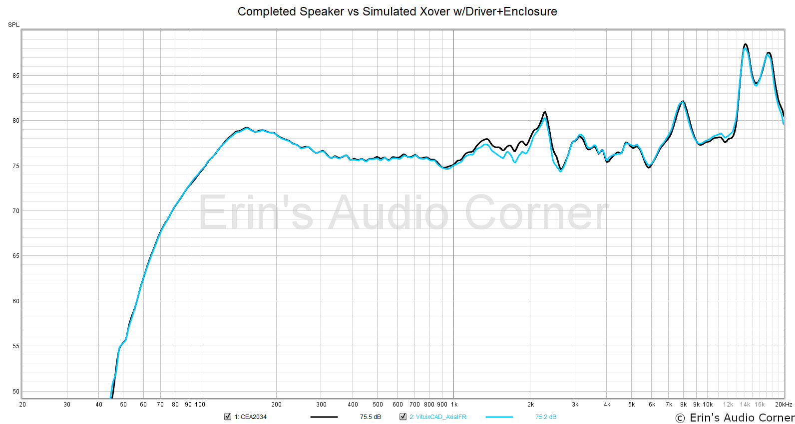

I wouldn't lose sleep over the mismatch between crossover based on simulation, and the crossover based on actual measurements. Just make accurate real measurements including polars, and VituixCad2 will do the rest.
Reference: https://www.erinsaudiocorner.com/loudspeakers/parts_express_copperhead/
Erin's measures this kit with his Klippel NFS, then takes out the crossover, and measures the drivers, in-box, and then sims the crossover with VituixCad2, and then compares the simulated crossover with the actual speaker with the complete passive crossover:

YesWhat do you mean with the difference between simulation and measured result? Do you mean difference between simulation that was based on the actual measurements and to full system response with implemented crossover that is based on the said simulation?
