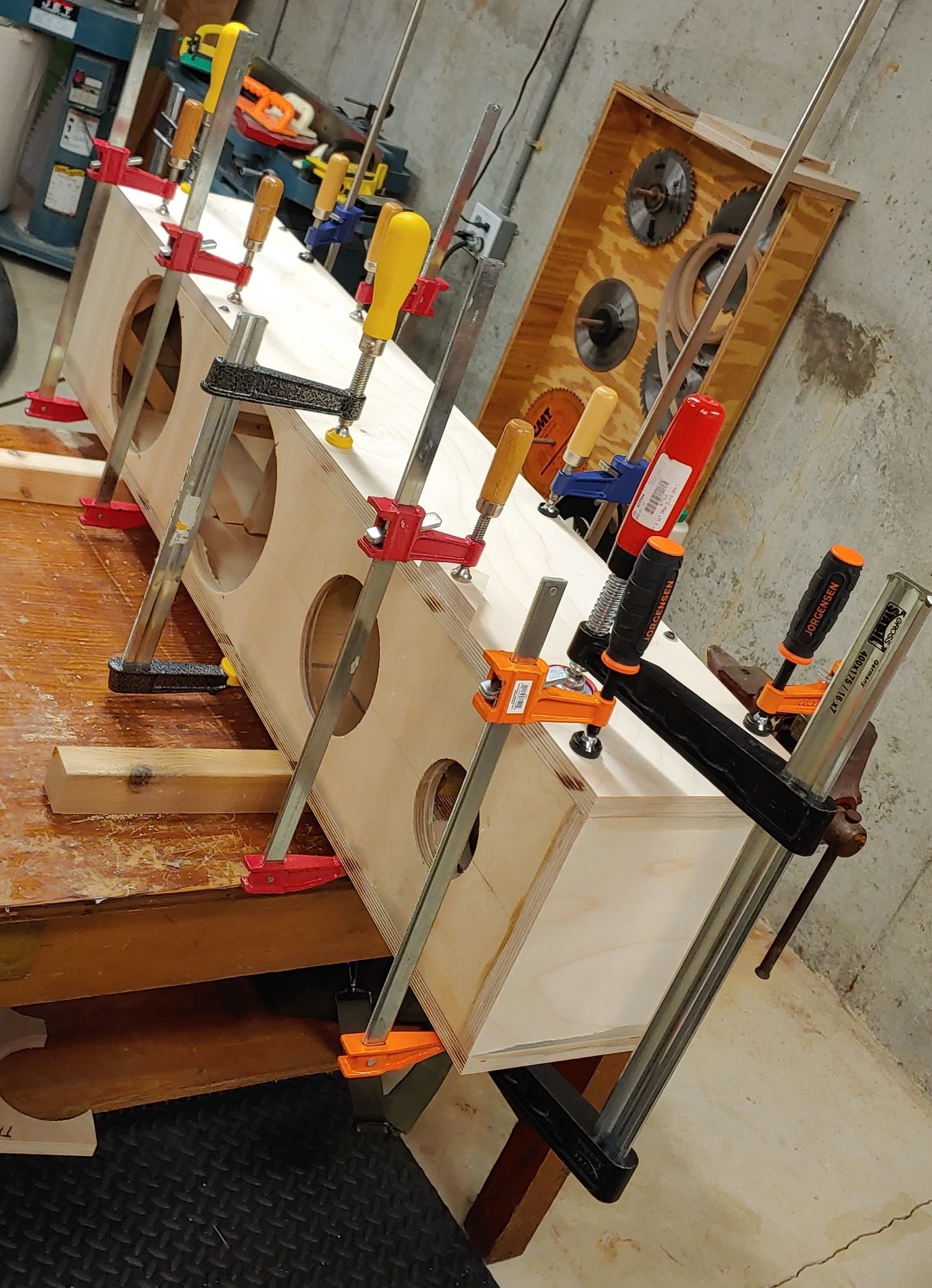

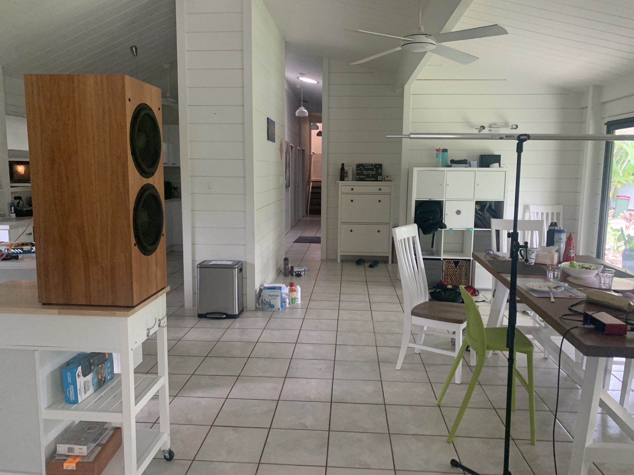

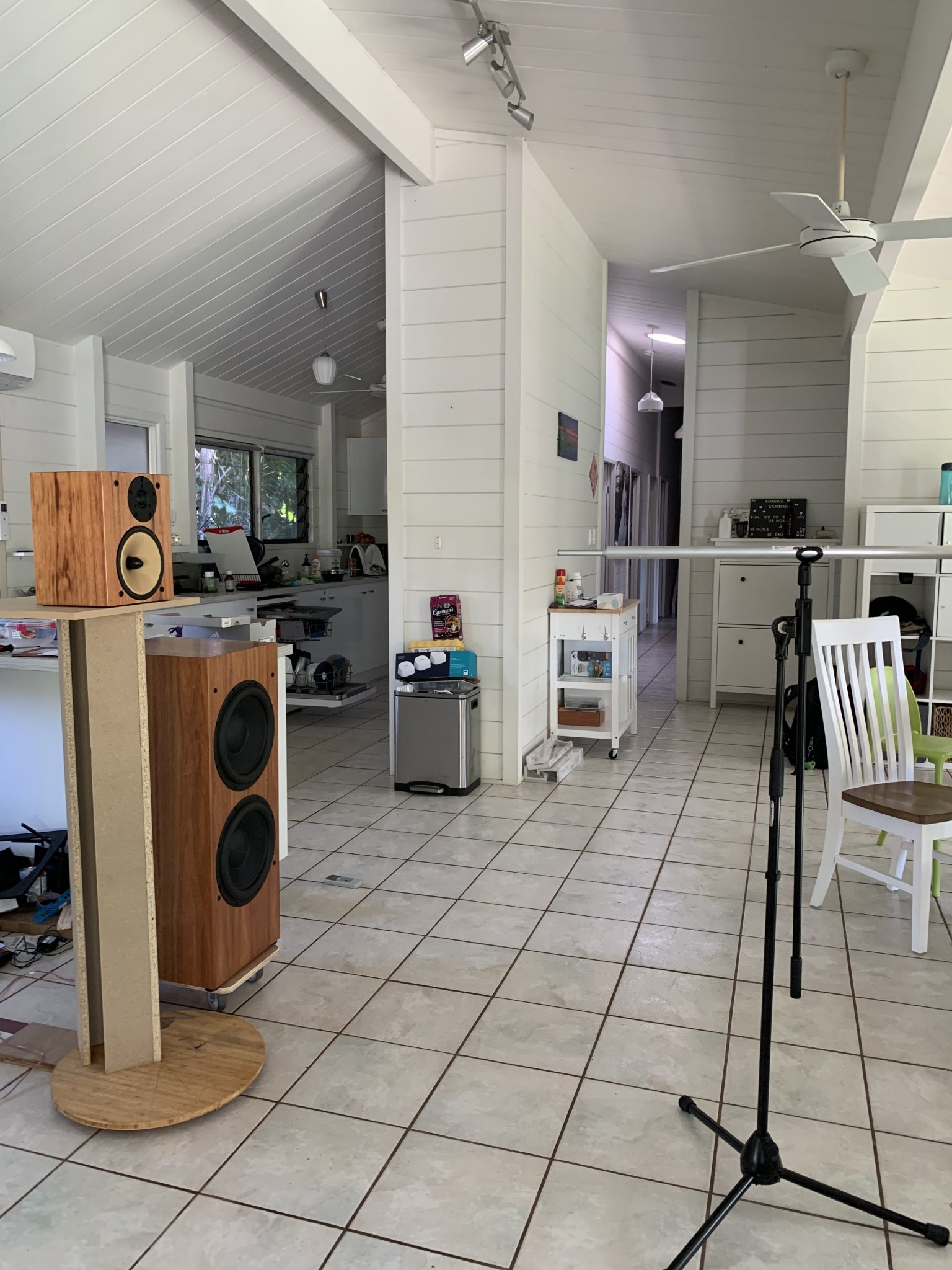

I let this project sit idle for a couple of weeks while I did some house projects and then did some vacation travel.
I have glued on the side panel, which was the last remaining panel of the main carcass. The main carcass is now done. All internal bracing is installed. The next step will be to construct the outer baffle and glue it on.

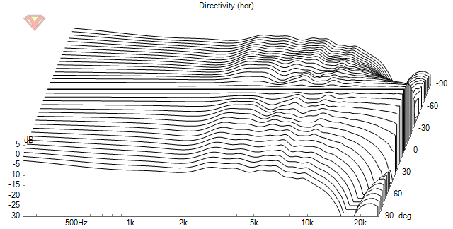

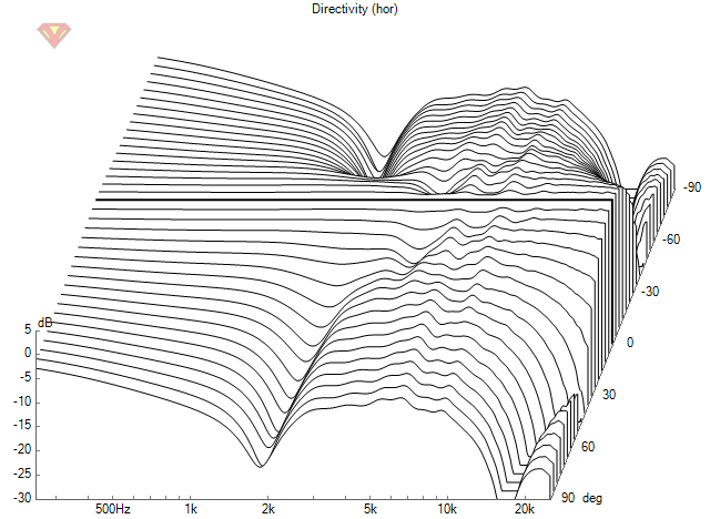

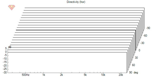

Played with VituixCAD and it can do close the same graphs as the Stereophile normalized horizontal graphs are. Attached is a VituixCAD project that can produce the images below. I urge anyone play with it to gain some insight how the speaker construct relates to various things on the graphs.

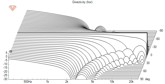

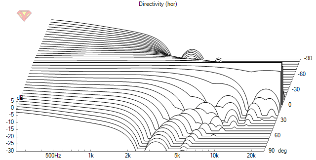

Here is ideal point source, this is the best that can be, straight lines. This is omni and all off-axis angles have same level. If it was narrower directivity but still constant directivity, the lines to off-axis angles were just lower in level but still straight.

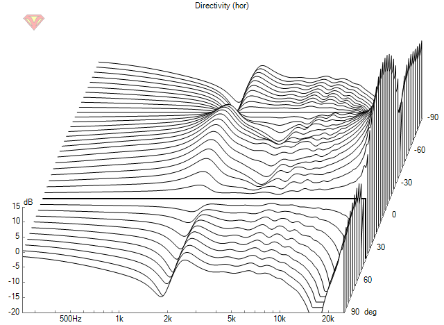

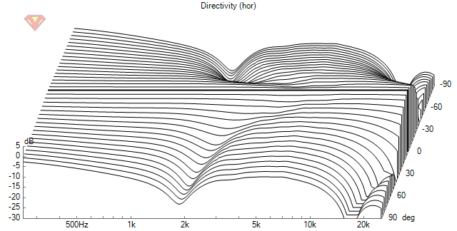

Below responses are ideal 1" and 8" transducers on ~minimal 20x40cm baffle made with VituixCAD diffraction tool.
Here is only the tweeter with and without 25mm corner radius on baffle. Response is about omni on low frequencies until baffle starts to narrow it, eventually the transducer beams as wavelengths get shorter than the diameter. Diffraction in between which almost cleans out with 25mm radius roundover on the baffle edge. The baffle is quite large for the tweeter and roundovers are needed to reduce diffraction.
View attachment 1058593View attachment 1058594

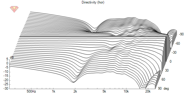

This is ideal 8" woofer on the same baffle without and with 25mm roundovers. Its minimal baffle for the woofer so not much effect to its response.
View attachment 1058595View attachment 1058596

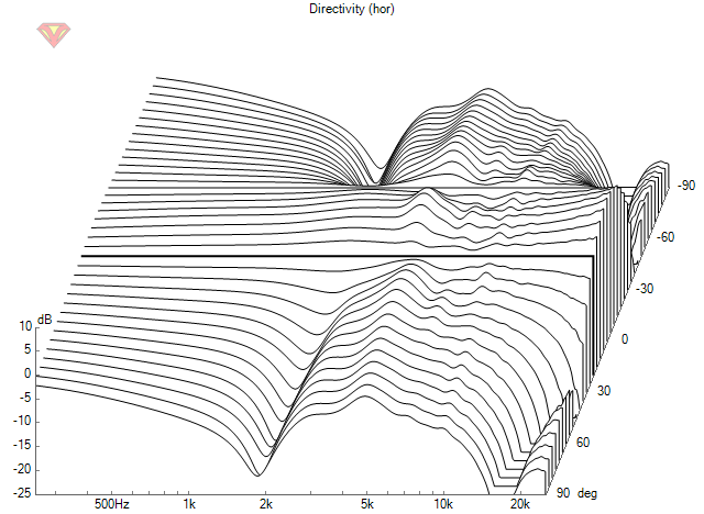

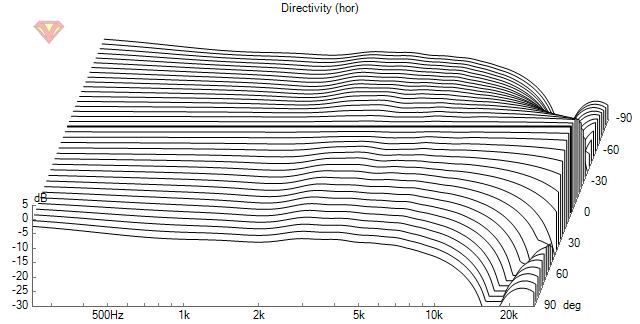

And here is the system with 3kHz LR12 crossover, with and without the roundovers:
View attachment 1058599View attachment 1058600
Yes its not too good of a system, 8" and 1" with 3kHz crossover, just something arbitrary to give more data whats what on the graphs.
Is there anything to learn? Yeah, do roundovers (and EQ) if you wanna make your graphs look better than in Stereophile! Pay attention to driver sizes and locations, structure, the construct.

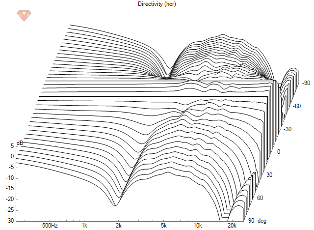

Note the graphs are Normalized to on-axis, meaning that the on-axis response is "EQd" perfectly flat to show off-axis angles response in comparison to that. Perhaps Juhazi observed from the graphs he linked on post #113 the B&W really has kind of wild on-axis response and came to conclusion minimal baffle didn't help. The ragged response is not due to diffraction though, except some on the tweeter but less than with the others, and could be EQ:d pretty nicely.

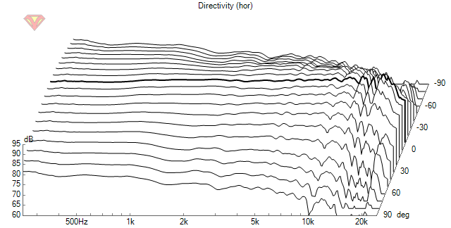

Here is simulation with real system measurements. Its not normalized but just EQ:d quite flat, the construct is made low diffraction without roundovers, basically its no baffle cardiodish with freestanding waveguide. Wouldn't be so nice without help of DSP, would have ragged on-axis response but normalized graph would look about the same as this. Btw there is two crossovers here, its a three way system.
Does normalize mean, that you perfectly flatten the on-axis in the simulation, so that you get the "pure" difference between on and off axis? Which again means, that normalizing a real measurement, would kinda confuse how the speaker actually measures?
You can normalize to any axis but most often it is the on axis. It is done by dividing all the other curves by the normalizing curve. Dividing something by itself gives the flat line.
It is a reasonable representation of what could be done if that axis was flattened by EQ, and will highlight how well the directivity might react to EQ.
Normalizing doesn't confuse anything as long as you understand what has been done and what it means.

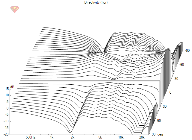

Here are previous example normalized to 0, 10, 20, 30 and 40 deg off axis.
normalized-to-0.pngnormalized-to-10.pngnormalized-to-20.pngnormalized-to-30.pngnormalized-to-40.png
This is just one special case, or point of view, how the simulator and data can be utilized, to evaluate if the construct is good or perhaps if it could be bettered somehow to measure better, what ever that means for given system. This point of view is not directly to make crossover but indirectly, after the fact, as the crossover and the resulting performance is pretty much dictated by the construct we cannot "correct" much any of this in the simulation or in crossover filters so we just have to build better construct, measure again, evaluate again etc 🙂 At least some of it can be evaluated without building anything, by simulation. Anyway, not for all projects, but if one intends to build multiple projects or do lots of prototyping for fun perhaps then its useful design process to get better performance, what ever that is.
