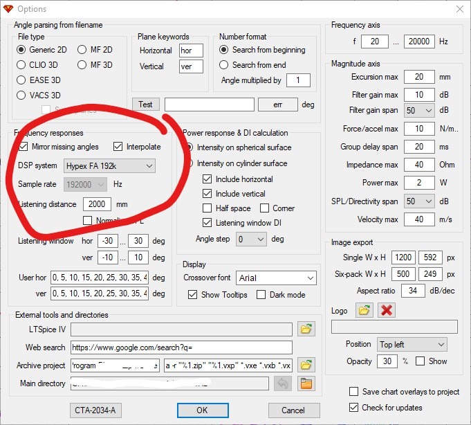

Wait, what is this then? I always thought it was the option for filter behaviour of FusionAmps ("FA"). Was I wrong?There is no HFD option in VituixCAD for the sole reason, Hypex doesn't want to disclose the formulas (according to Kimmo) But I use myself generic and 96 k to approach quite closely what HFD do

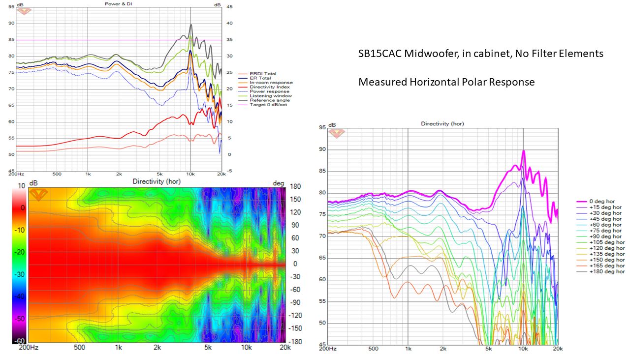

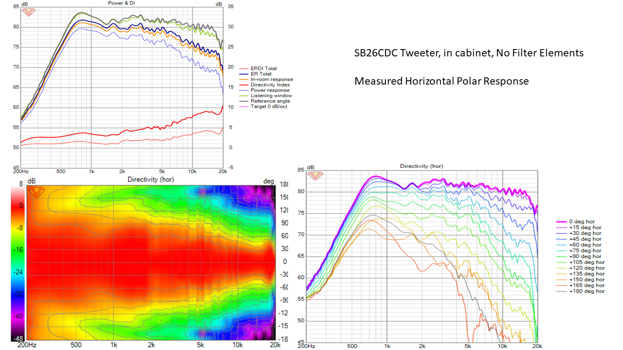

@hifijim can you post a polar graph from just the tweeter? It would be interesting to see if the polar changes because of the mid/XO. Or maybe it is just making the on-axis flat that is making the tweeter a little hot off-axis.
Here are some plots to chew on...
j.
Let’s take this offline. Let’s not take a really big detour. I just wanted to show Jim what happens with acoustic LR2 vs LR4.@tktran303 What is your CTC for mid/tweeter? Sorry for the digression Jim.

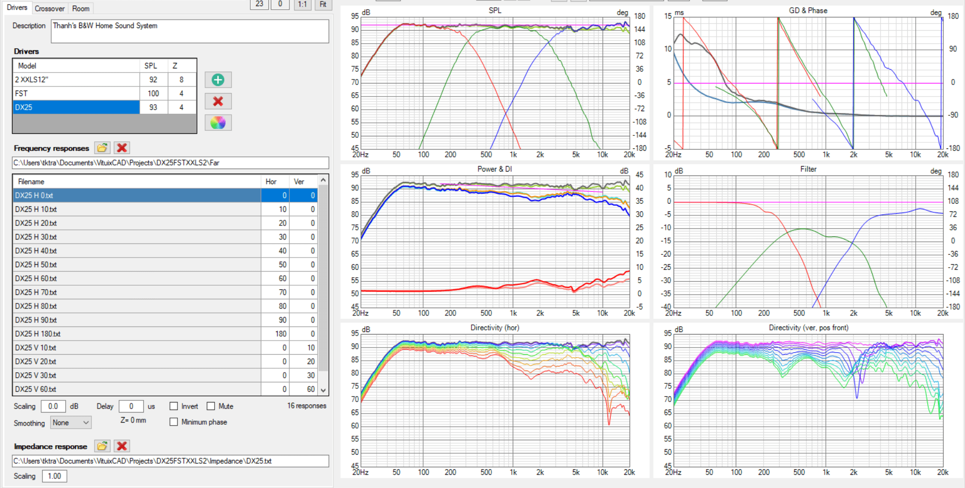

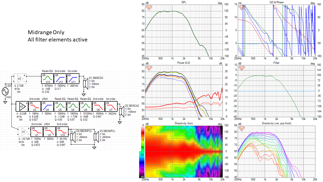

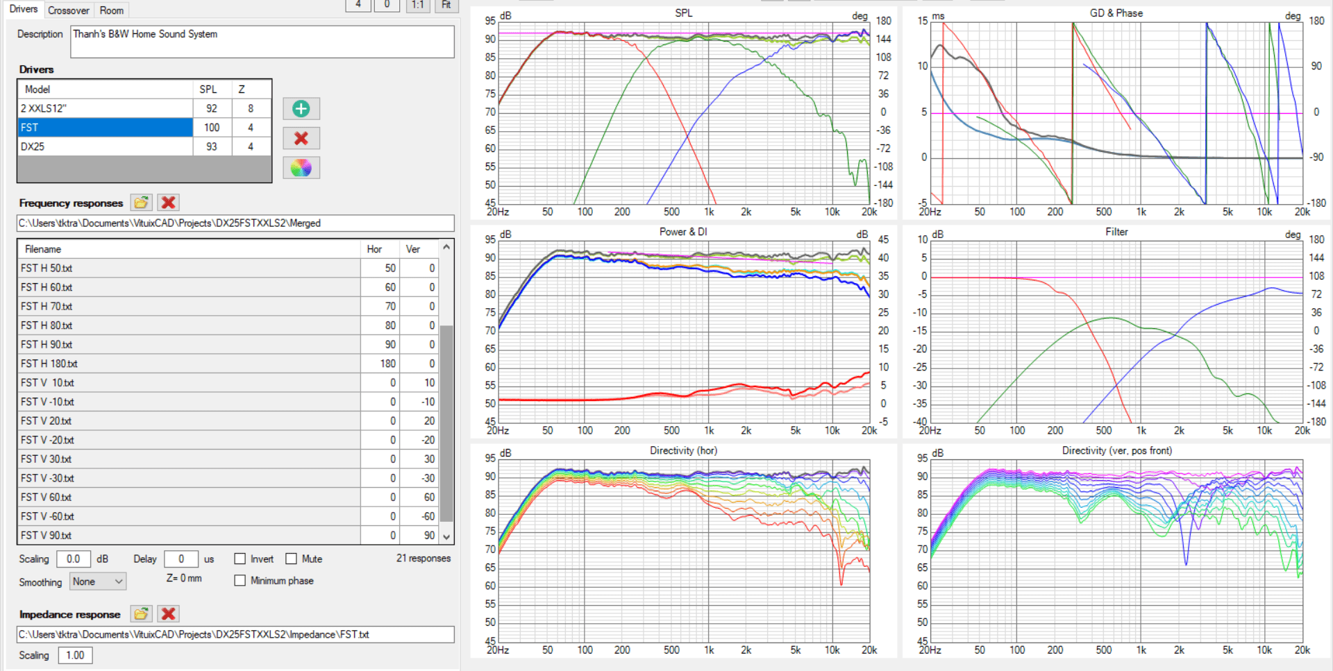

I agree that we can't say it in general, but at least on my upcoming project AND on simulation only (based on prototype front plate drivers measurements) AND M74B/T25B+Waveguide, LR2 between Mid and High was betterQuick detour-
Acoustic LR4 MF/HF:
View attachment 1067732 View attachment 1067731
same system, Acoustic LR2 MF/HF
True acoustic LR2 slopes have been long favoured by designers who have forgotten more than I know.
I could never quite understand why it was preferred. Something about allowing for a smoother blend, a smoother power response, different lobes. Or was it because it was esoteric or or “just sounds better to my ears”
And it was hard to be convinced when all I hard to stare at was a single on-axis measurement.
But now with complete polar measurements and visualisation like VituixCad2’s 6 pack; to me it appears better on all fronts, when crossing in the 2-3Khz region to a flat faced tweeter.
Historically the difficulty has been choosing drivers that are smooth enough outside of their passband (1 octave or more) that could facilitate it. You know, a tweeter that was robust enough below the crossover point, and a mid-range/woofer that is smooth enough in the stop band.
with DSP it’s a bit easier to tweek your filter to protect the drivers, so that opens up a lot of options for drivers that were previously considered too difficult to work with for acoustic LR2…

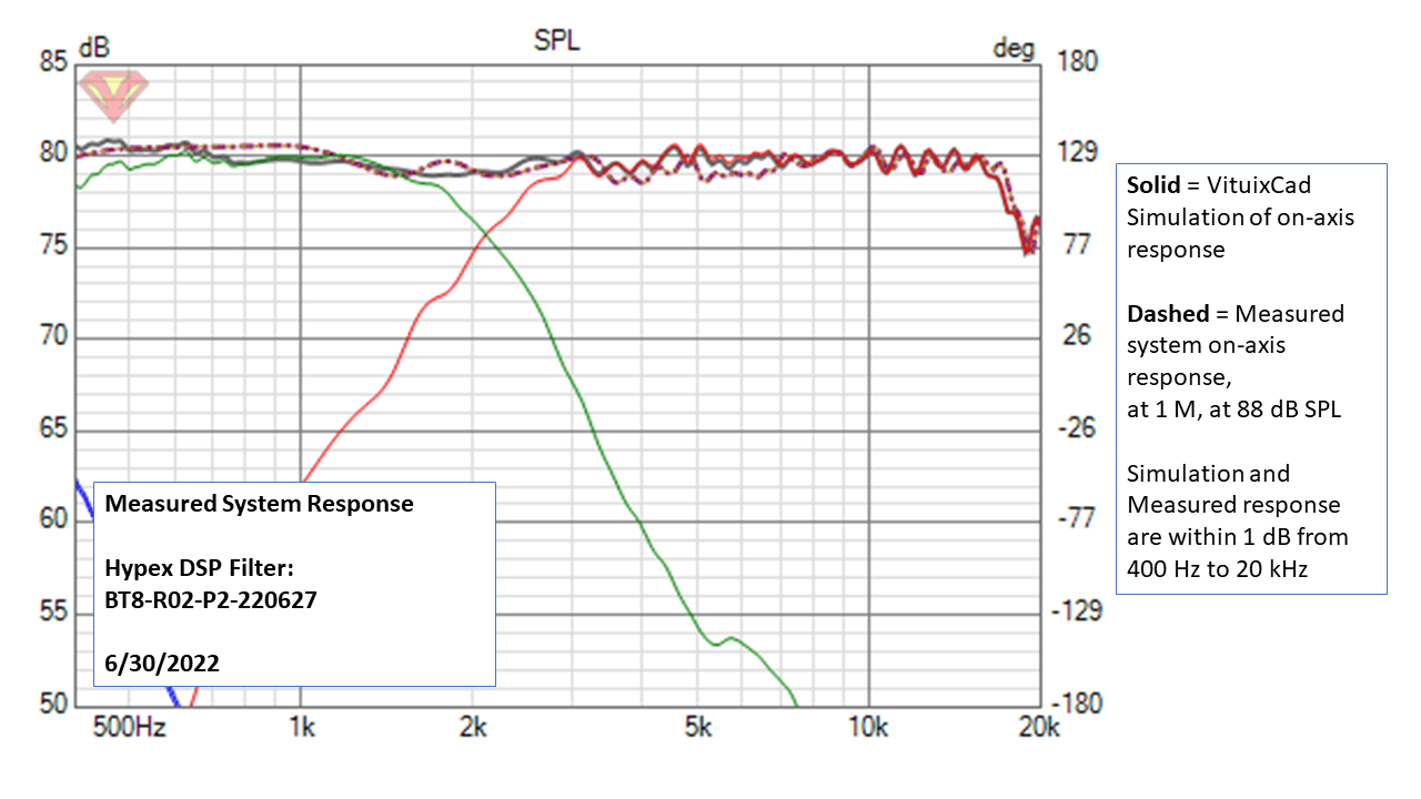

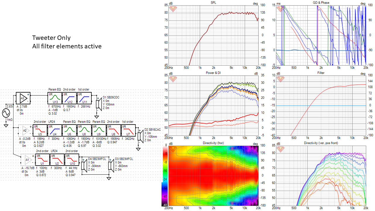

Update: I got the Hypex filter straightened out. Changing the tweeter delay made the big difference, and I also made some minor adjustments to the tweeter and mid filters and the tweeter levels. At this point, the filter elements / parameters in Hypex are very close to the VituixCad simulation parameters. The differences are:
Tweeter:
(1) Vcad 2nd order high pass filter at 1.9kHz has Q = 0.7. Hypex filter is at 1.9kHz and Q = 0.78
(2) Hypex filter has an additional 2nd order high-shelf filter at 5.66kHz, -1.0 dB, Q= 1.0
Midwoofer:
(1) Vcad 2nd order low pass filter at 1.9kHz has Q = 0.947. Hypex filter at 1.9 kHz has Q = 0.71
(2) Vcad has a Parametric EQ at 1.9kHz, -1.7 dB, Q = 5.97. Hypex filter has parametric EQ at 1.8kHz, -2.0 dB, Q = 5.5
All the other filter elements and parameters match. So as I said, minor differences.
The results look good. The VituixCad simulation and the measured system on-axis response are within 1 dB from 400 Hz to 20 kHz. Of course, below 400 Hz my gate window is too small to give a valid measurement.
I am now ready to move on to the next phase, which is hoisting this 70 lb beast onto a horizontal roller table and making vertical polar measurements. First I need to construct the roller table 🙂
j.

Thanks, @hifijim! That tweeter is playing well under 1khz! What a crazy part.Here are some plots to chew on...
j.

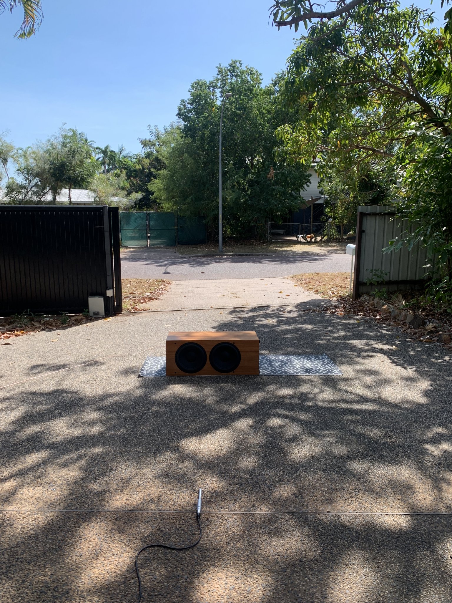

I have done outdoor ground plane measurements in the past on my earlier systems, and I got resolution down below 20 Hz. Due to uncooperative weather, I do not want to make an outdoor ground plane measurement just yet. I do, however, want to evaluate my lower crossover (300 Hz) to make sure it is valid. To do this I do not need resolution into the deep bass, I just need it near my lower crossover.

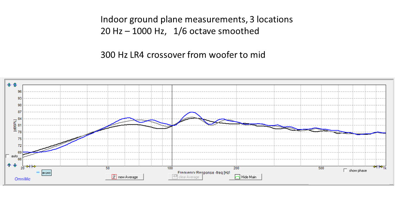

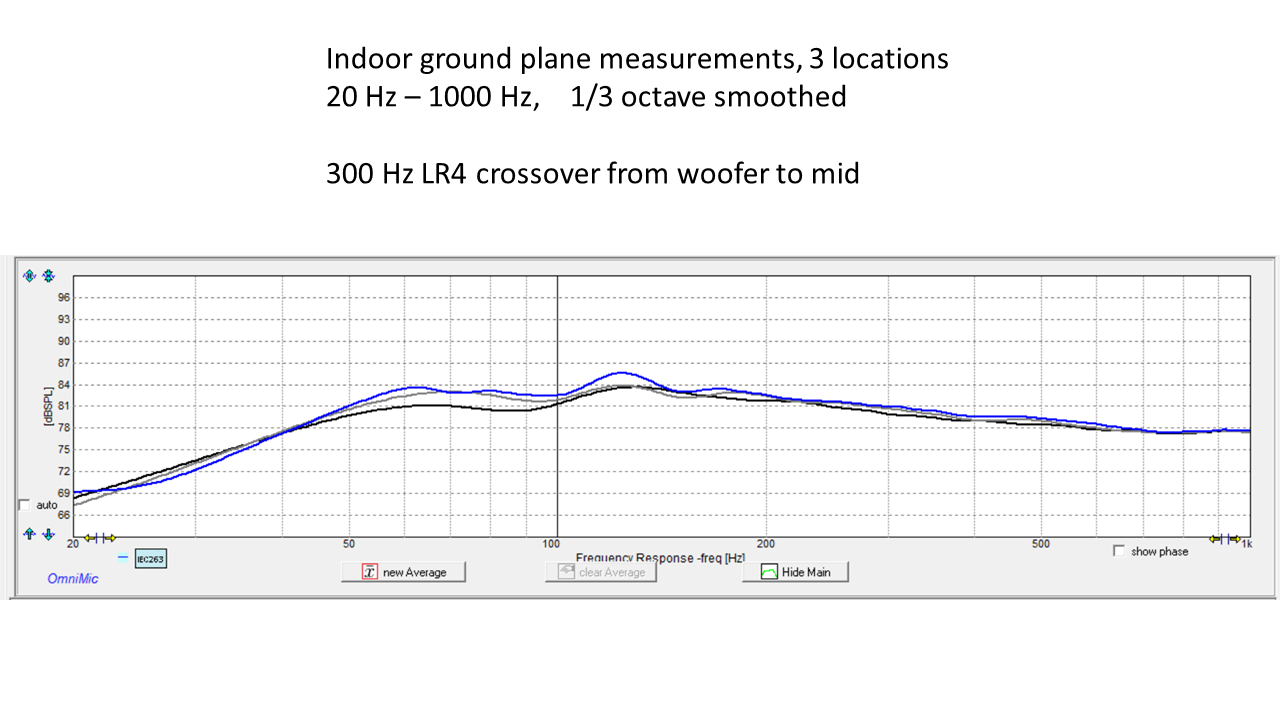

A challenge that we all face with 3-way crossovers is that the lower crossover often lies between 200 Hz and 600 Hz, and this frequency band that is often below our capability to make a gated measurement with good resolution. In my case, I have a 300 Hz crossover between the two woofers and the mid driver. Elevating my speaker as high as I can, with my best possible gate window of 4.6 ms, I have a 1/2 octave resolution down to 450 Hz. This does not inspire confidence in the measurements in the region near my 300 Hz crossover.
I experimented with indoor ground plane measurement. I made measurements with the speaker on its side and the mic flush with the ground at a distance of 1 m. I used both RTA (ungated) measurements and dual-gate measurements which blend a 5ms gate window with a 200 ms gate window. The RTA and dual gate measurements both agreed once the data was smoothed. I Measured 3 different positions to some-what average out the room modes. I also tested the technique to make sure it could pick up a deliberately misaligned filter. To me it looks like I get good valid measurements down to about 180 Hz before room modes start to dominate things.
The results tell me that my 300 Hz crossover is working as intended and is good enough for now. When I do outdoor ground plane measurements, any additional adjustment will probably be small.
j.
When I used this tweeter before, I was able to take it down to 1800 Hz with a 4th order filter. However, distortion starts to be a problem if it is pushed much lower than that. With a waveguide I am sure it can go lower.

later I did the GP technique, first in a field (not enough power cabling, ground not completely flat ) second on a soccer pitch (ground still soft, too loud much background noise)
But when did finally completed it successfully in fine weather, lined up perfectly with the late Jeff Bagby’s blend technique.
so now I wonder if I should bother with outdoor GP… so much work and so dependant on fine weather…
