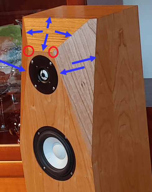

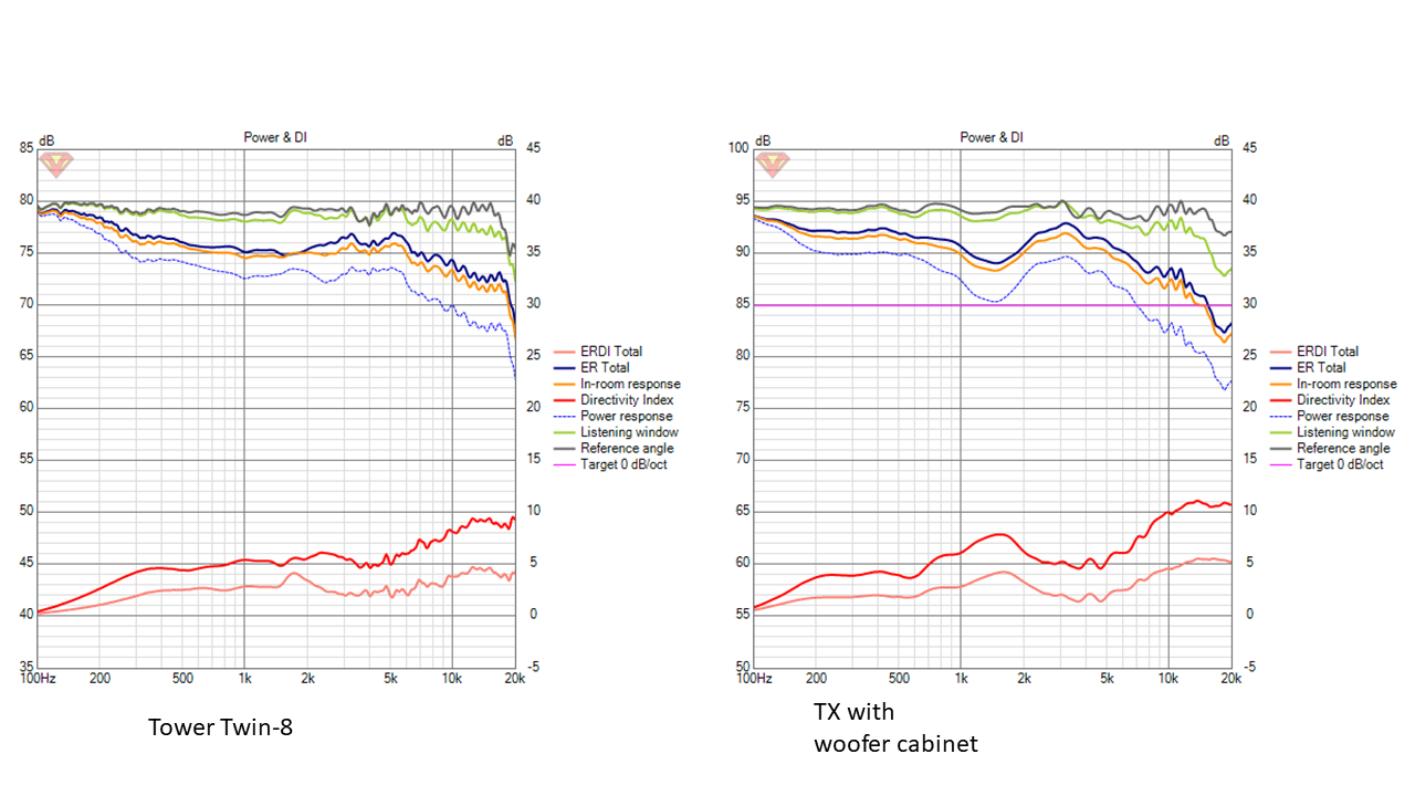

One other thing that came out of the listening session with @HeadShake was imaging performance. I had thought the TX system had a slightly better performance in this aspect, and it was one of the first things Headshake commented on when we switched from the Tower Twin-8s to the TX system.

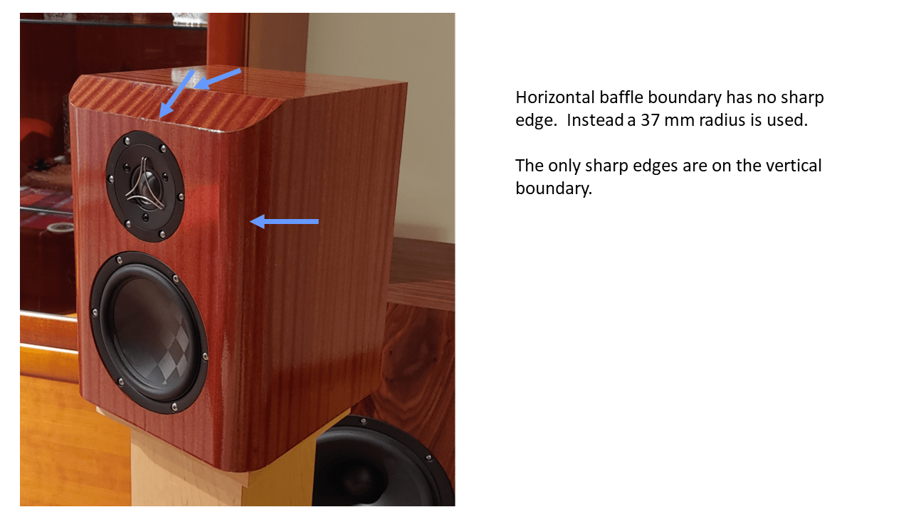

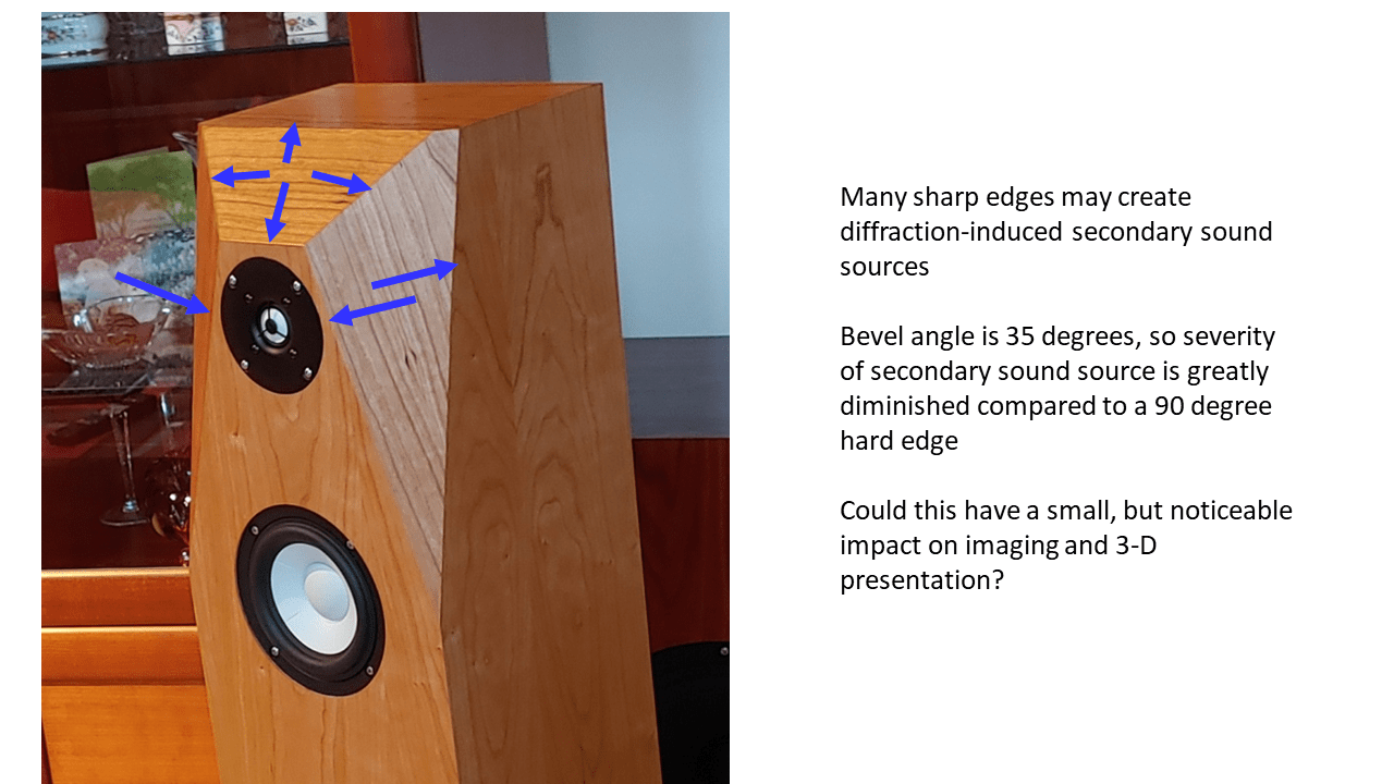

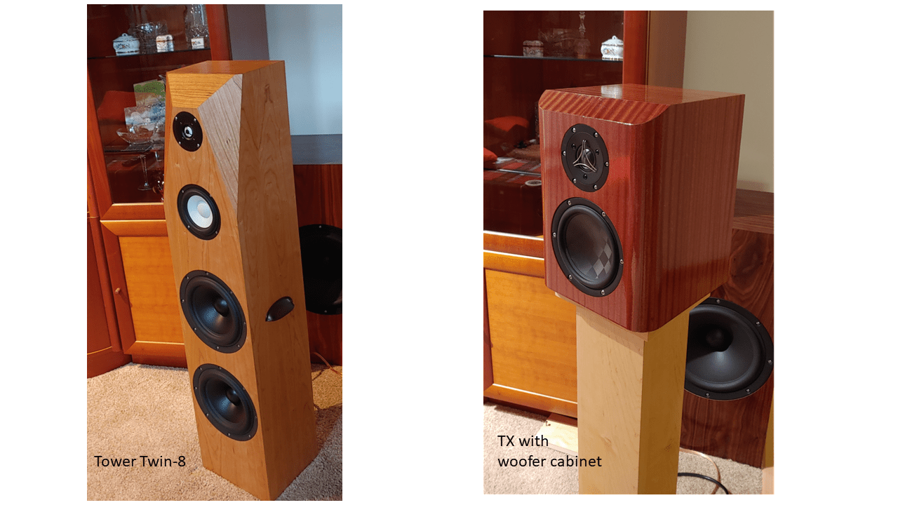

We discussed this for a while, and tried to understand why there would be a difference. We came to a plausible theory: The facetted bevels on the Tower Twin-8s have a lot of sharp edges. This was necessary because I wanted to veneer them. The bevels form a 35 degree angle to the front face, so these are gentle bevels, but still there is a sharp edge. Is it possible that these sharp edges could be producing a diffraction secondary sound source? Not as strong as a 90 degree edge of course, but still enough to slightly, ever so slightly, degrade the imaging performance?
The TX system has no sharp edge on the horizontal, it is gently radiused at 37 mm. The top edge is beveled at 45 degrees, so this would leave two sharp edges, but I suspect that a secondary sound source in the vertical is much less important than in the horizontal. The first sharp edge that the sound encounters on the horizontal is at the back of the cabinet.

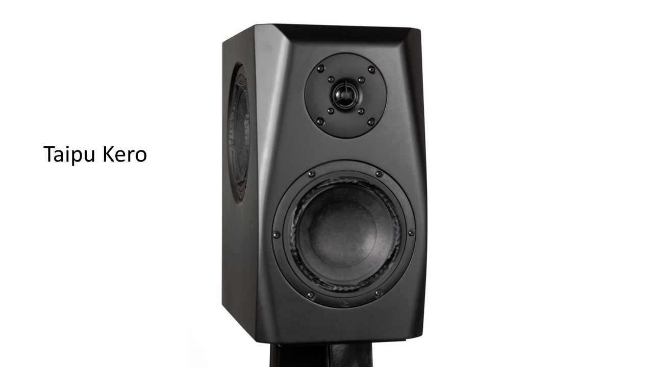

I have noticed that several recent designs use tapered bevels that have a rounded edge. An example would be the Taipu Kero, which I believe is a Kimmo Saunisto design). Is this rounding more than just cosmetic? Does it soften the secondary sound sources and enhance the imaging performance?
Thoughts on this theory?

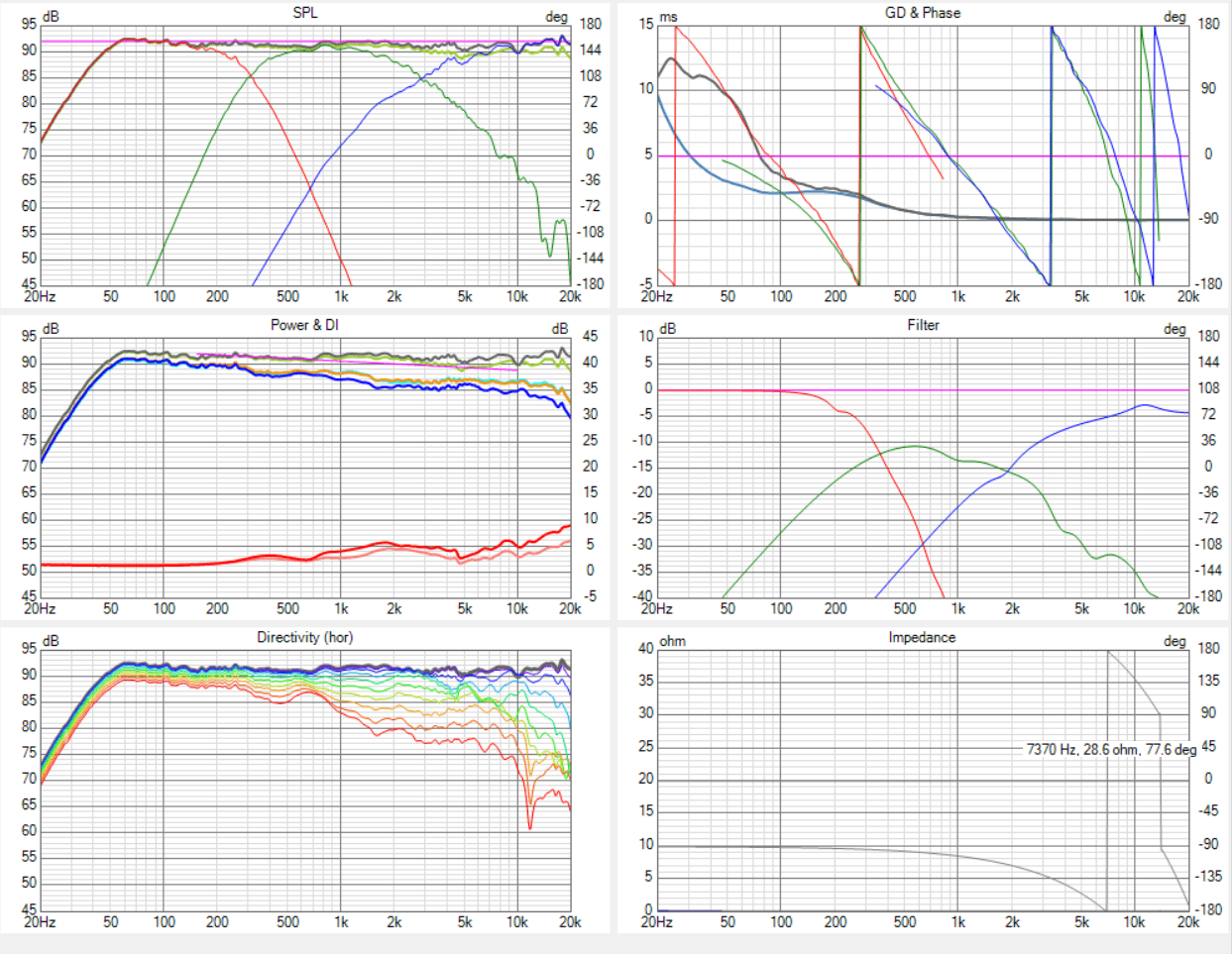

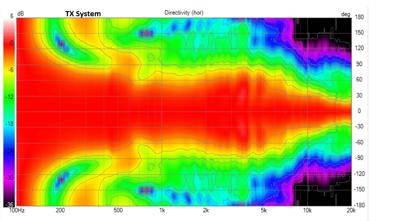

I also included the Power and DI charts for both speakers. Both speakers are +/- 1 dB from 100 Hz to 15 kHz on axis. But the DI curves are different. The TX system has a -4 dB dip between 1k - 2k, while the Tower is much better behaved.

Did you see that study facets vs roundovers. It's clear to me that roundovers are superior, the downsides is that it's just very difficult to veneer a large roundover. And besides, not everyone likes the look of a bubbly/rounded shape object.
The DI of the Twin Tower 8 is better. But the TX doesn't seem to be harmed by the directivity mismatch. Very interesting
Here's my speaker- no roundovers or facets or waveguides. Directivity mismatch around 4.5Khz due to hard edge diffraction.
But I don't think a drop @4Khz ever hurt anybody.

The tapered bevels do not simulate as causing any real diffraction but it would take quite a lot of mesh resolution and frequency points to see everything at high frequencies.I have noticed that several recent designs use tapered bevels that have a rounded edge. An example would be the Taipu Kero, which I believe is a Kimmo Saunisto design). Is this rounding more than just cosmetic? Does it soften the secondary sound sources and enhance the imaging performance?
The intersection points would be the most likely culprit of measured diffraction, the rounded facets smooth those out and present a more ideal transition, apart from difficultly in construction there is no down side to doing so.
I suspect the more likely cause is that the TX system is higher in directivity particularly at high frequencies, this will give more time between the direct sound and reflective surfaces. That really does have an effect on imaging, particularly being able to identify the sound as coming from a particular location.
My takeaway is that it is actually really hard to compare two things that are not the same if you are looking for a definitive conclusion.Did you see that study facets vs roundovers. It's clear to me that roundovers are superior,
The limit to which the number of facets approaches infinity, is a round over. So I don't think they are NOT the same.
It is hard to make sure that effective baffle width and other factors are not having a confounding effect and that you are actually seeing the difference from the edge treatment without something else superimposed on top.
Edit: The measurements stand for what they are, it is the interpretation of them to create some kind of generalised rule where things seem to break down.

I recon if I was a soundwave, I'd prefer a roundover to an edge. Shame, its so damn hard to veneer roundovers.

I like that theory, Fluid. Both systems create a convincing 3D image, but it is just slightly better with the TX system. However, when I pull the towers out into the room by an additional foot, the imaging improves a bit, and "a bit" is all it takes. When I do this, I am getting a bit more direct sound and a bit less early reflections. This all makes sense in the context of your theory. Unfortunately, this location is not friendly to the upper bass.I suspect the more likely cause is that the TX system is higher in directivity particularly at high frequencies, this will give more time between the direct sound and reflective surfaces. That really does have an effect on imaging, particularly being able to identify the sound as coming from a particular location.
So true. We can often subjectively assess that something is not quite right, but attributing that to a specific cause is very difficult.It is hard to make sure that effective baffle width and other factors are not having a confounding effect and that you are actually seeing the difference from the edge treatment without something else superimposed on top.

For my next project I will probably use a solid baffle so I can freely profile it and maintain good aesthetics. I am thinking about a new mid-tweeter head unit, using a Bliesma T-34B and a Purifi PTT6.5M04-NFA-01. I want to go further in the direction of diffraction control, and take steps to minimize diffraction on the sides and rear of the cabinet. I have not decided if I want to use a waveguide yet. These are just musings at this point.

The center image of the towers was very wide vs the tight spot on the TX. It made me wonder if the close spacing is a good thing or if something else was going on. I preferred the tighter spot of the TX.
A few days ago, @HeadShake came over and listened to both systems. He immediately noticed that the TX system was more 3 dimensional and that the image extended beyond the speakers, whereas the Tower Twin-8 image was contained to the region between the speakers. The TX system portrayed image height and depth better. He thought the bass, upper bass, lower midrange of the TX system was superior. He stressed that the Towers sounded extremely good, and it was only in comparison to the TX system that they showed their limits.
We both agreed that the Towers look really sharp. It is by far the coolest looking speaker I have ever built. It is also the most time consuming and difficult construction I have done so far.

The wider image that HeadShake reports once more suggests that directivity properties where critical in the perception of the systems. Jim, would you like to export the horizontal sonograms of both systems once more, with the span compressed to 30 dB, and in vCad options the ratio for the graphs set to 34 dB instead of 25? Obviously, DI index tells the story too, but anyway, just for fun.
