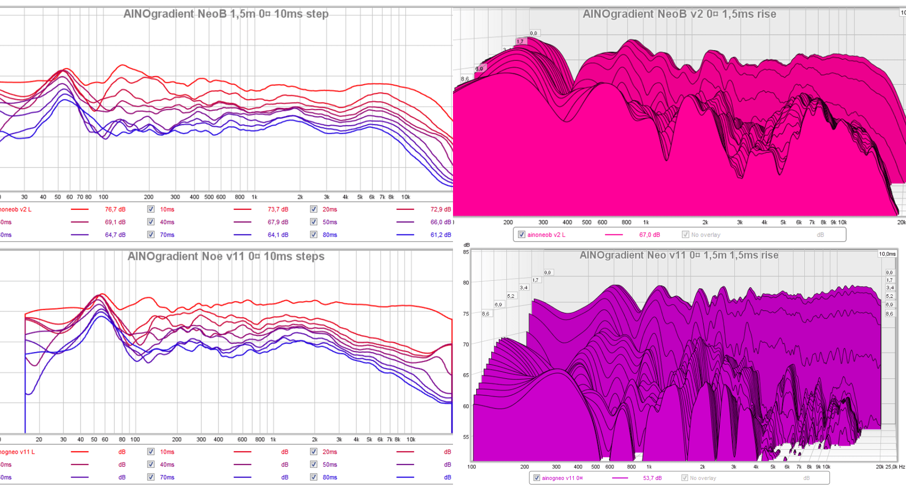

Difference in radiation pattern can easily be seen in decay of a room measurement.
My AINOgradients evolution has three different stages - first was Fountek ribbon with deep waveguide, then added with backside dome, finally planar with open back. Speakers are dipole from 150Hz up, until tweeter looses dipole pattern and behaves like two opposed monopoles with increasing directivity. All these do sound very different, I set them up to have similar response 0-30deg frontal on-axis (quasi-anechoic). The diffrencies happened wider than 30deg and on the backside. Decay shows bigger difference than listening spot response.
Here Fountek with and without backside dome. Dome was pointed 45deg up.

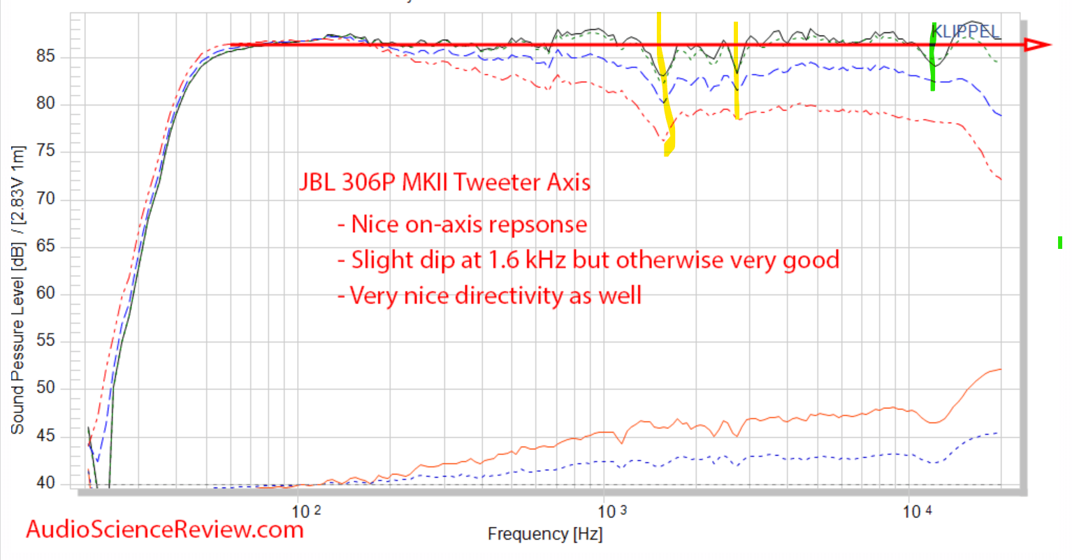

That is diffraction
Probably need to rethink that one as well, the frequency response dips there in the measurements and for the main one at 1.6KHz that is due to the crossover. Time and frequency are linked you cannot look at one without seeing the other, you can trade resolution of one to the other and some things are easier to see in one domain or the other because of this. The waterfall dips line up with the FR dips marked in yellow, green is a dome waveguide interaction that disappears off axis. A waveguide can be made to be very flat on axis and linear off axis, but mostly there is some on axis wiggle left which disappears off axis. Without having simulated the waveguide with an ideal source, it is hard to know what comes from the waveguide or from the driver itself. A dome tweeter on it's own depending on the baffle will tend to do the opposite, flat on axis and wiggly off axis due to diffraction.

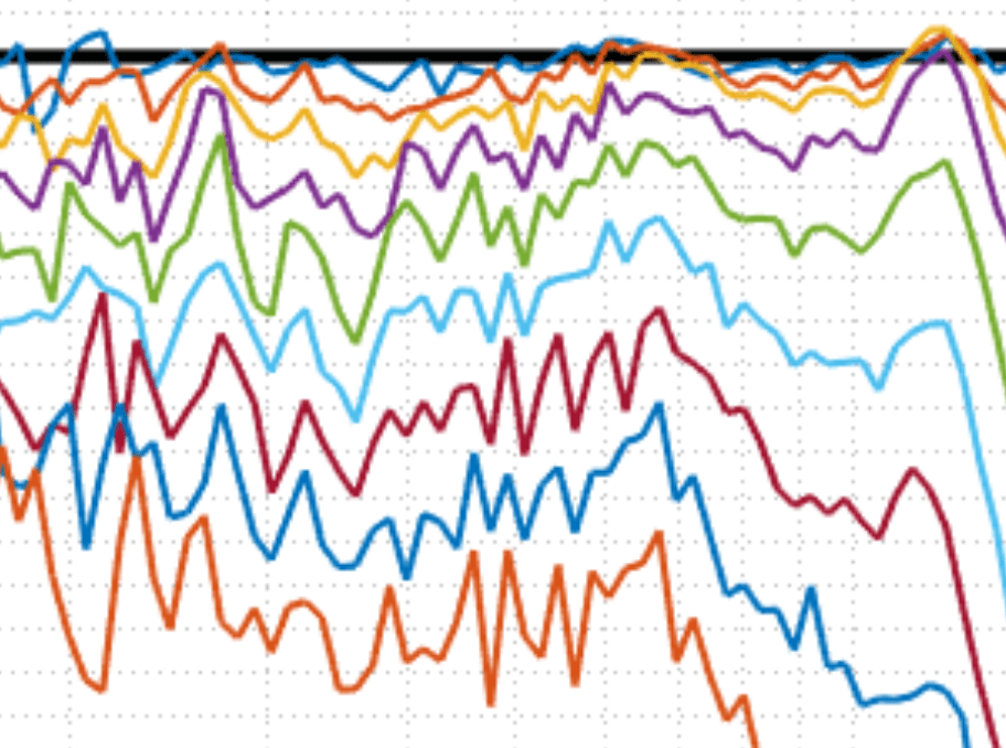

I think I have a better image that shows what I see in sims.
Notice how if you go off-axis the peaks/dips are all in the same places but they can be seen on-axis. I see over a dozen lines. The sound power of anything that is trying to bend a round shape will kick back all kinds of mess. A horn/waveguide is a controlled mess and cannot be flat on and off-axis.
It is kinda like:
on-axis, no teeth. As you go off-axis, the same teeth get longer and longer.

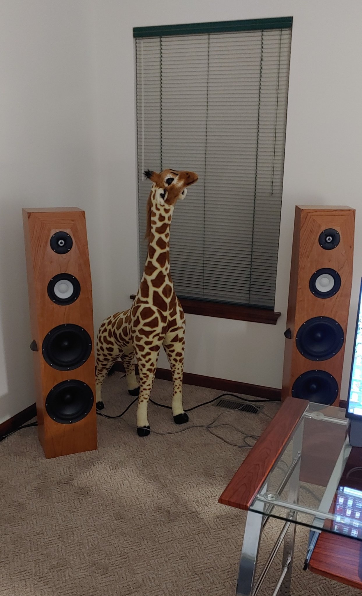

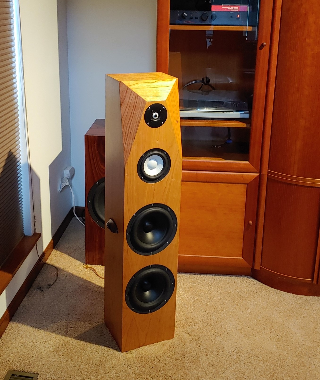

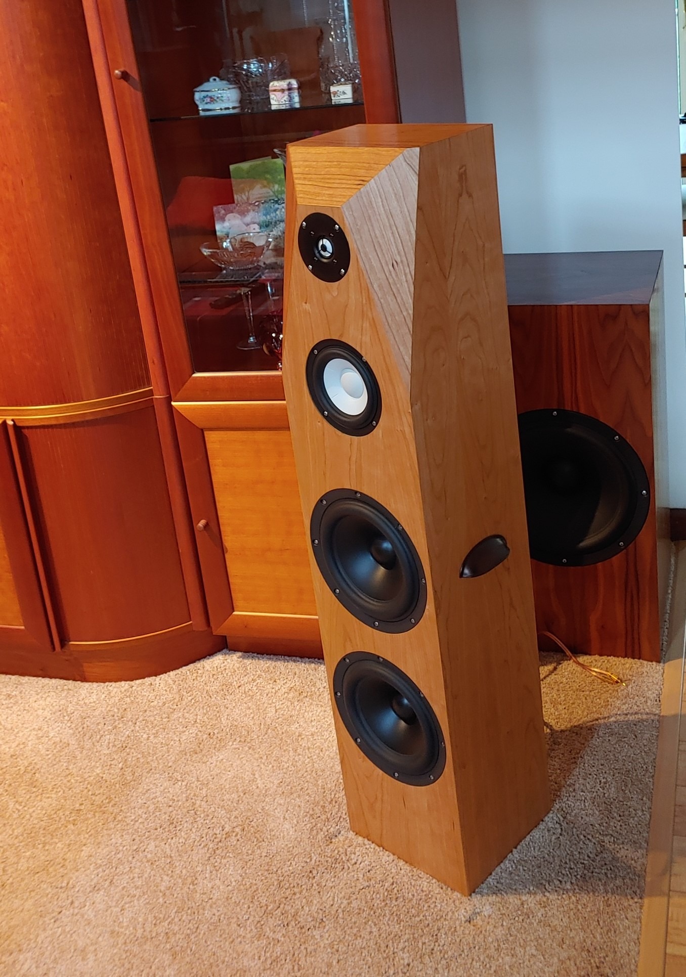

Photos of the finished project in the listening room. I realized I had not posted final pictures.
In my opinion, dipole or wide dispersion monopole are best for stereo in big rooms. Coaxial or other narrow dispersion monopoles (or even cardioids like D&D or synergy horns) are best for HT, nearfield and small and damped rooms. I have never heard hifi line arrays, so I can't give a recommendation about them. Any type of speakers can have smooth and wide spl response and low distortion, so that aspect is not an issue.
They all give different imaging and spaciousness, and finally personal preference will vary! Everyone should give a chance for each type of speakers - visit audio shows and hifi-friends, listen and discuss!
Agree.
One of the reasons I've built so many speakers is that different rooms need different speakers.
Agree. In a different room, the tower twin-8s could sound better than the TX system.

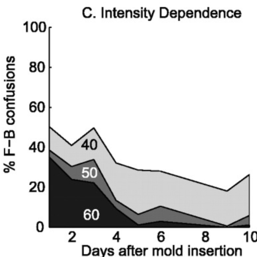

There is a paper on changes to the shape of the ear and how long it takes for the mind to adapt to change. What is interesting, is the very first day of any ear change, people have perceptions that are beyond any later perceptions. It is like the brain does not know reality and it guesses wildly. After about a week, most people adapt to the change in ear shape and correctly perceive sounds.
https://pubmed.ncbi.nlm.nih.gov/15930391/
The diff. colors are showing changes to the volume. When sounds are louder, we have less confusion. But still, day one is not as good as day seven.
It is not 1:1 to a changing out a speaker, but I always think of this paper when listening and comparing. Perception is not instantly correct. The brain takes time to have correct plasticity.
I can't argue against what you heard but there is an explanation for how perception can change over time.

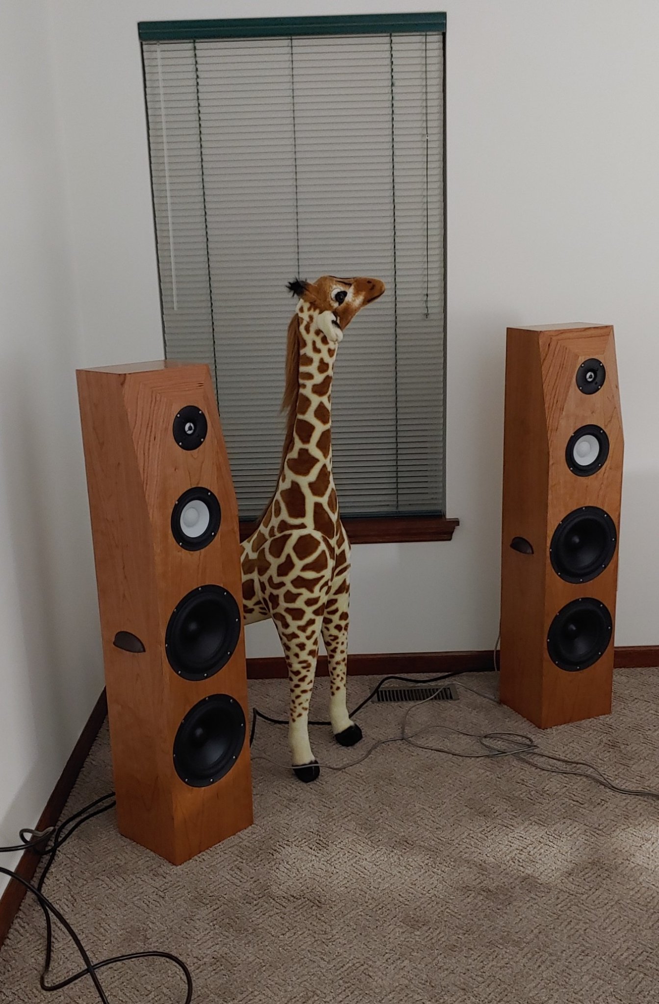

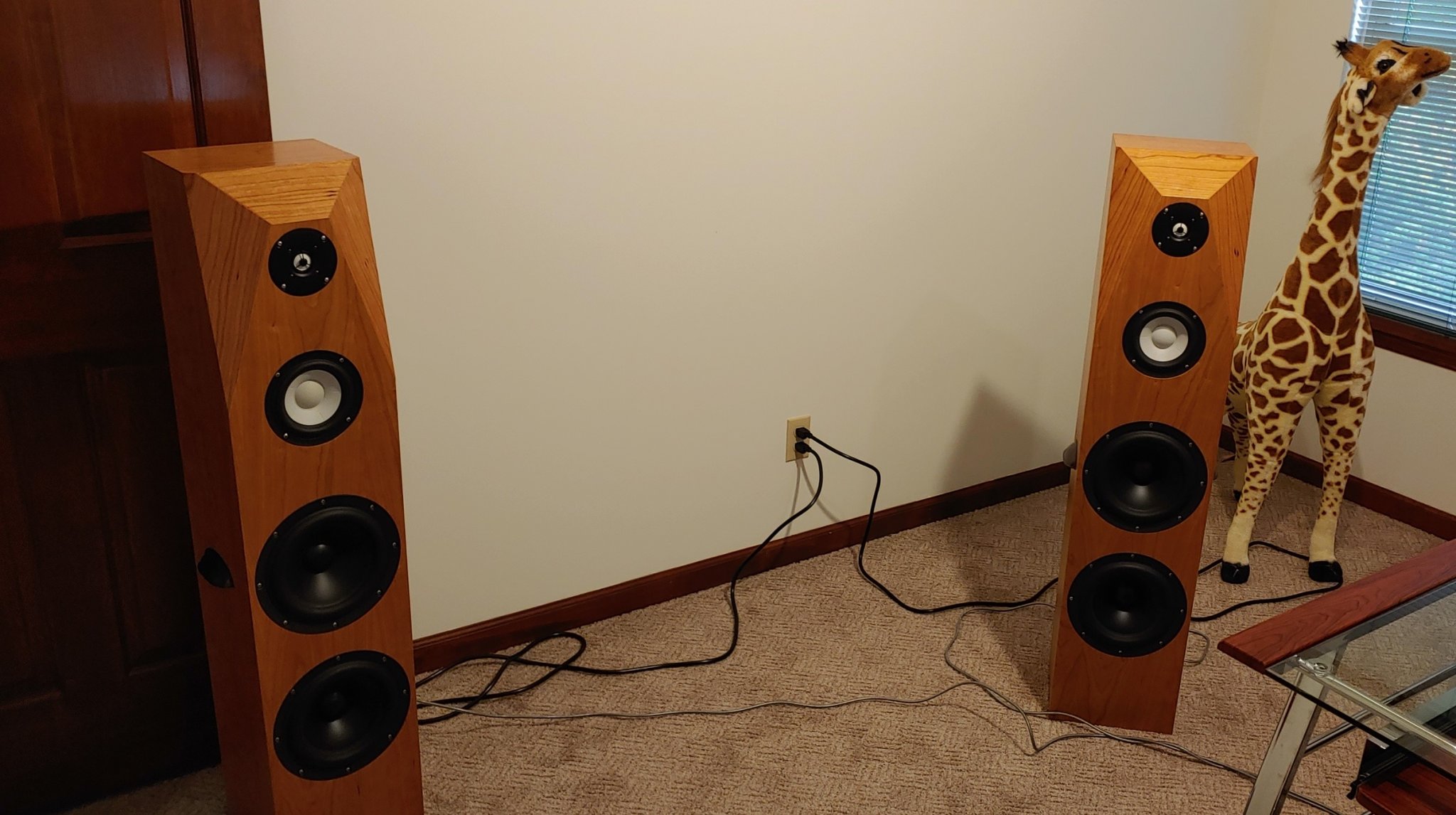

I have been moving these speakers around to different rooms and positions. One thing I have noticed is that they are very tolerant of room size/shape and positioning. My office is 10.5' x 12' x 8' high... not great dimensions. The walls are completely bare, there is minimal furnishings, and the only absorption in the room is the carpet. Yet these speakers sound pretty good in here. Tonally they sound right. I found two positions in which the sound quality was quite nice and the imaging was very good. Given the size of the room it is almost a near-field situation.
To get the best spatial and imaging performance out of these, there needs to be more space around the speaker than I need with the TX system. But even with sub-optimal placement, they always sound reasonably good.
Of course this is the promise of a smooth DI which is either flat or slowly increasing. But it is nice to experience it.
I now wish that I had allowed Headshake to listen to them in their optimum position. I think their imaging/spatial illusion is as good as the TX system with the right placement. In terms of dynamics, clarity, bass performance, detail, and a sense of naturalness, the TX system still has an edge. But the towers are very very listenable. No regrets.
