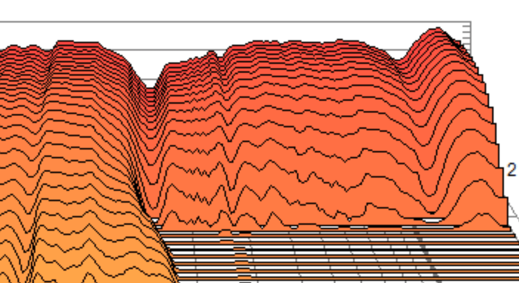

Well, while kimmo says that DI graphs are all you need nowadays, everytime I see a sonogram I find it easier to see things.
1) In post #303, fluid suggested the TX system was more directive. But from the graphs, a significant difference is only beginning at around 8 kHz.
2) Between 2 - 5 kHz the TX system is radiating wider and with much more energy (-3 dB pattern considered) than the towers.
We would probably agree that the range between 2 - 8 kHz is more recognizable and effecting the perception of a system to a higher degree than the spectrum that lies beyond. At least I would be surprised, if the slightly lesser early reflections between 8 - 20 kHz of the TX system were more noticable than its significantly higher early reflections from the presence region up to brilliance spectrum, compared to the towers.
Lately, there was this discussion where Earl Geddes mentioned his hypothesis of a zero-sum game between spaciality and imaging. In post #301, Jim you where mentioning the better imaging performance of the TX system. I would, however, assume from the graphs that what you had heard was enhanced the spaciality of the TX system over the towers.
This is obviously a hypothesis from afar.

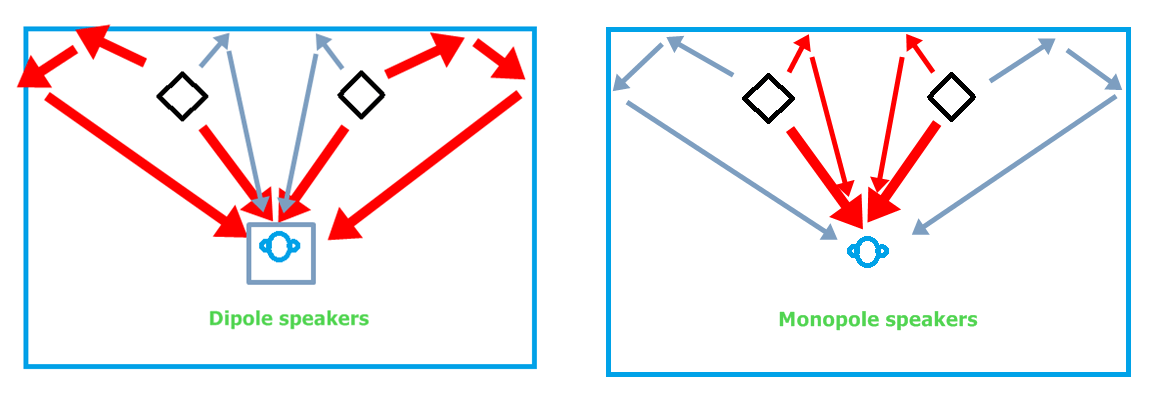

This is the explanation why I and some other dipole fans love their speakers. Positioned on the long wall of the room, dipoles give good localization with direct sound, and give lots of late reflections for spaciousness. But for this to happen, they do need a rather large and moderately reflective room - not often possible. For nearfield and monitoring, as well as home theater, coaxial monopoles are best IMO.I certainly don't want to analyse what other people think they heard 🙂

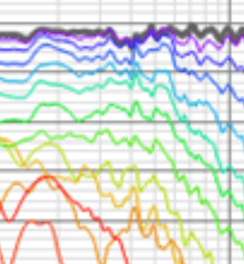

Narrow vs wide directivity, a good waveguide if not all waveguides are minimum phase devices so the phase follows the frequency response. Exponential horns have a defined cutoff frequency where the frequency response drops off rapidly and consequently so does the phase. This is why they should generally be used an octave above cutoff.I think Dr. Geddes is doing a horn vs infinite baffle comparison. Does anyone have a graph of the GD of a horn? I kinda assume horns break time/phase but have the benefit of not lighting up the walls.

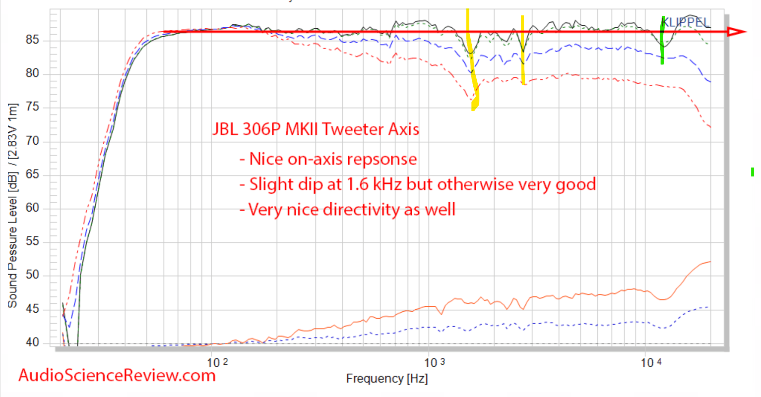

This is from the jbl 306p. Those dips are what I am talking about.
That is diffractionIn hifijim's data you can see at 3-4khz there is a dip on-axis but the power is more even off-axis. Now imagine a frequency trying to have a phase shift moving forwards or backward. The inversion causes a cancellation on axis and can make the on-axis sound different than the room sound. This is my guess anyways.
Probably need to rethink that one as well, the frequency response dips there in the measurements and for the main one at 1.6KHz that is due to the crossover. Time and frequency are linked you cannot look at one without seeing the other, you can trade resolution of one to the other and some things are easier to see in one domain or the other because of this. The waterfall dips line up with the FR dips marked in yellow, green is a dome waveguide interaction that disappears off axis. A waveguide can be made to be very flat on axis and linear off axis, but mostly there is some on axis wiggle left which disappears off axis. Without having simulated the waveguide with an ideal source, it is hard to know what comes from the waveguide or from the driver itself. A dome tweeter on it's own depending on the baffle will tend to do the opposite, flat on axis and wiggly off axis due to diffraction.My other observation is a horn cancels itself at some frequencies and can never be extremely flat. I still think this is true.

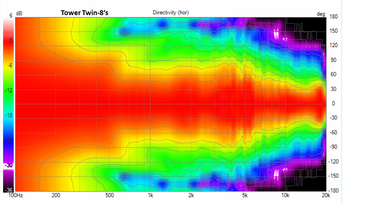

- New Project - tower 3-way with twin 8s
