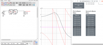

Kimmosto is talking about this (group delay) a lot and I get impression this is one of main reason(s) he seems to prefer 2 way speakers. Rule of thumb from his posts to keep excess group delay below 1ms at least to 100Hz or below. Audibility treshold of group delay is quite clear with multiple studies but its again a bit hard to isolate I think, with all other aspects that change with change in crossovers. Kimmosto describes group delay affecting initial pressure hit of transients and its magnitude, group delay makes it smaller in a way, less sensible. Its sensed more with skin and eyes for example than with ears and I think this is the reason he often says that tests on group delay with headphones are somewhat flawed as the critical sensation of tangibility does not come through as well as with loudspeakers. All this is moot with FIR processing as the group delay can be manipulated at will and is no issue.
Here is one such study where audibility thresholds of group delay are plotted https://www.researchgate.net/publication/352265058_Audibility_of_Group-Delay_Equalization/download

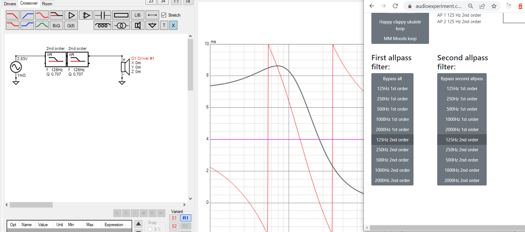

Here is hidden test https://audioexperiment.com/pages/group-delay-test-on-headphones/ which is work in progress as it was made copy pasting from the crossover test linked earlier and might contain errors. If you like you can try it though. You can inspect the group delay in VituixCAD, add active allpass blocks change its frequency and order to inspect what the group delay should be. The listening test uses web audio api biquad blocks and I've just copypasted biquads from VituixCAD to it.
For example two 125Hz 2nd order all pass filters make ~8ms at 100Hz. With only two cascaded allpasses its possible to make group delay that is barely audibility threshold and I should add few more stages so that the effect becomes clearly audible. But, if you don't hear any difference (assuming there are no errors how the listening test is implemented) then do not be affraid any sensible crossover won't make such crazy group delays and should not be audible.
Group delay is of course affected by diffraction for example, resonances, or bass alignment, so those could affect audibility irrespective of crossovers used I think.
