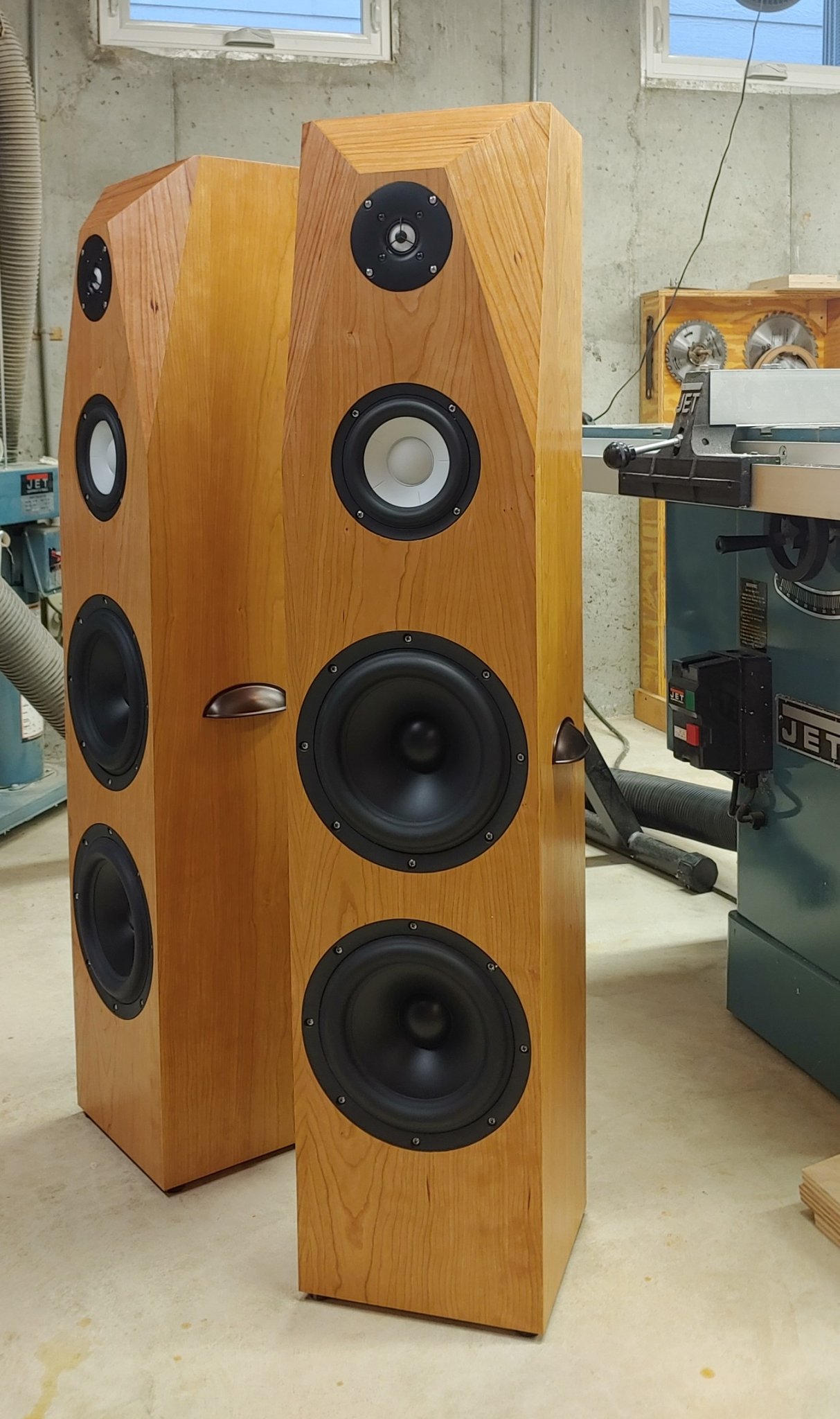

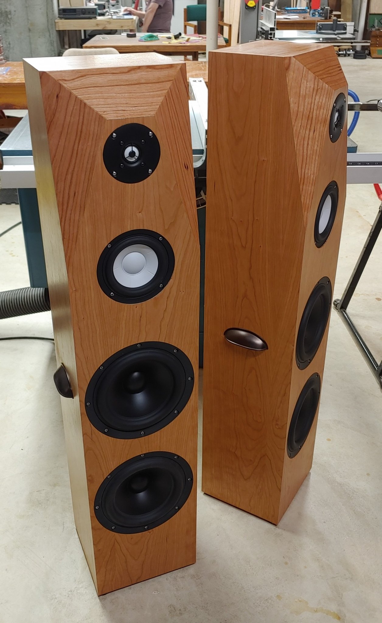

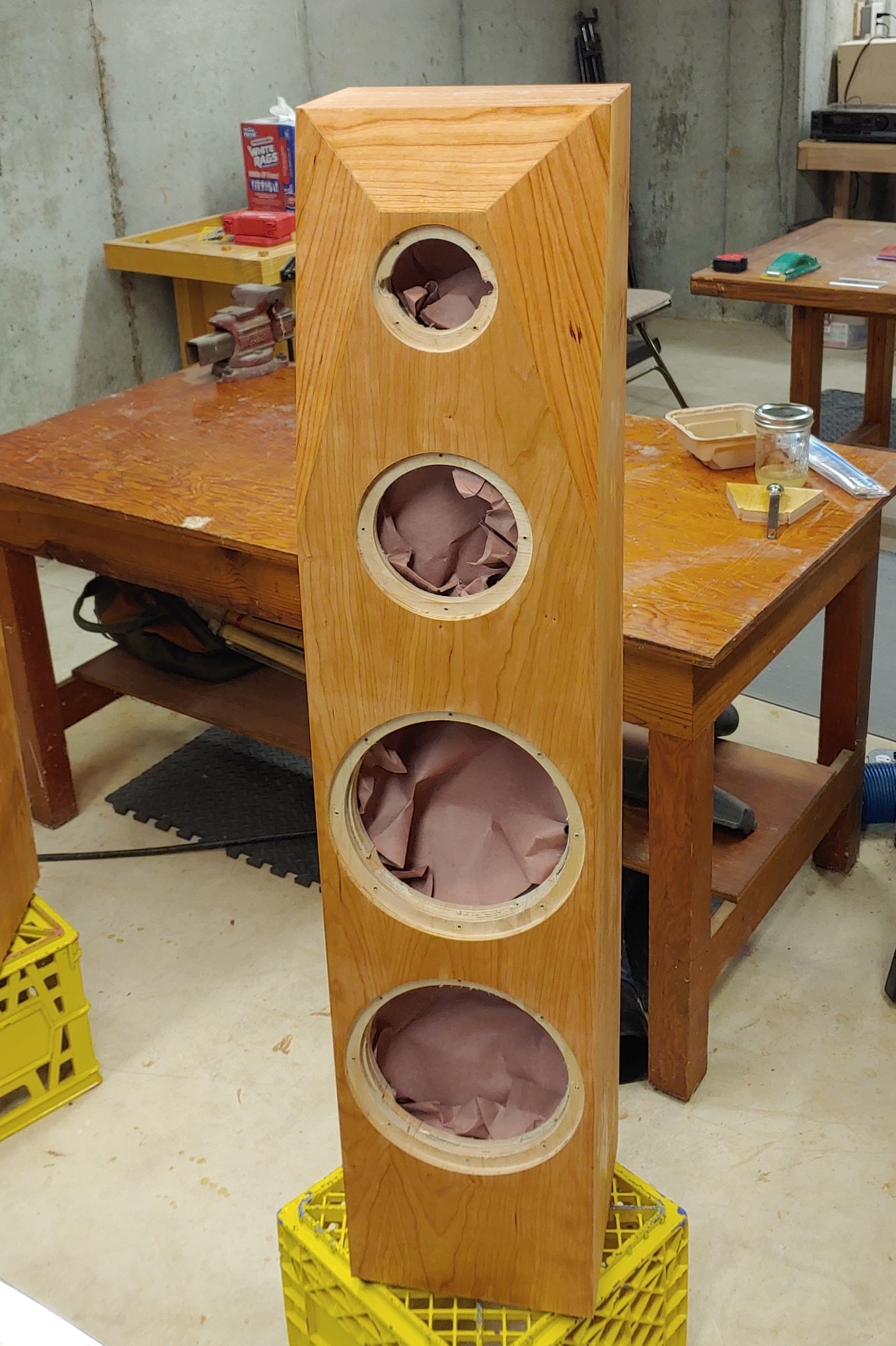

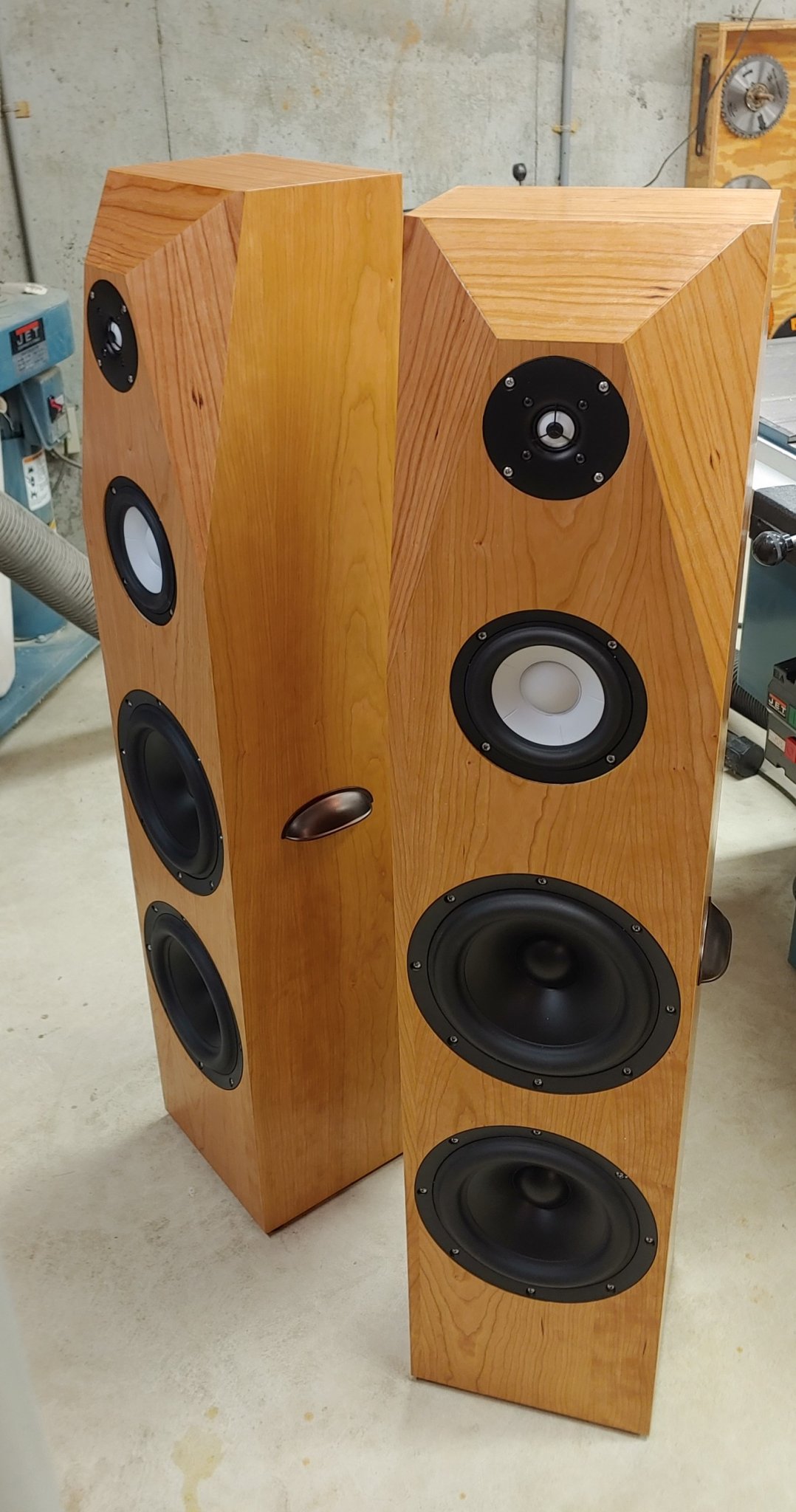

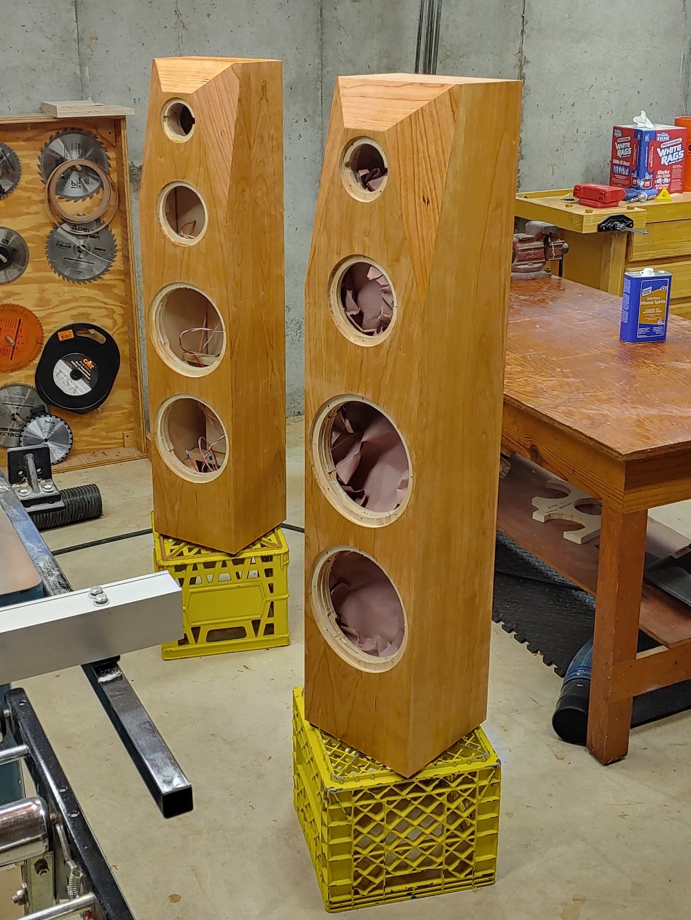

I am ready to begin the next round of testing and DSP filter development. Cabinets are finished, drivers installed.
I am pleased with the look of the natural (non-tinted/non-stained) cherry. Years ago, I built a lot of cherry furniture with a natural finish, and it tends to slightly darken over time, and the reddish rose tints become more prominent.
I installed bronze handles, the least obtrusive I could find. Without handles, it is impossible for a single person to carry these. Even the process of building and finishing them was difficult because of the weight (and I am not 30 years old anymore!)...
Back in post#88 I considered making each cabinet in two parts, a woofer box, and a mid-tweeter box to sit on top. Vineethkumar is doing his project this way. I definitely see the attraction, after wrestling these beasts around my workshop for the past month. I don't think I will ever again build a single-box loudspeaker of this size again.
If I get time tomorrow, testing will begin

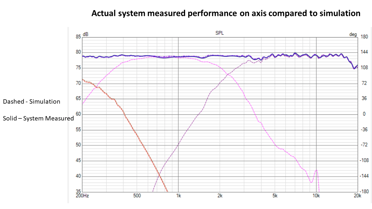

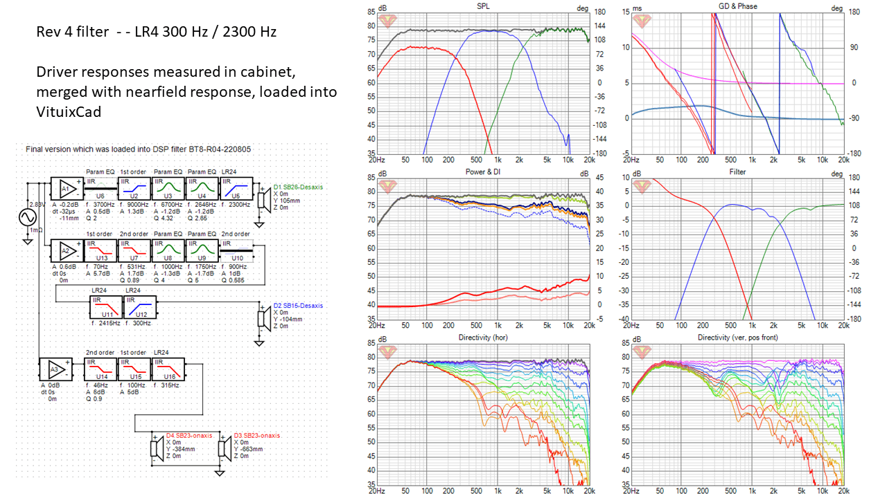

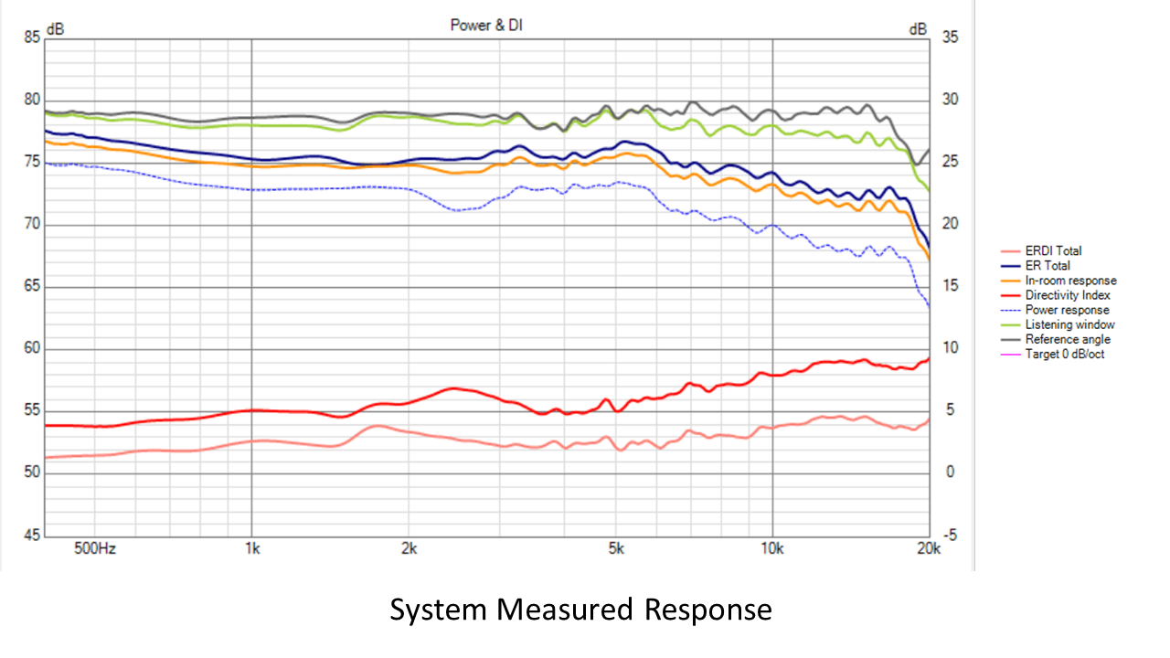

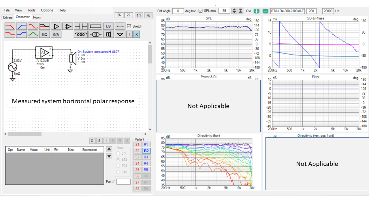

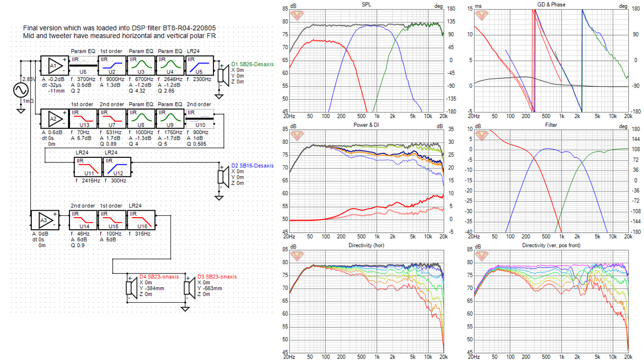

I have completed the next phase of testing. I made a new set of horizontal polar measurements of each driver, 0 – 180 degrees in 15 degree increments. The speaker was elevated such that my gate window for both the mid and tweeter was a bit over 5 ms before the first reflection (floor). I made a new set of near field measurements of each driver, and these were merged with the far field gated responses in accordance with VituixCad instructions.
Using these new measurements in Vcad, I developed a new DSP filter. The goal of this phase of testing is to achieve a close agreement between simulation and system-level measured results. To make developmental testing easier, I used 4th order filters so that all drivers are in-phase. I also decided to make the on-axis response flat, which also makes development and evaluation easier. Final EQ to achieve a desired in-room response can be easily added at any time.
The filter I developed has a moderate level of driver EQ, Linkwitz Transform on the woofers, and LR4 crossovers at 300 Hz and 2300 Hz. It is not optimized for DI performance, and I don’t expect this will be the final DSP filter, but it is a good filter to make evaluations and comparisons between simulation and test.

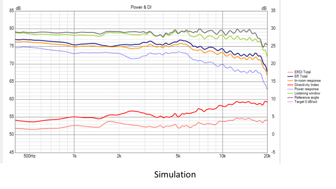

In my previous system level testing, the off-axis response from 2k to 5k was about 2 dB higher than the simulation (post #237). This was my prime motivation to re-conduct this testing. I am quite pleased that with the new test data, I have extremely good correlation between simulation and system level test results.
The system level measurements are horizontal polar… I made no vertical polar measurements. Therefore I blocked out the “Power & DI” plot because it is not valid.

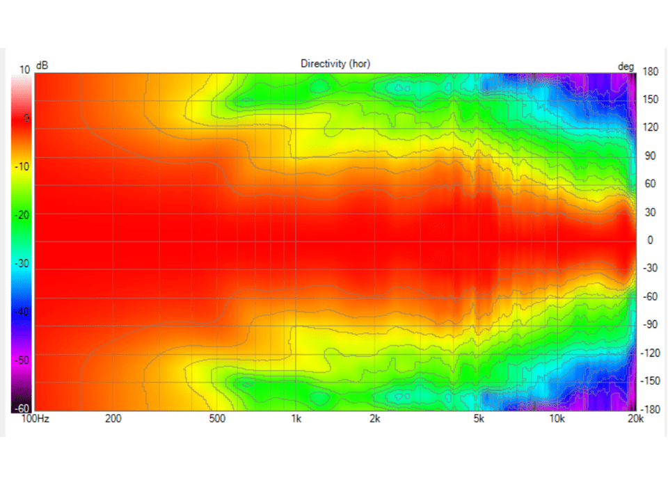

A few other things I want to point out.
In slide 4 and 5 above, the detailed horizontal polar plots, I show response from 500 Hz up. I don't want to show data lower than 500 Hz because that is where I merge the near field response. I do not fully trust the directivity data below 500 Hz. My room is simply not large enough to get good resolution below that, and Vcad is probably making a software-best-estimate of polar response in the region below merge... so it is not really measured data. And this is fine. This speaker is a sealed box design, and I don't need measurements to know that it becomes omnidirectional (DI = 0) somewhere between 100 and 500 Hz. I would need to measure directivity down to 100 Hz if this was a cardioid design, or a MEH perhaps. But it is not.
The next step will be to make vertical polar measurements of the system, so I can verify the simulation prediction of DI, ERDI, and other power related responses. But first I have to modify the rotating table to accommodate the handle and to ensure it does not mare the finish.

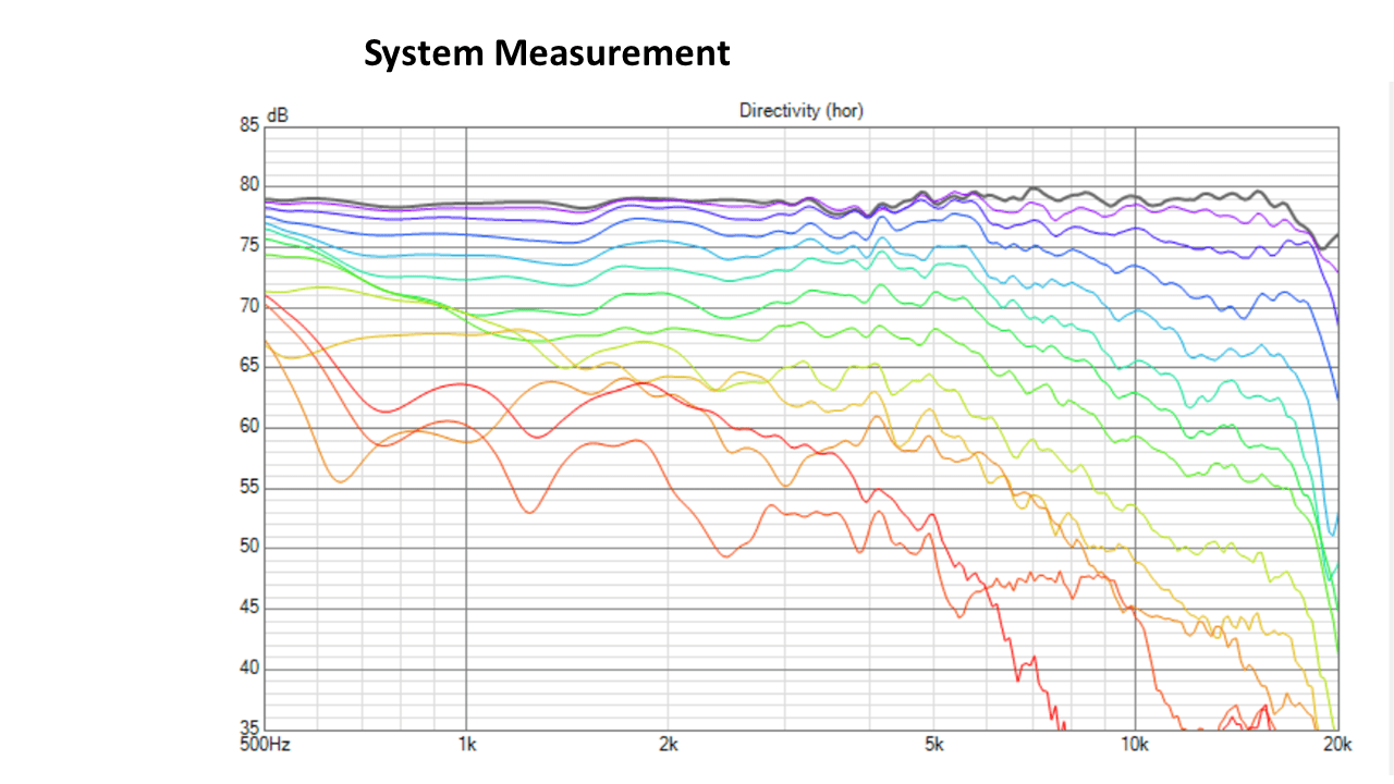

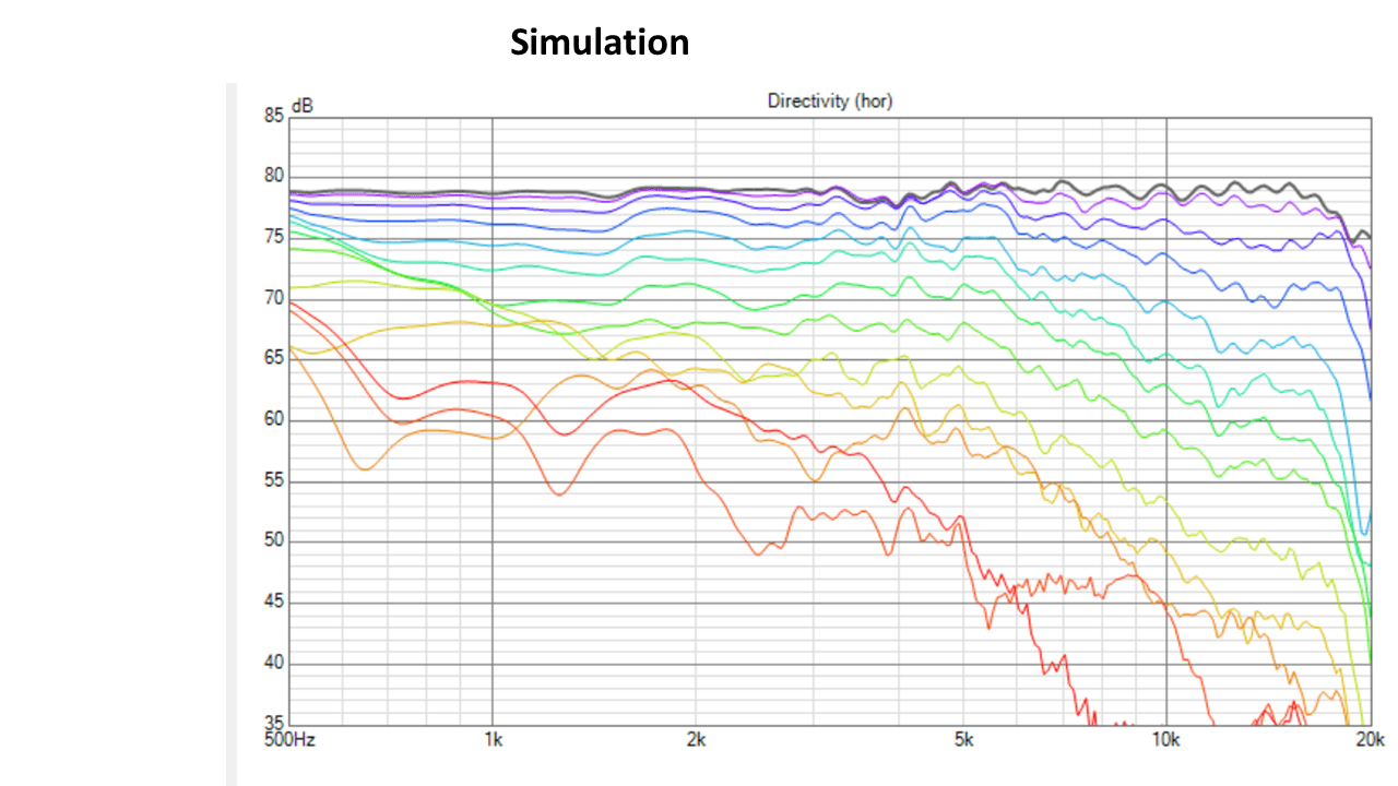

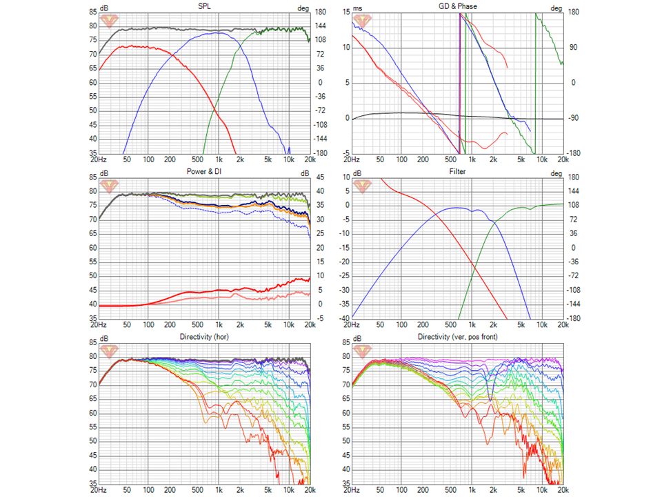

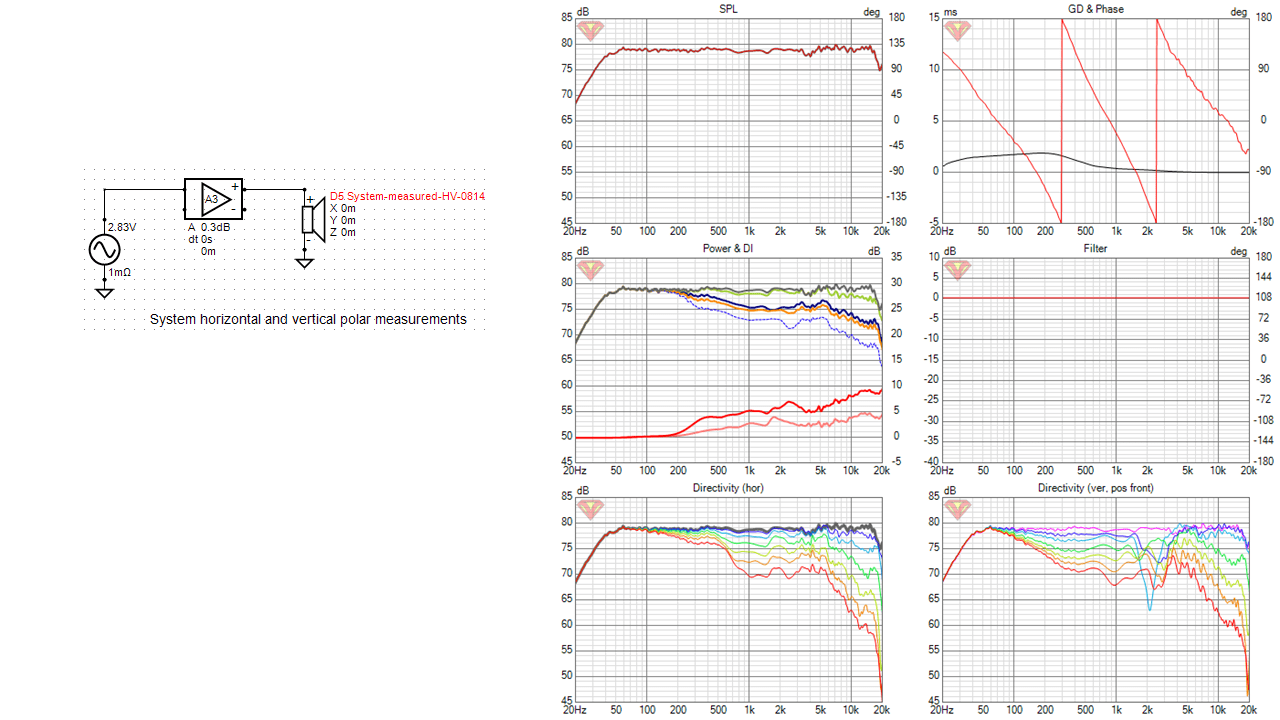

I have completed the vertical polar measurements. I am glad that is behind me.
I made vertical polar responses of the speaker system, and also the midrange and tweeter individually.

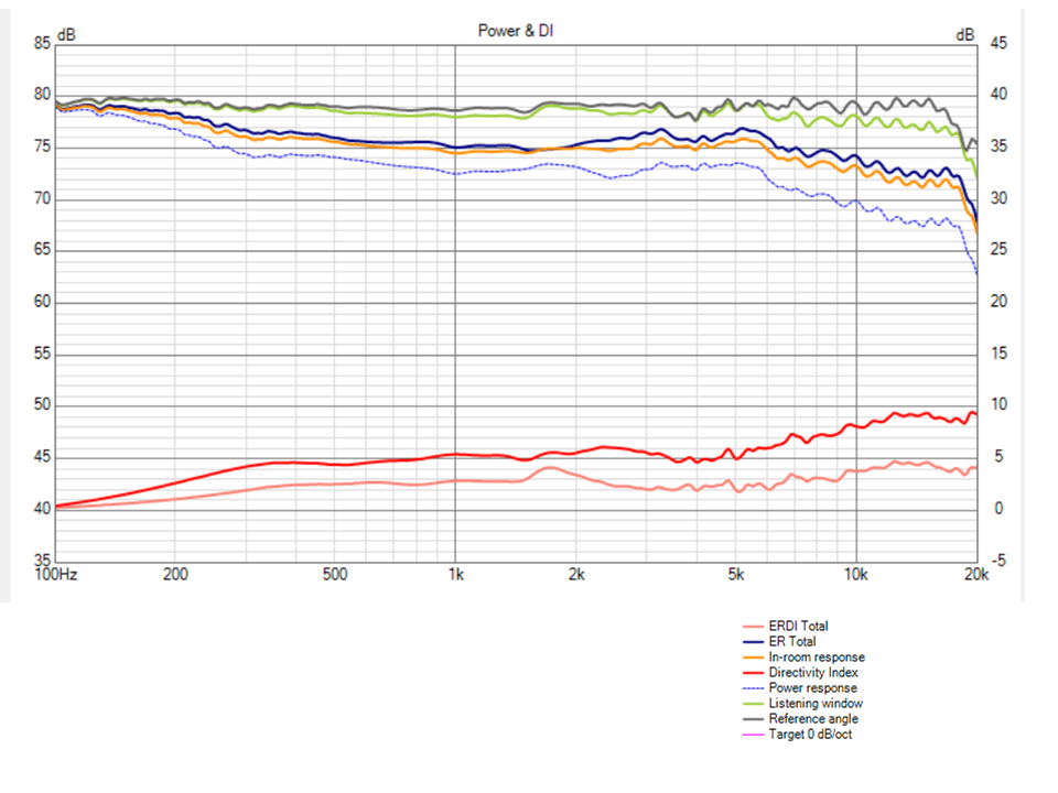

The results look really good. When VituixCad has the benefit of using a full set of horizontal and vertical polar measurements for each driver, the resulting simulation is a very close match to reality… reality in this case being a set of polar measurements of the entire system.
As I showed in post#250, the horizontal responses show extremely close agreement between simulation and measured. In the vertical plane, the comparison is good, but not as close as the horizontal. However, the detail differences at certain angles do not seem to affect the calculation of power response, early reflections, listening window, or predicted in-room response.
As before, I do not believe that I have good directivity resolution below 500 Hz, so I am limiting the Power & DI graphic to 500 Hz and up.

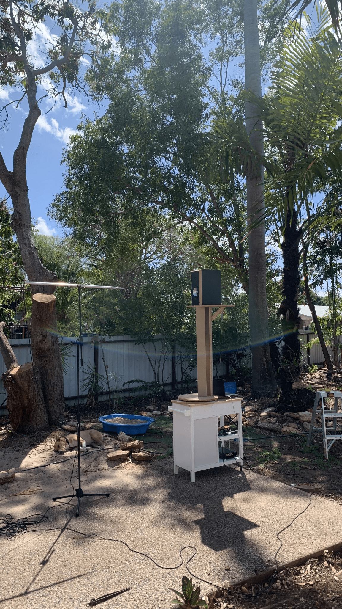

In order to make legitimate polar measurements below 500 Hz, I would need to go outdoors and make groundplane polar measurements (not on the menu). Or build a rotating tower (definitely no).
My gate window is about 5 ms, depending on the location of the first reflection. This means I get resolution down to 600 Hz at 1/3 octave, and down to 400 Hz at 1/2 octave. My merge with near field is typically about 500 Hz.
Below the merge, VituixCad has no measured data except for on-axis near field data. All of the other information it uses is based on calculations, such as cabinet diffraction results. I am certain that it is a really good simulation of polar response, but strictly speaking, it is not measured data.

I appreciate the ideas. Nice looking dog. Australian trees are very different than the trees in midwestern North America
The more difficult problem is lifting 80 lb to a height of almost 3 meters. To do low frequency measurements with a 10 ms gate, I would need the woofers to be 2 m above the ground, which means the top of the speakers would be over 3 m.
A ground plane polar measurement would be much more feasible for me... in fact, I could do it today without too much difficulty. I just do not see the value in measuring the directivity of a monopole speaker below 500 Hz... I am 100% certain that the DI is going to go from 4 dB at 500 Hz to 0 dB at 100 Hz... There is no way this speaker will somehow start behaving like a dipole or a cardioid.
I am going to do a groundplane measurement in the near future, but on-axis only... this is just to verify that the woofer levels are set correctly and that the Linkwitz Transform is working as intended.

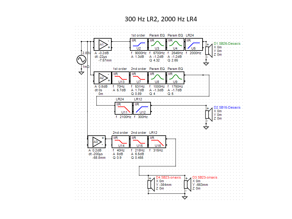

Here is the filter I have been listening to for the last couple of days. I made changes from the baseline using VituixCad simulation and critical listening evaluations. The upper crossover is now 2 kHz LR4. The lower crossover is 300 Hz LR2. Simulation indicates that the DI is +/- 1 dB from 300 Hz to 6 kHz. All of the Power&DI curves look nice. The horizontal dispersion trends are well behaved out to 90 degrees.
It sounds good, really good. Smooth, detailed, very articulate bass, good imaging.
At the start of the project, I was curious if the large CTC distance between mid and tweeter would cause me problems. The simulations were good, but how would it sound in real life? As far as I can tell, there is no sonic downside to the 1.2xwavelength spacing. Although I have a large listening room, I sit rather close to my speakers, about 8 ft distance. I get no sense of disconnect between the mid and the tweeter. Even at a distance of 4 ft, the sound seems integrated.
The change from 2.3k to 2.0k upper crossover was a subtle difference. I noticed slightly more congestion, or homogenized sound, on female vocals and horns with 2.3k. The 2.0k had more clarity, but it was a very slight difference.
The change from 300 LR4 to 300 LR2 was not subtle. The soundstage became more spacious, imaging was more precise. Bass instruments and drums had more impact and punch. I really noticed it on fast moving electric bass, drums, and piano.
This surprised me, because my main system sounds best with a 200 Hz LR4 crossover between the 12” woofer and the 6” mid driver. On that system, I lose a bit of detail when using LR2 filters.
Next step is to try some 3rd order filters to see how they sound. I also need to install a slightly down-tilted EQ on one of the Hypex presets. The current flat frequency response is just right for most jazz and classical, but as expected, it is too bright for pop music. For pop/rock I usually prefer a gentle -4 dB drop from 100 Hz to 10 kHz.
