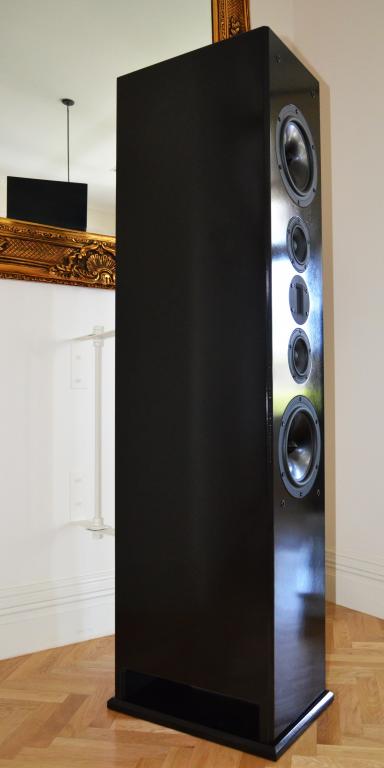

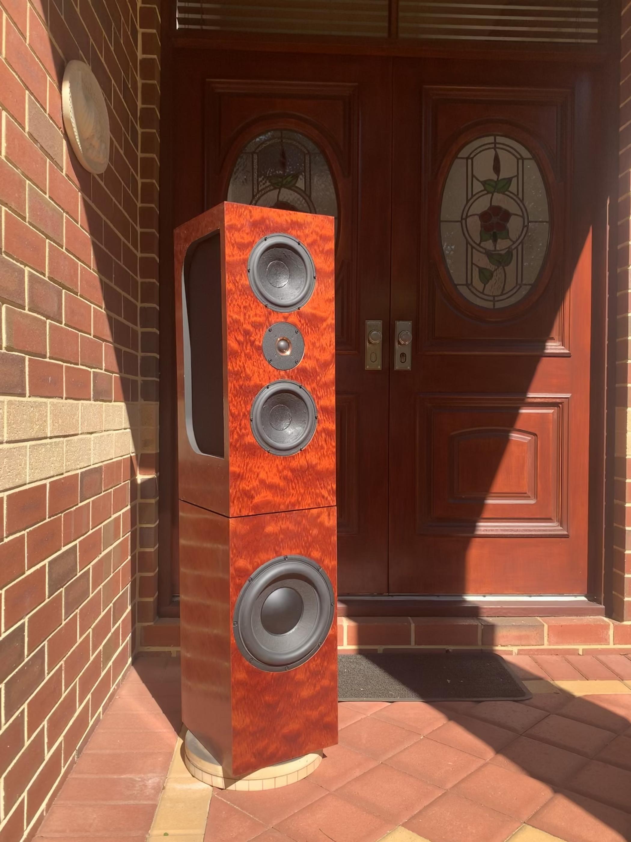

I’ve had a few large multi ways eg. WMTMW; WMTM all extending down to at least 30Hz or so (anechoic).; both active and passive, both monopole and dipole. (2 examples pictured)
In one of my recent experiments was to build separate woofer cabinets for the WWMTM (as designed, but not pictured) and test what the WWMTM sounds like in my room, vs separate W + WMTM and WMTMW, and the W + WMT resulted in the smoothest in-room response. I forgot to take photos of the setup or measurements. But imagine the WMTM in L/R stereo position plus additional 2 woofers, each in separate cabinets placed in different positions.
So I got the benefits of smooth integration of all drivers in a 3 way, but smooth in room response of 4 woofers spread out throughout the room.
I think it would be worth an experiment if you’re looking at a WWMT design. Certainly better for your back as well.

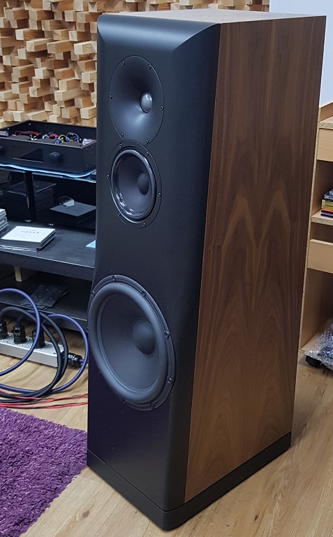

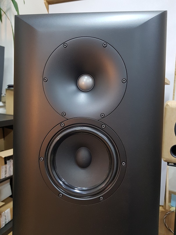

The requests for WG were noticed, currently I am not able to prepare and ship the batch of WGs.
I could provide STL file for 3D printers though. Just send me an email to petr.kocourek@gmail.com
Of course I do not allow any commercial use of this WG or further distribution of waveguides.
Project is finished, today I installed new WGs and dekor rings. Cosmetics is now identical to front baffle painting, and 18WE ring does not buzz anymore.
