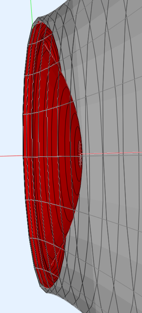

Now need to know the exact throat dimension of the waveguide; for the moment i choose 40mm as from measurements posted here seems 39.6mm.
Simulating with ABEC seems to perform good.

Ath uses sections of arc's in the source contours file, ABEC itself can simulate whatever mesh can be created in another way. If the mesh created isn't close to reality then the simulation has no hope of being accurate.The dome is a portion of a sphere, correct?
EDIT: now I see what you mean, ATH has an idealized sphere source. That's not what I meant. I mean the dome source, but just pointing out the shape of the dome must be spherical.

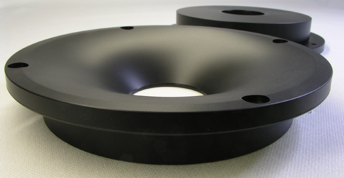

@jumper981 the Bliesma has an inverted surround, one of the things that make it work well on a waveguide.

T34B+JantzenWG could work reasonably well. Surround outer diameter is 40mm, Jantzen WG has 44mm.
I know that JantzenWG works well with TW29TXN, and with BN it will measure also fine as both versions has very flat dome profile.
