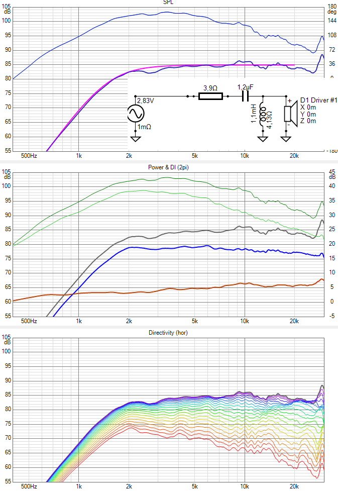

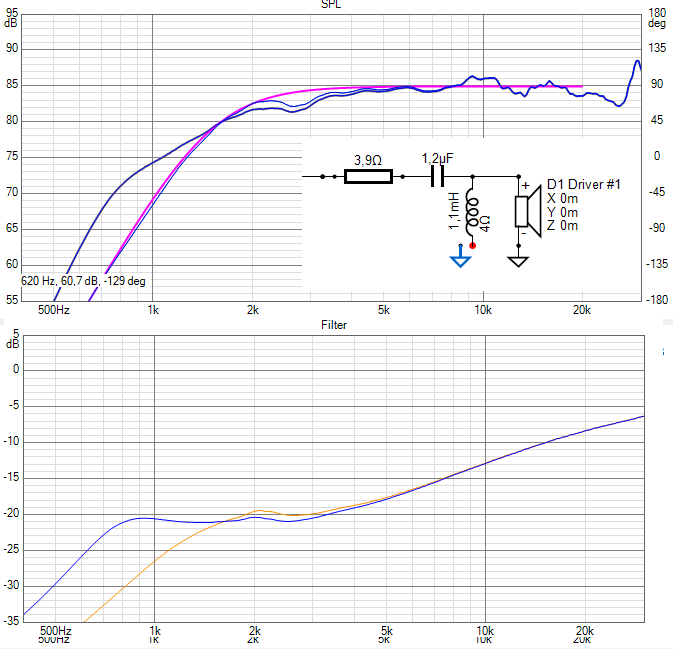

- New project: Bliesma T34B in WG, 18WE, 32W
