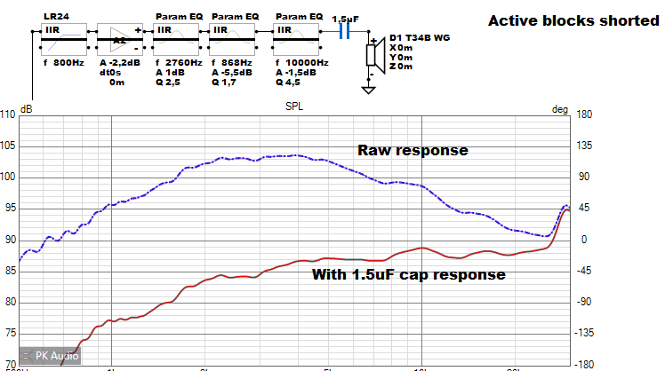

Hi Tihomir, what you see on the graph is actually wanted and exemplary effect of the WG. It adds SPL boost at the frequencies similar to dimension of the WG. That boost must be compensated in crossover, normally one capacitor does the job. You can see the result above in this thread in Vituix sixpacks. This WG has 30mm depth, the gain, compared to bare tweeter, at ~2kHz is actually ~7dB, which is quite common.

I do not have the measurements with cap only. This is all part of crossover design work in vituix with actual measurements of raw drivers.

see the impact if such a cap on raw response of T34B in WG. Such a small cap also created part of needed SPL decrease, and side effect of small value is that even high quality caps can be used and it does not make the hole in the pocket.

If frequency high pass of is 1800 Hz, attenuation is nearly 20 dB.Hi Mike,

Isn't that too much to connect to the midrange ?
The graph was SPL calibrated. Resulting loudspeaker sensitivity is dictated by the response of the woofer after baffle step. In this case 32W gives ~86dB/2.83V/1m. You can see the tweeter response with the cap is ~87dB, which was close to woofer sensitivity, and the mild tweeter sensitivity adjustment during tuning by listening was done in DSP. So it all makes perfectly sense, actual real measurements were used for Vituix crossover modelling. All dual channel and SPL calibrated.
