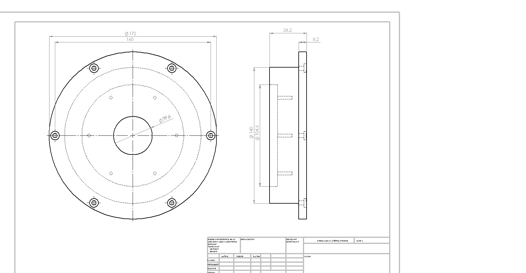

Here is drawing of current version, so you can see what to expect.
I will most probably make few updates:
1. WG throat ->40mm
2. get rid of 0.2mm from WG depth
3. Adding of the groove at the front side allowing to fit original T34B hexa grill
1. WG throat ->40mm
