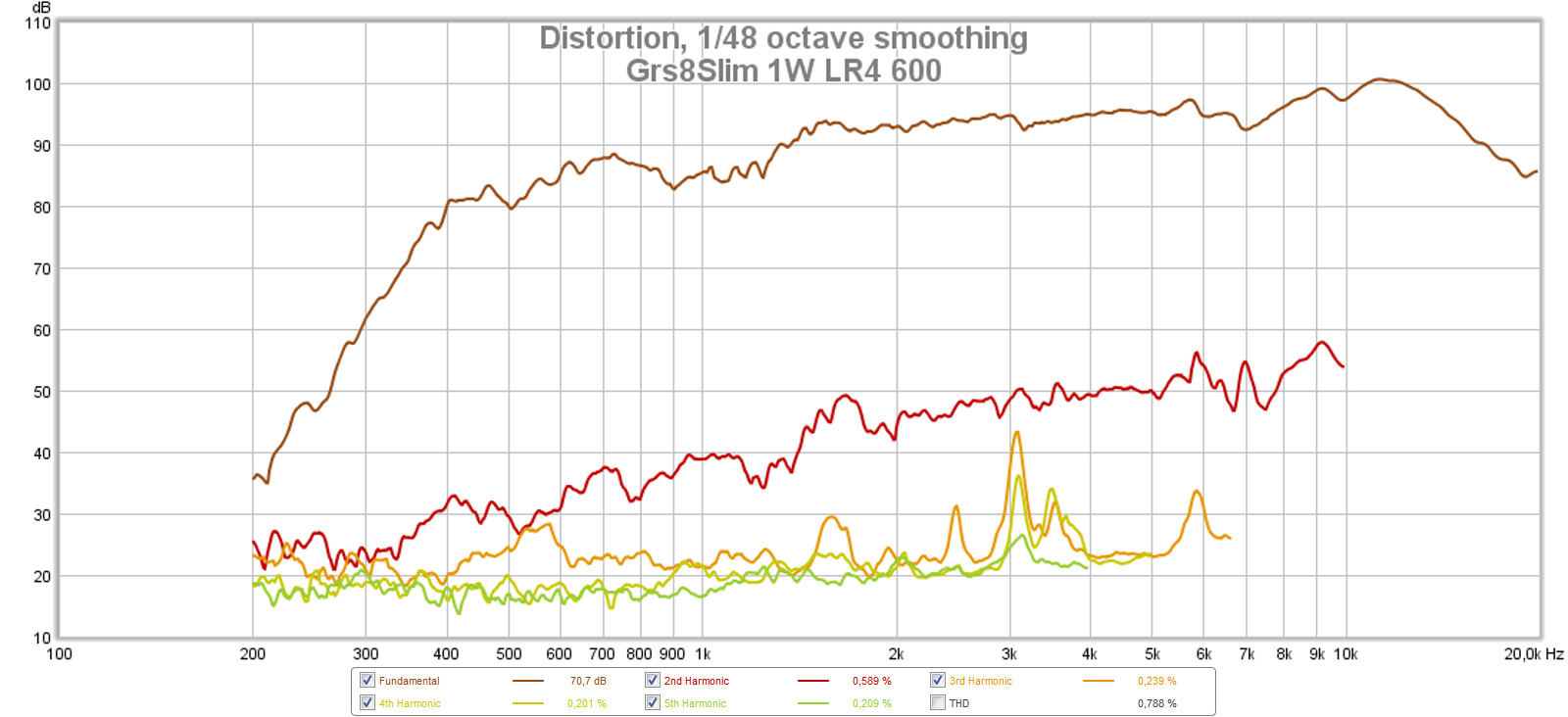

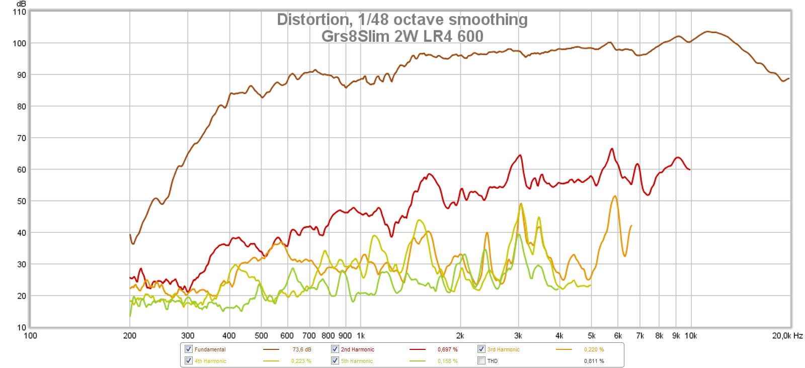

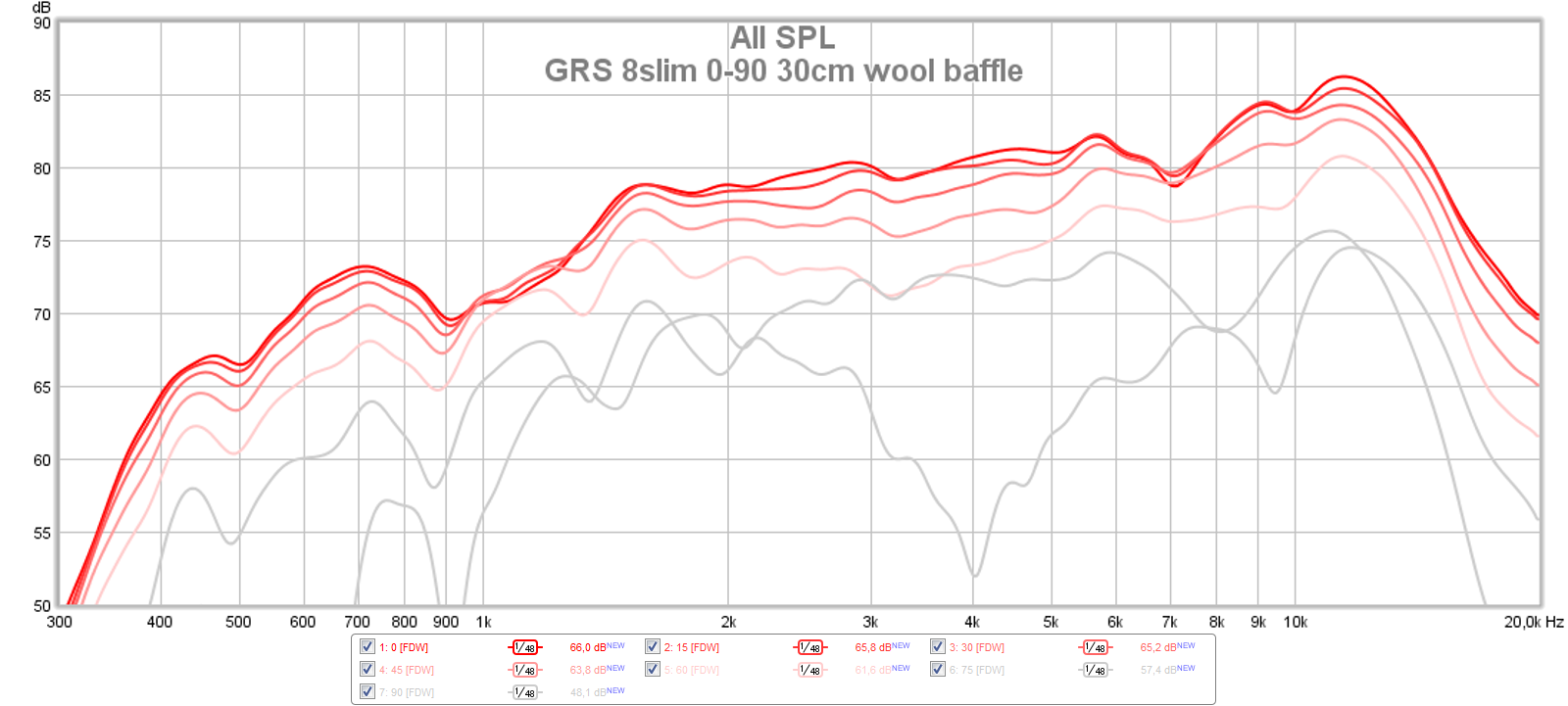

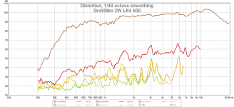

Now it is my turn to add my measurements:

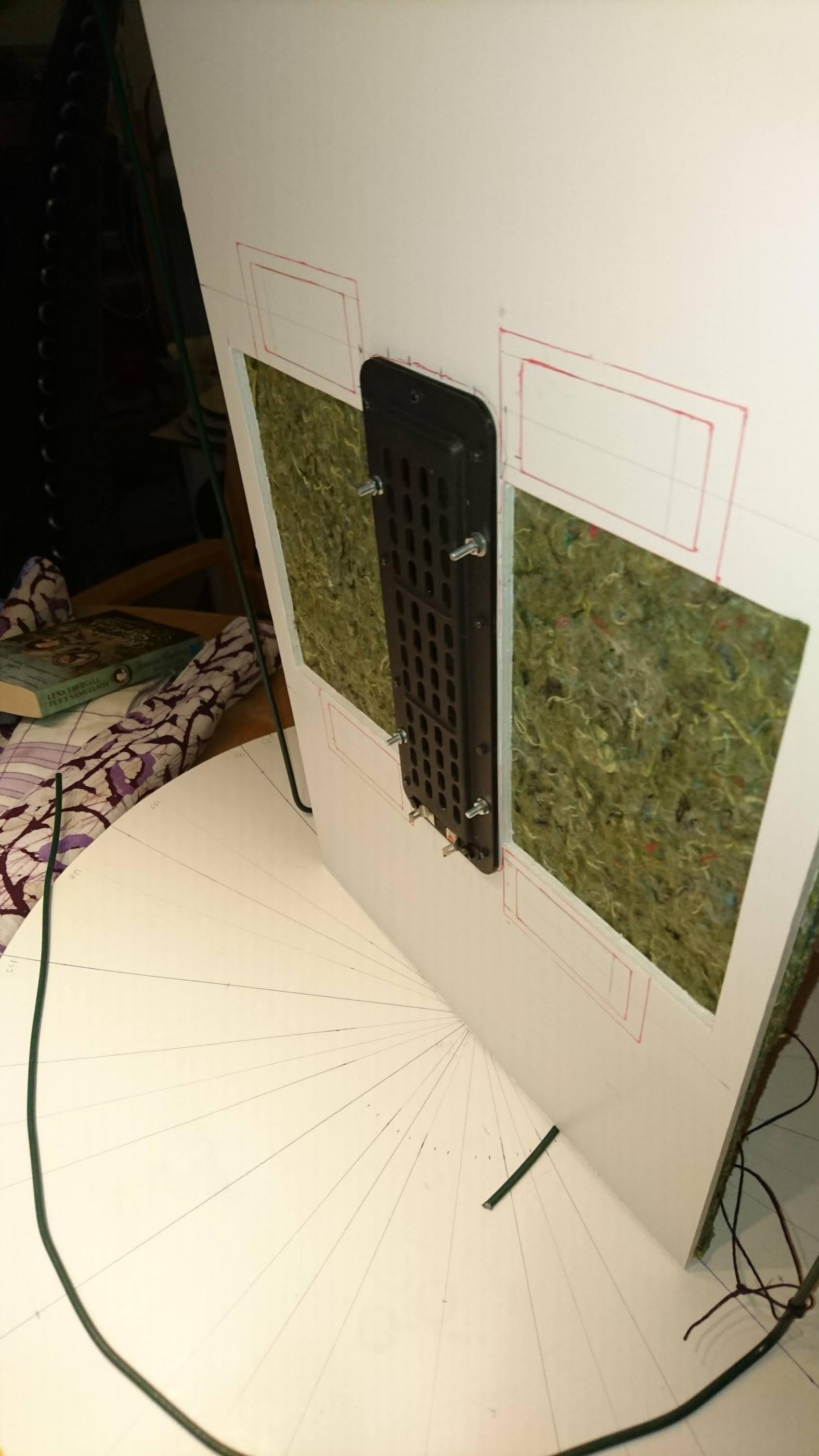

I've only tried one of the two drivers I bought:
I've mounted it in a 30cm wide foamcore baffle with an 8mm sheet of fluffy wool carpet on the front. This is to add efficiency without a sharp dipole peak.
First up is just a rough 0-90 measurement. Pretty nice overall. It might be that covering the 2 outer rows is uneccesary since the driver is so slim which I might test in the future.

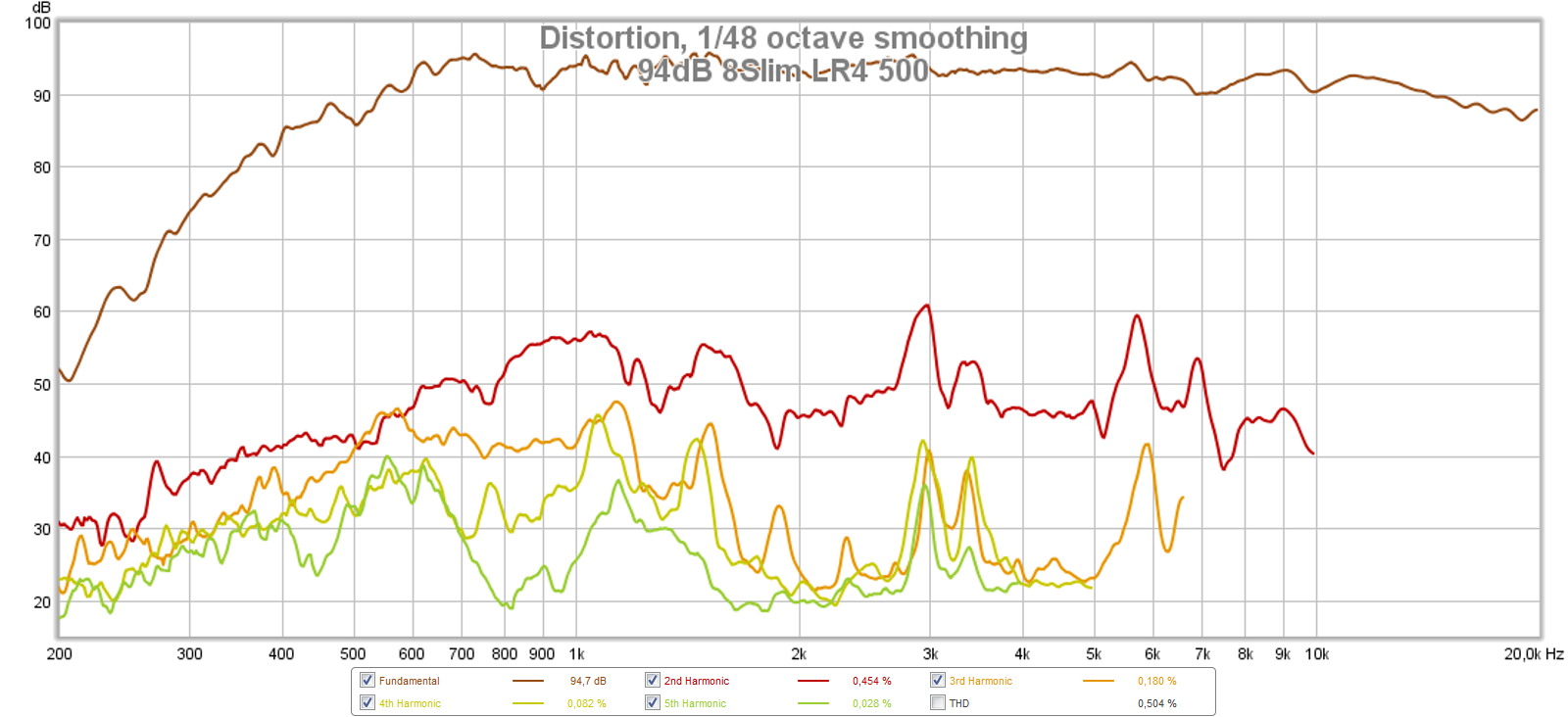

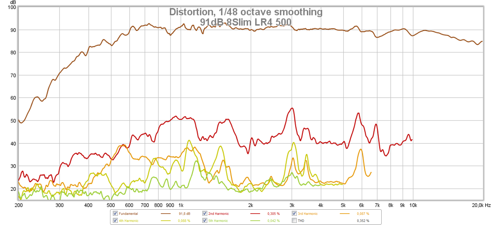

Next is distortion tests: The first two are without EQ except a LR4 highpass @ 600 hz. I estimated the impedance to be 6.5 ohm so 1W => 2.5V, 2W => 3.6V.
The next two are with lots of EQ such that the response fits a LR4 highpass @ 500 hz.
All of the distortion tests are measured at 0.5m with SPL - 6 dB => calibrated for 1m.
As my plan would be to get 7 of them in a shaded array, on the low end I'll get the performance of ~ 4 of them so. On the low end I estimate about 4 drivers will sum nicely so I'll get around 12 dB higher output SPL given the same performance due to more drivers.
Since it starts to distort more above 91 dB that would let it play cleanly up to 103 dB which is way more than I need. And semi-clean at 106 dB where it hits 1% THD @ 550 hz.
For my case, crossing a line of them at 500 hz LR4 shouldn't be a problem at all. If anything I could possibly cross them even lower. But I'll probably stay on the conservative side and stay at 500 hz so I don't push my midwoofers too high.

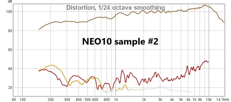

Sorry I disappeared y'all. It's been super busy at the day job and the side gigs.

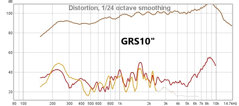

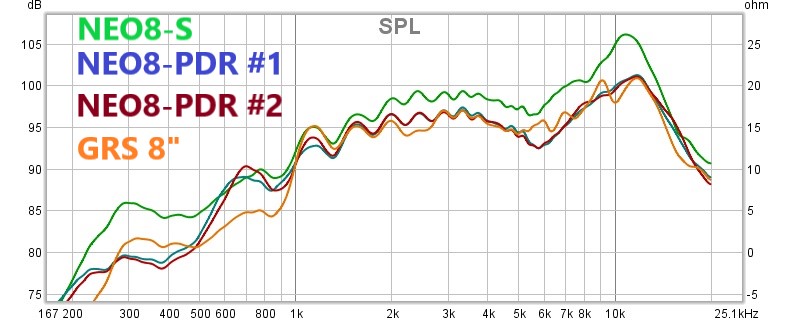

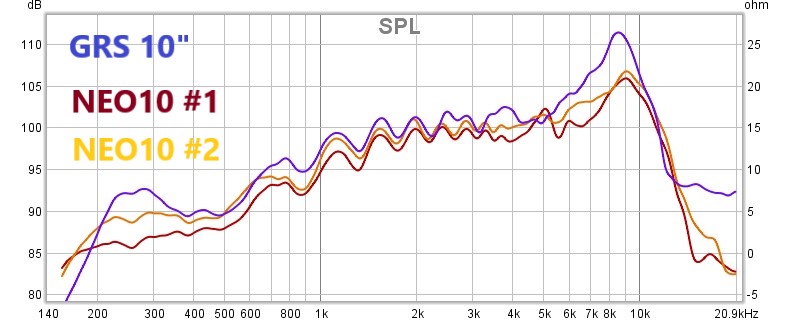

Here's a test upload of the NEO10/GRS10 comparison. I want to see if my snapshot looks clear and large enough and then I'll upload some more.
Neo10, sample #1 was set to 95dBSPL at 1ft and all gain settings were left untouched for the rest of the measurements. I've smoothed these snapshots to 12dB/oct.
Greg
Greg

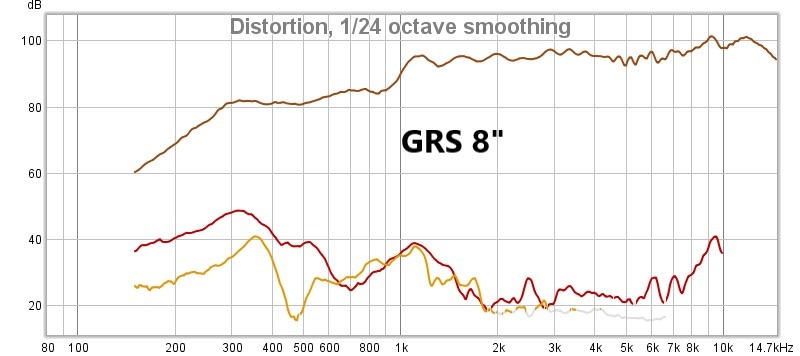

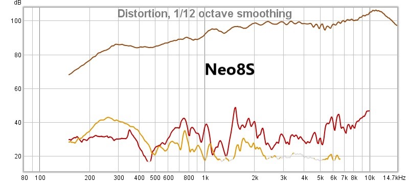

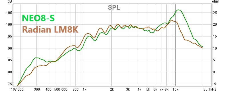

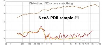

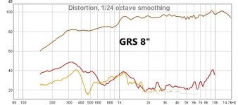

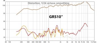

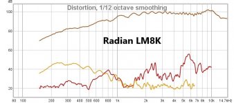

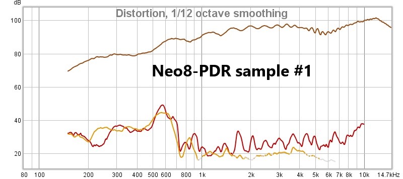

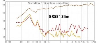

Distortion plots. 2nd order is RED and 3rd order is ORG
The original BG NEO8-PDRs kill it as long as you stay above 600-700Hz. Both samples were almost identical. Midrange performance from a simple harmonic distortion perspective is fantastic.
Most disappointed in the Radian, but it's still totally acceptable if you consider most of it's range is still below -40dB down or under 1%. Even some of the other drivers that look like they have a bad spike in the upper midrange are still at least -40dB, so overall pretty usable.

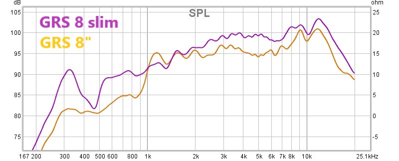

The Slim 8 is the worse of the bunch, as expected, with the highest levels below 1KHz. But used as a line array of tweeters, they sure are a steal.
Greg
Greg

Thanks Greg! Very similar looking responses. The GRS PT5010-8 has a bigger peak to deal with but overall not bad in comparison.
