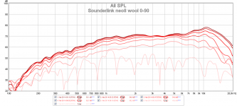

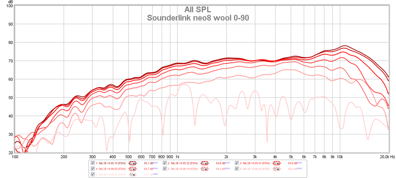

The only off-axis SLIM-8 results (that I have seen) appear to be from covering up the outside slots on a wool/felt baffle. Wouldn't this have the same effect on the normal 8's ???
I can verify that the same trick works on a normal Neo8, it does extend the high end a bit. I have gotten more smooth results with a less wide baffle though, on the order of 10 cm or less. This 30 cm baffle is a bit extreme but I wanted to specifically test the extreme case in that measurement.

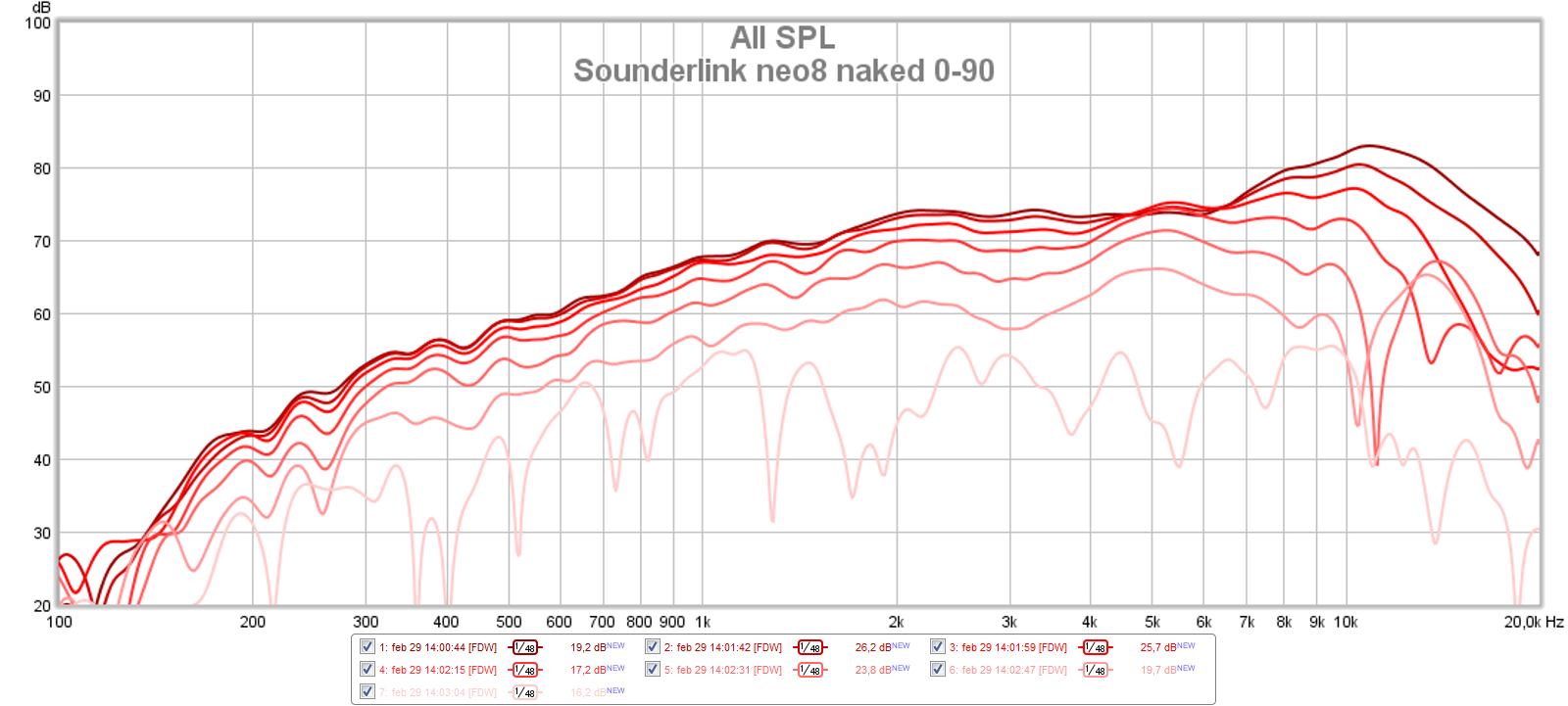

With a smaller baffle that covers ~ 10 cm and that covers the outermost two holes we get the following on a Sounderlink Neo8 which is basically the GRS wide 8" but more expensive, more distortion and less consistency*. (*My guess based on the consistency of the slims, probably similar for the other planar drivers from GRS)
Note that even with those tricks the top end at 10 khz and above is still worse than the slim. Not by a huge amount sure but a bit worse.
There is also the fact that the wide 8" is well, more wide :D Probably not an issue for most but I'm building a dipole and in this case it is very advantageous to have the slim design. A dipole with a hard baffle will create a null on the other side, as can be seen in the measurements. The bigger the baffle relative to the radiating area the bigger the null. It's not a huge null but it is there from 4-7 khz and no amount of wool I have thrown at it has eliminated it.
The slim driver has a lot less baffle but the same radiating area, so this null is pushed higher in frequency which is a good thing. I believe with some tweaking of the wool baffle (mostly reducing width or curving it to create a mini-waveguide) and with more drivers I can eliminate the null with the slim driver.

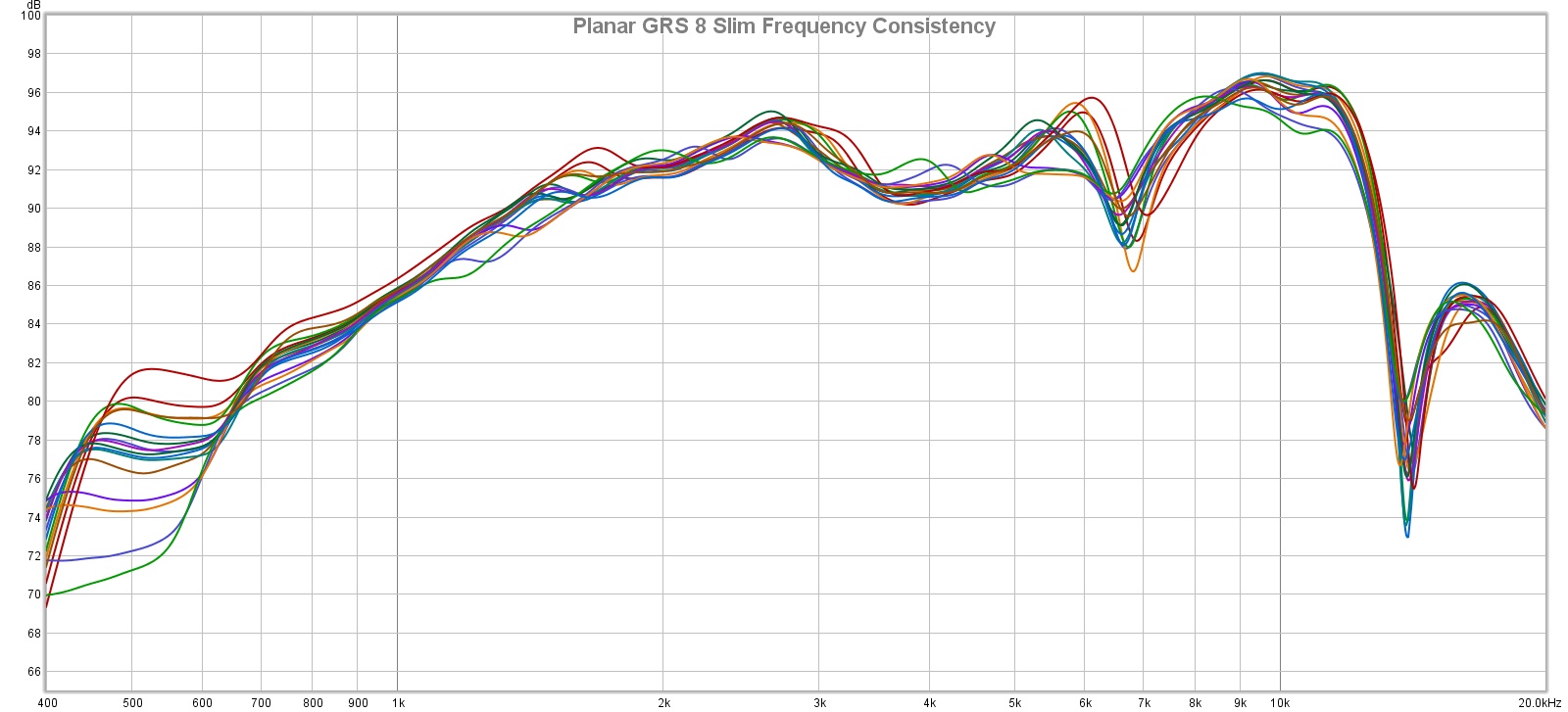

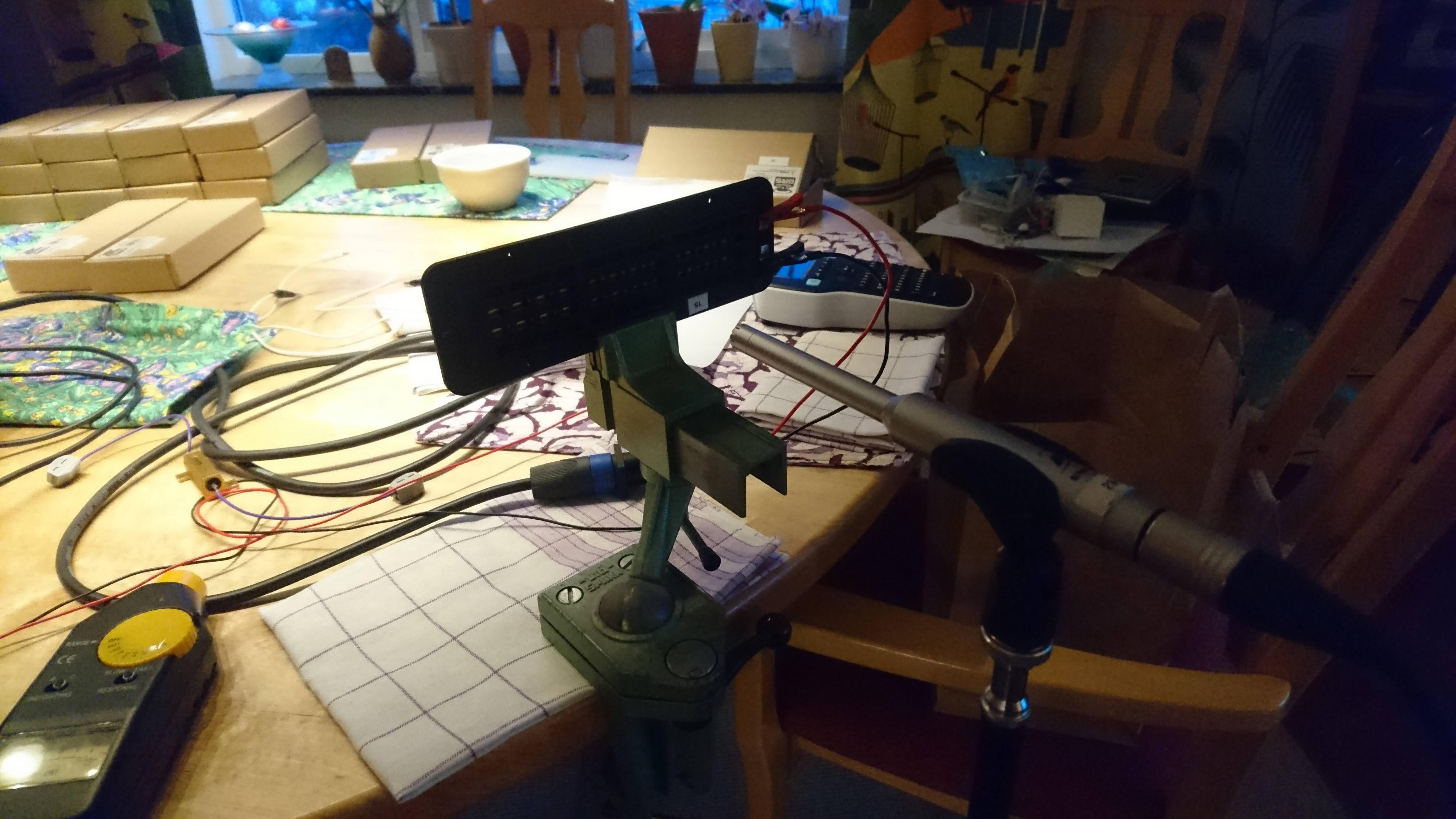

While I have not yet build a real speaker with my set of GRS Slim 8" I have gotten around to measuring them for consistency:
Distortion measurement is at ~ 2.6V so ~ 1W. I added a 18 dB highpass filter @ 800 hz. SPL is not calibrated.
The goal of the measurements is not to see the actual performance but rather to detect if I have any bad drivers in the bunch.

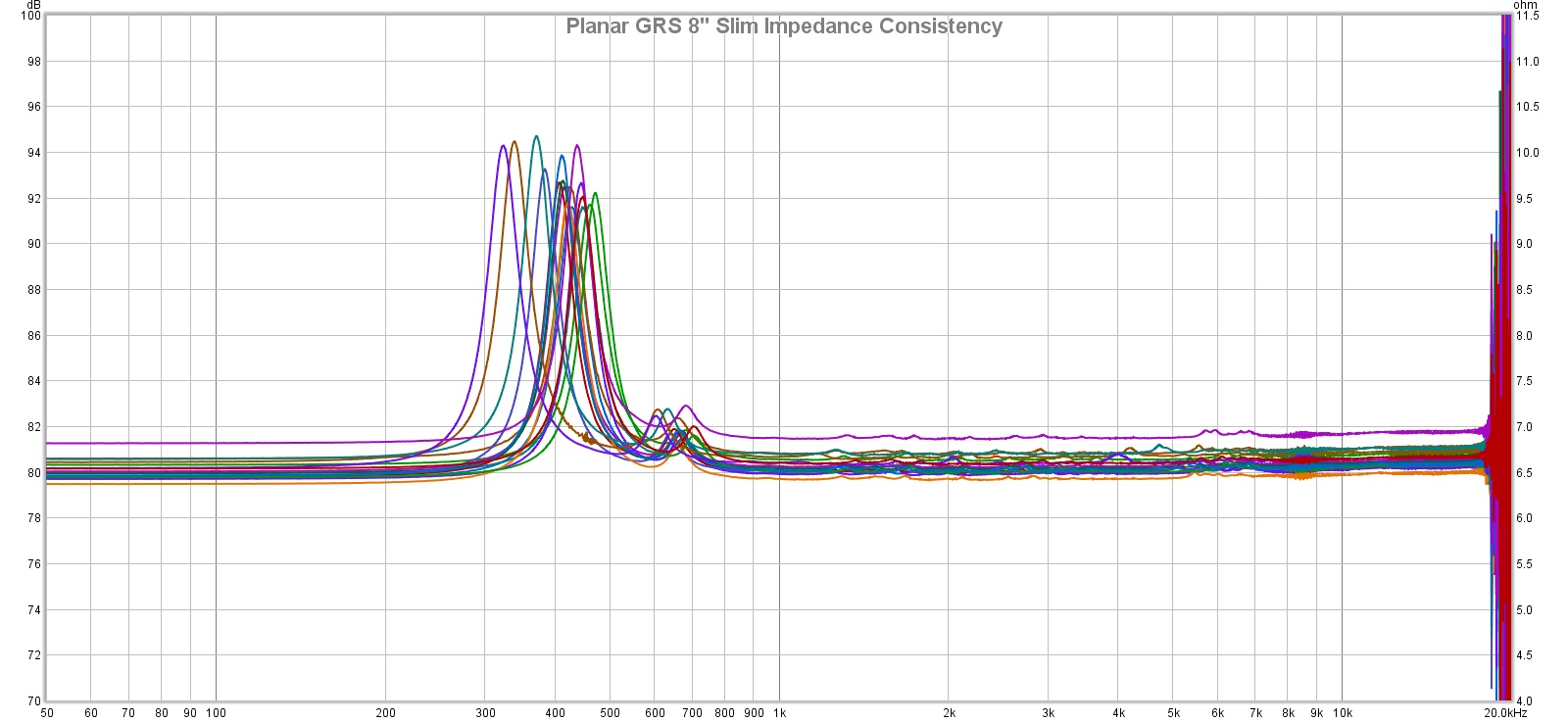

REW .mdat of all driver impedances:
Planar Impedance Numbered.mdat - Google Drive
The driver number on the distortion sweep corresponds with the impedance driver number.
All impedance measurements are in free air (same setup as when measuring distortion) except that for driver 1 where "with wool" means in this setup: New planar drivers at Parts Express.
Conclusion:
No truly bad drivers in the bunch, which far better than I expected. They are all pretty much the same except below 600 hz where they differ somewhat. I only need 14 for my speakers so I will keep the 3 drivers the furthest from the average as spares and use the others for my speakers.
While I have not yet build a real speaker with my 17x of GRS Slim 8" I have gotten around to measuring them for consistency:

Conclusion:
No truly bad drivers in the bunch, which far better than I expected. Especially considering how cheap they are. The Sounderlink drivers I've tried, which are more expensive too have nowhere close to this good consistency! They are all pretty much the same except below 600 hz where they differ somewhat. I only need 14 for my speakers so I will keep the 3 drivers the furthest from the average as spares and use the others for my speakers.

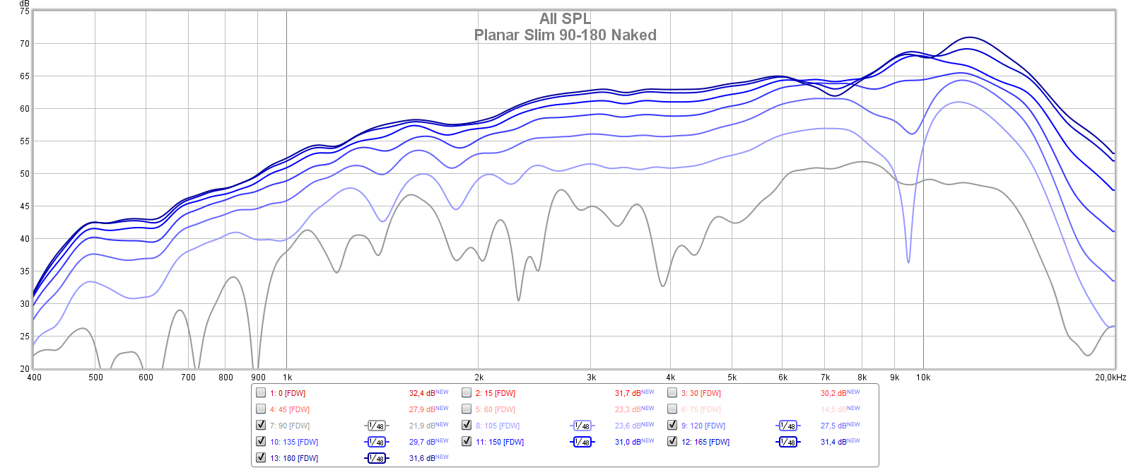

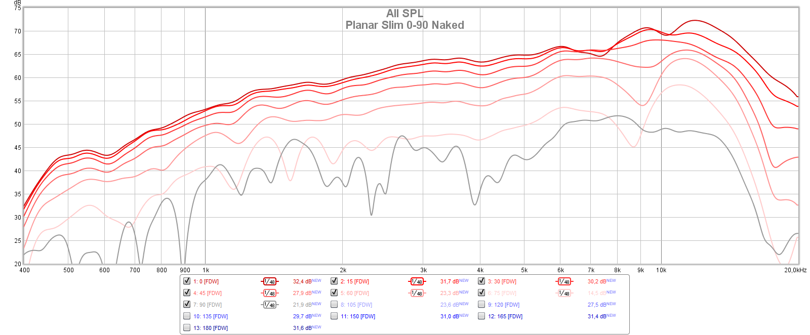

More measurements, this time 0-180 or the Slim 8" naked in free air:
The goal this time is to determine which side I want facing the front since they are not fully symmetrical as the back has felt on the outer holes. And from the result I'll probably have mine facing front with the terminals facing the back.
