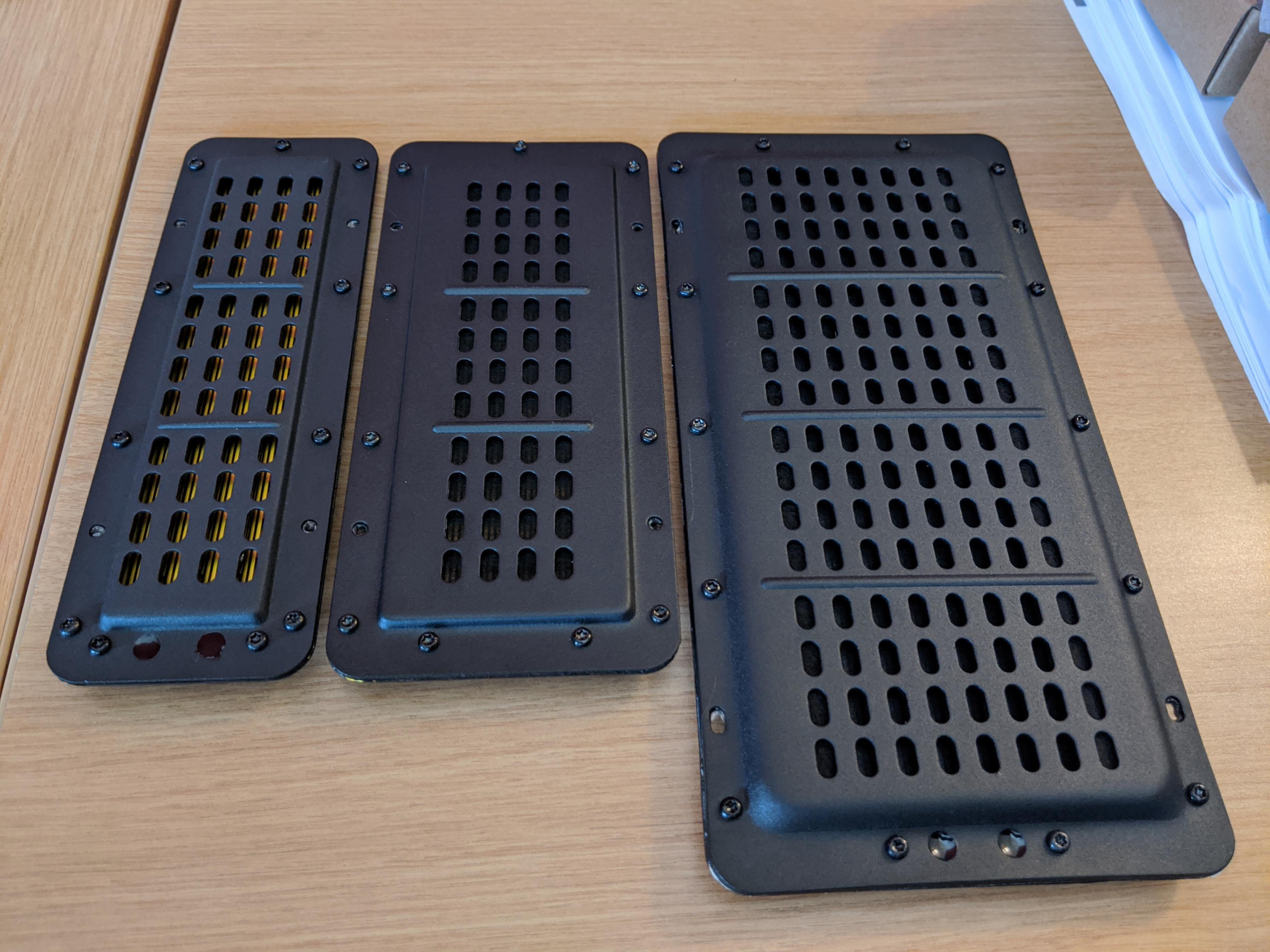

the slim looks to be an longer neo 3. a neo 3 uses thicker magnets then the neo8. and has usually 5 or 3 rows.
they use the same metal layout and even the felt in between the outer rows on this slim version 🙂 so if you want to make a line array , ur better off buying a few of these instead of the neo 3
like one of those is not even 2 the price of a neo 3.... jees.
The 8" slim does indeed look capable of playing up to 20khz. That would be great, as the NEO 8 apparently can't. The loss in the low frequencies is not a problem, as a "normal" woofer can have good dipole characteristics (up to beaming frequency).

The non-slim neo8s kinda works up to 15 khz if you squint a little and cover the outer holes with wool / felt. Probably a better idea to go with the slim though unless it has significantly less low frequency output.
I'll wait until the first distortion measurements of the slim 8 are posted so I can see how low it can be crossed. I hope an array of them can handle 500 hz and then 16 of them goes for $660 including shipping (but excluding Swedish duty fees). Not bad at all compared to how the BG prices have skyrocketed.

thats weird in there documentation the slim has felt . but here there is nothing by the looks of it ? or only on the back side ?

Slim 8 only has edge felt on the back side.
How about using the backside with felt to fire toward listener? Backside will have lots of diffusers behind speaker anyway, as per usual dipole practices..
I've thought of that too. No reason not to if you don't mind seeing the connectors/wire or can make a grill cloth to hide.
