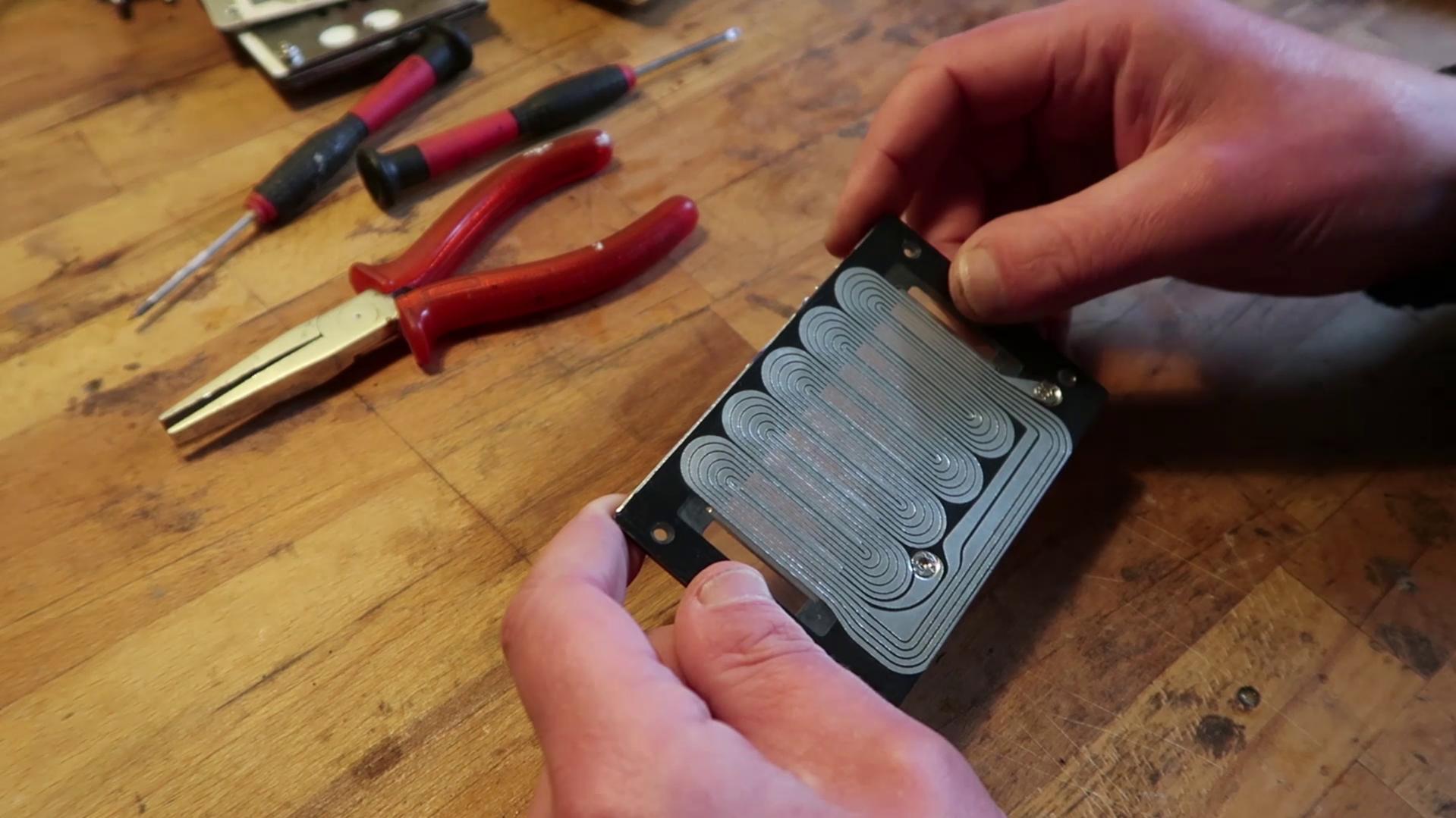

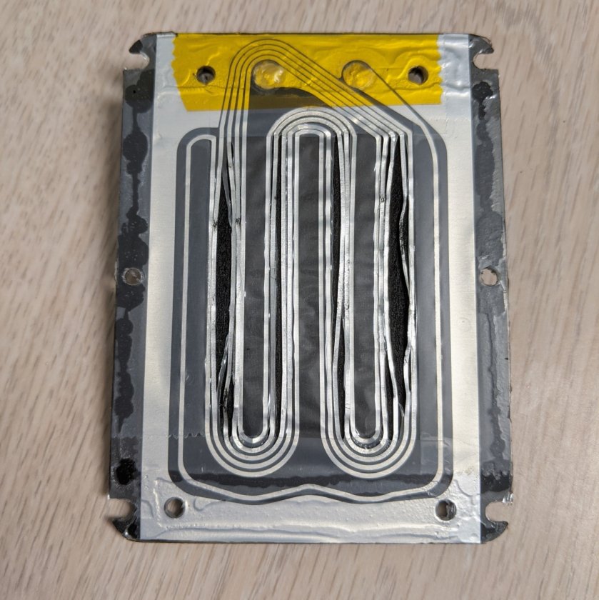

Sounds like this happened during testing outside in hot weather with decent volume levels.
Note to self: avoid high volume in heat with Mylar/Kaladex.

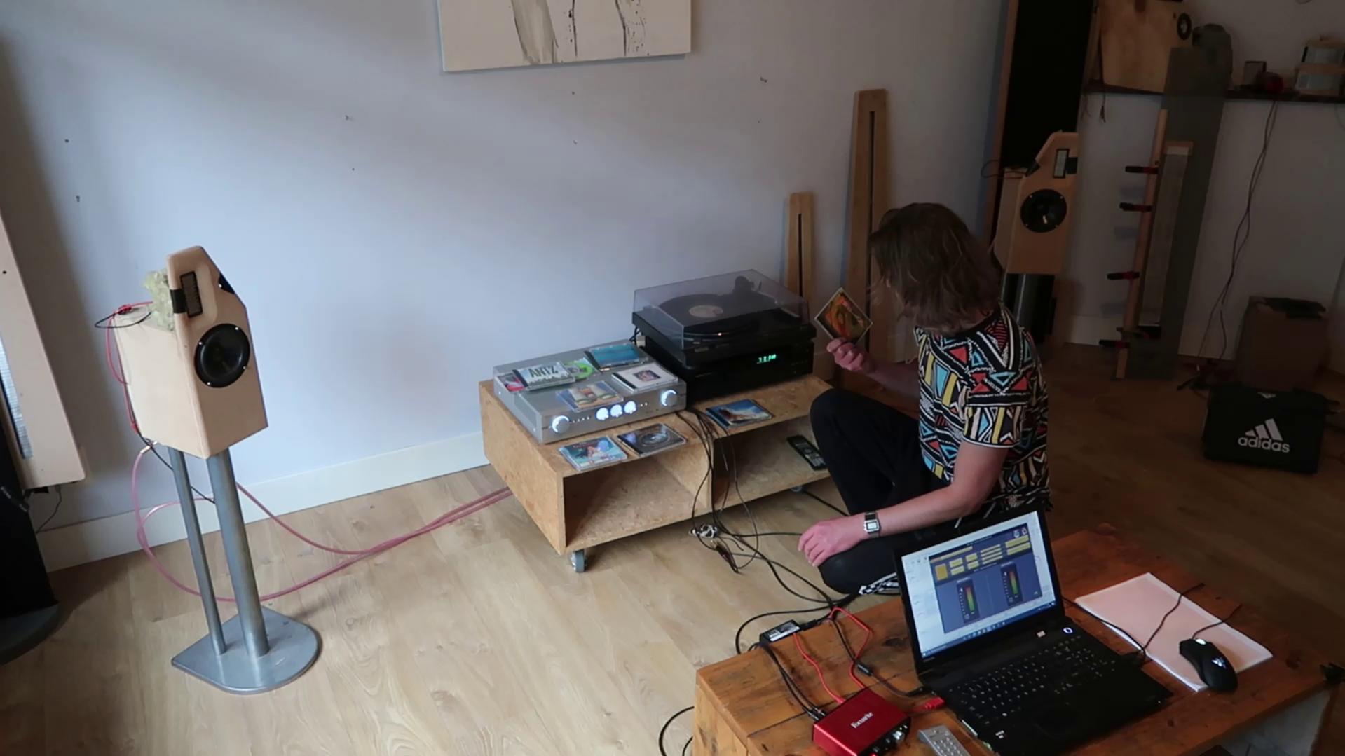

Haha! I am not the most experienced with measurement of units, but plan a sweep from 400Hz to 20kHz with REW and UMIK. Some absorbing material on floor and ceiling, and because of nude (dipole) measurement I expect little reflections, as there are zeros to all sides.

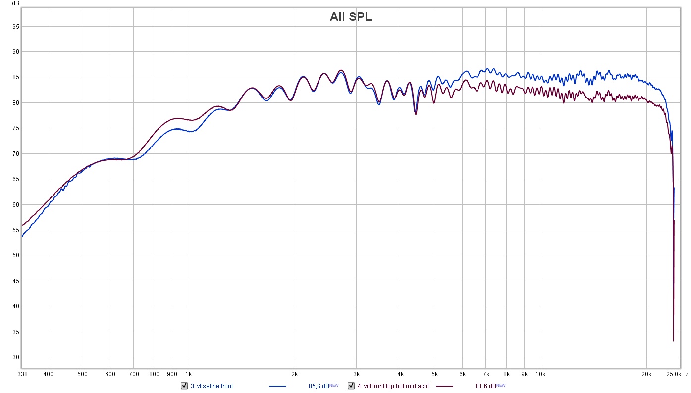

here is a version in push pull that i tamed only by acoustical measures (damping and some other methods) for flat and smooth response. no eq used or needed in my opinion. yes you do lose on insane output humps at 15khz or a rising response.. so not suited for horns, since that would result in a bigger downwards slope (like the radian tweeters)
Picture is wilth crossover in place as intended for the small speaker in question at 1300Hz 12db oct. could be upped a bit to make it even smoother though, and play louder without addressing the resonance more then i did.
Blue as is with only padding on the back in my small baffle
brown with extra padding top and bottom on the front to increase vertical dispersion and a slight rolloff in a small baffle
ofcourse i can make up something in between these curves. at the cost of vertical dispersion... or decide horizontal is more important up top and flip it around an should be able to create a lookalike curve
gating is used set to 4 ms. no smoothing used. SPL might be slightly off though. not by much
