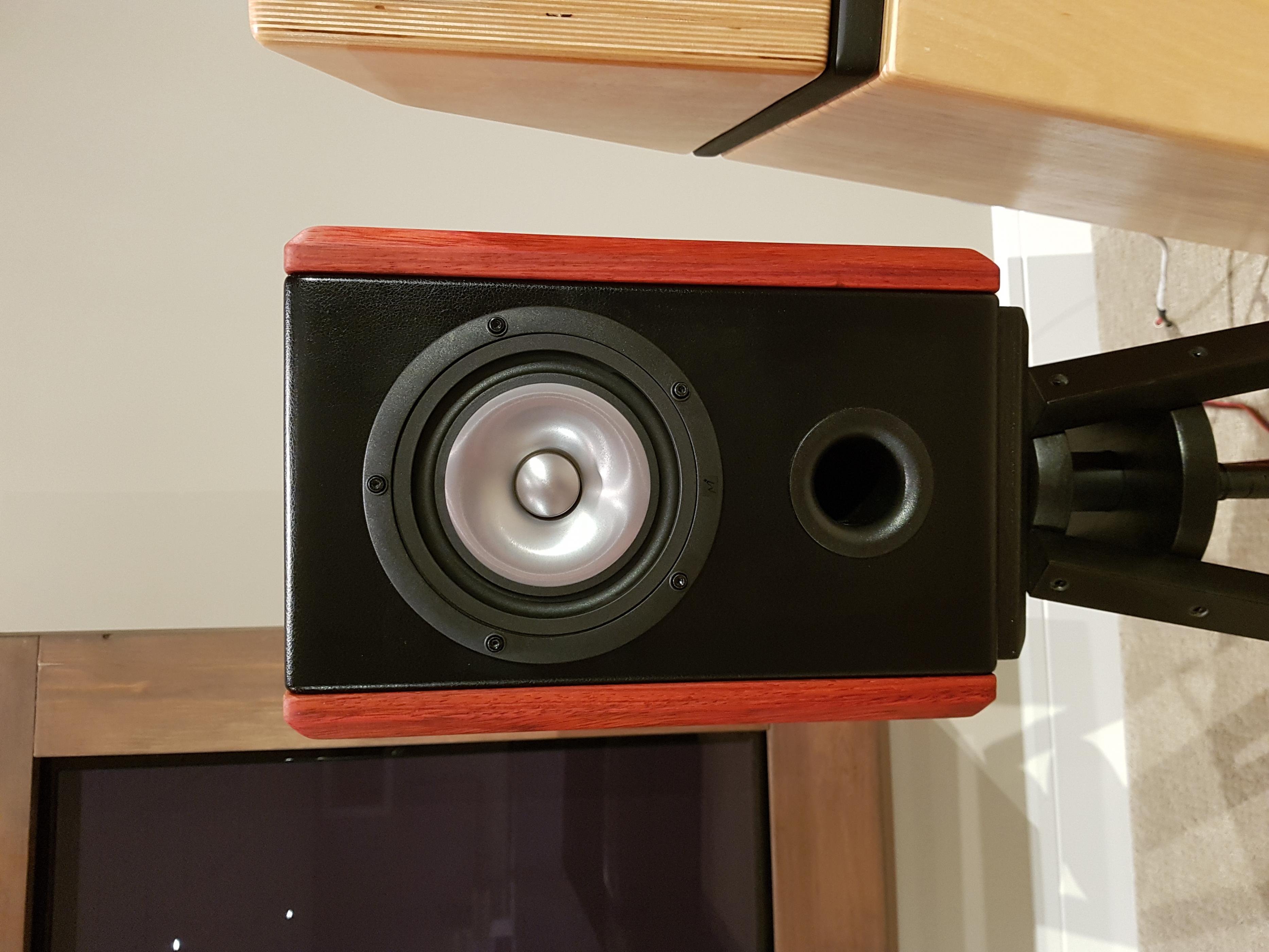

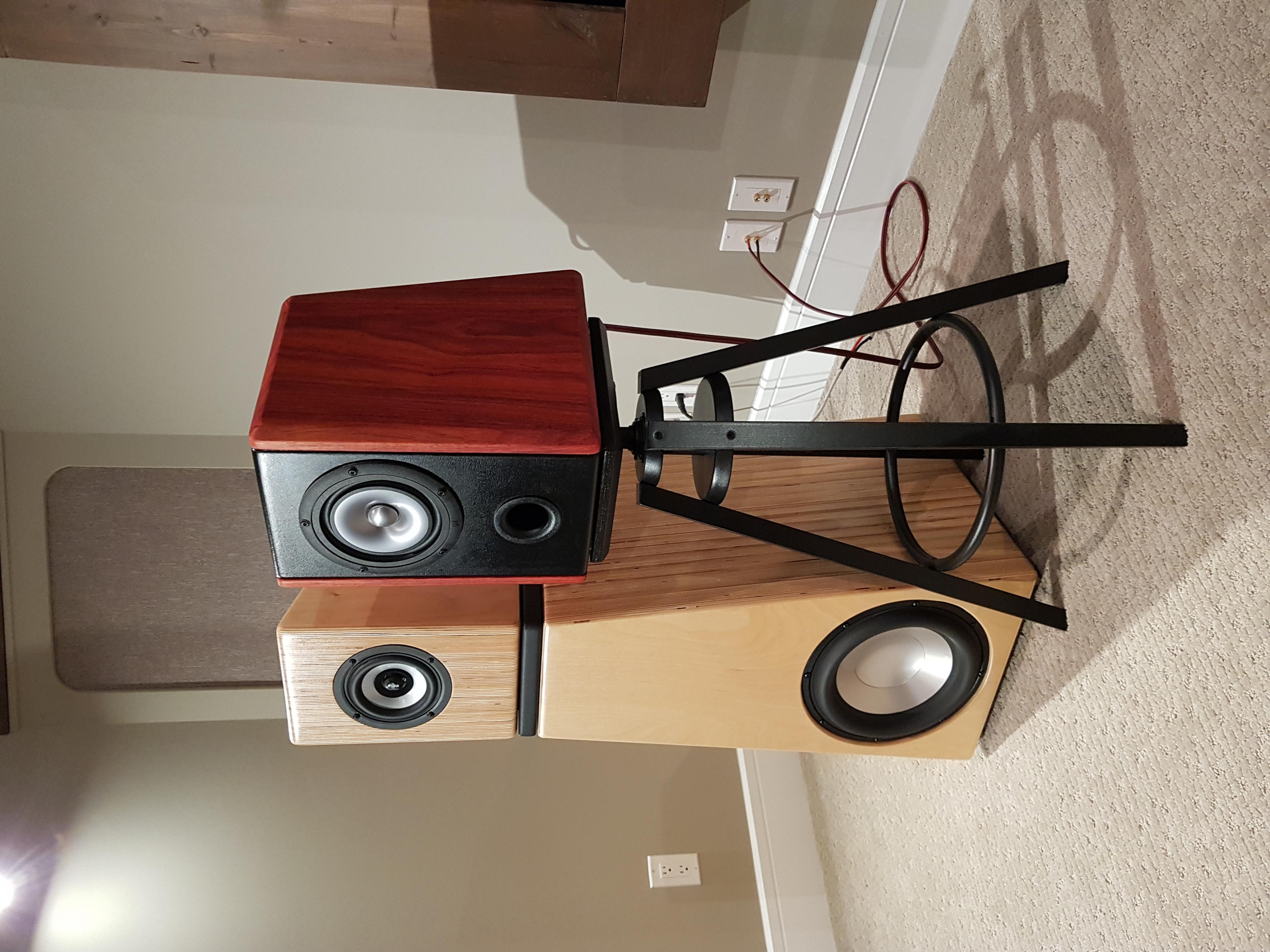

Couple thoughts regarding the Alpair 11MS and how they compare to the Eikona 2s. First thing that jumps out right away is the presentation of the 11MS are more forward the the Eikonas. The soundstage is not as wide and open as the Eikonas but rather further into the room toward the listener. They are extremely detailed and do seem to have more sparkle up top. The Eikonas are just as detailed but have more of a relaxed feel to them. When listening to vocals the 11MS will present the lead voices front and center and 10 feet in front of the instruments and percussion where as the Eikonas present the lead further back, standing amongst the back up instruments and with slightly wider soundstage. The 11MS do have a much wider sweet spot then the Eikonas and really are impressive in that regard.
If I had to choose between the 2 drivers I would likely go with the Eikonas if price was similar(which it is not and also I'm used to their sound over 2 years now) but would absolutely have no issues living with the 11MS. Unless comparing the 2 back to back I would suggest the differences between them are nearly indistinguishable.
If you take into account the $85 USD for the 11MS, this is a complete no brainer!!
That’s a very interesting read, I have the 11ms & absolutely love them
Wow, those Eikona cabinets are absolutely gorgeous, did you make them yourself?
Thank you! Yes I built them my self. There is a full write up on EJ Jordans website under Blog. You will have to go back a ways as they were built in Jan 2018.. They are crossed at 120Hz to the Seas subs. Absolutely my favorite setup to date!
