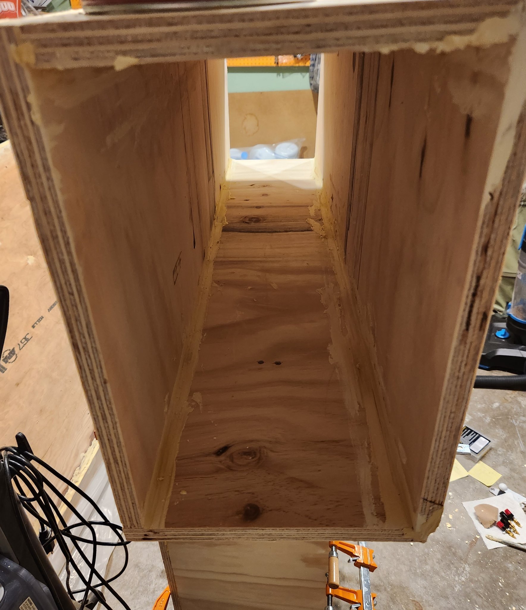

Hopefully the 11MS's will arrive tomorrow. One side of my pine ply has a bunch of knots. Is there any structural advantage as to the orientation of the knots (inside, outside)? Thanks!
cipriano,
The visible knots on the outer layer of the plywood should not be a contributing factor to the structural integrity; as you have 7 layers in your plywood, the knots should be part of one layer.
Aesthetically you might prefer the knotted surface to be not visible; if you decide to put that side on the inside, just check if the knots do not make the surface uneven for the joints you will be making with other panels for the chassis.
My build skills are rudimentary (to be kind), so once they are ready for a finish, it looks likes it will be a latex paint job. Using a generous amount of Durham's Water Putty on the inside corners. The 11MS's are burning in with about 12 hours of smooth jazz off of Directv.
Regarding the 23/32 pine ply, I remembered that about a decade ago, I did my first build. It was a BIB Pioneer BOFU ... made with 1/2" OSB! 😳 So, I'm feeling better about this Naturala 7-Ply.
As you can see in the picture, there is a few voids along the edges. But I've been practicing my routing skills along a leftover lengthwise piece and nothing seen so far. Keeping my fingers crossed!
