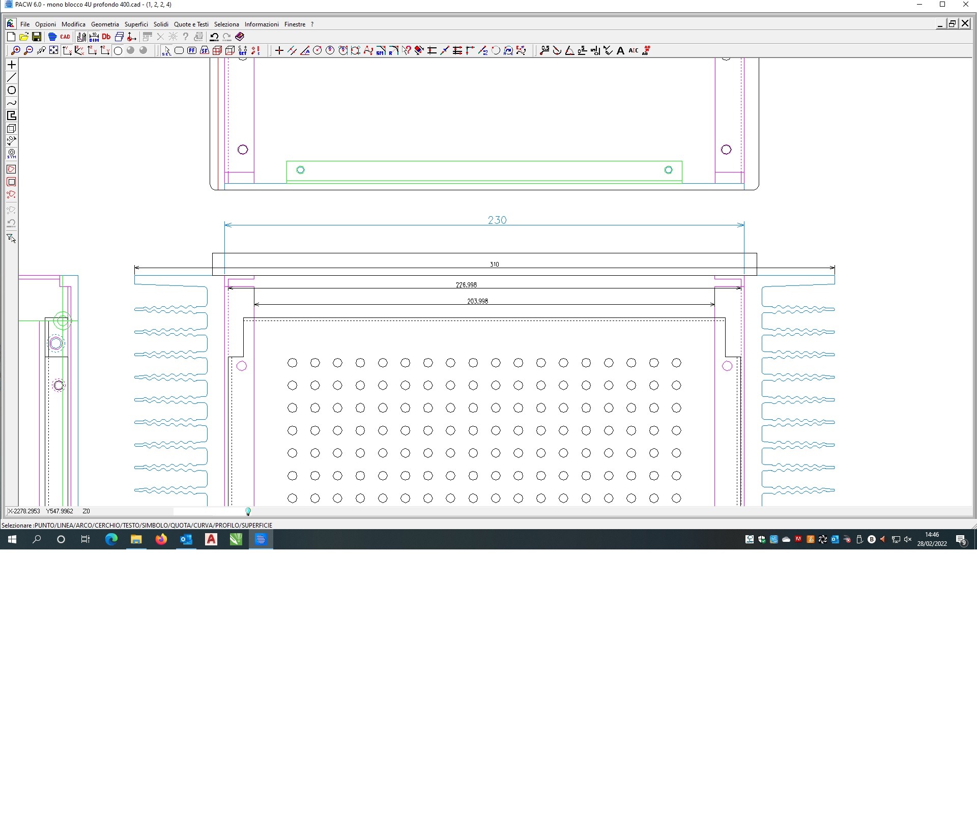

Speaking of which, I believe you mentioned earlier the width of the monoblock chassis is 210mm, what is the internal width?
The attached picture should help!

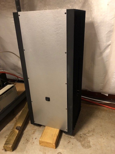

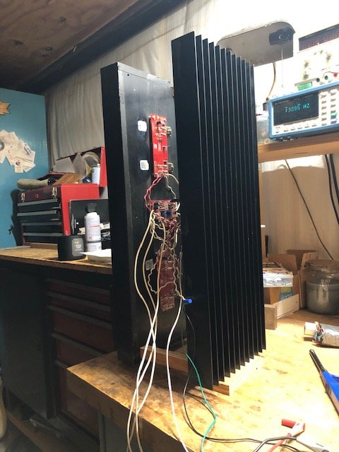

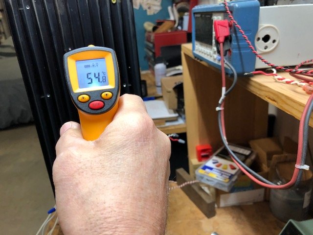

ZM I respect your opinions and info very much but i have to disagree respectively. Why couldn't something like that be in the shop? I'll agree with you completely if there is zero interest. As far as cooling being "hysterically bad" just makes no sense. First of all these were pulled from industrial 50HP drives that used the HS in the exact same configuration in closed cabinets. The pic in first frame is of the F5T in operation with each transistor biased to 1.5 amp. It's been running continuously for three days. The hottest spot is just above the topmost transistor at 54-55 Deg C. The second pic is of a Pass A-40 that I have been using for 15 years or more. I have never had an output transistor fail in that time.
Two heat sinks of equal area, fin size and spacing, one that is higher than wide and the other that is wider than high, with equal number of devices equally spaced, the wider than high heat sink will be more efficient and cooler if naturally ventilated (no forced air).
Ok I hear what you are saying and not arguing it. But how much more efficient? The statement that it is "hysterically bad" I think is an exaggeration. This being DIY I chose them BC they were free. With what would be considered high bias they seem to be doing an adequate job. I would probably lower bias a little to drop to steady 48-50 C. I have an identical HS that has been cut in half. It might be worth setting up experiment to test the performance and quantify. Lots of extra work though!
