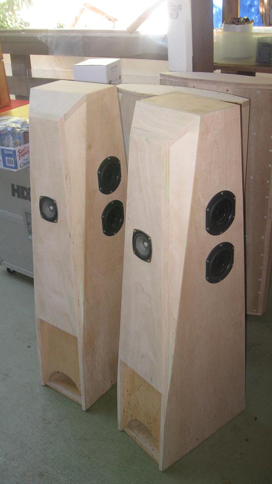

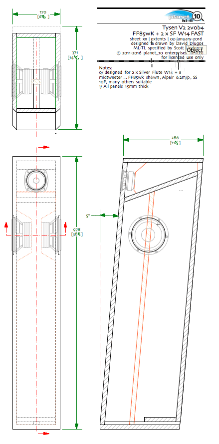

Tysen sets the example of a slim floorstander with a tapered midTL sitting on top of a push-push ML-TL (with side-firing woofers).
As said, an example with A7.3 and pricey scan woofers exist. The tilt in Tysen is because they are short.
http://www.planet10-hifi.com/planset/TysenV2-promo-171217.pdf

1. Which woofers would you recommend with the MAOP 7 or MAOP 5 in a "Timpert-Tysen style" loudspeaker? Only the A12PW? Any other options?
2. I was thinking of a Tysen similar to this one but using 2 side mounted woofers (either the A12PW or another woofer) with a MAOP 7 or MAOP 5 on the front. https://www.diyaudio.com/community/attachments/a7pa12pw-jpg.477422/
These are narrow too but too tall. My wife wont want anything much higher than her shoulder height (say 44-48").
https://www.planet10-hifi.com/planset/MK12pw-A7-MTM.png
3. The challenge the MTM floorstander in your image has is lower WAF. In the end I would like the speaker to integrate aesthetically into the living room. Hence I was looking at a narrower front baffle and side mounted woofers. The bonus being that the 2 woofers can be interconnected to reduce vibration (sort of like the cylinders of a boxer engine).
4. How does one handle baffle step with side mounted woofers?
5. What defines a Tysen? I assumed any loudspeaker that uses a full range in the front baffle, supplemented by 2 side mounted woofers would fit the "Tysen" criteria.

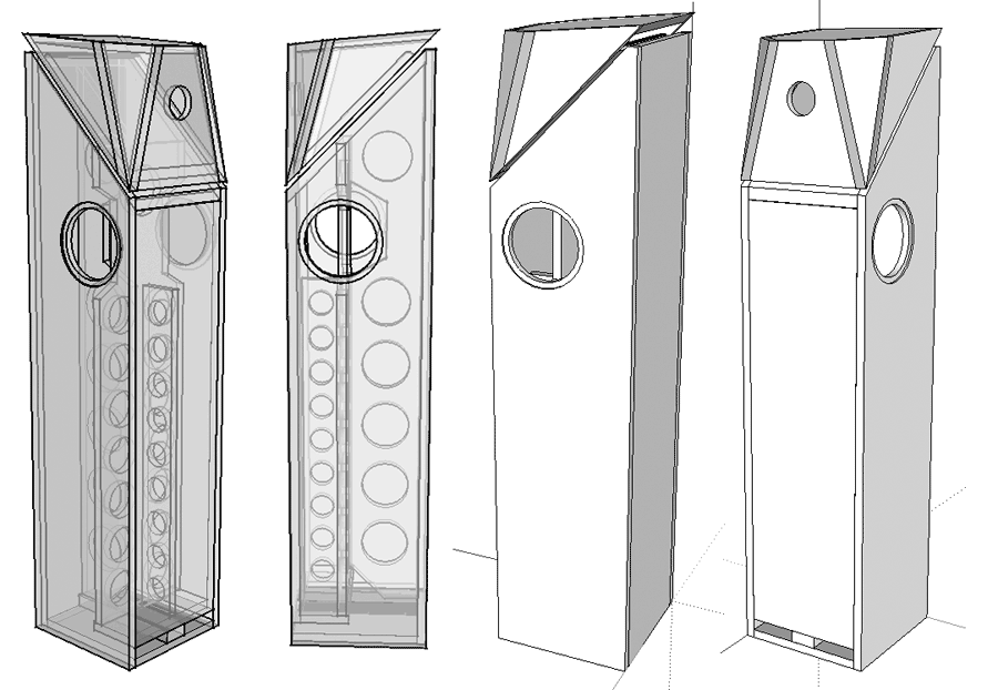

A “Tysen-style box” would be an ML-TL push-push side mounted woofers with a highly tapered midTL on top. There are many potential cosmetic possibilities including the one you linked with the careful attention to low diffraction around the “tweeter” but misses out on doing a lot more. That helps only with HF diffraction, and with the midTweeter used, could well be moot at the frequencies it is operating at due to limited dispersion of the 4” A7p. More important to concernn yourself with the shape of the 2π to 4π transition.
There are just too many woofers to choose from for me to directly recommend something. The A12pw is certainly very good, it does have a slight edge in voice matched to the MA tops than say the SDX7eN used in our other big WAW. The other woofer we have used is the EL166 (anyonr close, i have a trapeoid ML-TL helper woofer with 4xSDX7eN for take-away (too big to ship, i will accept donations, but they really just need a good home).
I would turn the question around, what woofers work in an ML-TL that can be fitted under the midTweeter TL, and that you can get for a good price where you are.
If you go active you have much more potential choice. Do note that Class D can do very well in the bottom with something more nuanced on top. I have a 4x100 into 4Ω downstairs that was built from a pre-builf sure board for <$100 USD. Considerably less than the big chokes & almost beer can sized caps.
With the side firing woofers there is no baffle step. Only on the midTweeter. If you set the XO somewhere between (0.707->1) times BS(-3) and use the gain control on the bass amp to dial in exactly as much as you need.

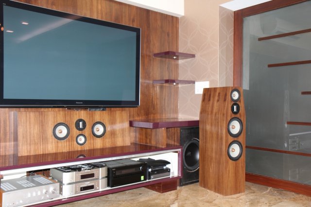

My current speakers are 44" tall, 10" wide and 16" deep. Keeping height constant, we were considering something slimmer and less deep. Say 7" wide and 14" deep? Beyond just physical size, the aesthetics (shape and proportions) of the Tysen V2 look very pleasing.
I am the only person among all my friends and relatives using "traditional" speakers and amplifiers. Most of my friends have moved to soundbars for video and Sonus (1 has BluSound) for audio. My wife keeps wondering why we need towers! 🙂

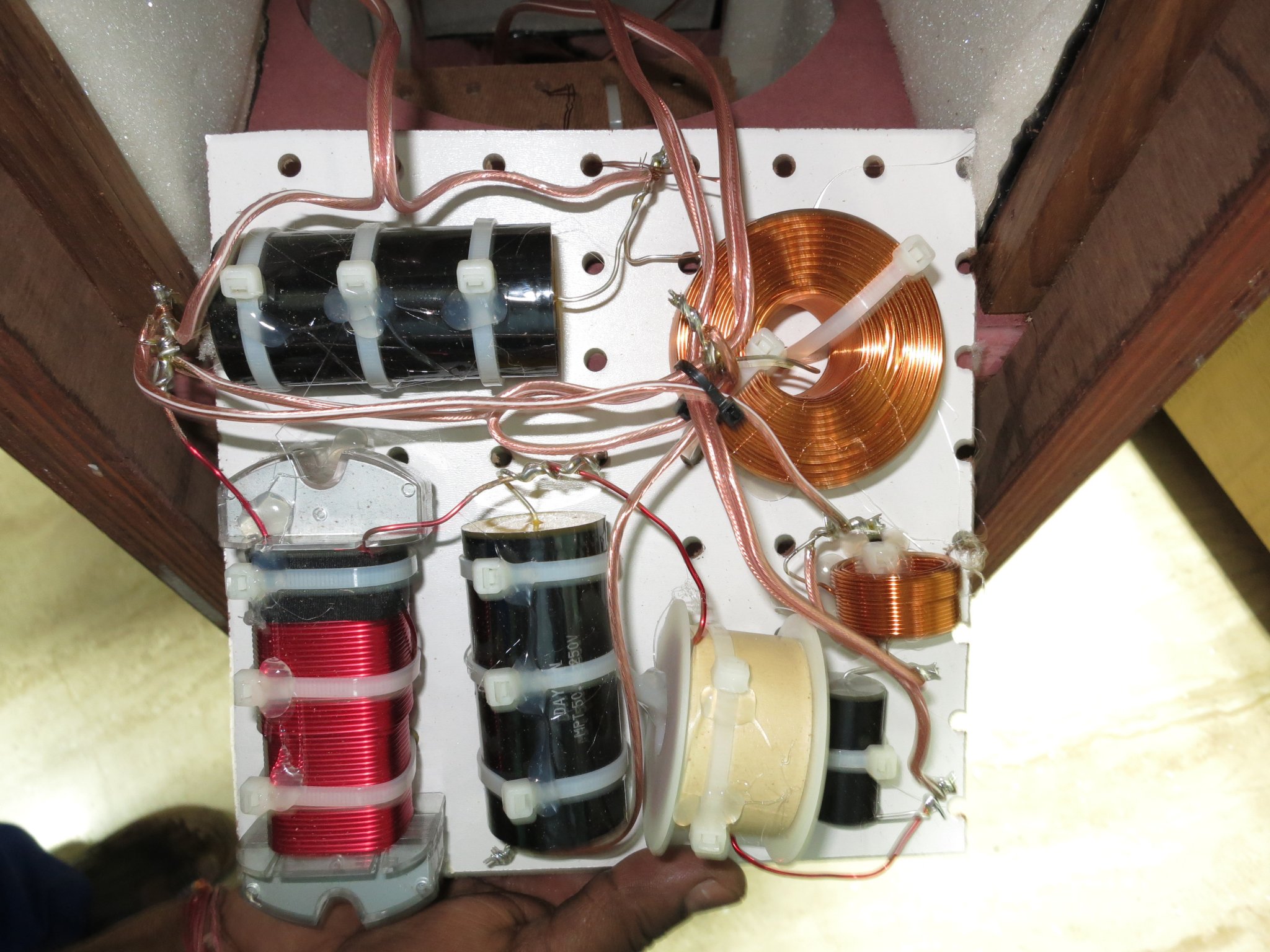

The speaker (including the crossover) was designed by Rick Craig of Selah Audio. Rick passed away in August last year. From all my interactions with him, I can say with confidence that he was a real gentleman.

Round ports can be easily adjusted but some like the Tysen's port is a slot and are hence integral to the cabinet. I would assume the slot port can be replaced by a round port having an equivalent area.
