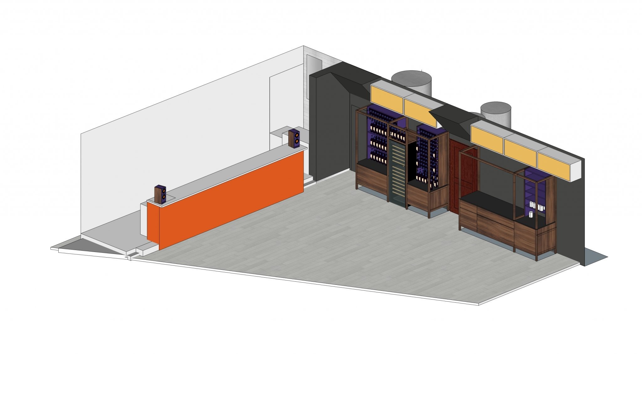

Amp & other kit? Room size? Where are you?
dave
dave
Bristol, Uk.
It's a tricky site...10m long, 9m wide tapering to 3.5m. Lots of glass on the angled side. I think for aesthetics the speakers would sit on the bar, so be approx 1.3m high.
Scott & Stefan has both visited in its previous incarnation.
I've got a bit of old kit kicking around, at the moment I have a little Roon NUC playing through a Hypex DLCP with the older UcD amps & Alpair 7.3's in sealed boxes.
I have a few boxes for the new 252 or 500MP nCores so may get the boards to finish these (I have the 500w ones at home and like them with Alpair 7.3;s).
Or I have some Hypex fusion plate amps if I want to do something more complex, but these have been sat dormant for ages, I think I have some 10" Beyma woofers and a whole load of horn drivers awaiting homes.
Ideally I would love to throw some tubes in there, and have it all analogue.

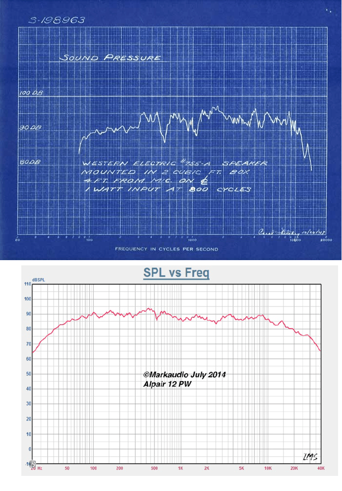

Came across this for the A12pw wideband that i thot was interesting: "It's worth noting though that the FR is not dissimilar to the Altec 755A"
An interesting point. Digging the 755 measurements out of my records, the overall response trends aren't actually all that far apart. Ignoring the bottom end, since the 755 was measured in a box, both are quite flat through the midrange & lower treble region, & also appear to have the same mild cone modes around 2KHz, 4KHz & 8KHz, despite the difference in Sd. Same sort of progressive rolloff >10KHz too. The 12PW isn't going to be a substitute, obviously (!), but in purely in terms of general on-axis response trend / balance, there are definitely parallels.

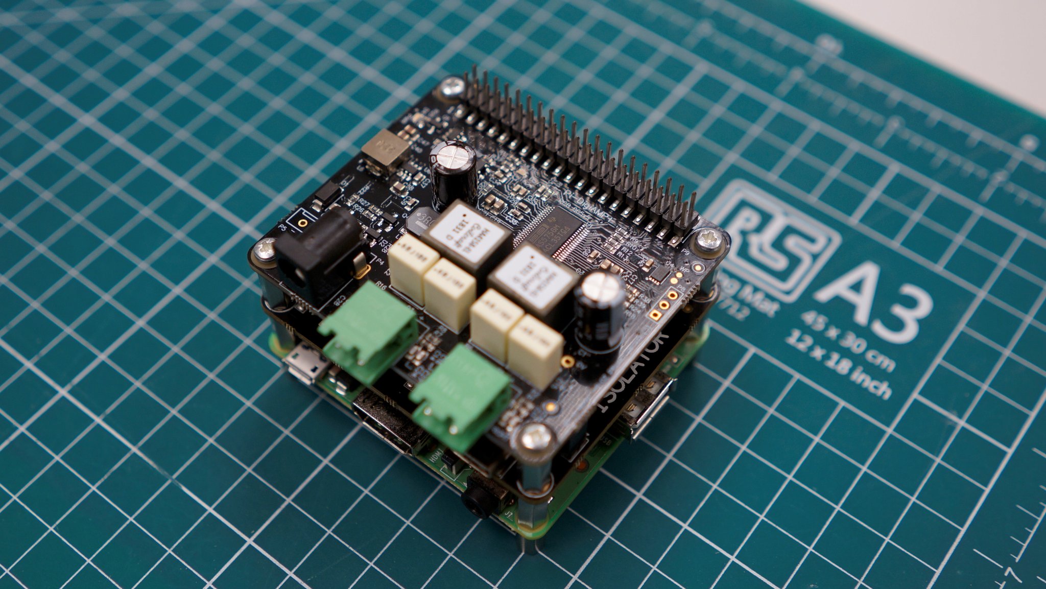

Hi, I have good experience on a casual listening setup that incorporated CHN-50P with IQaudio DigiAMP+. Simply plug n play, applying the picoreplayer as Airplay endpoint.I have a pair of CHN-50s on the way for a not-so-boom-box.

I am considering to try the MA12070P HAT also.

I went for the DigiAMP+ too. HiFiBerry seemed to be twice the price for the same design. Also I recognise the coilcraft inductors and the inbuilt power supply is useful. Looking forward to getting the setup this week, not much bigger than a two PU5 side by side. I'll make a build post on the forum once I've got things up and running.
Yes indeed, I like the KEMET film cap too.I went for the DigiAMP+ too. HiFiBerry seemed to be twice the price for the same design. Also I recognise the coilcraft inductors and the inbuilt power supply is useful. Looking forward to getting the setup this week, not much bigger than a two PU5 side by side. I'll make a build post on the forum once I've got things up and running.
