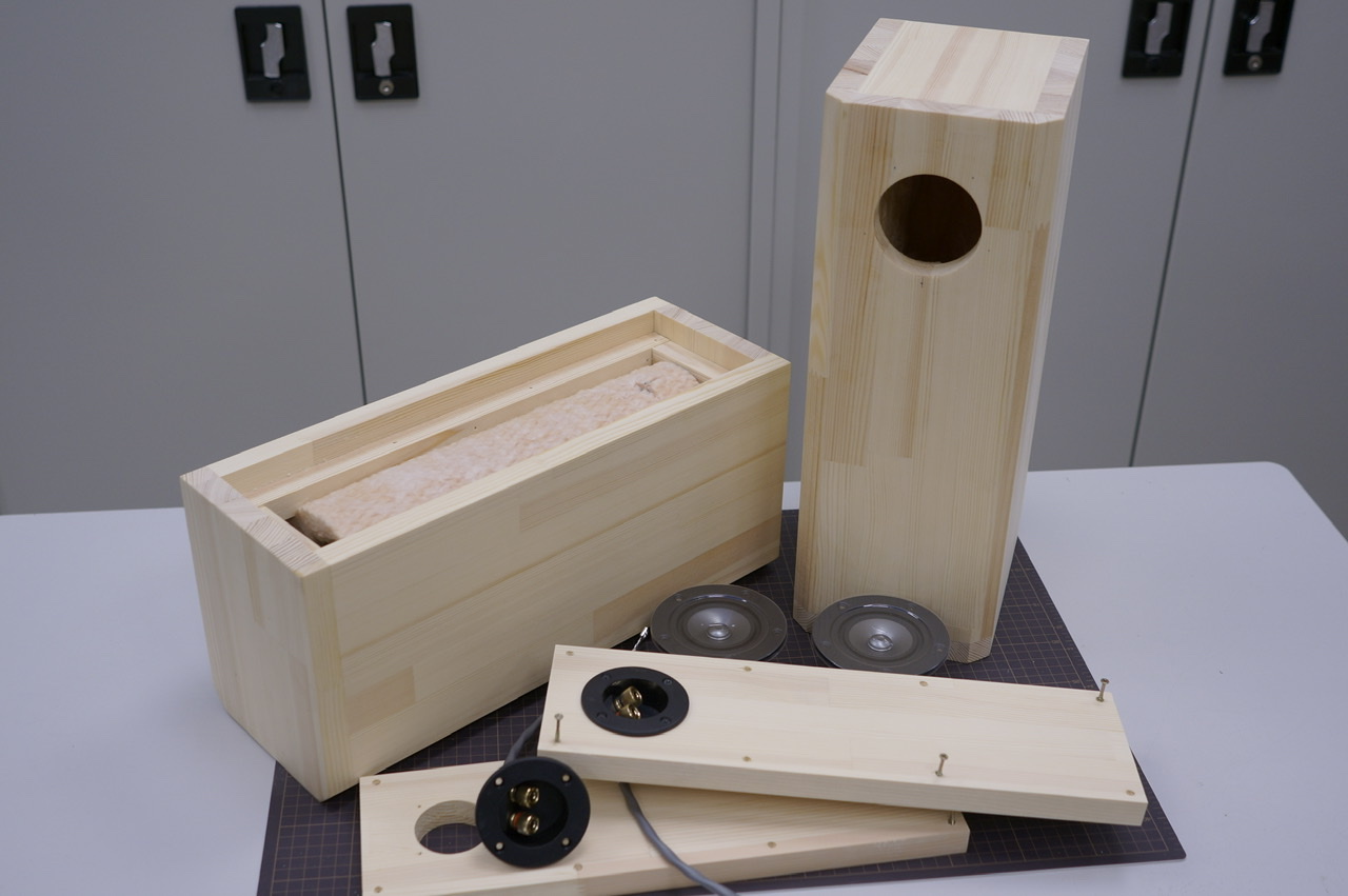

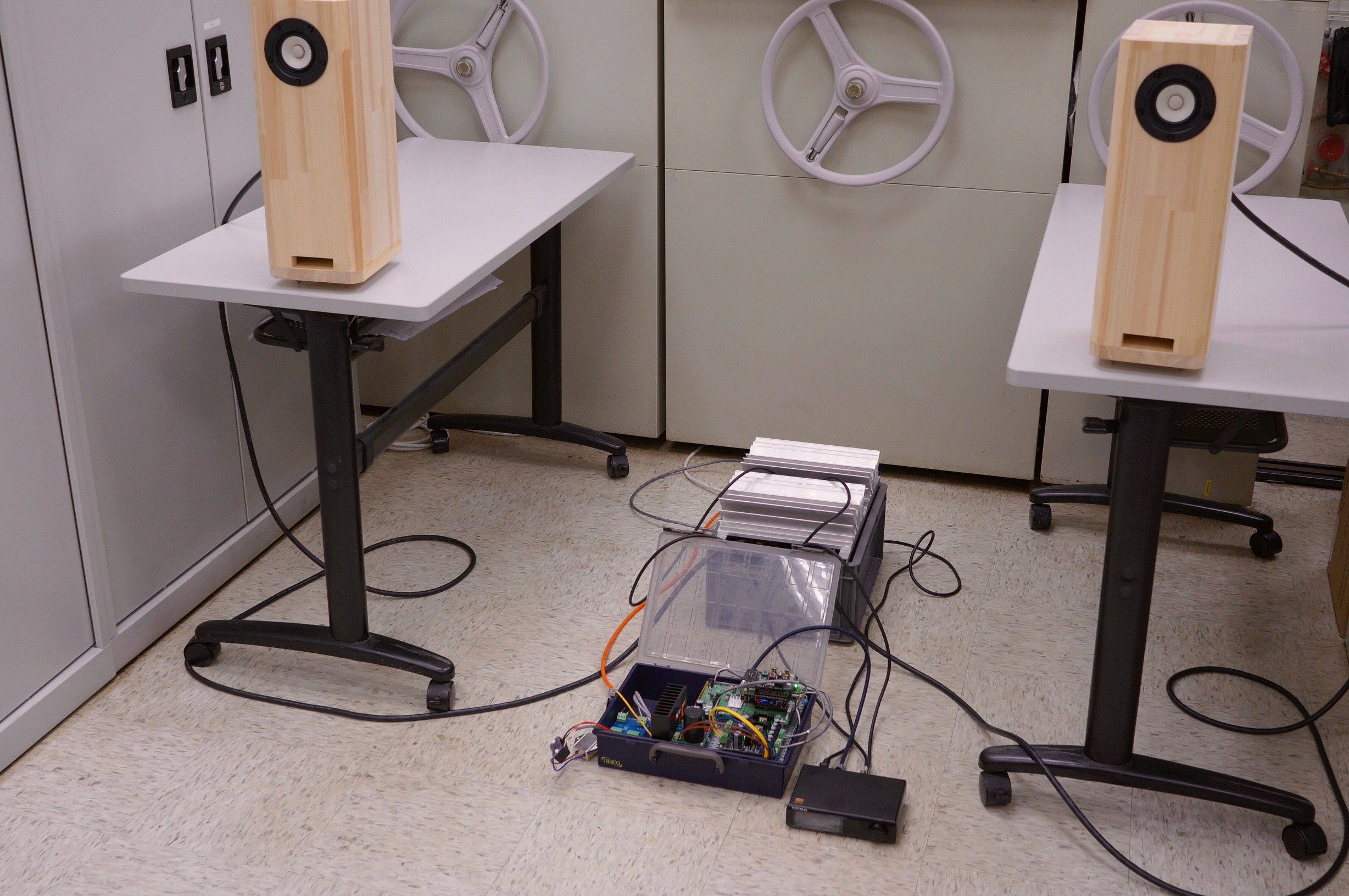

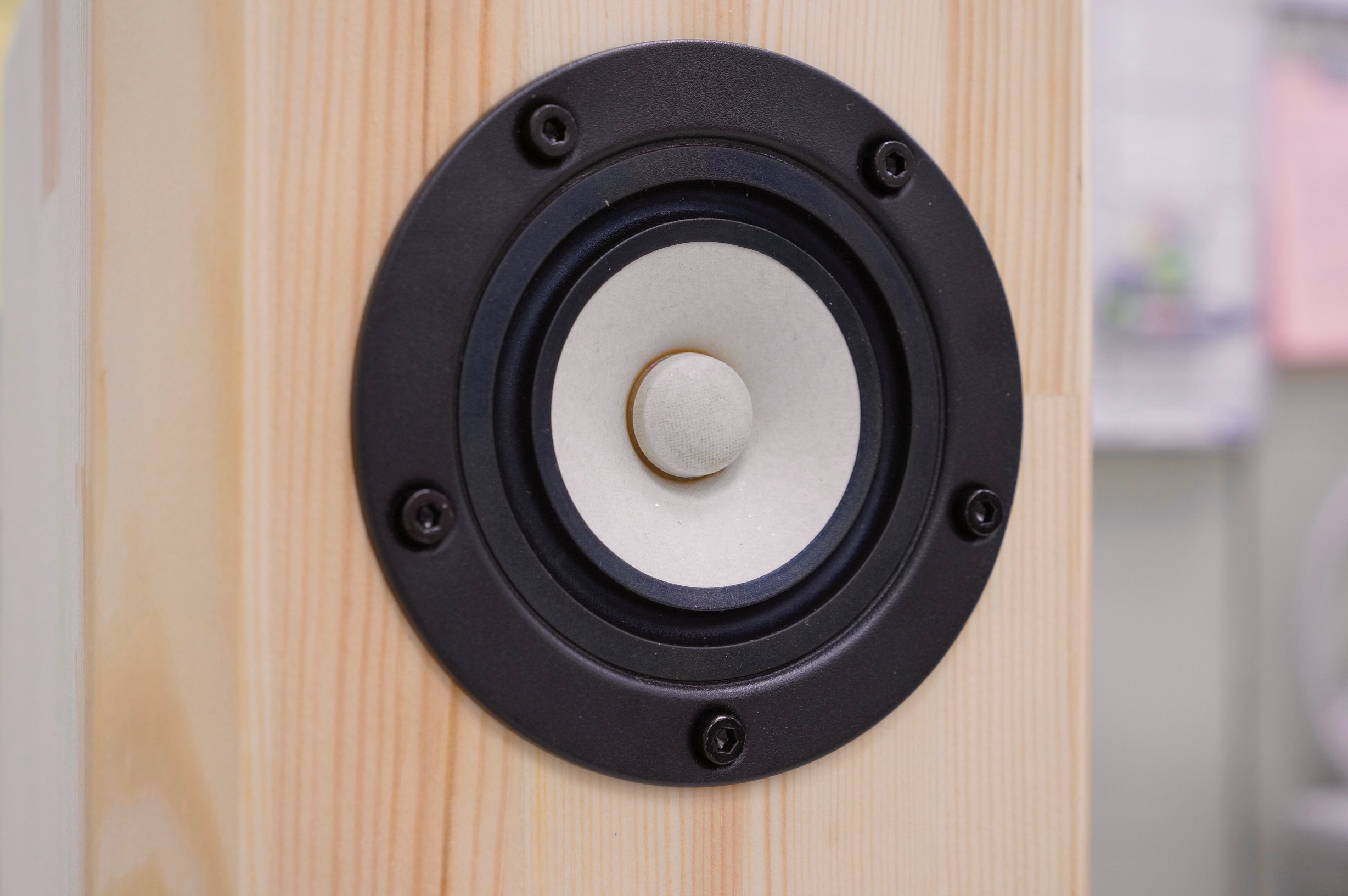

I just changed to CHN50P which is paper cone version of CHN50.
Comparing with the OM-MF519 I listened before, the 50P seems a bit more natural and organic especially on vocal playback, mid-bass also more texturized.

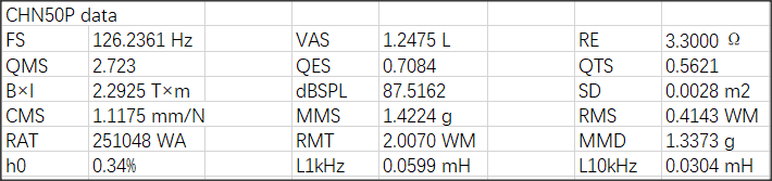

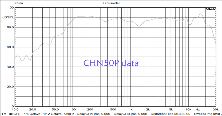

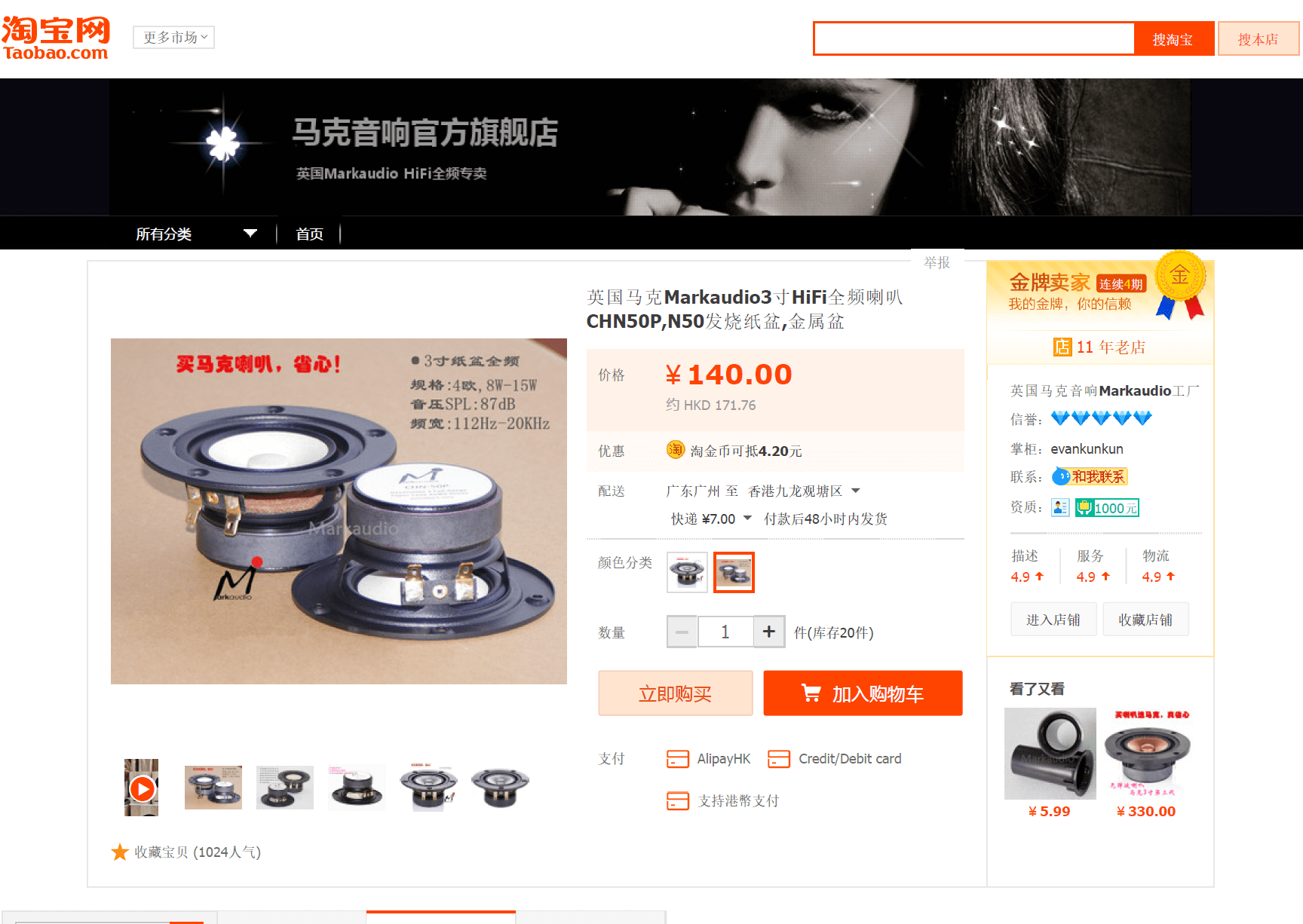

I purchased via China official dealer's Taobao store directly. It is about 15.7% higher price than the ordinary CHN-50.
The parameters and chart listing below is captured from the store page also.

I don't see anything exotic in this driver. I see a DEEP at around 1100 ~1200 Hz (human voice) and at 11KHz also and a peek at around 15KHz and after that a "cliff". I think vifa's TC7FD04-04 have better performance, but maybe I'm wrong. EliasThe parameters and chart listing below is captured from the store page also.
