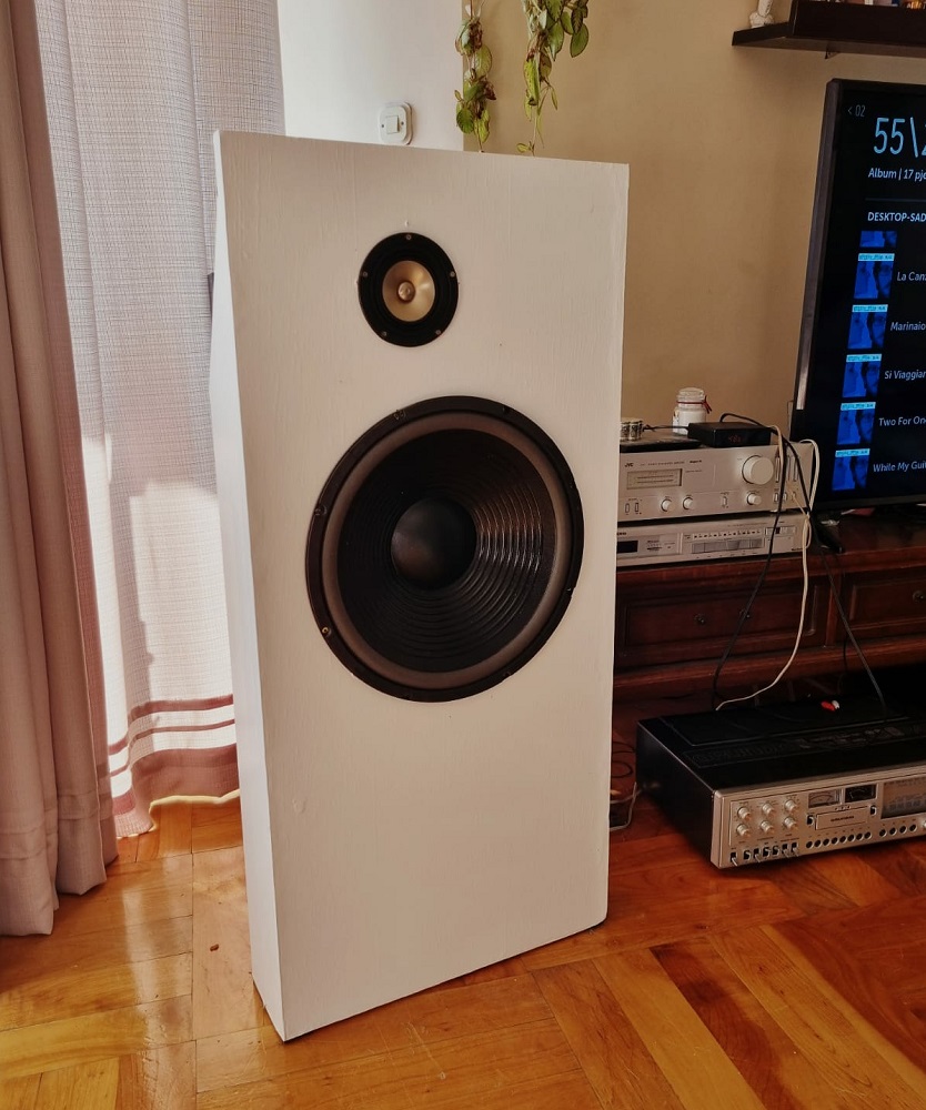

one more + for Pluvia 7 HD,
here in "Manzanita " OB, good sound from beginning
