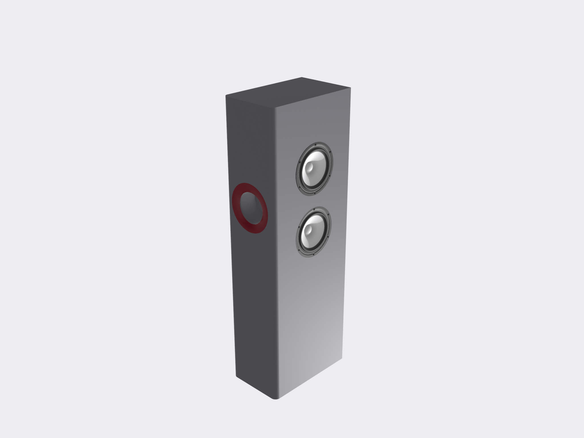

Working backwards, if my box is (46"x 6"x 14" internal) 2 cu. ft. (56 litres) and I have 4 woofers sharing it, I would have to choose a woofer that works in 0.5 cu. ft. The SEAS L16RNX seems to fit that bill. What do you think?
https://www.madisoundspeakerstore.c...l16rnx-6-aluminum-cone-woofer-h1488-08-8-ohm/
It looks like the woofer has to be as close to the top of the speaker as possible while the port is close to the bottom.

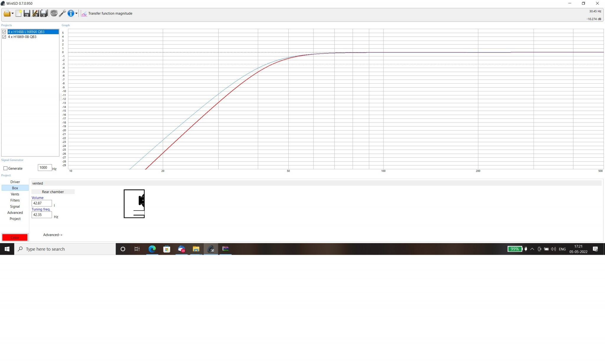

I took the SEAS L16RNX H1488-08 into WINISD. It gave me a QB3 volume of 11 litres with a 9" (24cm) long x 2" (5cm) dia. port. Tuning freq of 42Hz. I am fine with 42Hz as this is the open low E on the bass guitar. There is very little information below this except maybe on some classical pieces. The B string on 5 string basses can go as low as 30Hz but I do have a corner loaded 15" TC sounds subwoofer on the rare occasions I need to cover this last octave (20-40Hz).
4 drivers would require a box of 44 litres or about 1.6 cu. ft and a single 4" (10cm) dia. x 9" (24cm) long port would suffice. WINISD also computes "Ist port resonance" which is around 700Hz. Halving this to around 350Hz leads to a very long (20" or 50cm) port.
I also took the SEAS L16RNX3 H1869-08 into WINISD. For 4 woofers I got a box of 35 litres (1.25 cu. ft) tuned to 38Hz with a single 10" long x 3" dia. port.

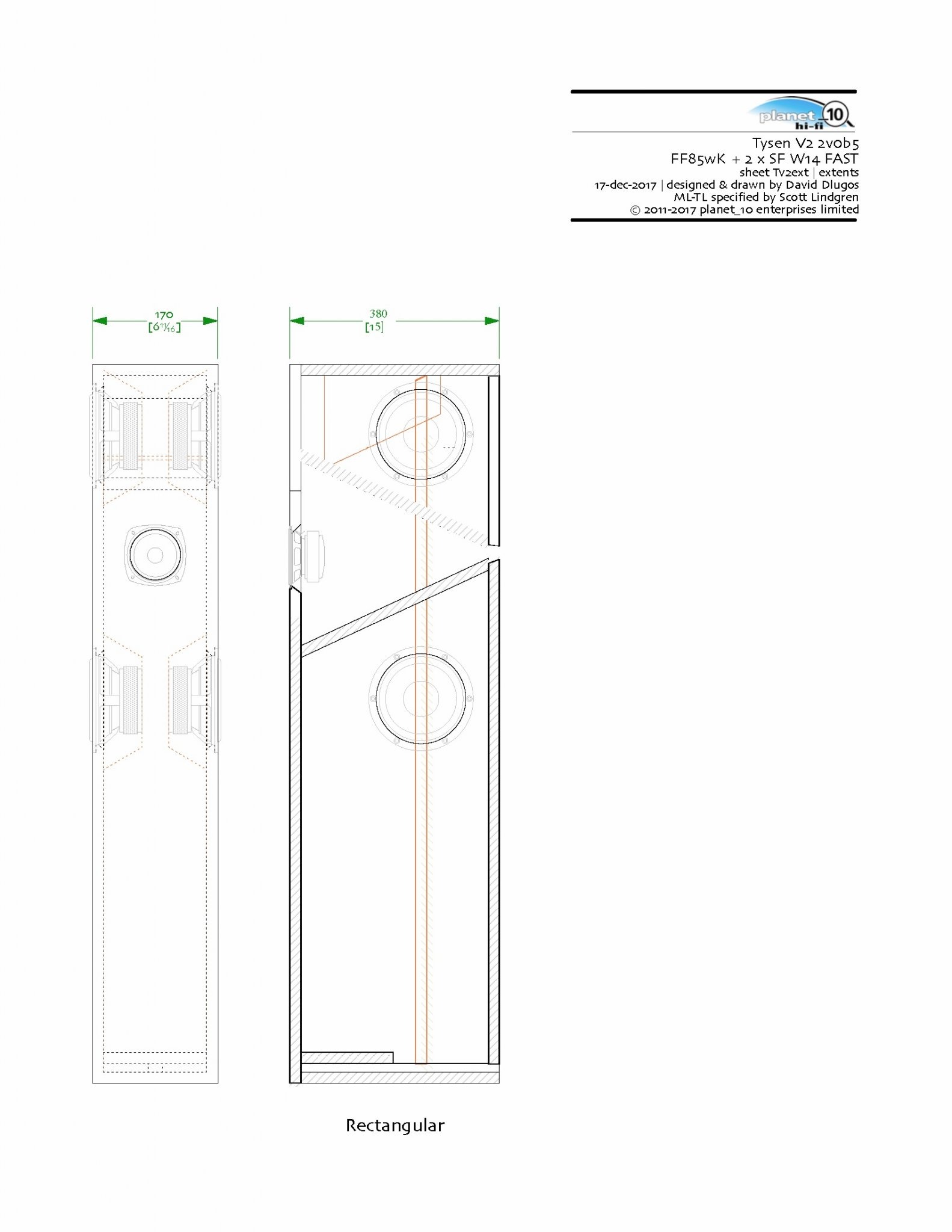

Assuming that 2 woofers would be above the full range and 2 below, a good approximate for Zd would be anything between 8" to 9" (diameter of woofer + radius of full range). Zv would be around 43-44".
Something like this
https://www.diyaudio.com/community/attachments/1650220363767-png.1045607/

With reference to post #1993 by you, I have attached the image you shared of a 4 x woofer design.
The 4 woofers share the same cabinet volume? Or the top 2 push-push woofer are in their own space, and the 2x woofers below the wide-band are in the ML-TL part?
I'm not Dave but since post #1993 was penned by me I'll try and answer this.Dave,
I am sorry but the sketch which was just a crude cut-paste of Dave's Tysen V2 design does intend to have all 4 woofers sharing one common box volume. I know the sketch does not look like it but it's just a side view. In reality, the MAOP7 would be isolated in a conical enclosure that exits out the rear of the speaker. Something like this:
I assume that this cone would have a volume of about 1.7-2.0 litres (12cm dia x 37cm length).

As drawn it looks like they are in different size boxes.The 4 woofers share the same cabinet volume? Or the top 2 push-push woofer are in their own space, and the 2x woofers below the wide-band are in the ML-TL part?
If you are going to flip/mirror a pair of drivers on the bottom, the top ones will be the same as the bottom ones. Like in Twin Frugel-Horns.
But it is possible to reorient the taper of the midTL to ensure the enclosure space for the woofers are common. As we did in our A12pw MTM.
dave
Absolutely. Just one question does the MidTL box have to be rectangular? I was thinking it would be easier to make a cone from fibreglass or hard cardboard or even find a planter with the required dimensions. A fibreglass cone with a wall thickness of 5mm would be stiffer and occupy less space in the box than a rectangular cone made of 12mm wood.As drawn it looks like they are in different size boxes.
dave
If we need 43 litres for the woofers, 6 litres for the MidTL and another 6 litres for the bracing it totals 55 litres or 2 cu. ft. Would a requirement of 6 litres be a fair assumption for the volume of the bracing?
Since the internal height and depth are more or less fixed at 44" and 14" respectively. To achieve a box volume of 2 cu. ft. the internal width would have to be 5.6". If bracing takes more than the estimated 6 litres, I could increase the width accordingly.
