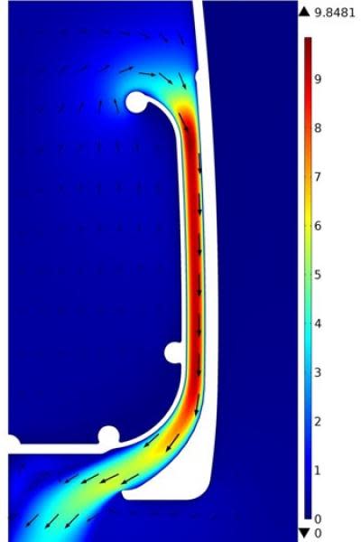

Yup, I understand this. If the slot is tall enough there will be less of a difference as the airflow along the walls of the port will have less of an effect.,With respect to the slot vrs cyclinder: In theory, there is no difference between theory and practice. But, in practice, there is.
Exactly! This again begs the question, why not a PR? It removes the question of the prospect of simulating "airflow" altogetheruntil the aspect ratio of a slot increases sufficiently for the friction to start damping the alignment (in effect adding acoustic resistance).
As shown in the image from Genelec below (source: https://www.genelec.com/key-technologies/laminar-integrated-port-technology)

Almost no added R and an additional suspension resonance make a PR quite different.
Thanx for the genelec pic. The Red is the key bit. Added R to the vent pushing it more aperiodic and making the box less sensitive to dynamic T/S changes.

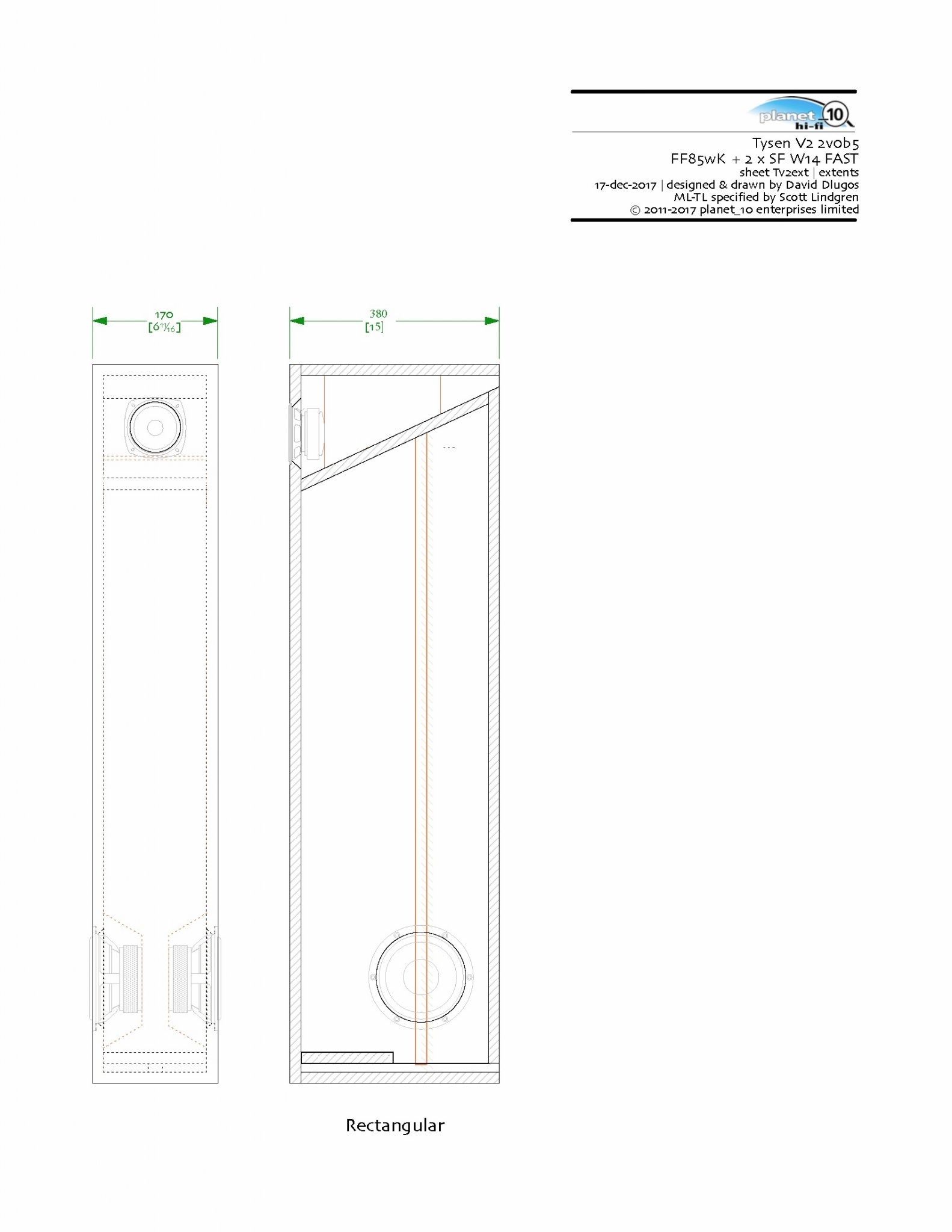

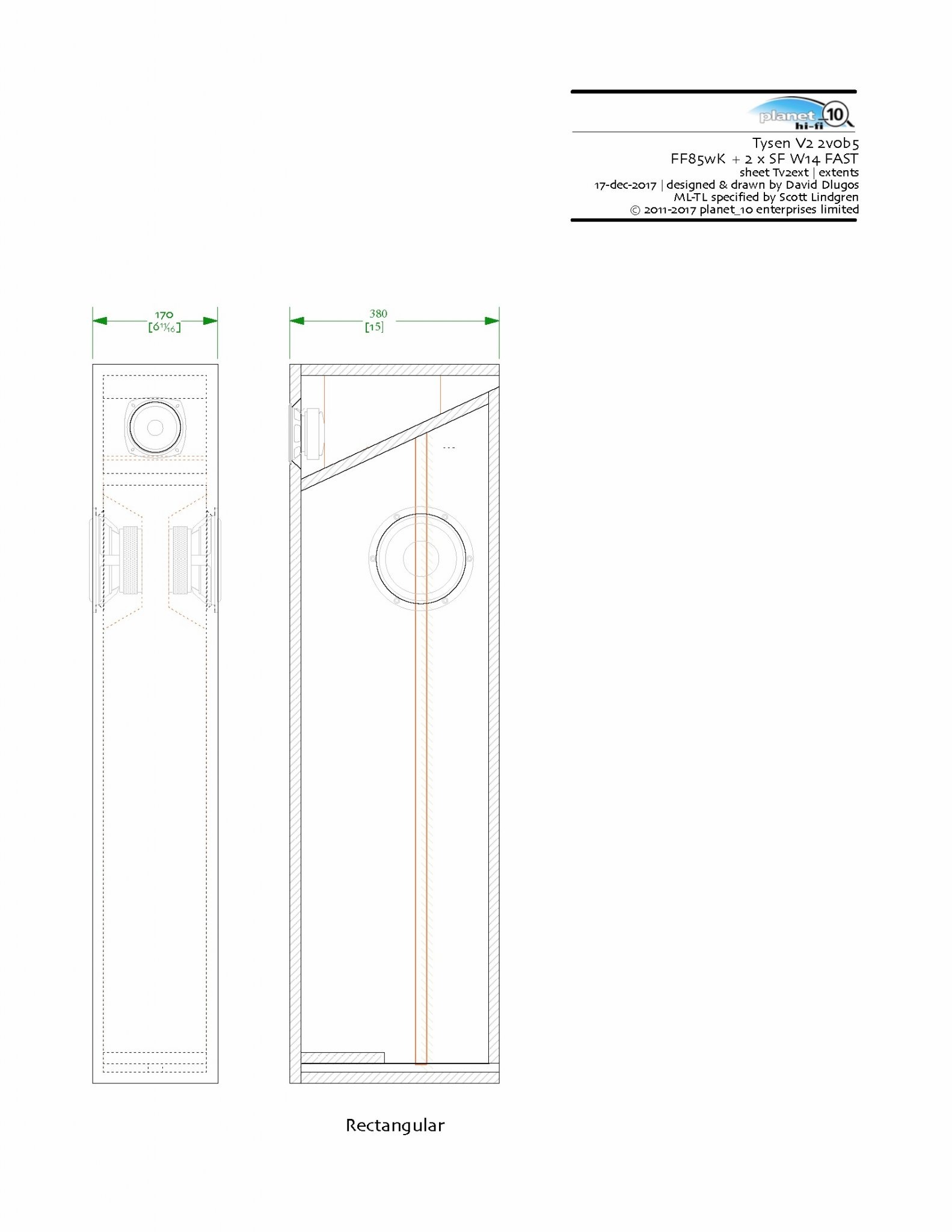

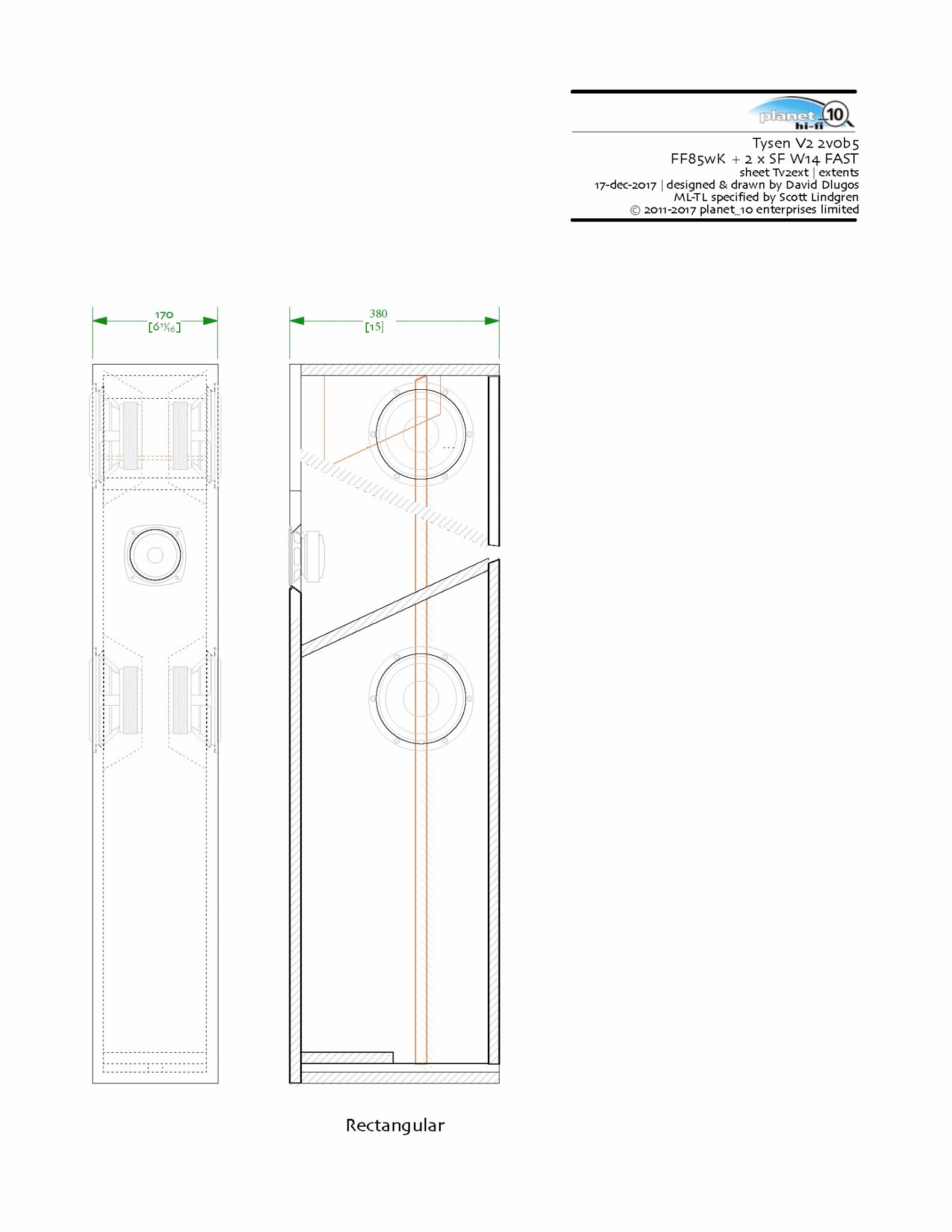

Great I have 3 "designs" in my head. Each of them involves a 4" full range on the front baffle. I have made some crude sketches by editing the original Tysen PDF to help you visualise my thoughts.
Option 1. 2 x 8" push-push woofers placed slightly higher up than on the Tysen V2
Cabinet dimensions: 46" H x 7" W (front) 8" W x (rear) 15" D
Which of these 8" woofers would suit this configuration best?

Option 2. 2 x 8" woofers placed as close to the floor as possible to eliminate floor bounce (http://www.troelsgravesen.dk/BOOKSHELF-1/RoyAllison.pdf)
the same choice of 8" woofers as above. Maybe the port at the bottom can be moved to the top and face the rear instead of the front.
Option 3. Clone of KEF Blade (using a port instead of ML-TL) using 4 x 5-6" woofers instead of 2 x 8" woofers.
Cabinet dimensions: 46" H x 17" D x curved front baffle 7" front, tapering to 5" in the rear. I can make a small conical enclosure from fibreglass for the 4" full range.
Choice of 6" woofers.
Woofer placement in n ML-TL is usually determined by the designers choosen Zd. Not taking advantage of this means the TL typially needs more damping.
One of the goals of a WAW is to get the midTweeter and teh helper woofers within a quarter wavelength at the XO. This approach will greatly compromise that. I in fact have never had an issue with, or obsessed over floor bounce.Option 2. 2 x 8" woofers placed as close to the floor as possible to eliminate floor bounce
The only difference in concept with Blade versus Tysen is that the Blade mirrored an extra set of woofers so as to make a symetrical )push-push) woofer, midTweeter, PP woofer in an MTM arrangement. Flip a tysen woofer upside down and put it on the top, gives a Blade configuration. While thot experiements outlined the concept, the blade beat me to the puch and is a brilliant design over all. (althou i would not be surprised if they have soem KEF-ness to them).
We did this with the facets, adding a second set of Peerless 830870 to this design, and then jumping thru hoops to get a quarterwave load for the woofers.
Not easy to build.
