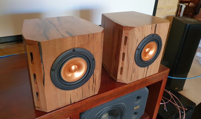

That's a beautiful pair of speakers! A pity that they are not flush mounted - that's my inner autism speaking 😉
You can get away with no rebate with the new baskets but things do look tidier if you do one.

Yes it is, I wonder what species that is.That's a beautiful pair of speakers!
