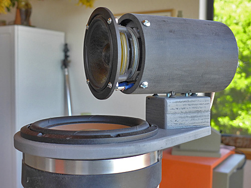

Anyone here tried an alpair 7ms or 11ms in a no-baffle configuration like how the fullrange driver is mounted on a linkwitz lxmini with a tunnel with absorbing material behind the driver. And use a single subwoofer operating below 80hz for bass extension. How would they sound.
Staging should not be affected as frequencies below 80hz is omnidirectional (correct me if im wrong)
What would be the cons of this configuration except the power handling
Neither drive unit will make it unaided to 80Hz under those conditions; anechoic baffleless -3dB mass corner frequency is 200.87Hz & 214.978Hz for the 7MS & 11MS respectively using the published data. So you would either need significant EQ, or cross higher, as Linkwitz did.

Anechoic on an IEC compliant test baffle. That's how the vast majority of manufacturer anechoic measurements are taken. Seas are probably the most famous exception: they use test boxes, the dimensions of which are provided on their site, with the mathematical T/S derived curve also provided on the FR chart.
Shouldn’t it be at a higher frequeny? What is the starting point of the dipole cancelation with a 122mmm wide circular baffle?
I have never been convinced that a baffleless OB driver is a useful approach.
dave
Purely mathematical T/S derivation which assumes monopole conditions; additional cancellation effects from dipole etc. losses will kick in far higher.
As the LF is concerned, neither have I. Sure, you can use multiple drivers, usually with copious amounts of power & EQ, but since it's about the least efficient way of using drivers in the LF I can think of, I generally find my interest goes off a cliff faster than Wile E. Coyote. 😉

The thing that attracted me to lxminis are the simplicity.
My design aims were that all frequencies above 80hz should be from single driver. But now its clear for baffle less none of the FR drivers can do that
