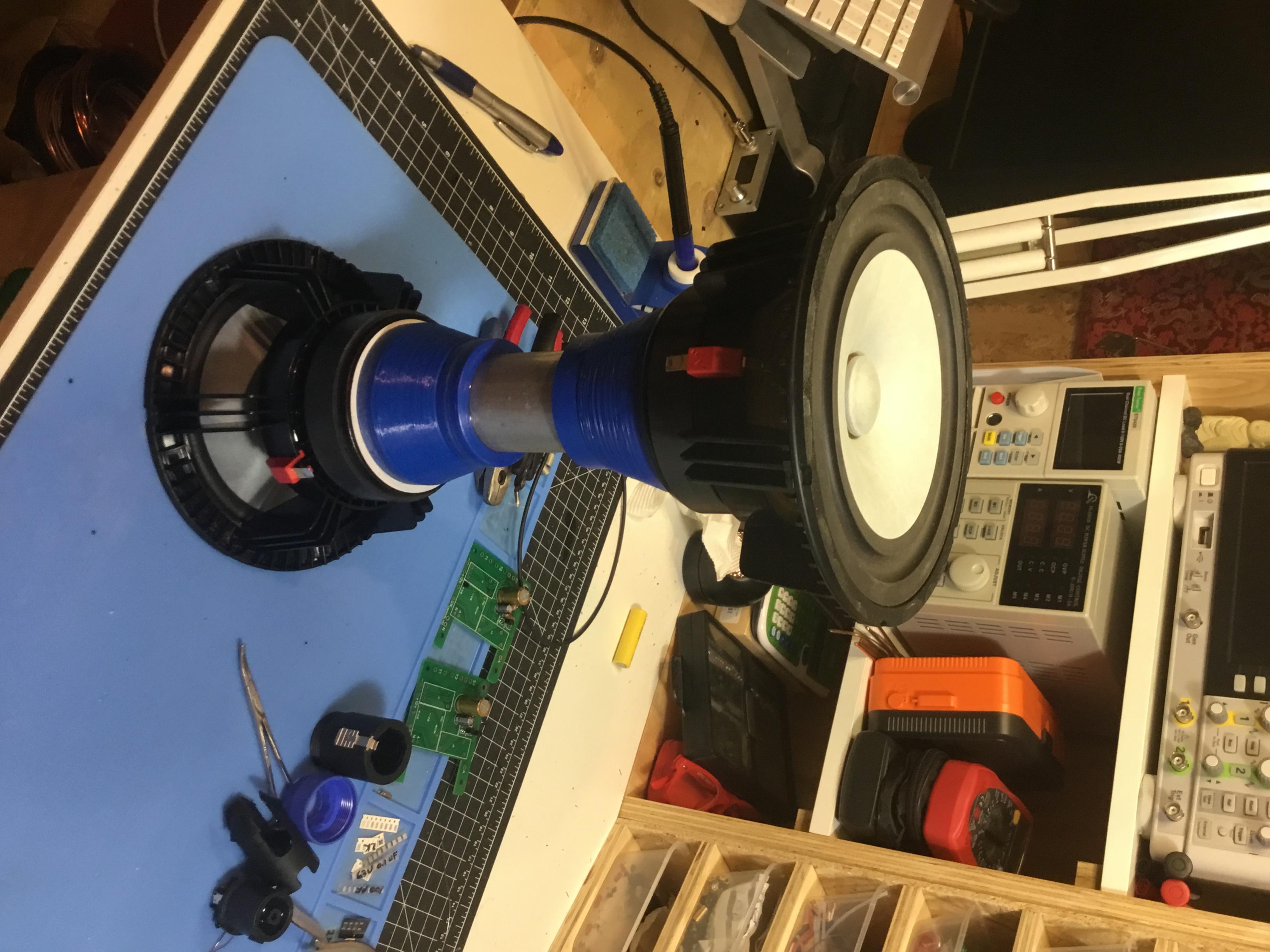

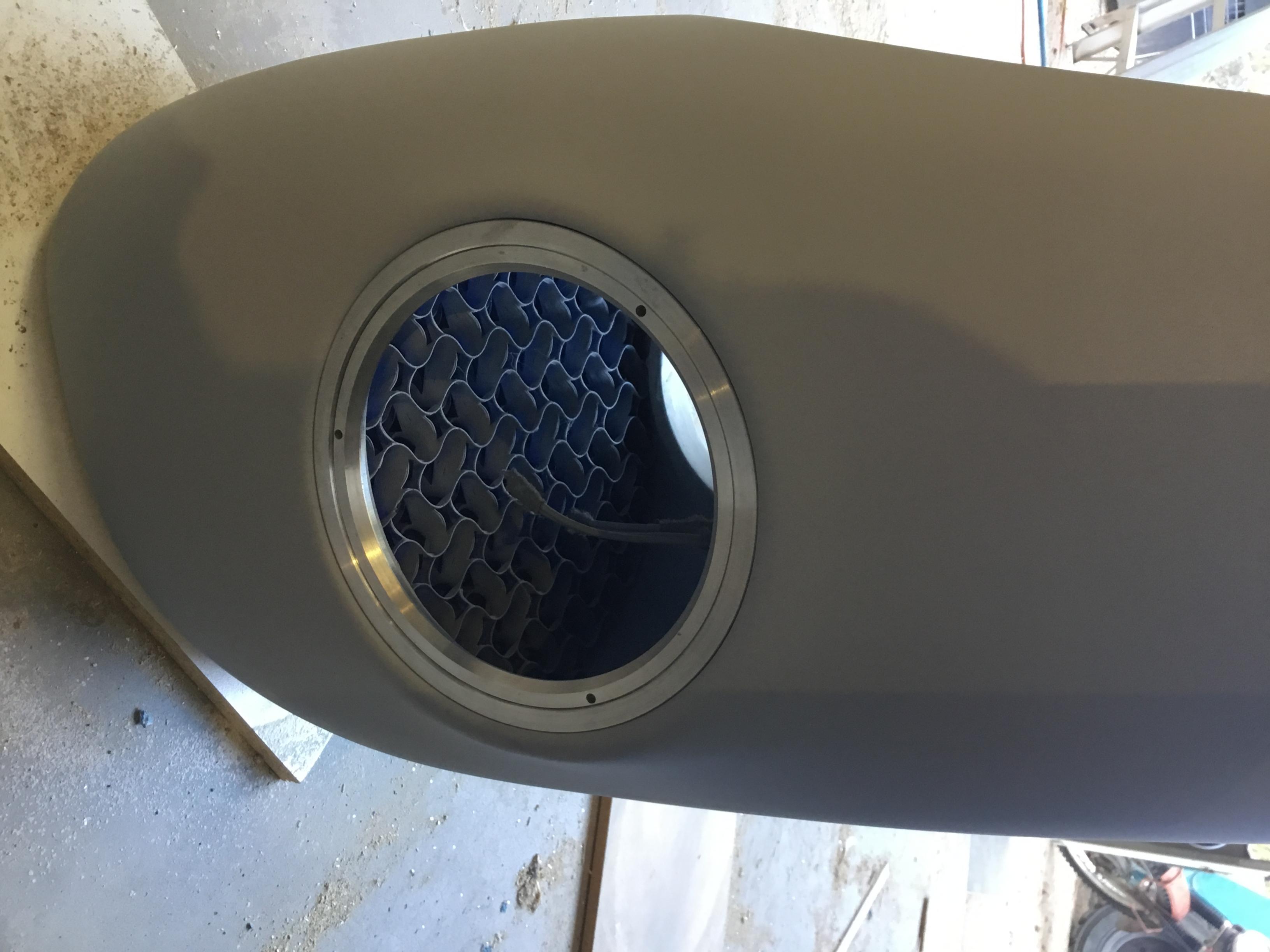

thanks for your kind comment. I really like the 12pw, actually they are my favourite MA driver. That said they really only produce the magic at low excursion which is one reason I think multiple 12pw in a single box is a good solution. if you want SPL definitely look elsewhere. For high quality bass at low SPL i think they are truely excellent, especially considering the size of the actual diaphragm... My design was created for a specific listening room which has lots room gain due to its size. this is one reason why I went for a sealed box design, I have used them in ported boxes and they also sound excellent however not quite to my taste.

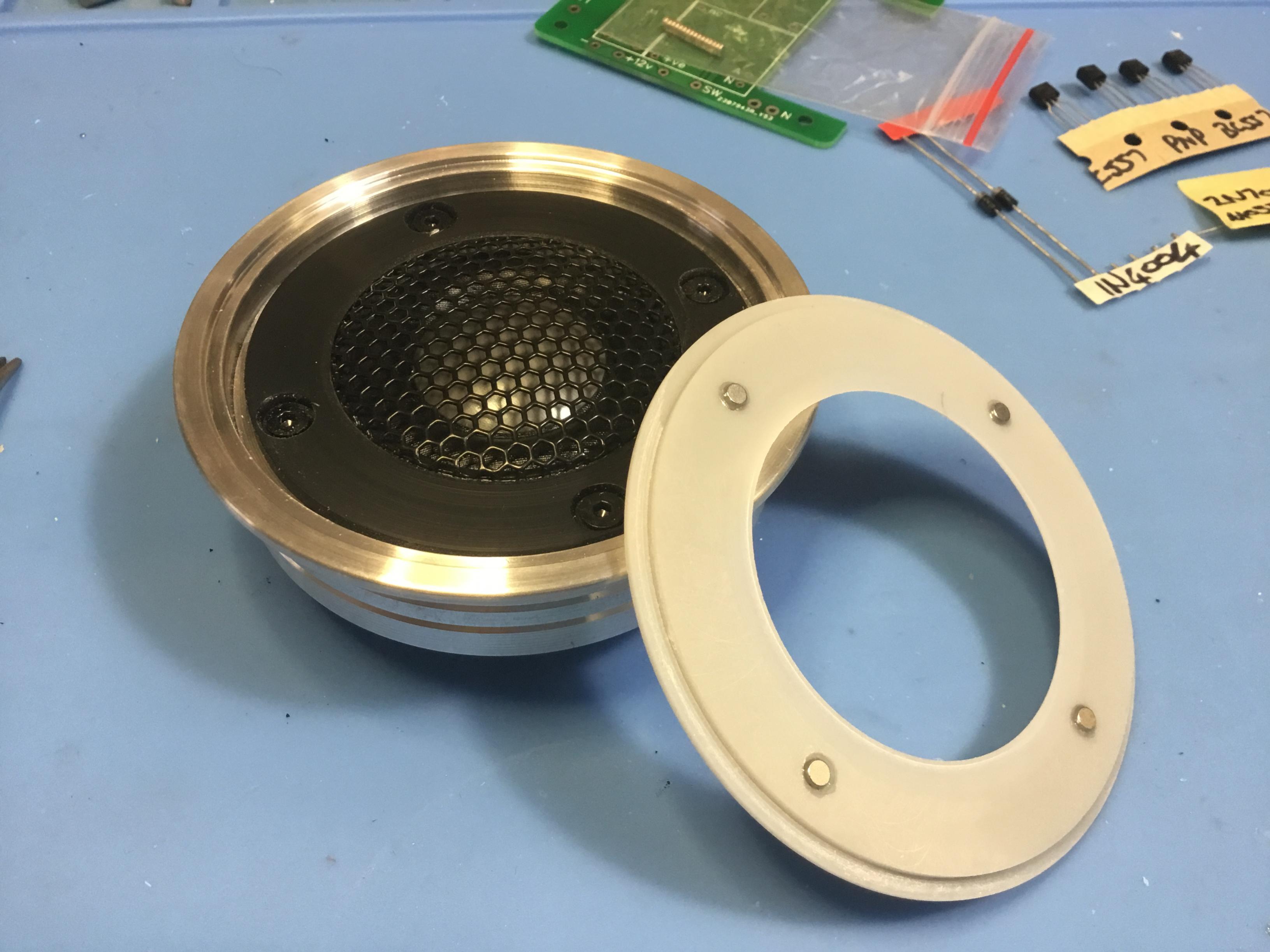

For the crossover, I did initial testing with a mini DSP to work out crossover points and slopes. I arrived at 200hz and 3000hz with 4th order slopes after a little listening. I like Mini DSP for convenience but would never consider using one in a finished design so I bought some active crossovers to test from XKitz and am very impressed with them. Not sure they will stay in the design as I will likely build my own crossover, I doubt there will be a sonic benefit but I like making my own things. For the actives I use the designs in Doug Self's Active Crossover book.

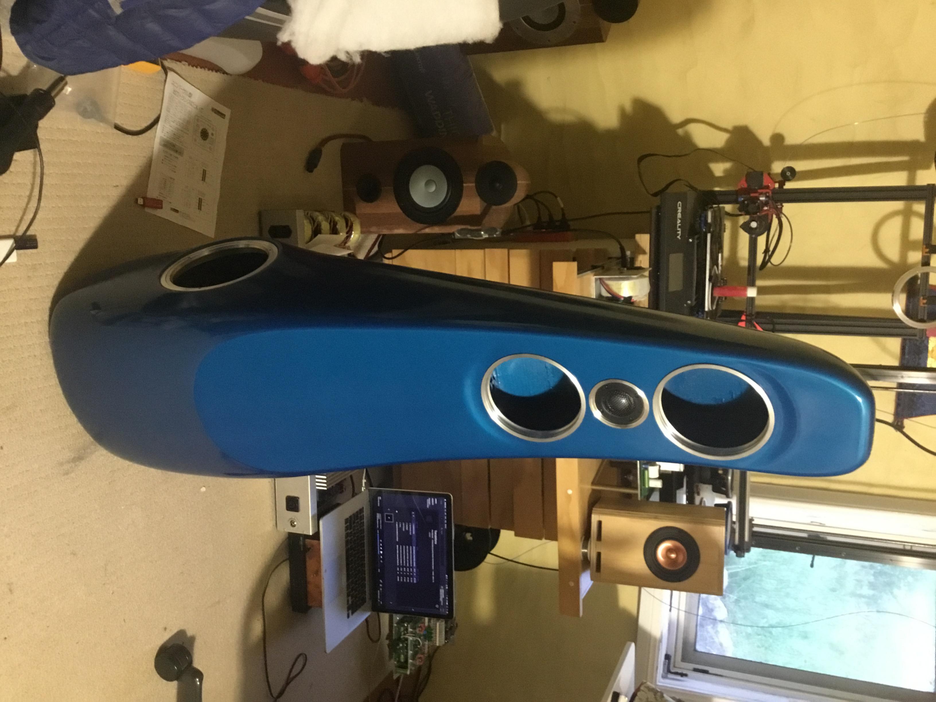

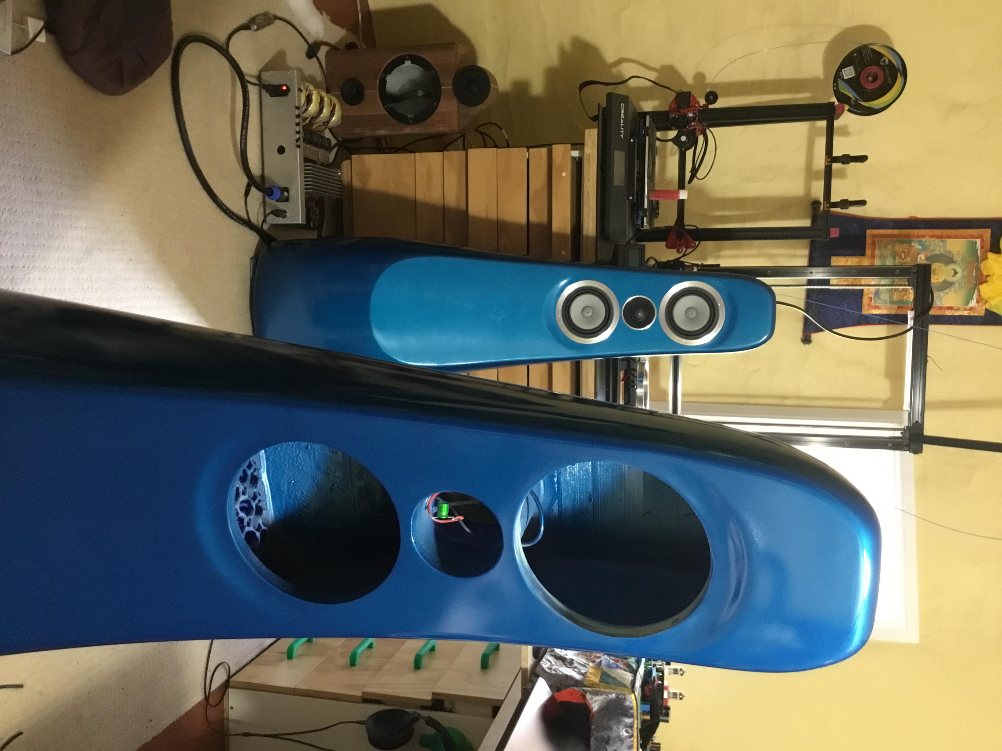

Printer is a Formbot Raptor, you can see it behind the speakers in one of the photos. It has build volume of 400x400x700 although I wouldnt recommend trying to print something as large as a speaker box too high as the inertia of the moving print gets a little worrying above about 500mm. The speaker was built in 4 main parts and printed over a two week period. Quite surprisingly nothing went wrong which is a minor miracle in FDM printing.
I am actually printing a set of test speakers for my next design right now, I will add some pictures if you are interested.

I used the Mini DSP to test a lot of different crossover points. I planned for somewhere around 5000hz but 3000 just sounded best, it wasnt based on measurements just listening.
Dual Alpair is interesting in the D'Appolito configuration, I am not sure there is an improvement in soundstage (as far as positioning of instruments etc) but there seems to be a definite improvement in the tangibility of the soundstage. In a listening session with a friend, we were listening to Skip James and Lisa Hannigan. My friend commented that the authenticity of Skip James' experience was more present in the D'Appolito. So while the soundstage didnt seem to have more resolution in terms of position it seemed to be able to convey an extra dimension where things like the authenticity of the performer is more present.
If I had to take a guess it seems likely to me that we have the inbuilt ability to judge authenticity through the tone of a persons voice, perhaps whatever auditory cues convey this are revealed in an articulate system... I dont know.
It also added an extra (and quite delicious) dimension where you feel as though you experience the shape of the singers mouth or the perceive the fingerprint on the guitarists finger as the string is plucked. I have heard this before in point source configurations but it seemed more present here somehow.
What may be of more practical value was the observation that this incredible soundstage suffered greatly from speaker placement. Not so much toe-in but the height of the tweeter and the tilt of the speaker... meaning that the 10p's needed to be an exactly equal distance from the ear for the soundstage magic to do its thing. I have never had to set up speakers as precisely as these ones.
