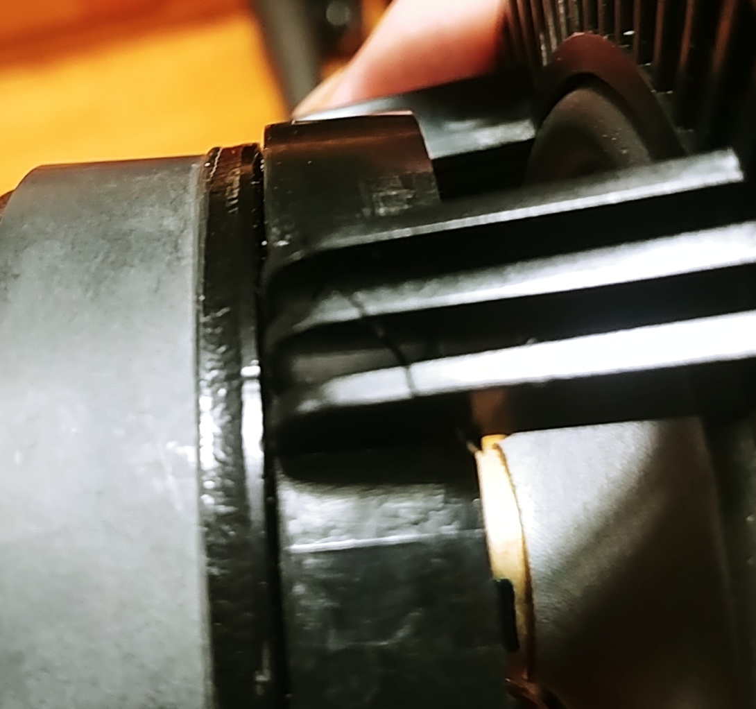

Was this a basket issue with the alpair6s or just bad luck. A pair of a6,s we purchased a few years ago but never used seem to have fractures in the 3 legs of the basket. The haven't completely separated but may compromise the integrity of the driver.
Not something I've seen before either, so I suspect bad luck I'm afraid. Some epoxy should sort it though.
After a close look at the second driver there seems to be similar fractures in one of the 3 piece legs.
J B Weld is an epoxy brand favored by many. They have "5 minute" and "24 hour" formulas. The 24 hour version is quite strong but the 5 minute version would probably do OK here.

Hopefully, none of the suspension is affected by this. I would guess damage during shipping? We used to do "shock and vibe" testing; some of which was to simulate shipping handling and damage. Knowing many of my buddies that worked for UPS, FedEx and other shippers; if it said fragile; they threw the boxes even harder!

I hear ya about the shipping and I do have jb weld around, I recently used it to re-attach a dust cap that dropped off. They came in a case of 24 and were the only pair of 6s in the box.
