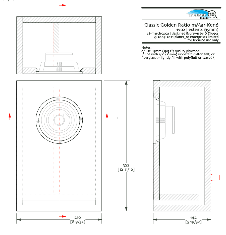

Was a 7p tuned version of any of the desktop/small size enclosures every designed? Cant find any available publicly, but maybe they are part of a subscription?

Here you go with a stand-mount design for the Alpair 7P:
https://www.diyaudio.com/forums/full-range/356380-alpair-7p-enclosure-2.html#post6252917
Planet10 might have paid plan-sets.

A7p can be fitted into the milliSize enclosure. It is the smallest. You will not find any P10-hifi plans without high ratio slot vents.
A7p is about the same size bezel as the FE127eN in these.

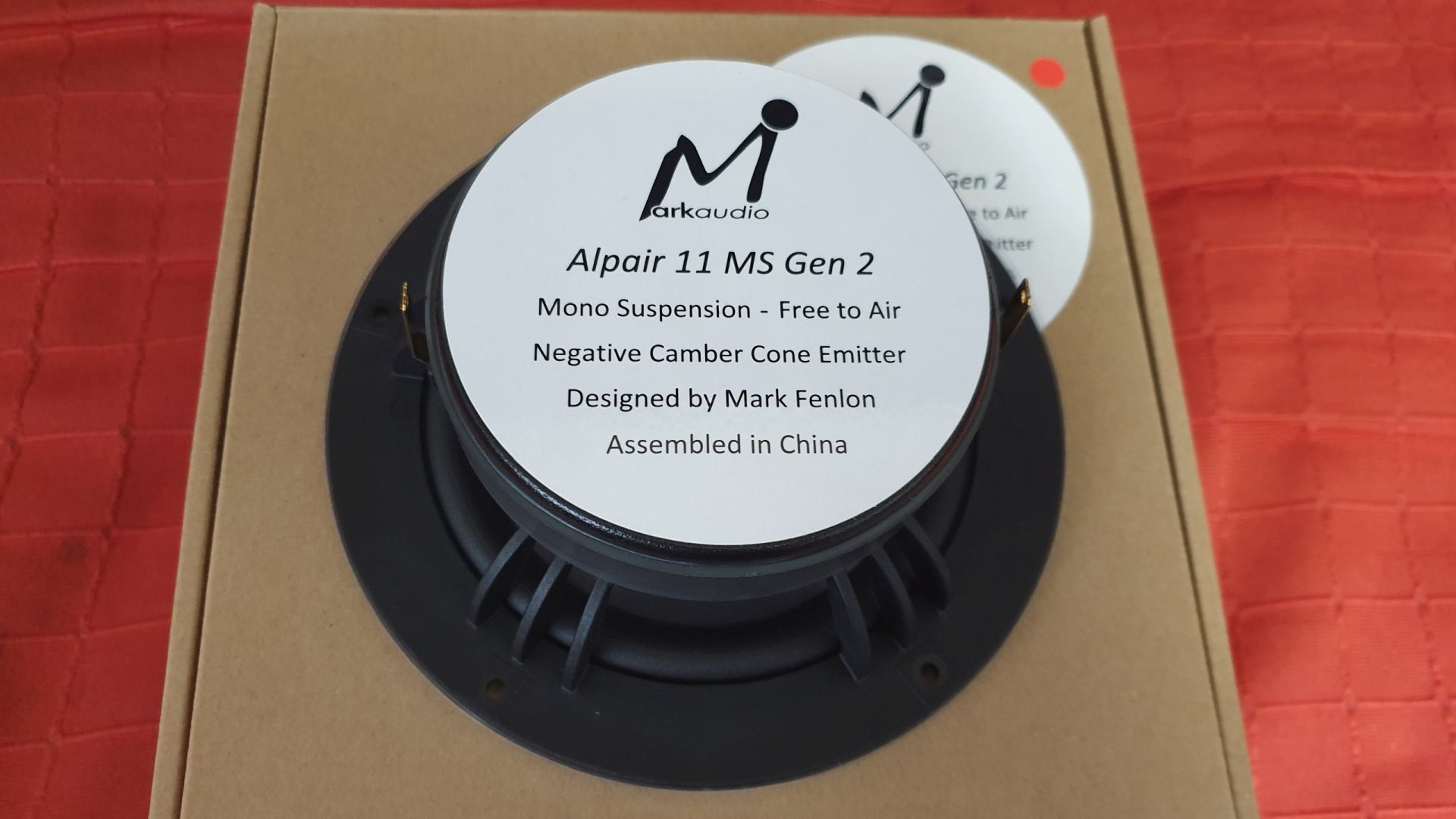

Hi guys!
I have recently ordered a pair of Alpair 11MS drivers from KJF Audio and I was surprised when I received a Gen 2 version. I was not aware that there is a Gen 2 version of these drivers and I can't find any info on them. Does anyone know anything about these new drivers? Can they be used in enclosures designed for Generation 1 drivers (Nostromo)?
Hi guys!
As far as I recall, there is from a user's perspective essentially no such thing, label and to a point language barriers notwithstanding. If memory serves some minor changes were made to the composition of the surround to reduce the number that failed to meet tolerance, but this did not significantly affect the baseline frequency, impedance responses, or cause the parameters to drift away from the production QA / QC tolerance vis-a-vis advertised spec. under the given test conditions. It was just a change made for manufacturing reasons to reduce wastage and while it's certainly honest to note it, it doesn't really affect buyers per se. I'll double-check, but as far as I know, that's the state of play.
but this did not significantly affect the baseline frequency, impedance responses, or cause the parameters to drift away from the production QA / QC tolerance vis-a-vis advertised spec. it doesn't really affect buyers per se.
Probably thats why the officially published spec sheet is the same at mark audio website.
...from a user's perspective essentially no such thing...
Way more changes were made during the lifespan of the A7.3 and it did not become an A7.5
It is worth noting that the difference bewteen A7.1 and A7.2 was the super gasket, those 2 only got those designations after the A7.3 came out.
So one has to note that generation designations are somewhat fluid.
