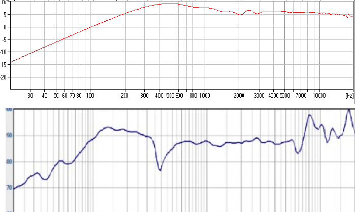

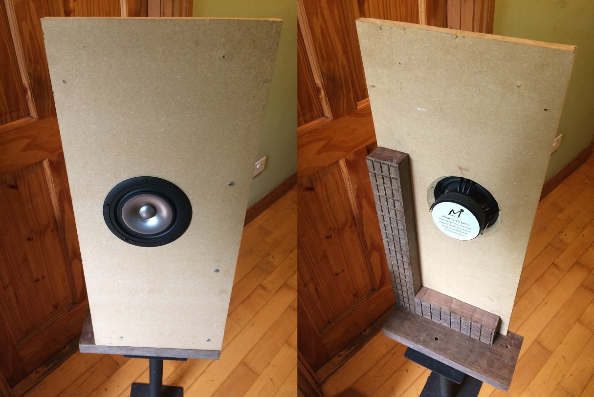

Here is the OB 11MS on a 80x35cm baffle intended for FR use, the first was just manzanita style baffle minus the woofer.
I also built a simple 14L box that could be used sealed or EBS BR to have a frame of reference (because it would be a challenge to make the 11ms sound truly bad anywhere).
It sounds really nice to me, but it is very peculiar just how well the 11ms is able preserve a sense of low-end on the OB, to the point that I prefer it with no EQ at all.
The driver response and baffle response should compensate for each other well, but there has to be more to it.
I used parametric EQ to see if cutting the lowest frequencies could improve quality like it did with 7p... even around 30Hz there is audible changes in the low end, the sound becomes leaner and less enjoyable but there is also no noticeable quality gain (if anything there is quality loss from the use digital EQ), this is at moderate to low volume.
I don't think it's possible 30Hz would be audible in this scenario... could it be 11ms has high THD in sub-bass and high order harmonics are letting you 'hear' some impression of sub-bass higher up?
Regardless, having also compared to sealed enclosure, if this 'effect' exists it is a lot more apparent on the OB. The bass deficiency of the sealed enclosure is more noticeable and distracting to me than the OB, on top of having more room interaction, it's probably because the box emphasises or contributes to peaks in the upper end more.
Im experimenting with P830668 right now on very large baffle.
In my limited experience you can not get a real increase in bass from OB without a bigger baffle. With a small baffle no amount of EQ could provide a good sense of bass impact or definition, while you would still get room interaction.
Excessively big OBs (wide ones specifically) sound awful outside of the bass for whatever reason. With huge baffle i think it should be possible to build an amazing OB sub, even with reasonably small woofers, but then the question is how will you ever integrate it well with a HF driver that wants the smallest baffle possible to sound good.

Want to add that adding width to outer sides of the baffles only and maintaining the relatively short distance from front to rear of driver on inner sides was something I did not test previously.
Testing now imaging is better preserved with increasing width, similar to L frame but with a lot better effectiveness preserving the low end in practice, I guess there must be some baffle step with L-frame.
L-frame just did not sound right to me but with this extended width baffle you create more edge diffraction effects instead, evidently it does not sound as smooth.
There is the approach of lining the baffles with felt to deal with edge diffraction which would also work with an OB, will see if that can improve this too.
Unfortunately you cant escape the basic practical issue of having huge open baffles that cant be placed near walls...
